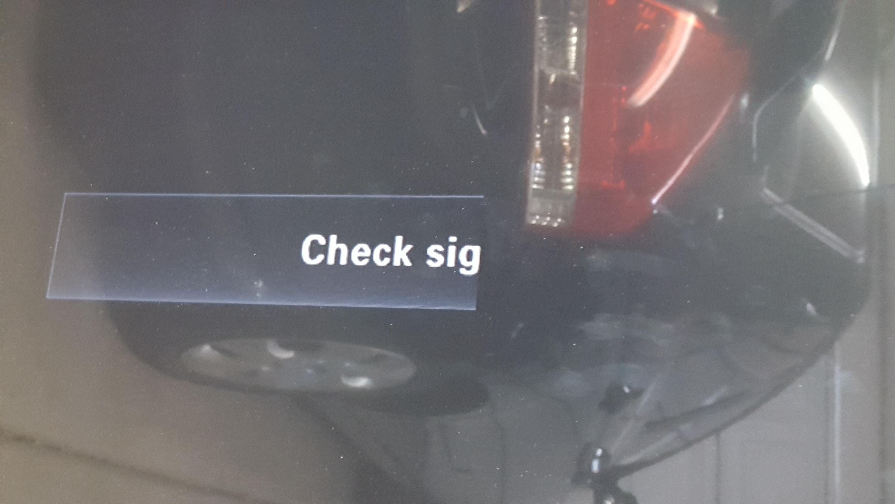

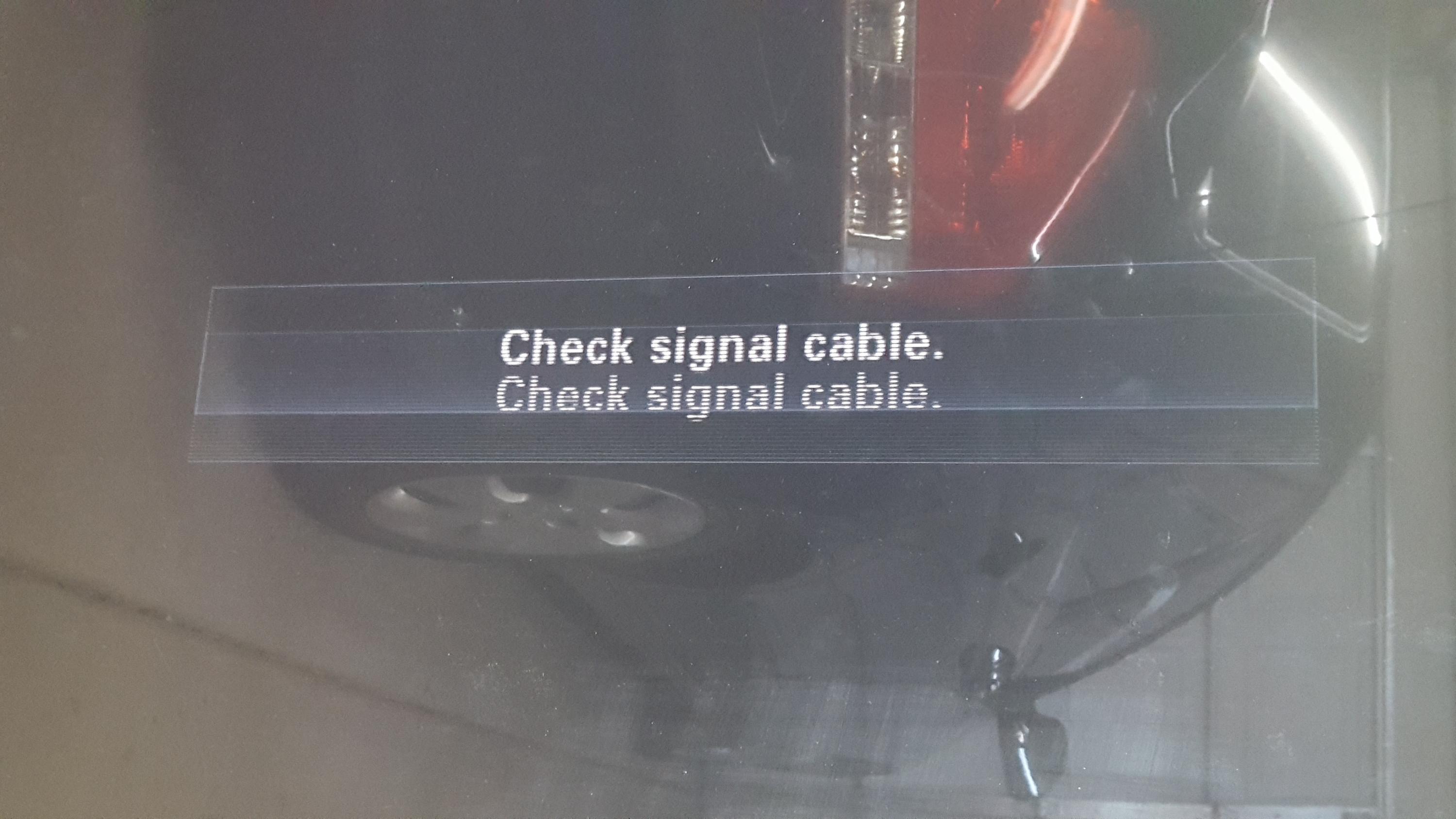

    When it is all plugged in, I get double image/horizontal lines. When I unplug right ribbon cable only, double image/horizontal lines goes away. When I unplug left ribbon cable only, the double image/horizontal lines is still there. See images for details (yes, that is my car in reflection, bonus points if you figure out make and model :)
    Tab bonds look very good.
