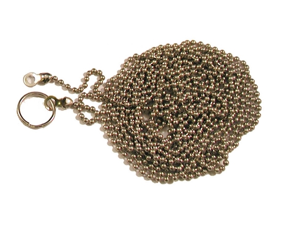

          • R_J
            • Jun 2012
            • 9588
            Re: Good endoscope / borescope
            If you are fishing wire vertically what works well is Ball Chain, you feed it from the top and it will stay straight and usually find the lower hole quite easy. then you use it to pull a pull string, then use the string to pull the wire as the chain is not that strong.

              • R_J
                • Jun 2012
                • 9588
                Ball Chain, the same chain they use on sink plugs

                  • R_J
                    • Jun 2012
                    • 9588
                    Yes it would be similar but smaller, the fish type is usually heavier, something like this from home depot https://www.homedepot.com/p/Westingh...0700/203077870
                    Many places have it in bulk and you can by it as long as you need, it is also very easy to splice if broken or to extend it.
                    Cheap and works well.
