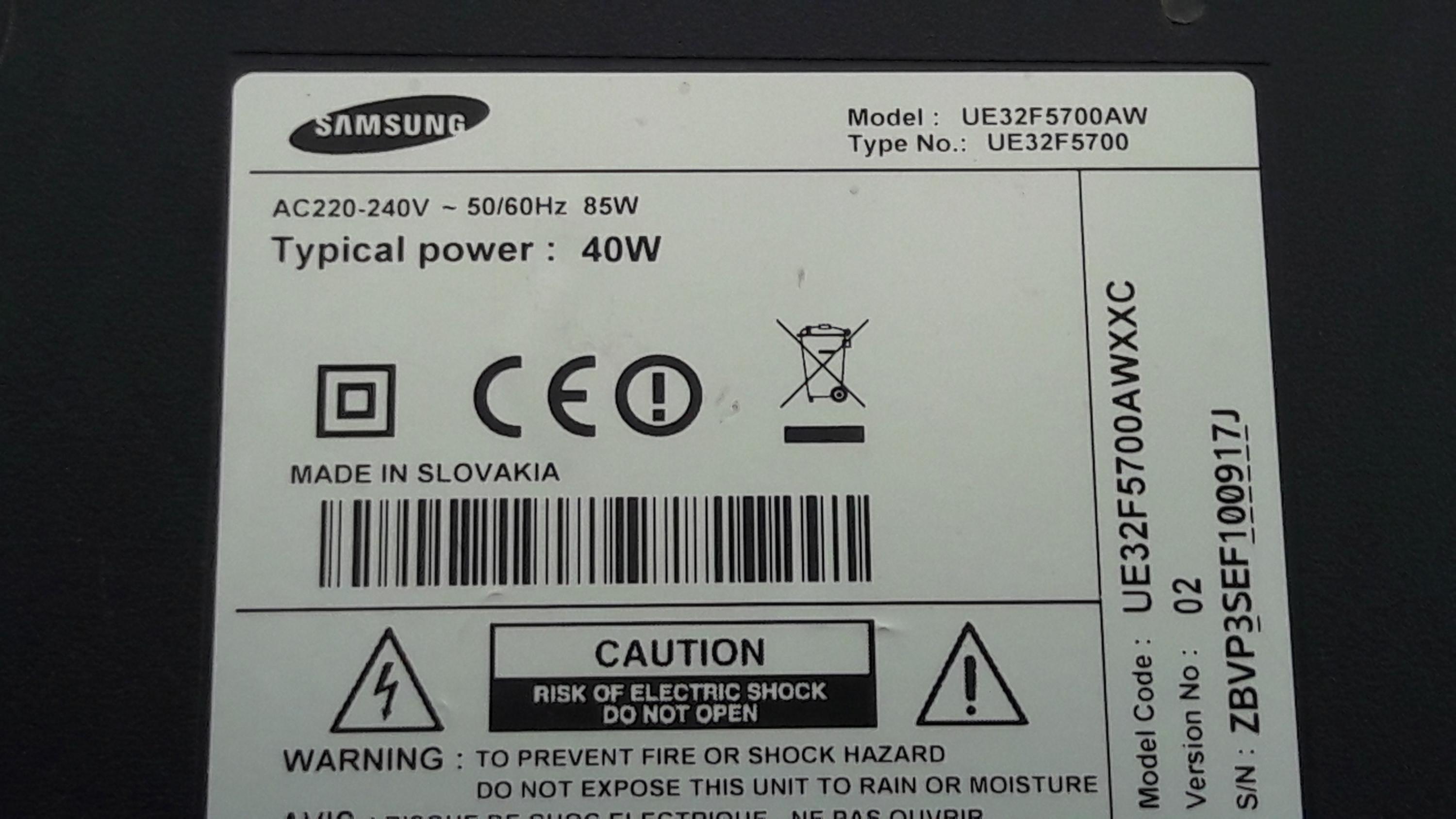

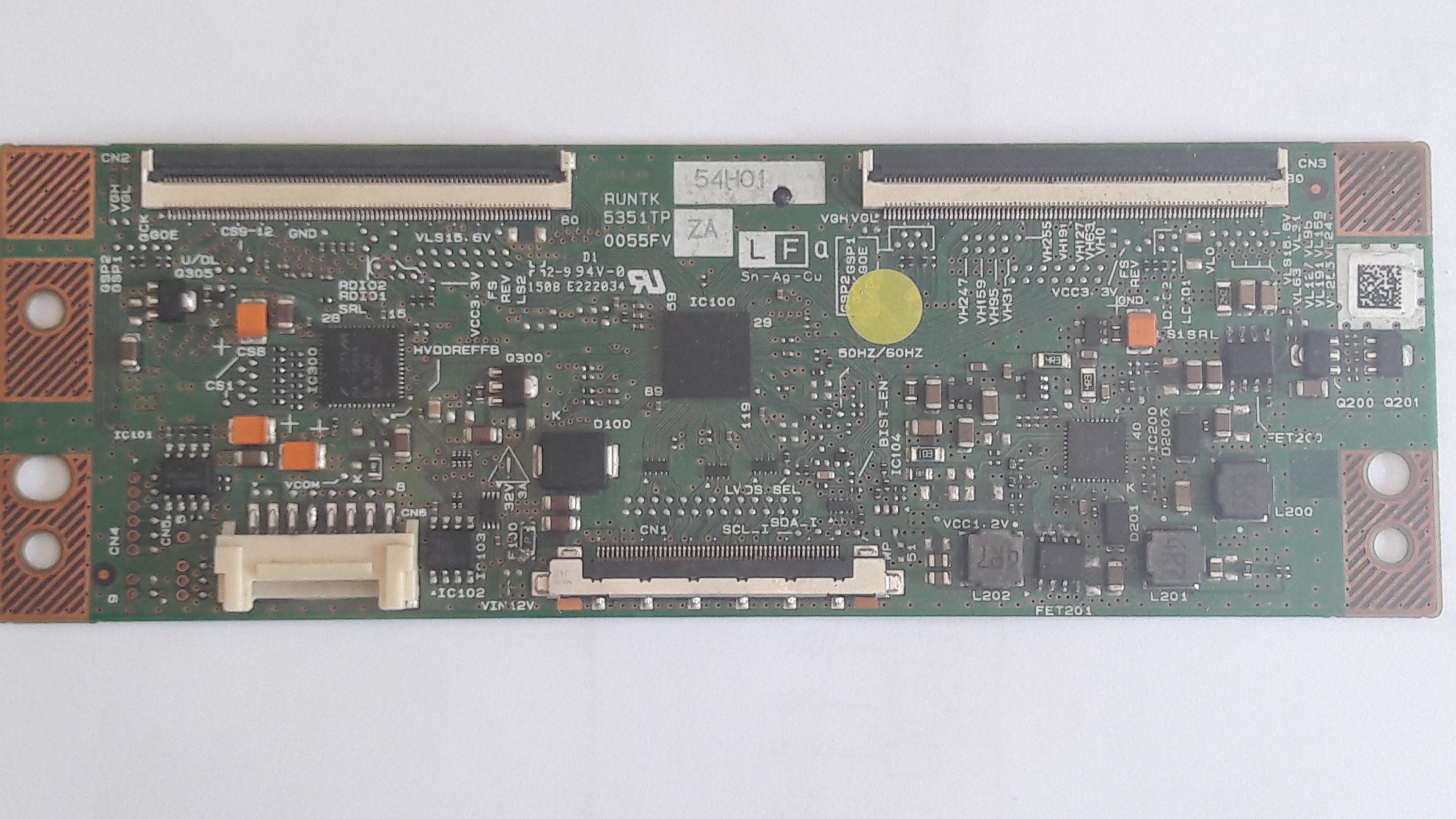

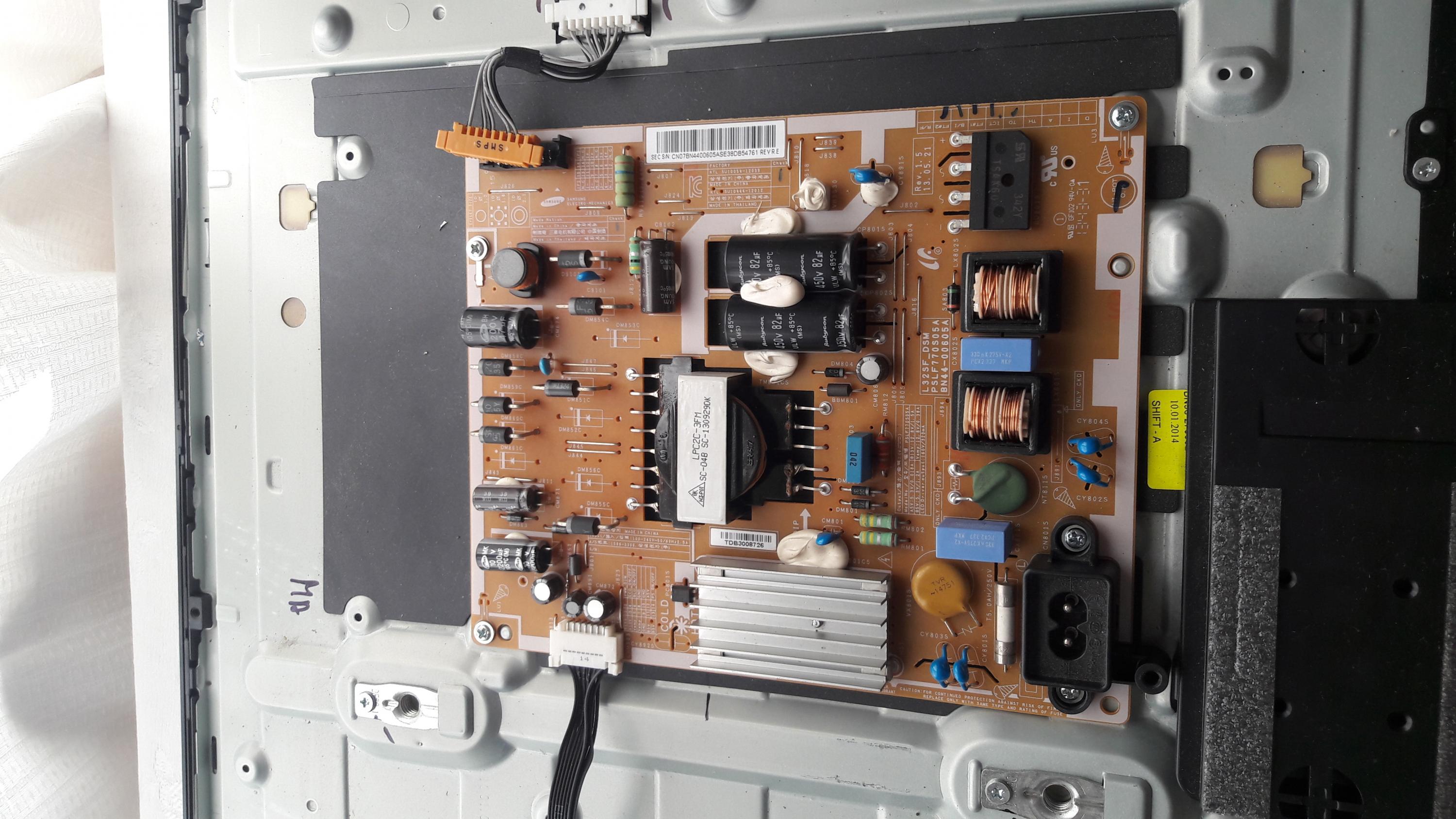

    Hello, good morning, I have a Samsung TV,
    Model: UE32F5700AW, when I turn it on
    it has sound and the led of the panel light up but the image
    is absent, I have been told that it may be the
    T-con. In the input and output of the fuse of this card I have
    12 v., But I do not know where to measure more tensions in the T-con.
    The code of the T-con is RUNTK 5351TP 0055FV ZZ.
    Please can someone tell me the steps to follow for
    find the problem
    Greetings and thank you.
    P.S. Sorry for my English.

    Please upload good clear straight shot pictures of the whole T-CON board and also the whole back side of the TV showing all the boards.

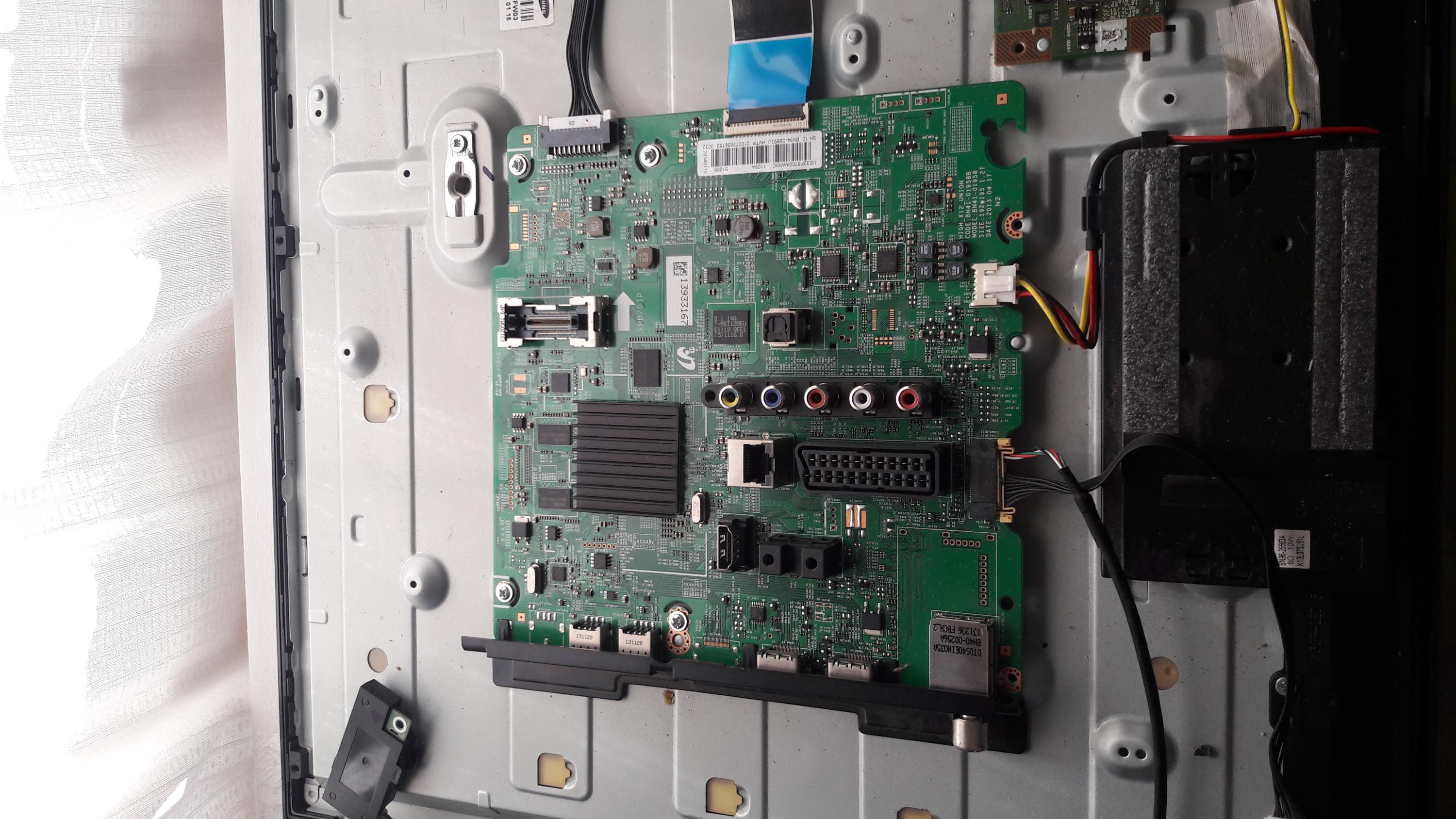

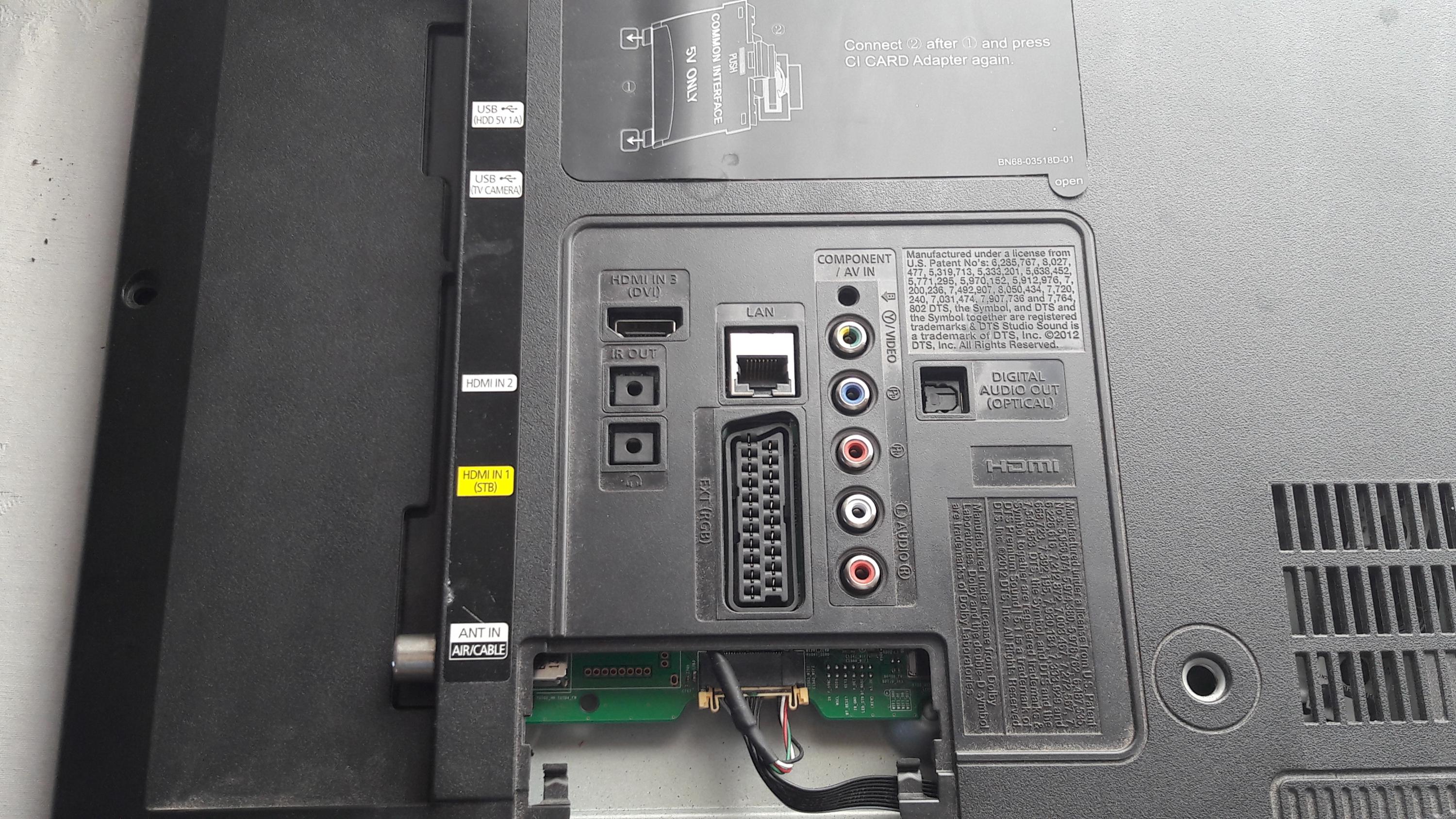

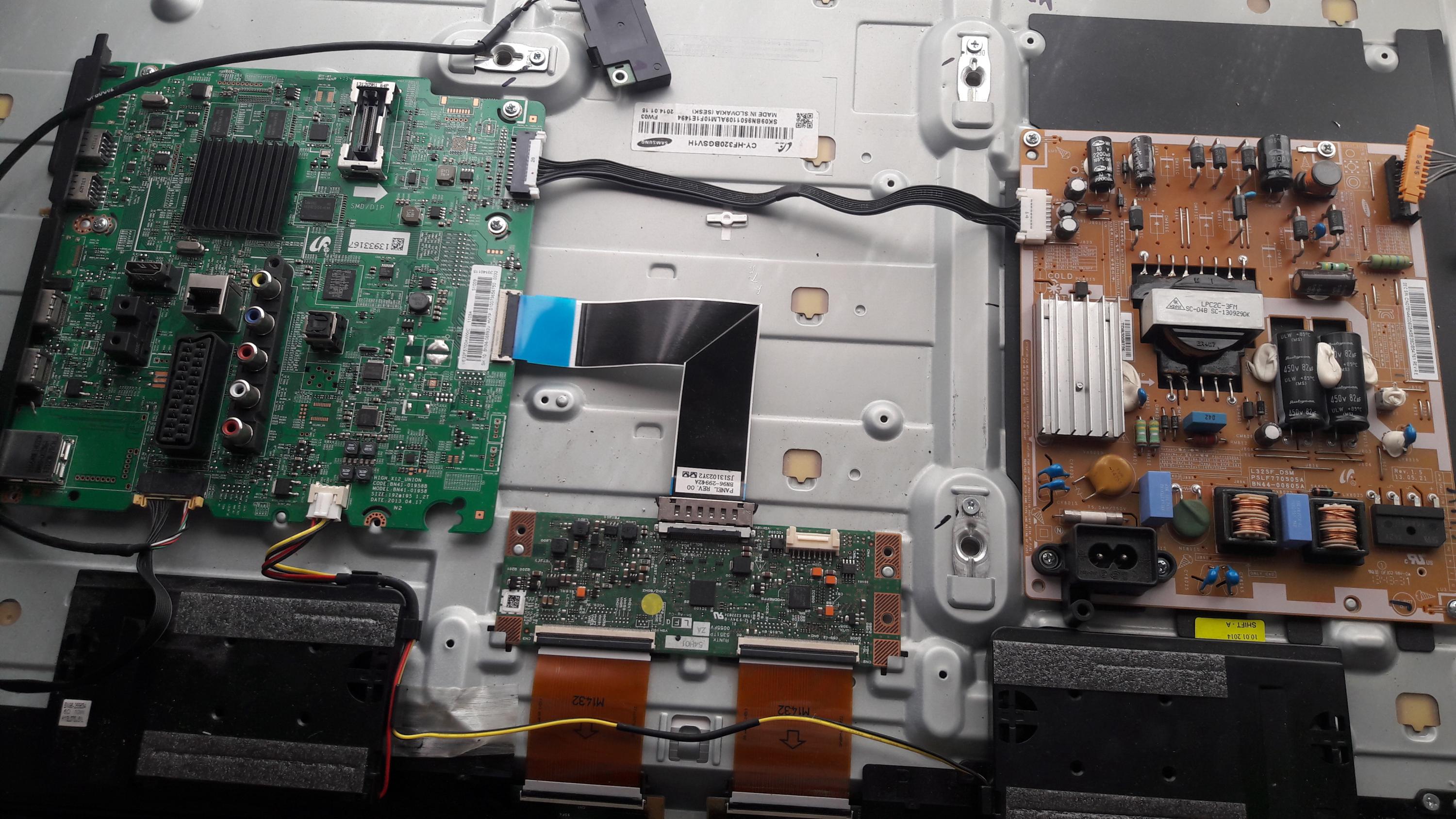

      Re: Samsung TV with black screen
      Hi, I'm attaching TV pictures, I hope
      be correct

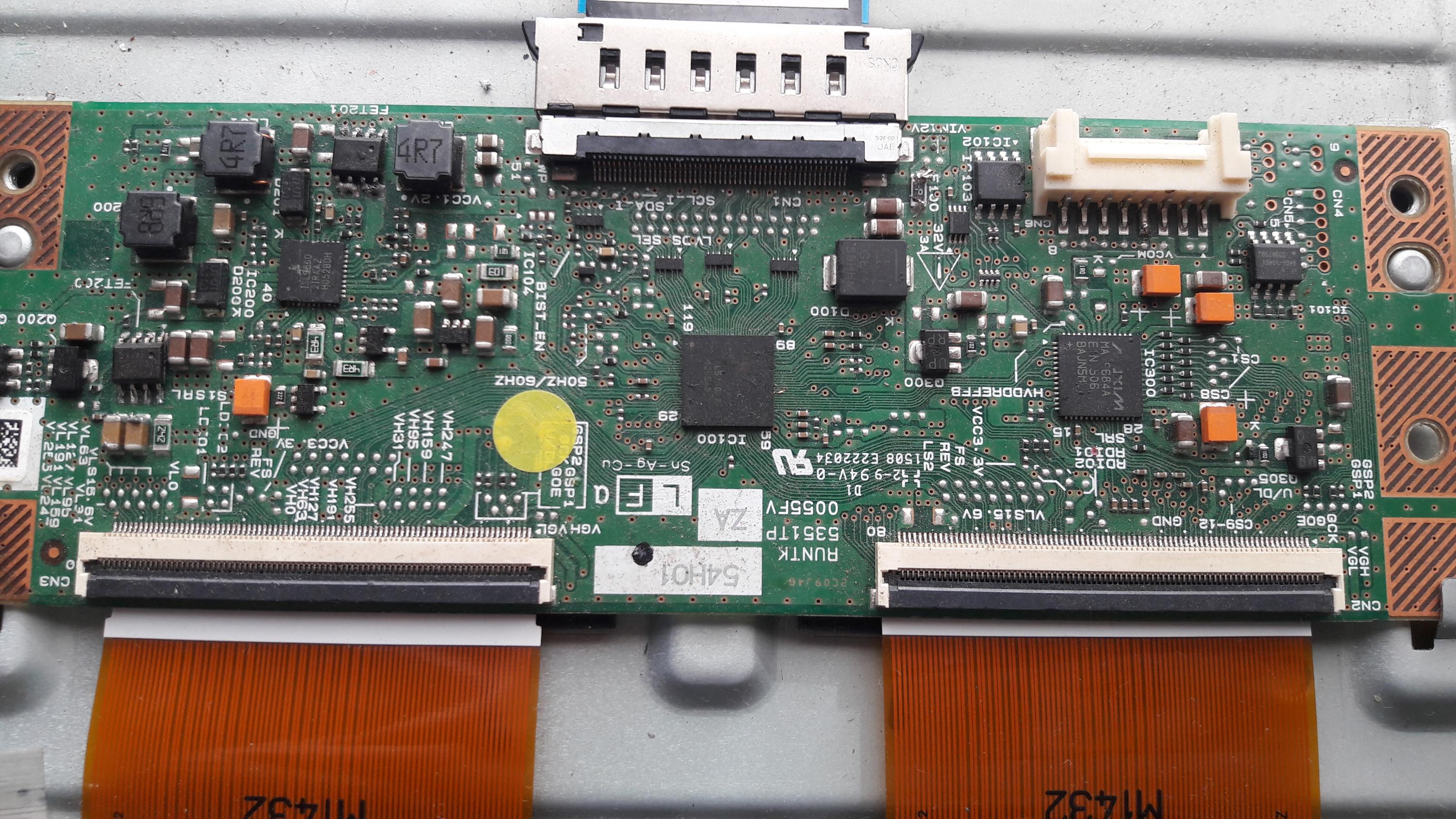

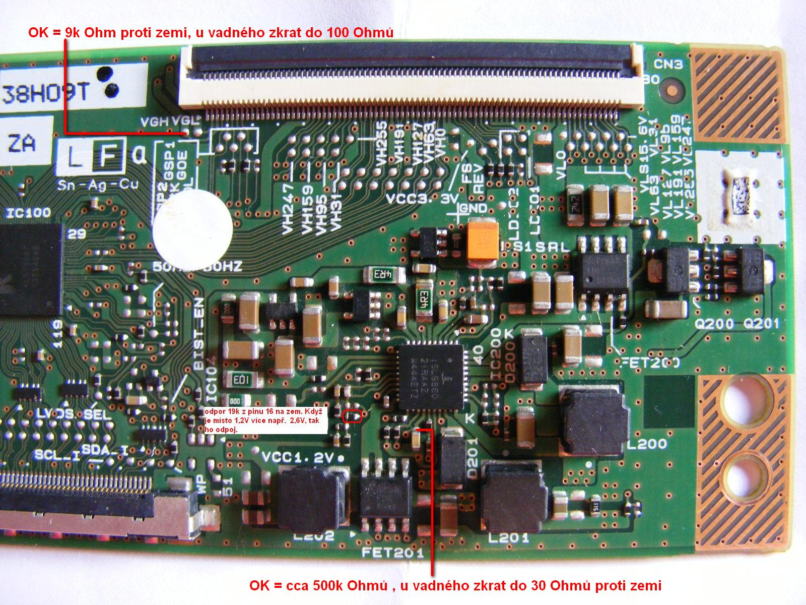

        Looks like F100 was bridged and was open circuited again. If you do have 12V on both sides of F100 then measure the voltages on VGL, VGH, HVDD and VCOM and report your findings.
          Hello, indeed the fuse is bypassed because it was fused and as I said in my first post
          I have 12.4 v. At the entrance and exit and in the points you mention I have no tension.
          A greeting.
              If the Flat ribbon cable to the Panel Bd. is disconnected, do these voltages come up? If yes then the Panel is defective, if no then a new T-CON Bd. should solve your problem.
                Mainboard there, need to check white sticker numbers to see if its a match, 60 euros for a 32 inch tv seems a bit high tho. https://www.ebay.es/itm/PLACA-PRINCI...13WS:rk:3:pf:0 Oops, thought you were looking for a mainboard.
                  Disconnecting the flat cable that goes to the
                  Main-boar, the voltages remain the same, absent.
                  I understand that it is necessary to change the T-con, I can replace it
                  for a Runtk 5246TP instead of the Runtk 5351TP.
                  A greeting.
                      Yes a new T-CON will fix your problem.

                            What we need are the Voltages of VGH, VGL, etc. on the T-CON board test point when the ribbon able between the T-CON and the LCD panel are not connected and connected, not the cables to the Main board. There are many Voltage test points on the T-CON board that need to checked and reported.

                                What we need is the OP (gua45) to provide the Voltages from HIS T-CON board suggested in my post #14.
                                  But we know fuse is blown so he must replace it first.. also to be tested VLS15.6V

                                    ic looks bad by where it says FET 201 top left
                                      Tcon fuse is good then.
                                        He bypassed the fuse per post #5.
