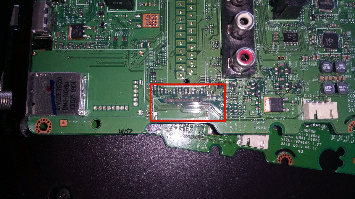

    I did an LED replacement on a really nice Samsung UN46F6300... With the bad luck I have had this week, I was really worried about it..
    Replacement went fine.. Didn't crack the screen or tear a tab-bond...
    I had put the back cover back on and reconnected the IR/Button to the Main Board.. Then I remembered I wanted to check something.. Pulled the back cover off and totally ripped off the IR/Button connector..

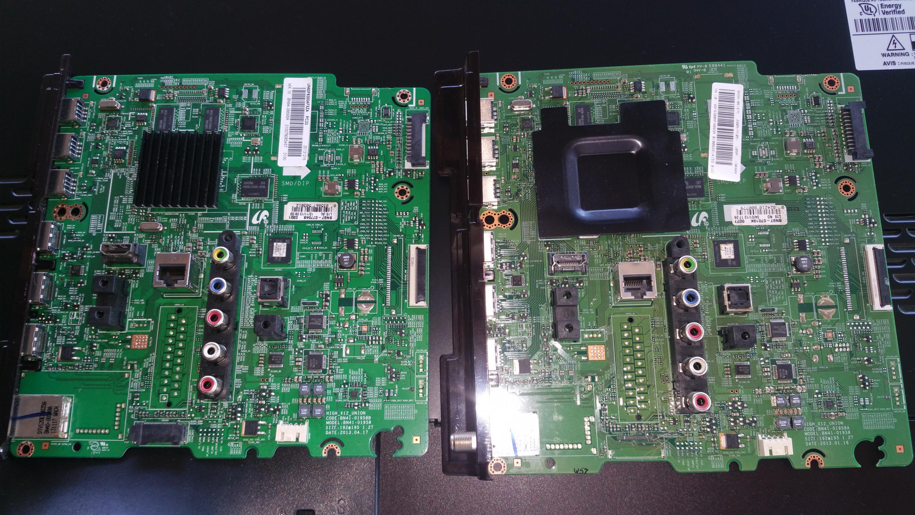

    So, I found another board that looks identical and has the same connections.
    Works great... Except for the fact that the display image is upside down.. Can't catch a break..
    I have had luck before with fixing this problem by replacing the firmware chip with the chip from the original board..
    Long story short.. (too late.. ) I need to confirm that the WinBond chip on boards is, in fact, the BIOS/FIRMWARE chip...

    Have you tried flipping the image in the service menu?

      Re: Generally Speaking, WinBond Atmel - BIOS/FIRMWARE
      go through the service mode
      done this in the past with a f5500
      reckon it should be similar here
        U might need to change the panel type thats what i ended up doing
        what tv is the repalcment board from there should be a model number on it
          just seen pics
          so u are going from 60 to 46
          u jsut need to change the panel type u shoudl be fine

            Thanx for the input and advice...I did that and got the panel type to the correct setting...
            I tend to make things more difficult than they have to be.. heh
            But simply for future reference.. Is it a safe bet that an Atmel or Winbond chip is likely the firmware chip??
            Thanx again for the advice, ya'all.. Saved me a lot of work and likely a lot of headaches...

                  No, it's not guaranteed, but it's likely.
                  The firmware can be stored on either an SPI flash or a larger NAND flash in a TSOP package (44 or 48 pins). Sometimes a bootloader is on the SPI flash and the rest of the firmware is on a larger flash chip. Sometimes there's just one.
                  Swapping the chips shouldn't cause any harm in itself, if done correctly - but changing settings is the easiest obviously.
