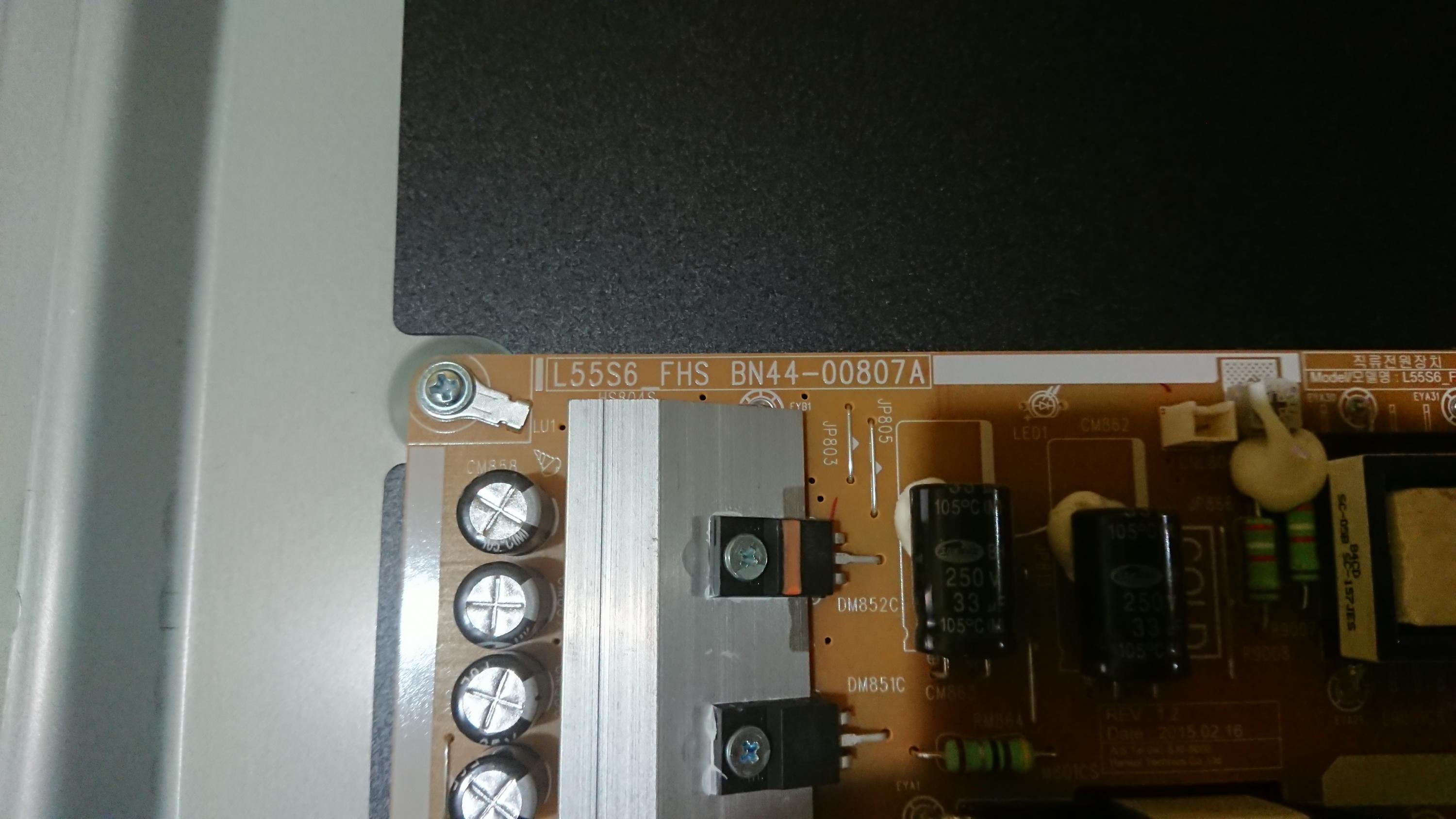

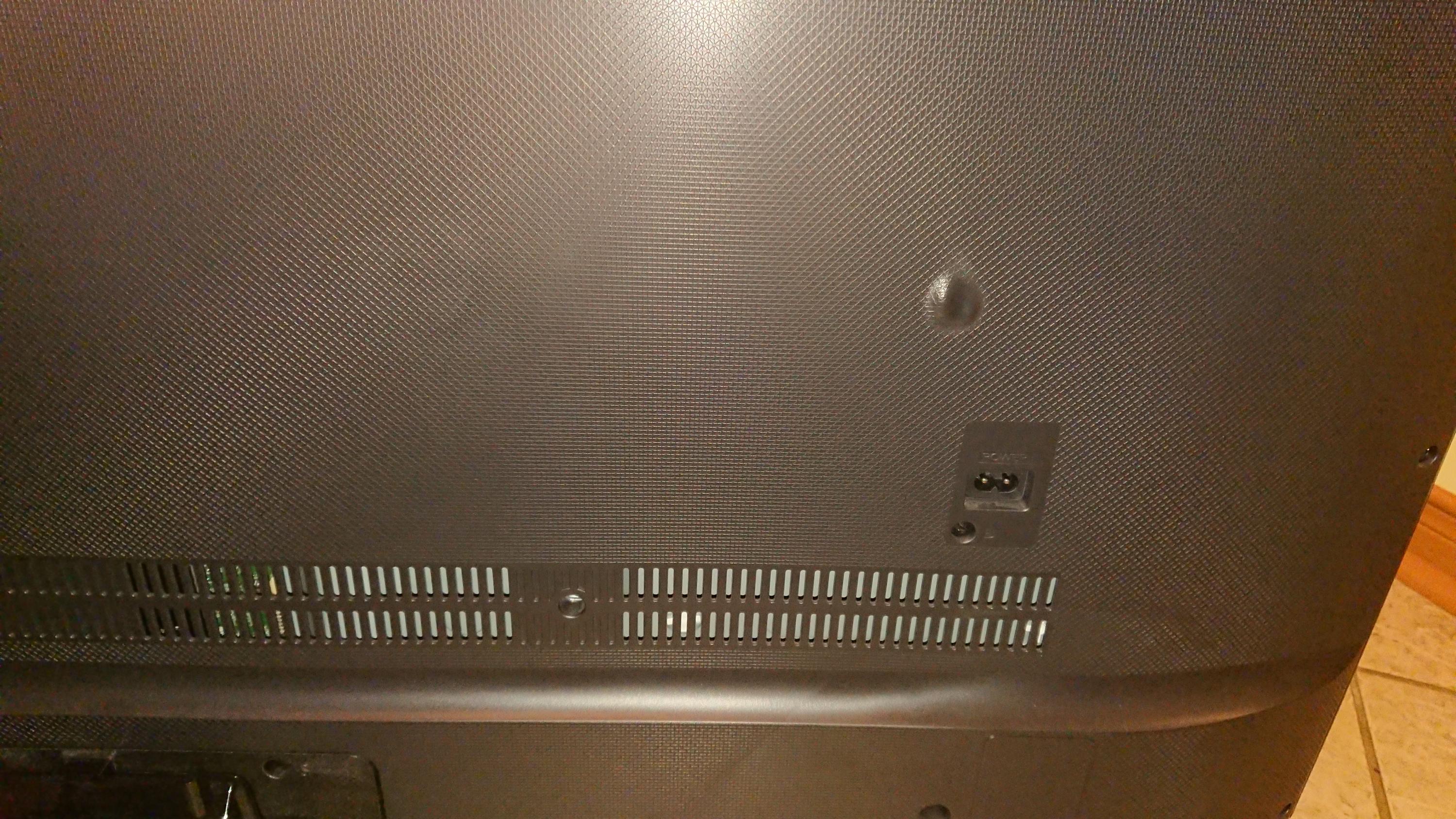

    First obvious visual red flag, as a plastic bulging on the back over, not too far from the plug ... I immediately think, something blew up on the power supply board. Here's the pic ....

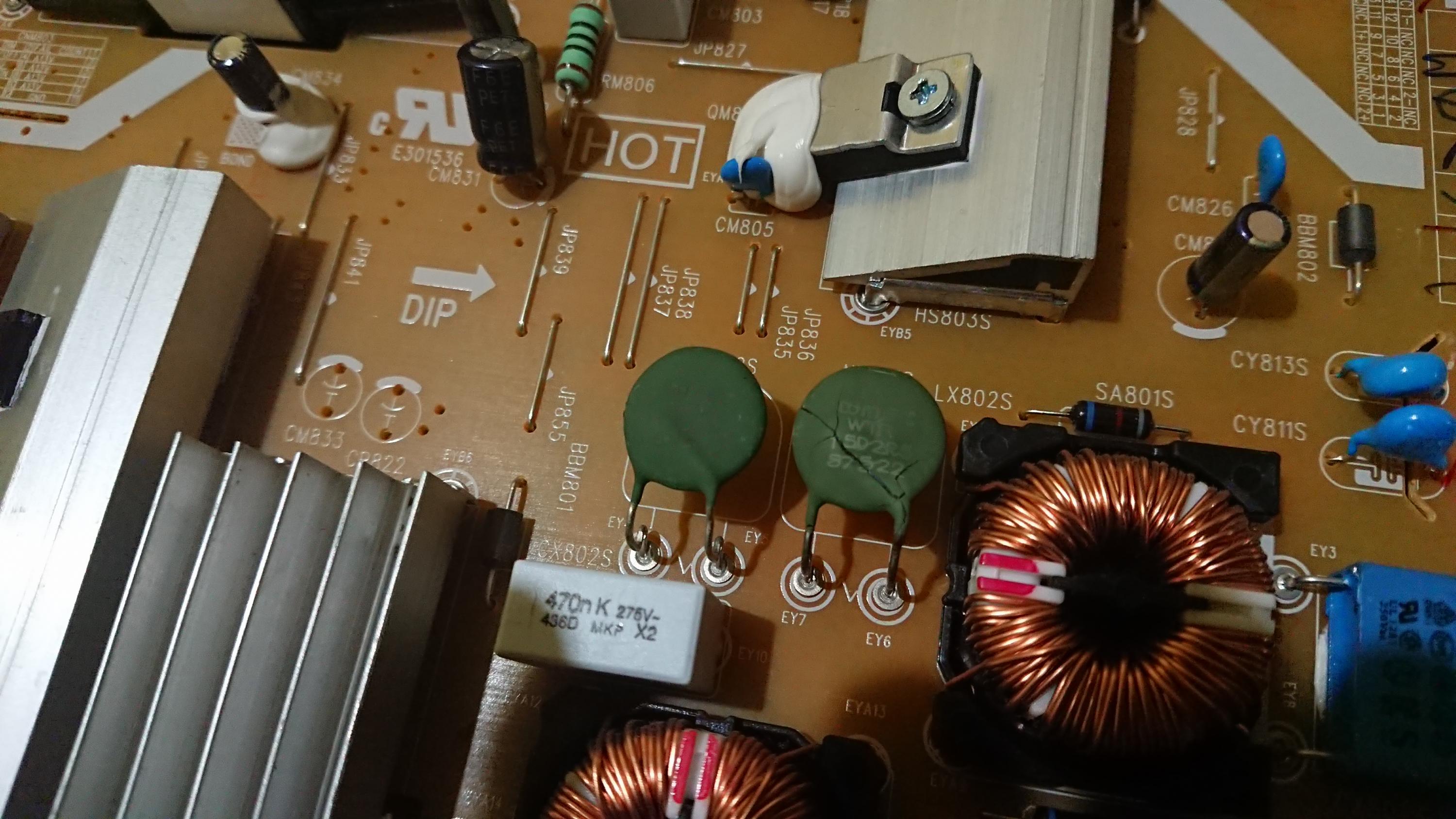

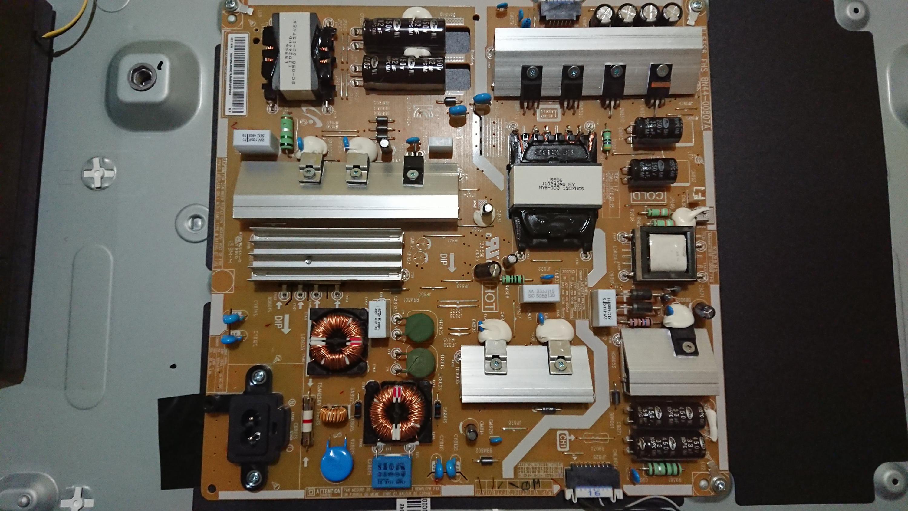

    After I removed the cover (pic below), I am looking at where the bulge is and see obviously one of the green NTC thermistor guys hurting. Using voltmeter to measure ohms, obviously I get out of range figure.

    is the other one working with it ? like in series or parallel ?
    i would be checking for shorted semiconductors first
      Re: Samsung UN50JU6500F; Blown NTC thermistor
      Well the other one measures about 3.5ohm at 21C. Shorted semiconductors ... you mean like diodes, transistors etc.?
      You think replacing it, is a good chance it will blow right back up again, eh?

        I do not see the pictures of the board.
        P/N BN44-??????
          If it is a bn44-00807 the green one is a mov 14D751 (location VX801S)
          The thermistor is a 2.5D-15 (Location NT811S)
            I took a couple more pictures of the board ... It's BN44-00807A

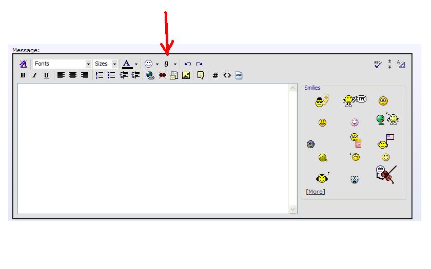

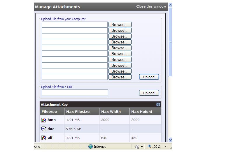

              Use the Go Advanced and click on the paper clip to attach your pictures
                pic has vanished
                  That's odd as far as pictures ... is this site not compatible with Google Drive pics sharing?

                      both thermistors are 15D2R5

                          Pics are attached to the thread now.
