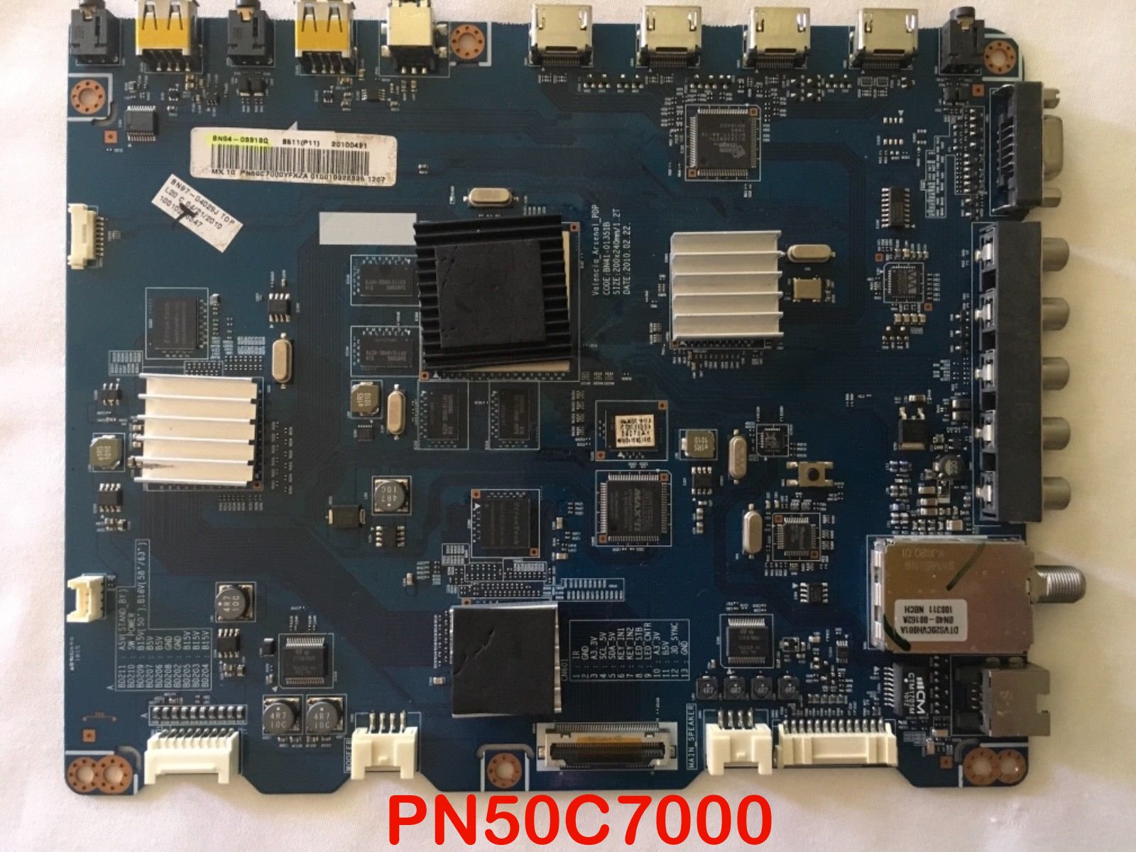

    Got a real nice and clean PN50C7000 in...
    At power up, the screen flashes momentarily and then a relay clicks and it shuts down. VS is at 212v and then starts to count down..
    Repeats... A screen flash, a relay click, VS at 212 and then counts down.. Continues..
    Replaced the Power PCB.. No change...
    Replaced the Main Video board..
    Now, the screen brightens for 15-20 seconds, then dims again... VS holds steady at 212v...
    I am thinking X-SUS board???

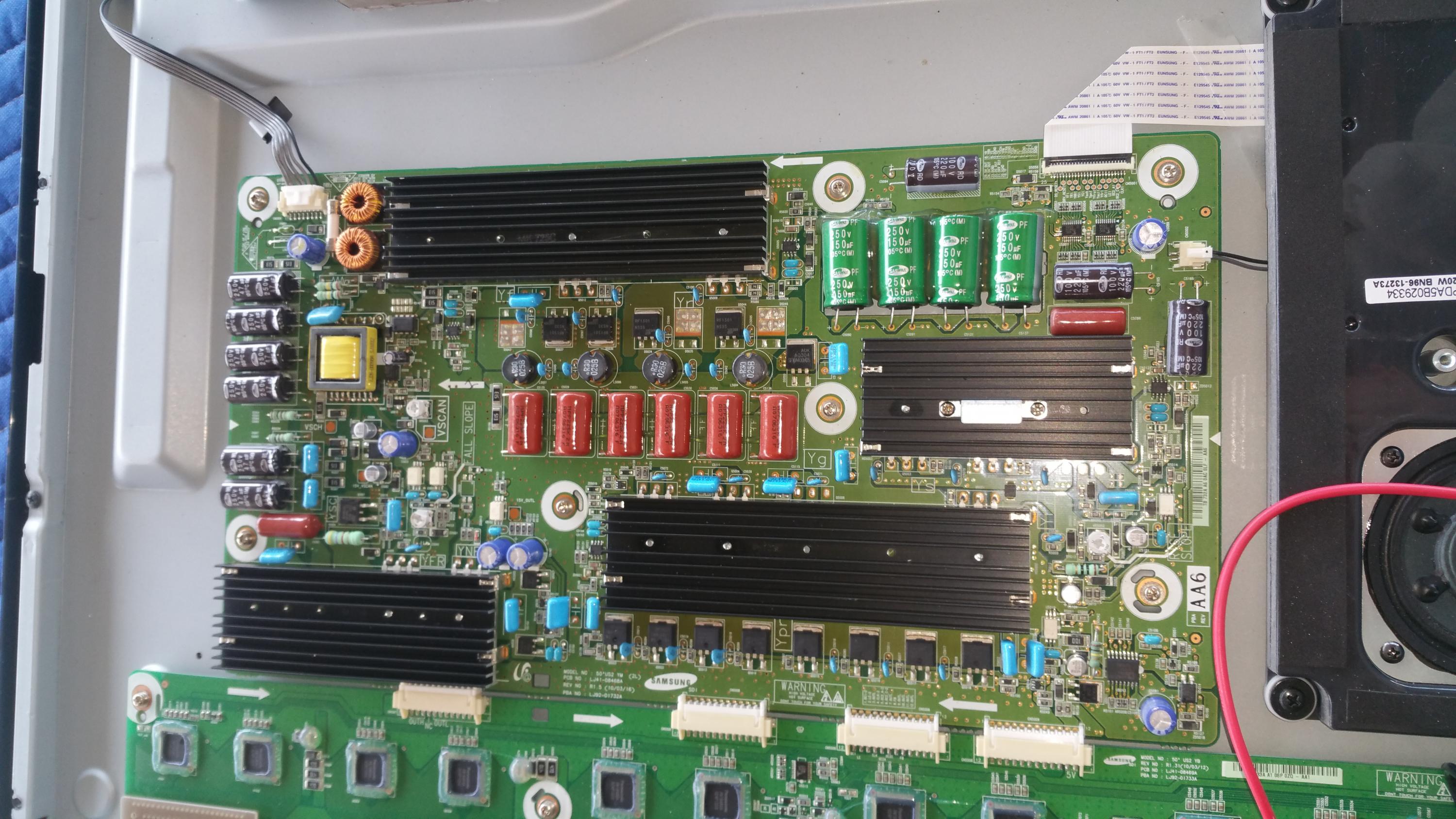

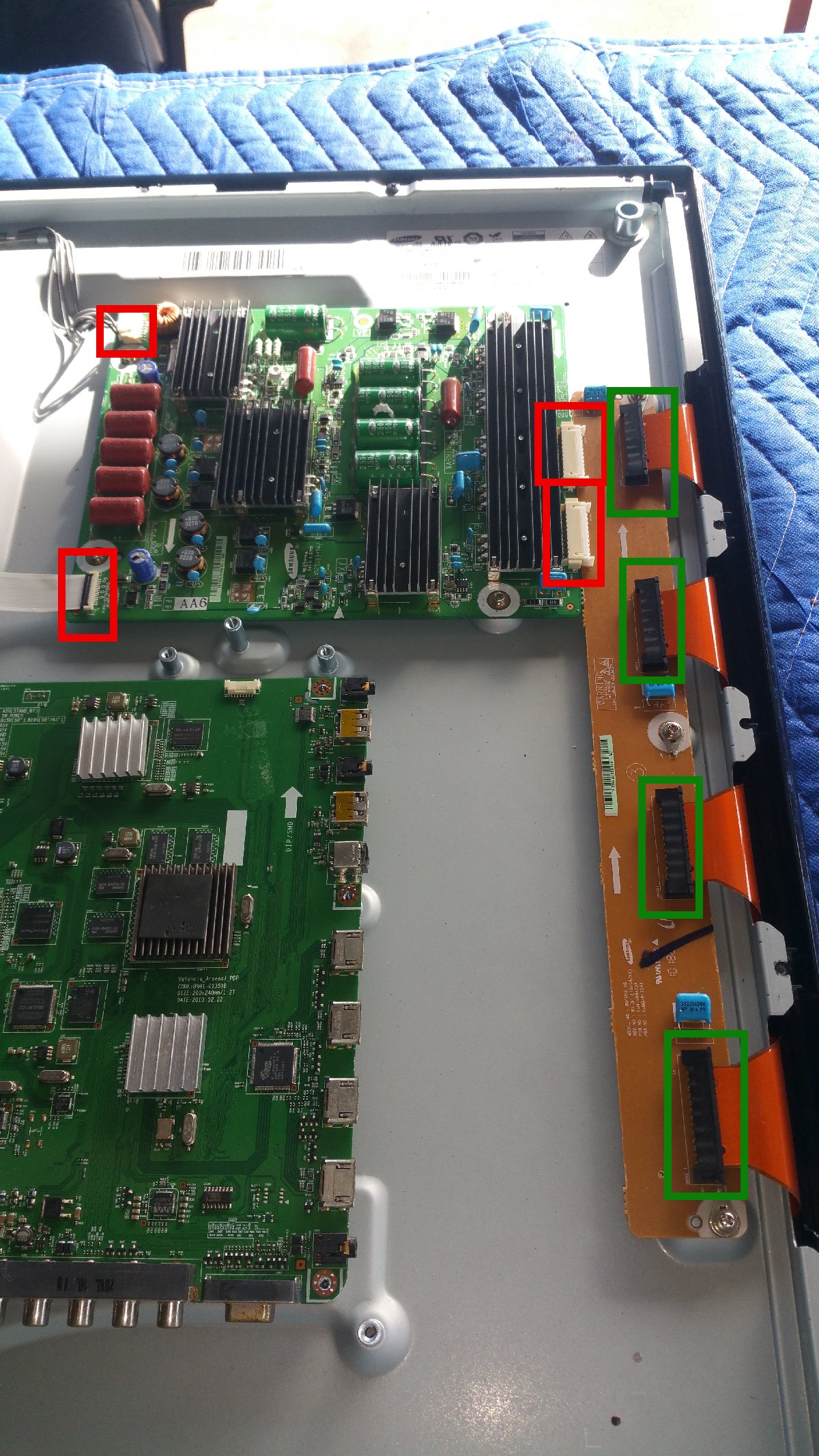

            OK I am back...
            Here's a pic of the X-SUS area...
            From what you wrote, I am guessing I unplug the X-SUS board from the red marked areas and physically remove it from the TV...
            The green marked areas can remain plugged in..
            Is that an accurate assessment??

                After reading and re-reading your post, I figured I understood it all right..
                So I went ahead and powered up...
                With the X-SUS pulled completely out of the equation, I don't get ANY flash on the screen at all. Completely dead on the screen..
                I get a solid and steady 212V on VS and 55V on VA...
                So, I am assuming we're talking a bad Y-SUS???

                  OK..
                  Turns out with the X-SUS board installed, the screen does flash bright for a second or two and then dims a little, but it's still lit.. I even see a few sparklies here and there..
                  But nothing is displayed..
                  With the X-SUS pulled out of the TV, the screen is completely dead.. No flash no bright no nuttin'...
                  So, indicates the Y-SUS or the buffers??

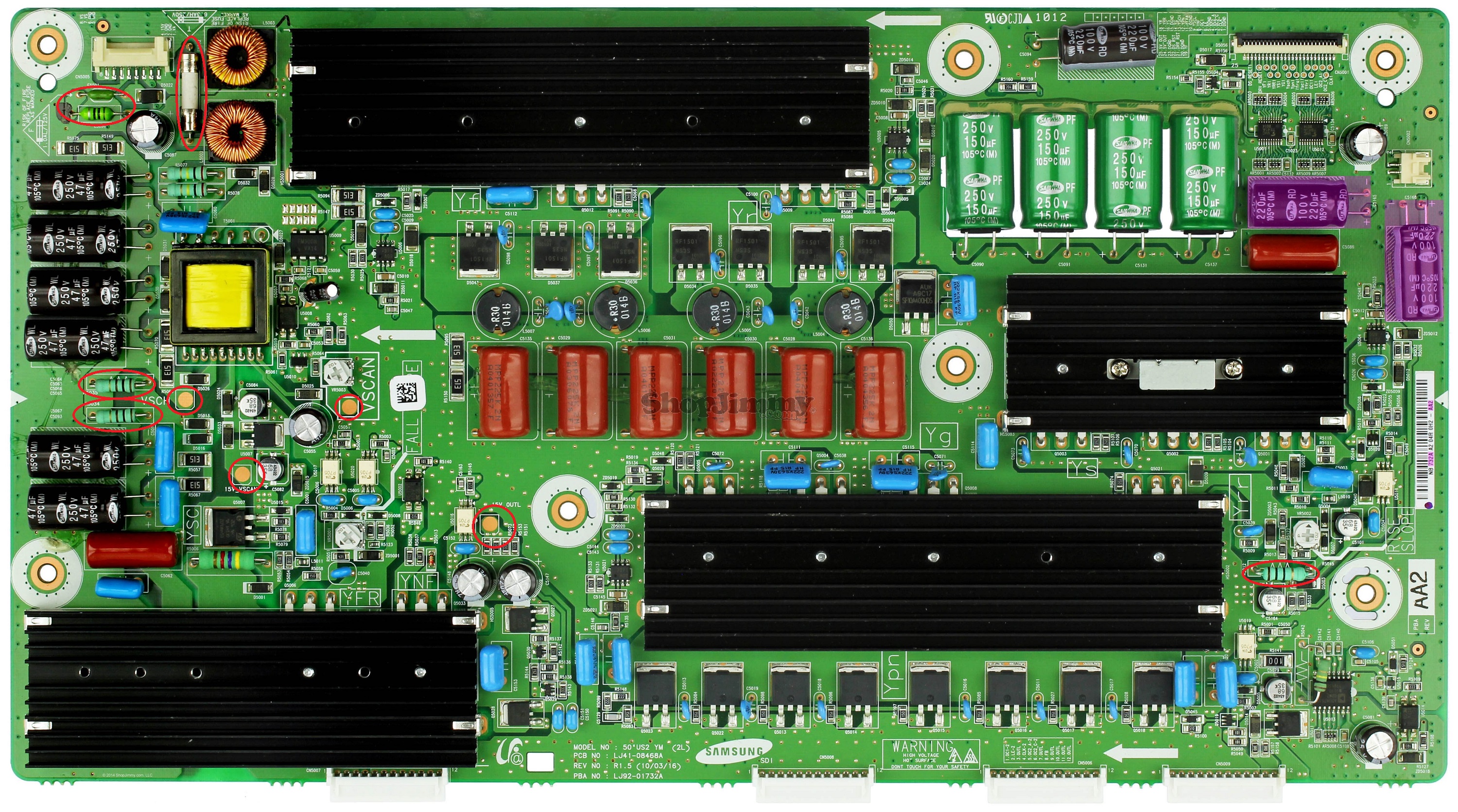

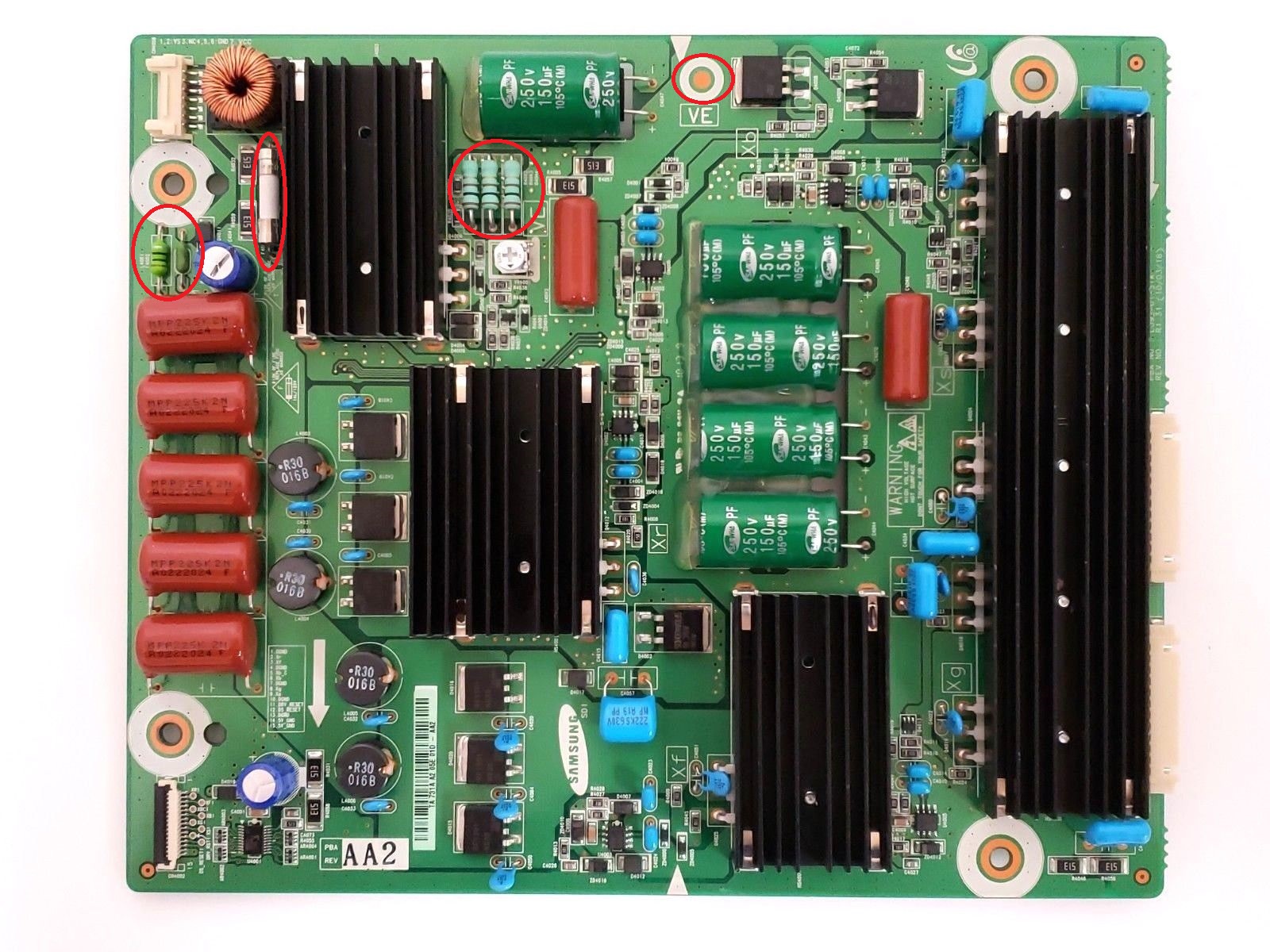

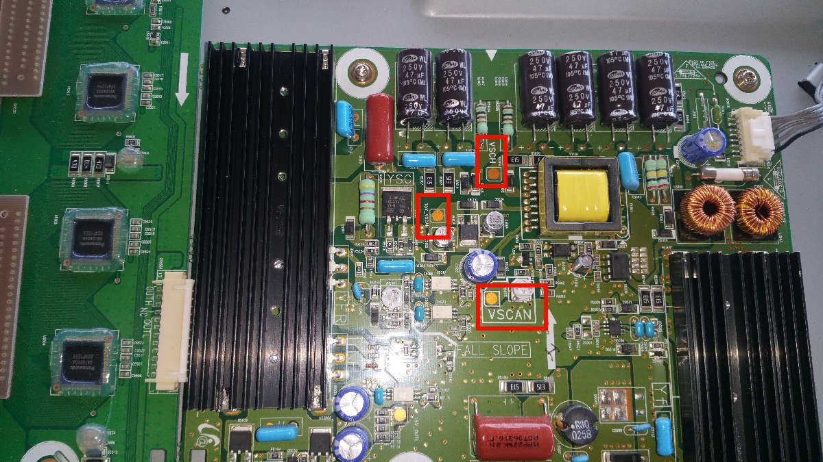

                    These are your X and Y boards, circled in red are points you should check.
                    Post your VSCAN,15V,VSCH on Y board and VE on X while the panel is ON, i think you measure them from checkpoint to ground except for VScan,which should have it's own reference. VE is 86V, VScan/VSC -190 according to what i've found.
                    Here's why i circled those resistors,in my experience with LG plasmas they tend to open when IGBT go boom,don't know with samsung,wait for the board to be totally discharged before servicing.
                    All of them are 1 OHM,some in parallel,should read 0.33 to 1 OHM.Also i circled the fuses,make sure they are good.
                    Forget this purple squares on ysus image,it was already like this when i got it.

                      On the Y-SUS Board, VSCAN is -189v, 15v_VSCAN is -134v and VSCH is 89v

                        On the X-SUS, VE is74v..

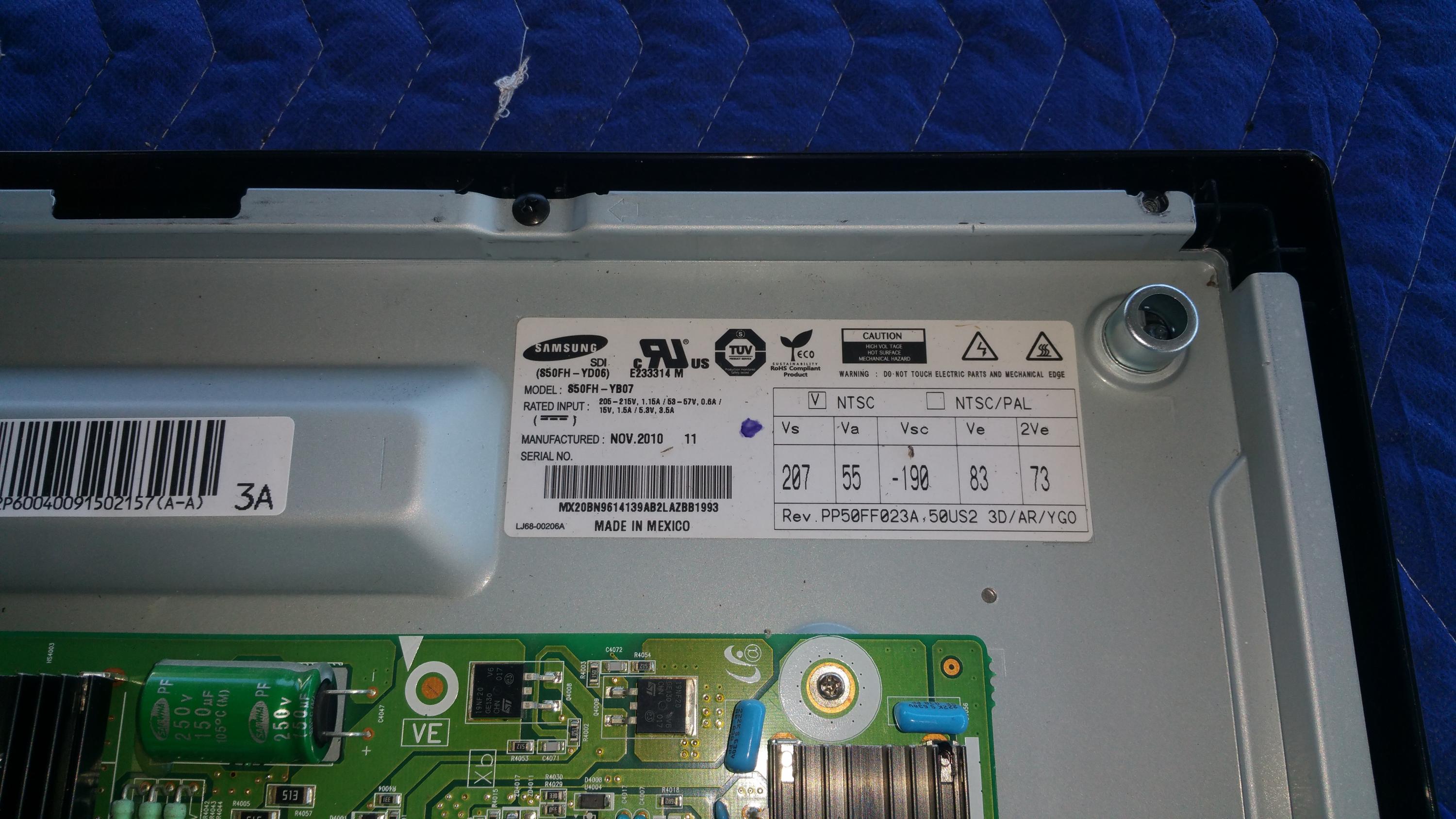

                                Attached is the spec sticker..
                                VE on the X-SUS is 73v... On the sticker it says VE is suppose to be 83v but VE2 (which I can't find) is supposed to be 73v...

                                  Ooops forgot the sticker...
                                  Put the old Power PCB on there.. No change in results..
                                  VSCH voltage was -39 instead of +89

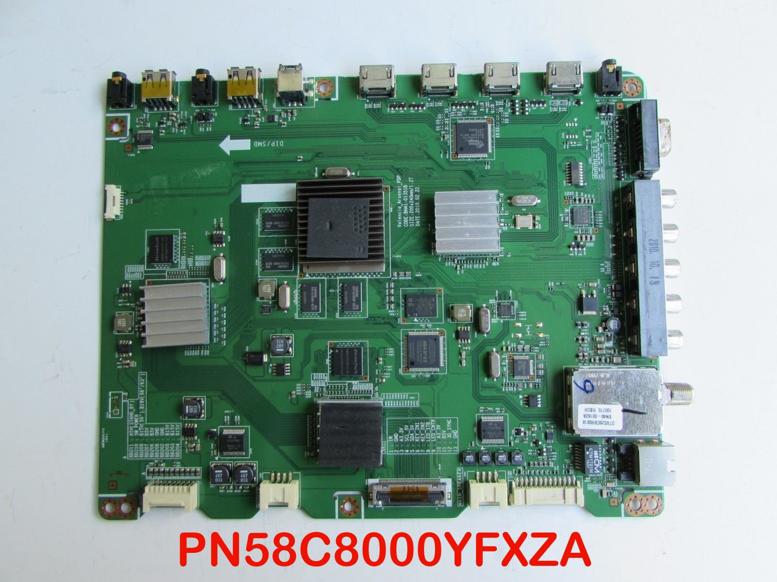

                                    OK Just was re-checking the Main Video board..
                                    While connectors and component placement is identical, this board is for a PN58C8000YFXZA and I have the PN50C7000....
                                    Could that be the issue???

                                      This is a main board for C8000 series,i didn't find any info on this 58 inch model,but they probably communicate differently with the logic board.
                                      I'm not an expert and you're in need of one,I've had a PL63C7000 with a PL50C7000 main and it worked fine.
                                      For now use your original main.
