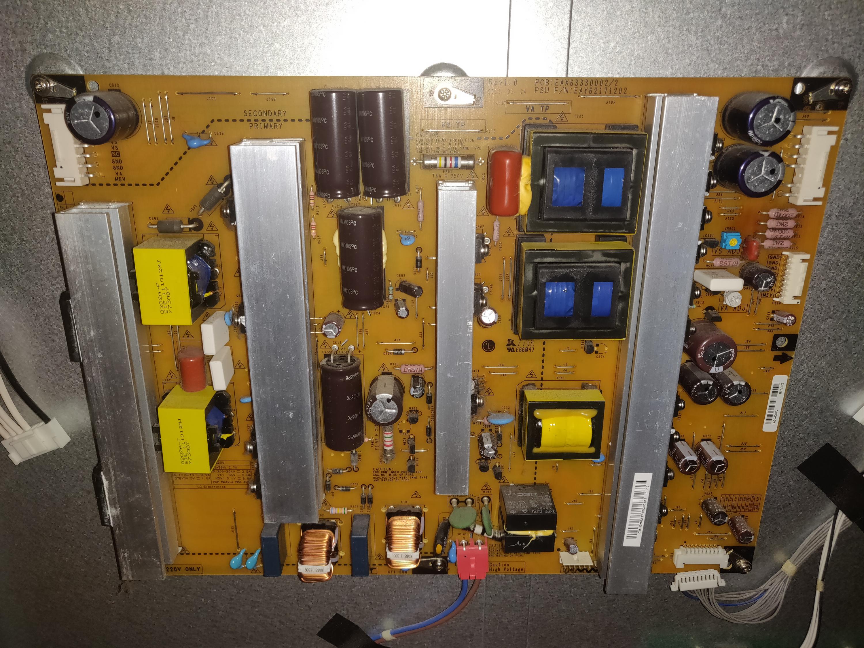

          Could we at least get photos to see what we are dealing with? I suspect this is why you aren't getting responses. I would need to see a clear focused close up of the PSU and all its connectors so I can read the pin labels. Thanks.

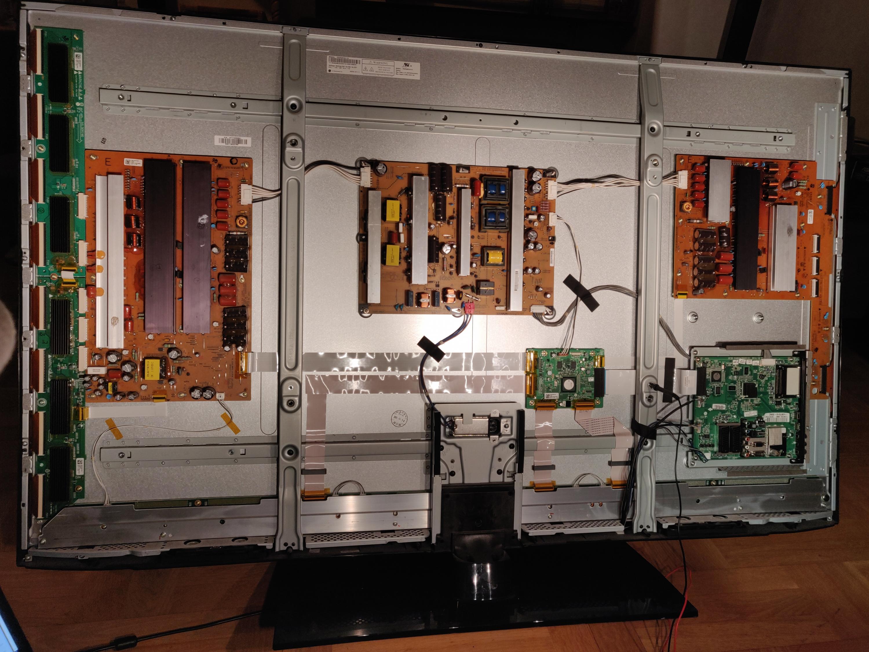

            Post a picture of the Asus board. Top and bottom. Make sure your model number is correct.
            DO NOT RUN THE SET WITH ANY MOUNTING SCREWS REMOVED !!!!

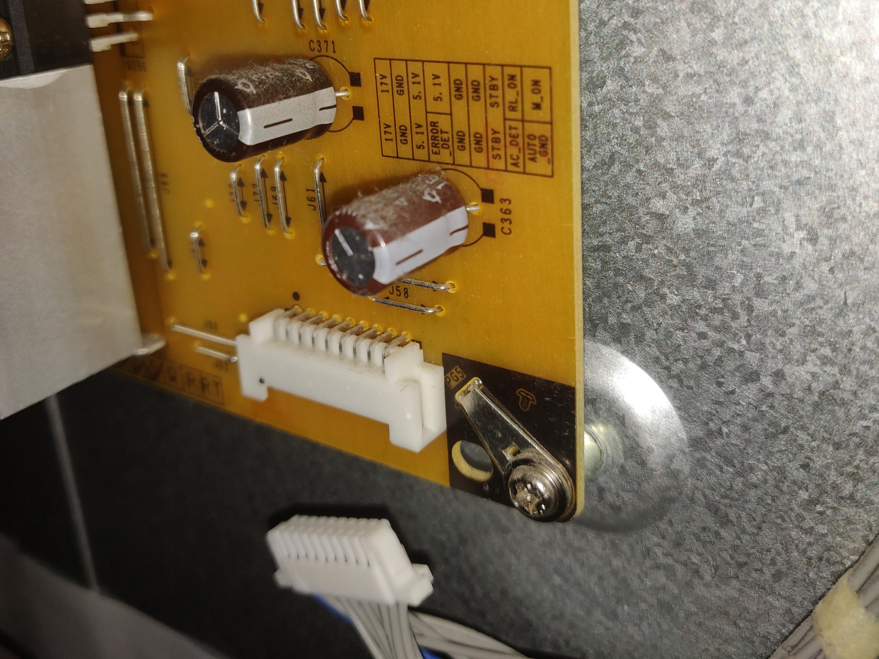

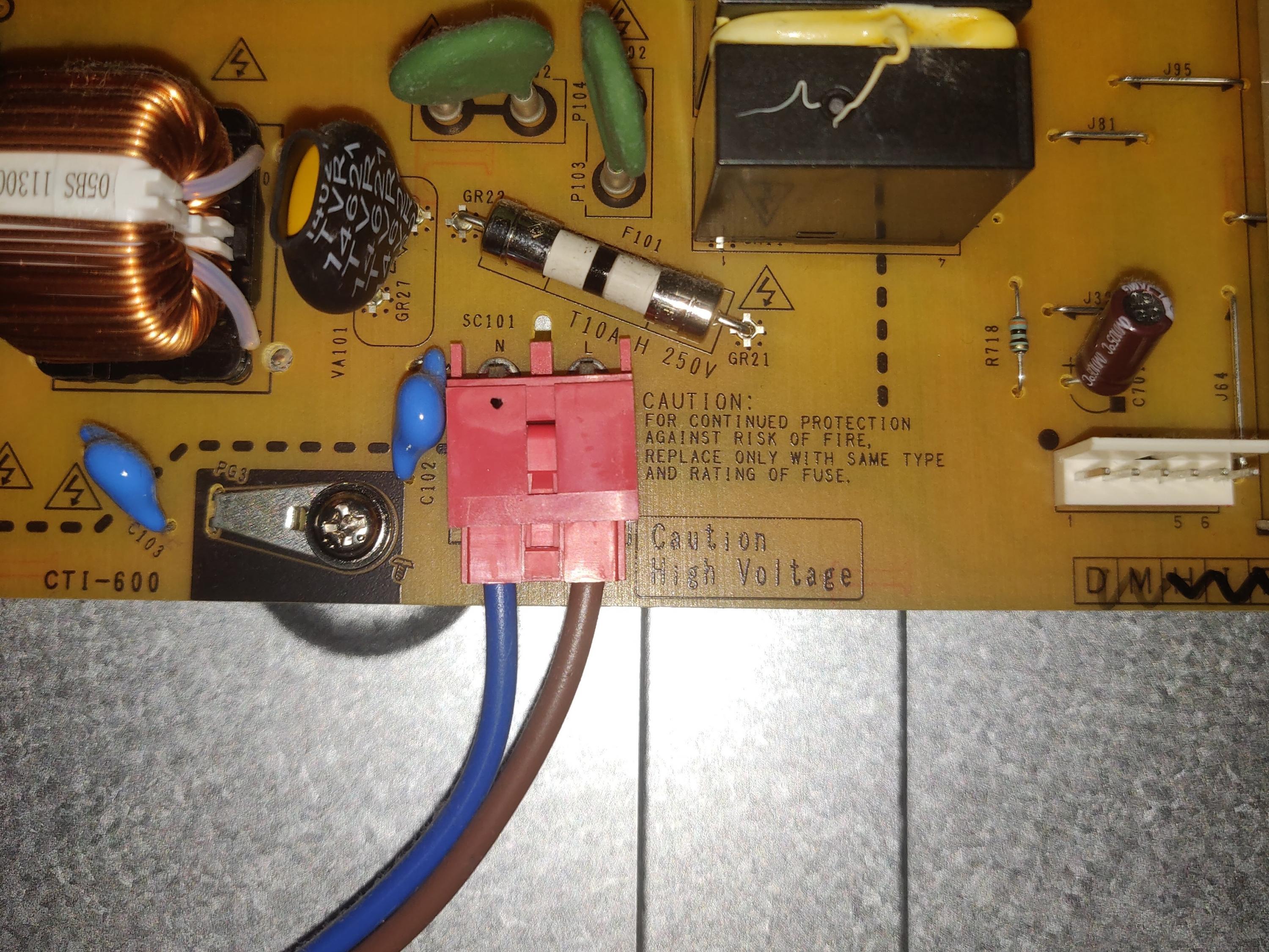

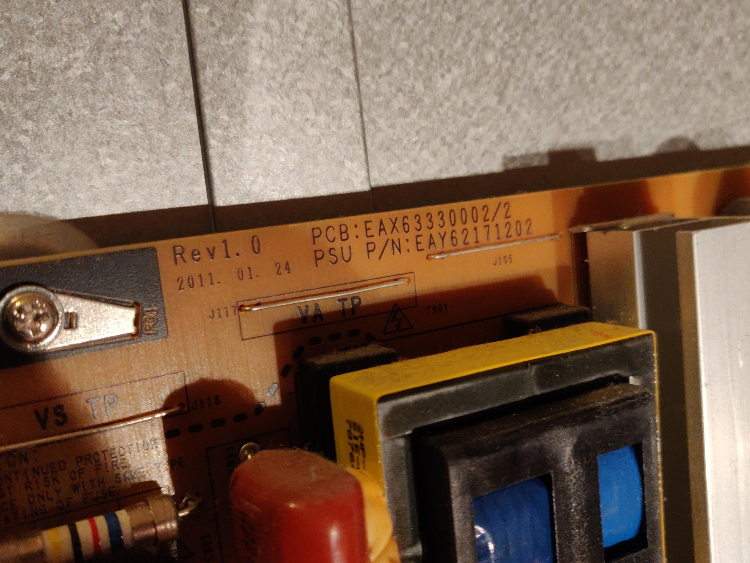

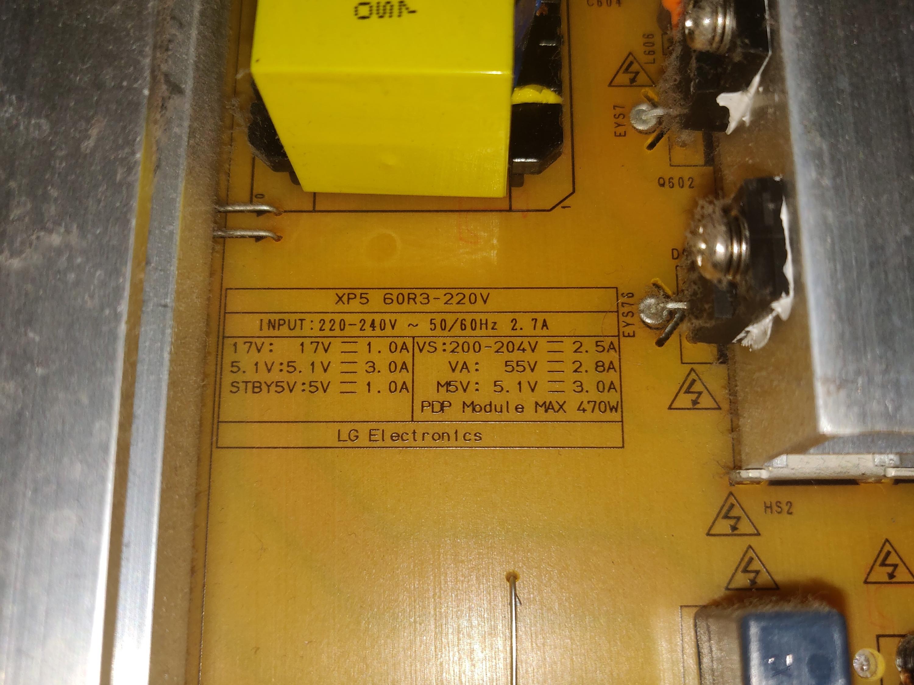

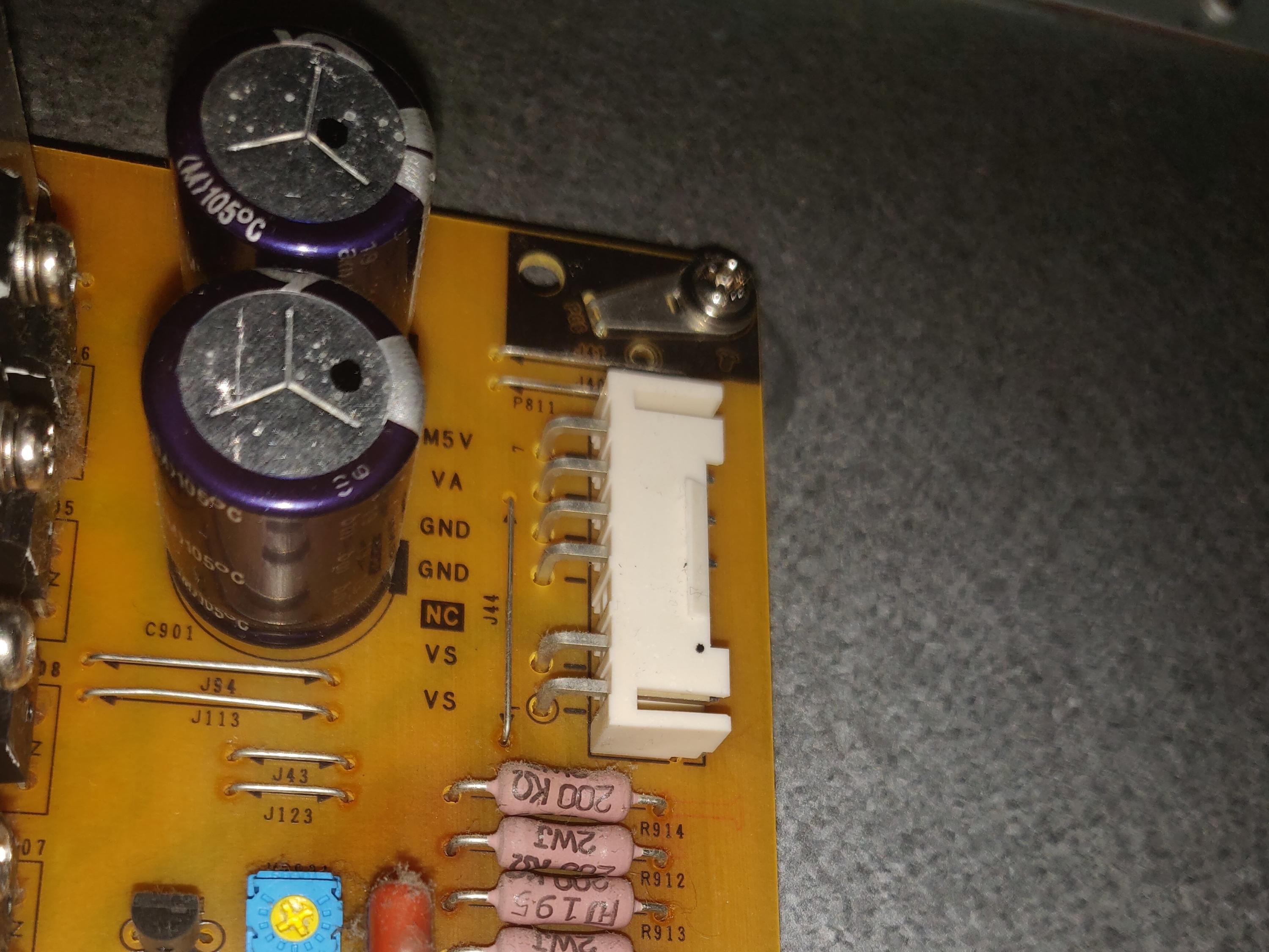

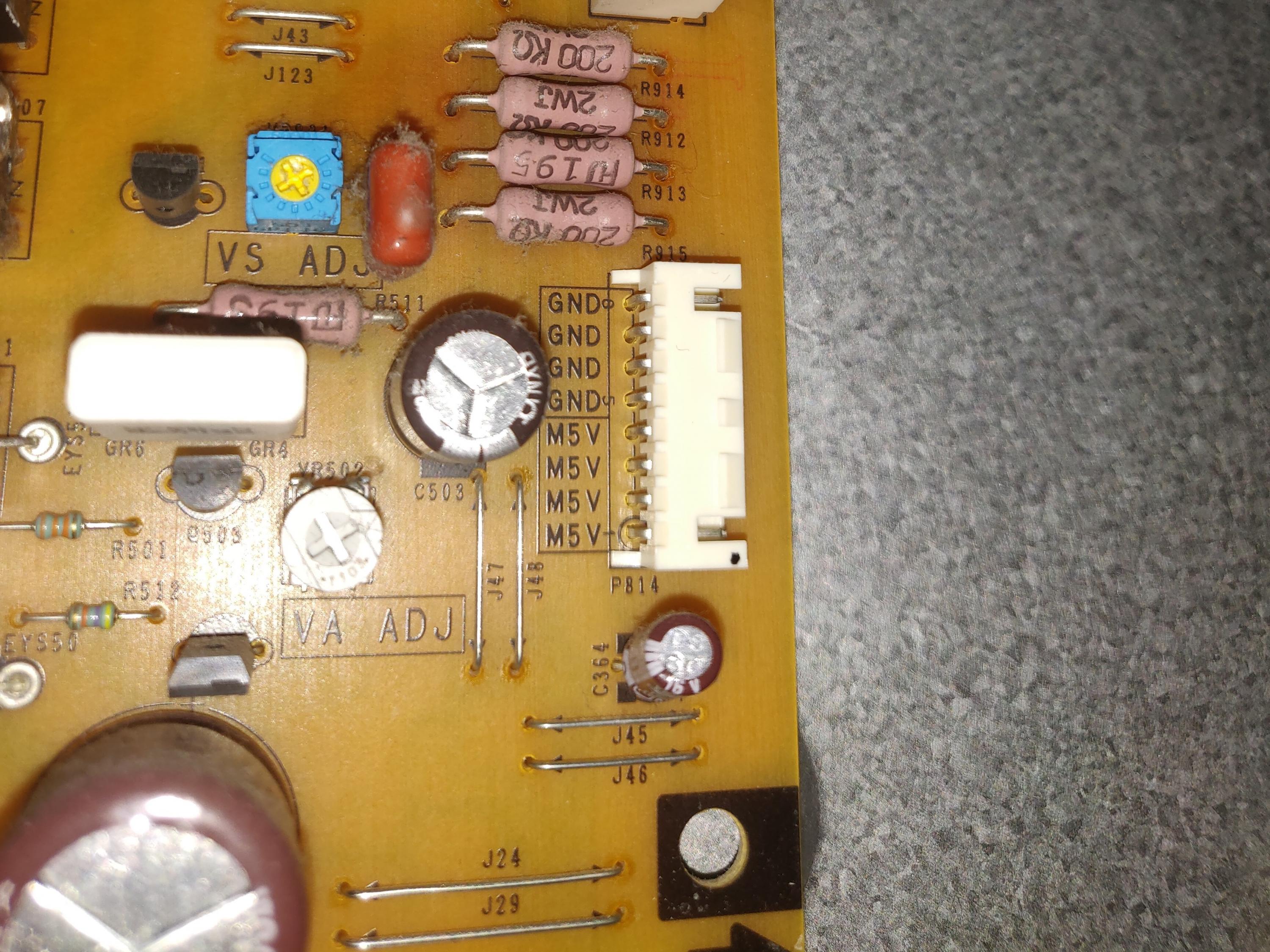

              Here are some photos of the PSU and connectors along with an overview shot of all the boards.
              I'm not sure which is the Asus board. I only see the Ysus and Zsus boards.
              Thanks for the response!
              Edit: Sorry about the flipped images. They're cropped and fixed now.

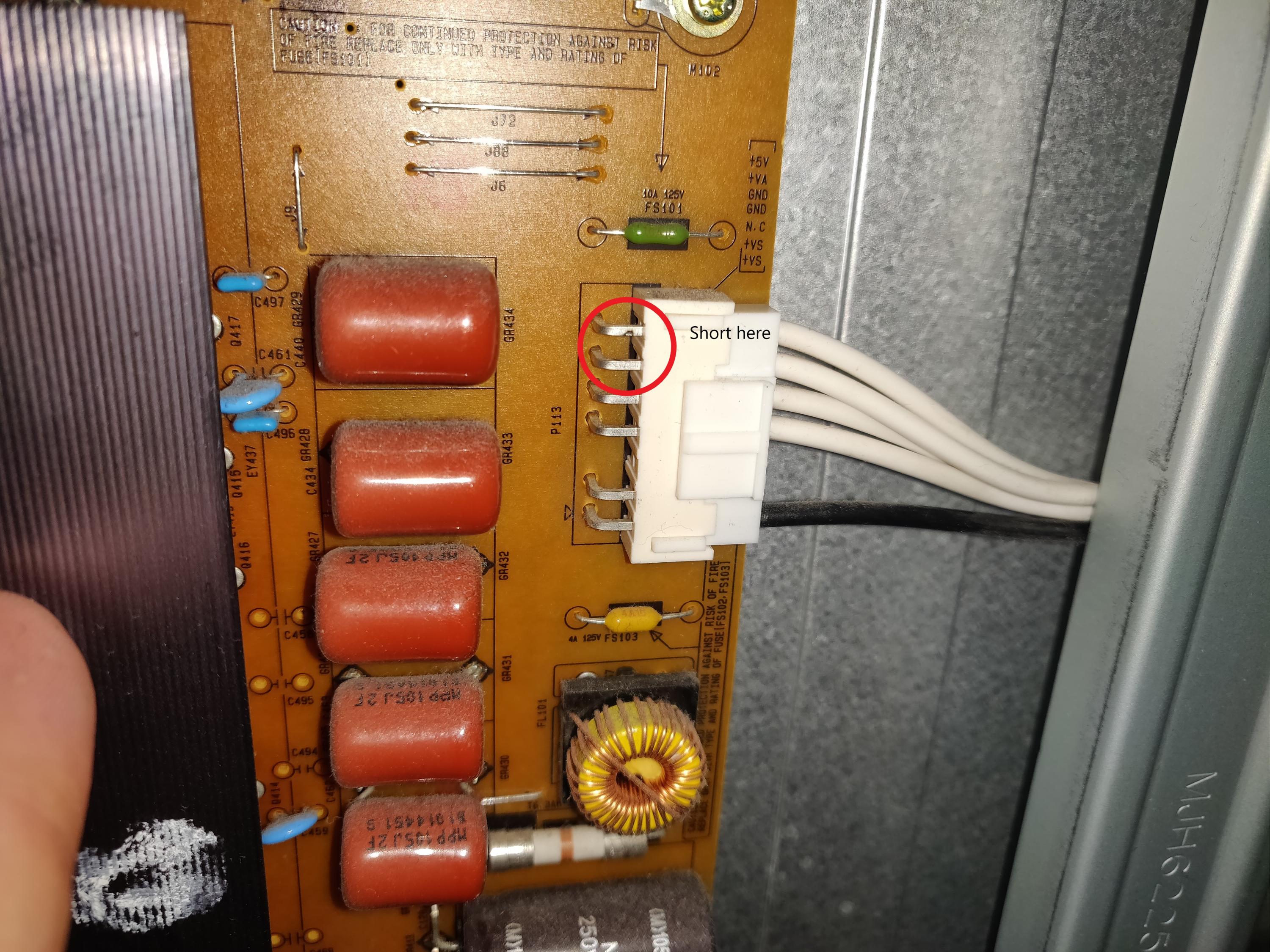

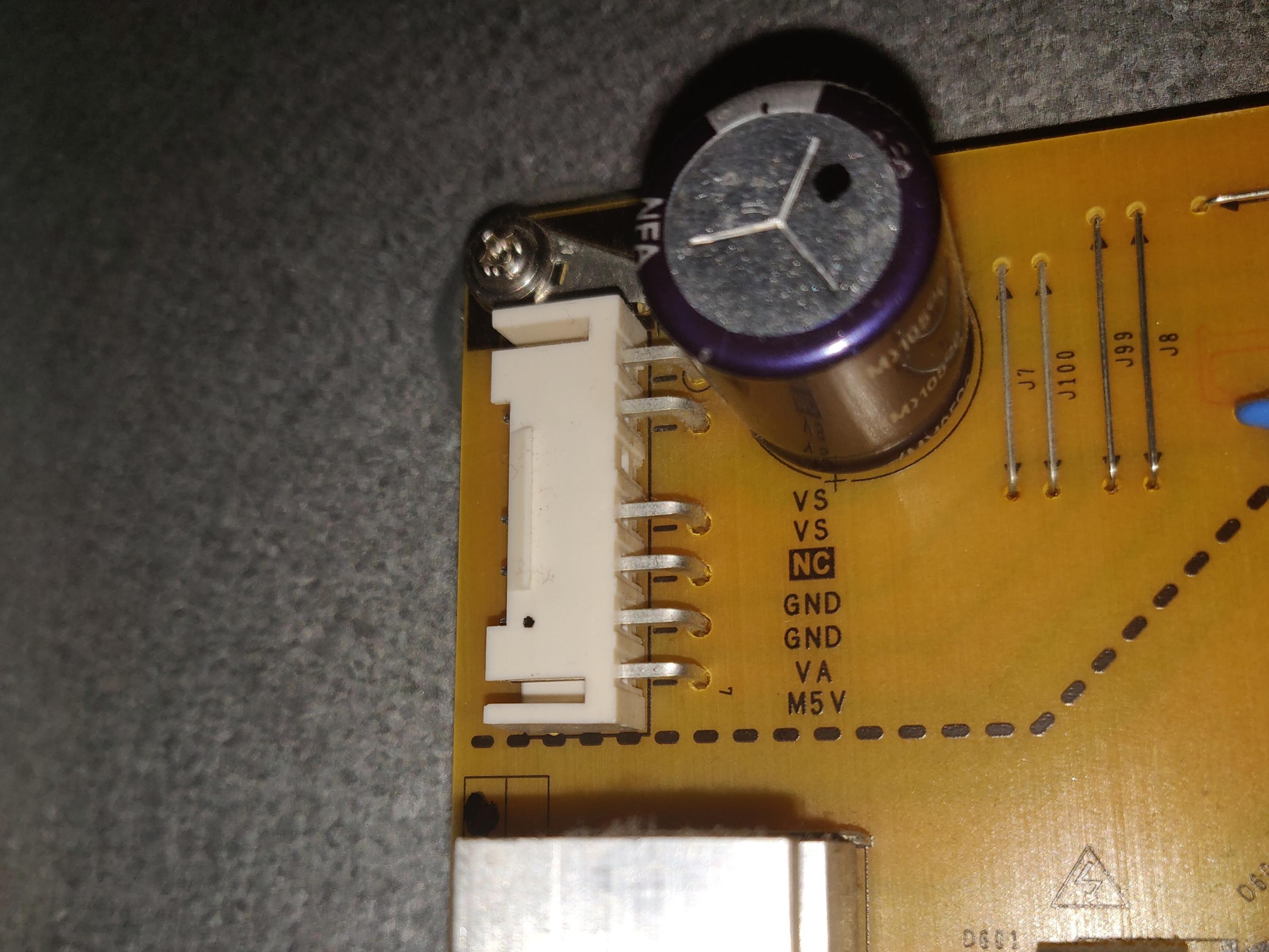

                      Here is an image of the panel voltage label and one of where the short occured on the Ysus bd.

                          If you shorted Va55 volts to M5volts you damaged the power supply M5 volt circuit. What voltage do you have on M5 now? is it 0?
                          Check the voltage on J54 of the power supply, It should be 5 to 6 volts
                          If it is zero volts, check Q353 and the zener diode next to it.
                          Chck F302 fuse on the power supply

                            I can't find Q353, and I can't find a schematic for my board in order to locate it. Could you highlight on the board where I might find it?
                            I searched for zener diodes to help me locate Q353 to no avail.
                            Only ZD101 and Q101 were next to each other, and ZD101 is the only zener diode I can find.

                                Do you have the M5 voltage at the plug where you shorted the M5v to Va?
                                Are you sure you shorted Va to M5 or was it Va shorted to ground (the other pin next to Va)
                                If there is no regulation on the Vs or Va, check the components around the adjustment controls, likely either an open resistor like R515 (white ceramic) or the control. or a shorted transistor or diode.
                                I don't have a schematic only the picture of the board.
                                    Yes, I am sure. I shorted the M5 with Va using my positive test lead of my DMM.
                                    I'm quite sure the negative lead was grounded as I was testing voltages.
