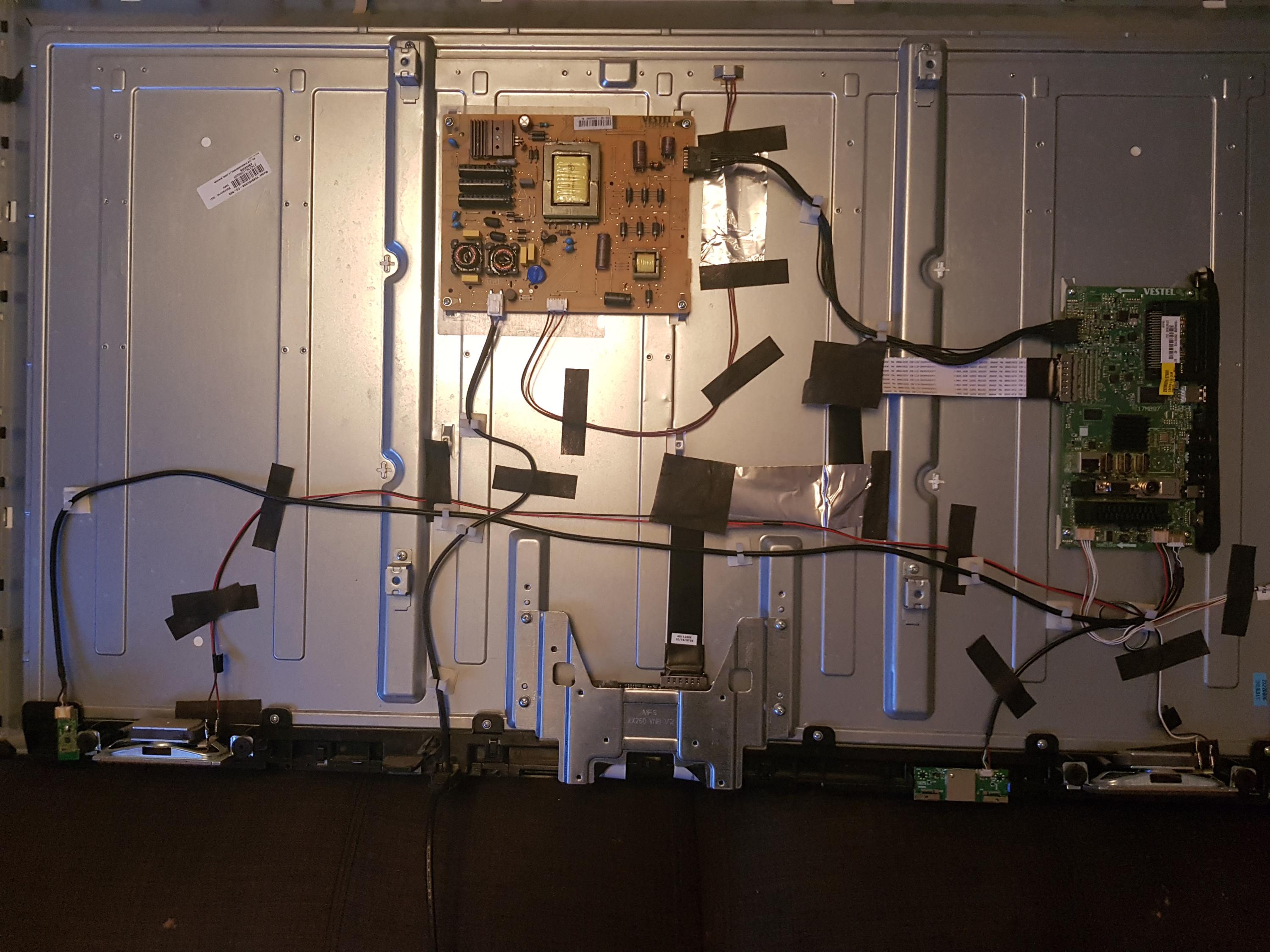

    Have a 50" Celsus, TV powers on, screen illuminates ok, has sound, but no display, tried using menu etc and still no display.
  • Bloopeta
    • Jun 2018
    • 526
    • United Kingdom
    Re: Celsus DLED50272FHDCNTD no picture
    If I unplug the LVDS cable from main board to Tcon, the screen doesnt change at all
    Here is a pic of the board set up
    Am I looking at needing a new main board??
    Any advice greatly appreciated.

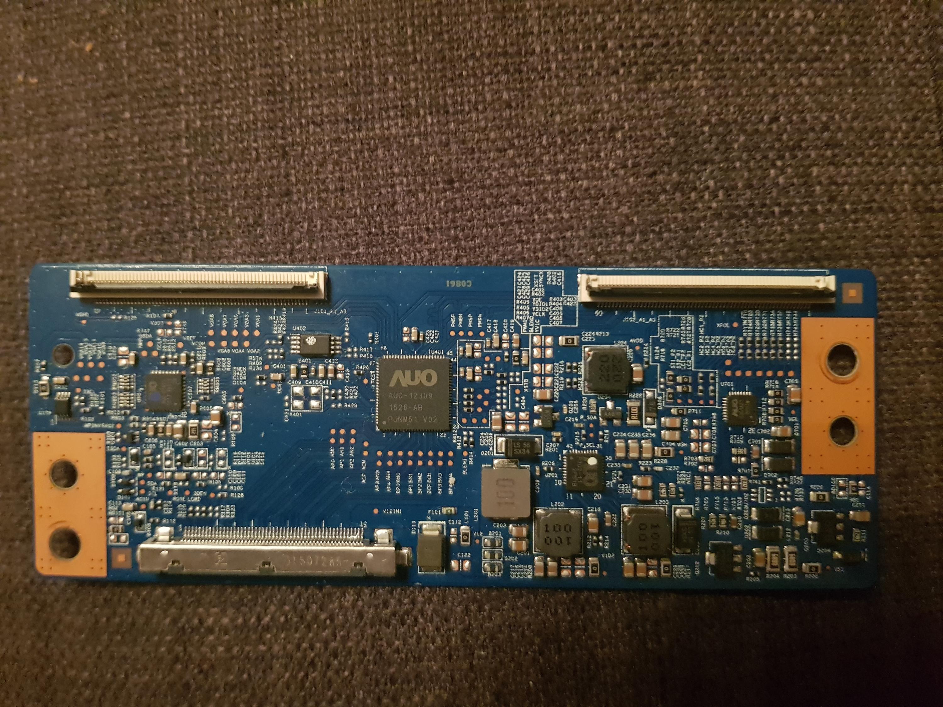

      on the tcon board look for the fuse and check the voltage on both sides of it

        Which one is the fuse please?
          bottom long connector too the right theres a diode d111? the fuse is above it f101? hard too zoom in on your picture as goes out of focus
              Hi, thanks for your help, I get 13v both sides
                on the top of the tcon there are two small ribbon cables if you remove one end of one cable and turn tv on what do you see on the screen? reconnect that cable and try it with the second one
                  No change m8, same with either removed, blank illuminated screen
                    im running out of ideas one last test i can think of is on the tcon board you will see some round gold colored test pads with writing by the sides of them start with the ones that start with a letter v test the voltage and let us know what the pcb marking is IE VIN IN 12V VGA 1 12V ETC ETC
                        Not sure if you need all these but lol
                        V12 12.31
                        V102 1.20
                        VGH 0.18
                        X529 2.11
                        V55 0.03
                        V12IN1 12.32
                        VGA1 0.08
                        VGA2 0.12
                        VGA3 0.13
                        VGA4 0.12
                        VGA5 0.13
                        VGA6 0.13
                        VGA7 0.10
                        VGA8 0.10
                        VGA9 0.01
                        VGA10 0.01
                        VGA11 0.01
                        VGA12 0.01
                        VGA13 0.01
                        VGA14 0.01
                        WP INV R602 1.04
                        AP0 1.07 AN0 1.32
                        AP1 1.07 AN1 1.34
                        AP2 1.10 AN2 1.28
                        AP3 1.11 AN3 1.28
                        AP4 0 AN4 0
                        ACP 1.19 ACN 1.16
                        BP0 1.07 BN0 1.34
                        BP1 1.07 BN1 1.33
                        BP2 1.09 BN2 1.29
                        BCP 1.21 BCN 1.17
                        PM5P 0
                        PM8N 0
                        PM9P 0
                        PM9N 0
                        Ducky29 has suggested the firmware has gone bad? Anyone comfirm this please?
                          Did you also check if any component in the TCON is hot?
                          Or use a hdmi and check if you have any sound. If you do have sound but no picture then TCON(most likely) /mainboard is bad.
                          If you don't have sound then you have a firmware problem.
                              Looking at the voltages i would try another tcon board just use a seller that has returns policy if faulty on arrival
                                      The new T-CON Bd will fix your problem. Though there is 13V on both ends of the fuse, there are on the T-CON generated voltages that are missing due to one of the ICs producing HVDD, etc is not working.
