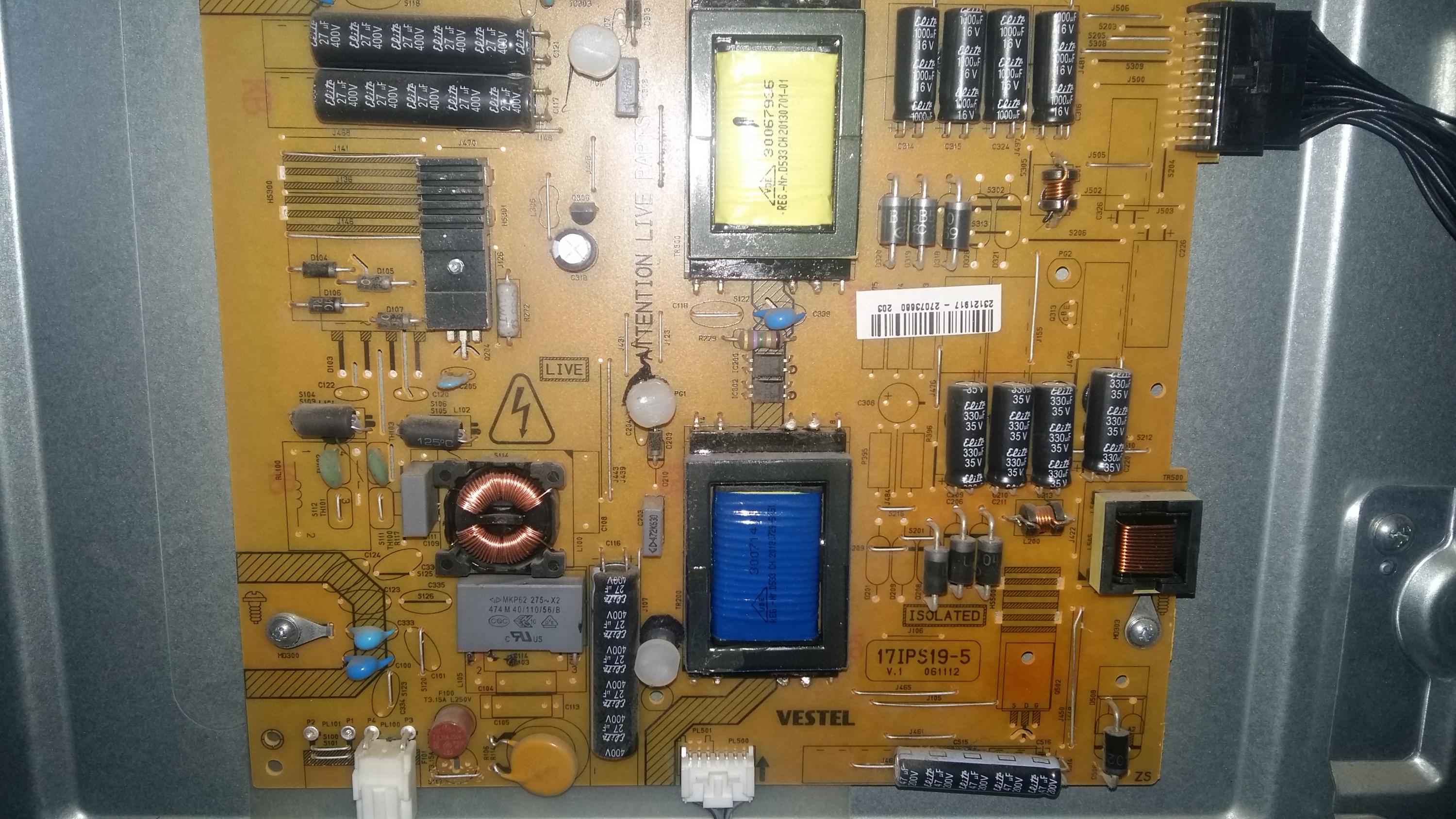

    Hi all. Hope somebody can help. Just bought this tv and the issue is the screen lights up but nothing on screen red light stays blinking then tv turns of then back on but still no picture. Screen lights up as it should it's just blank. Cycle just keeps repeating on off on off. All advice is greatly received. Thanks.

    Re: Lux0140001b/01 no picture
    Hope pics are ok

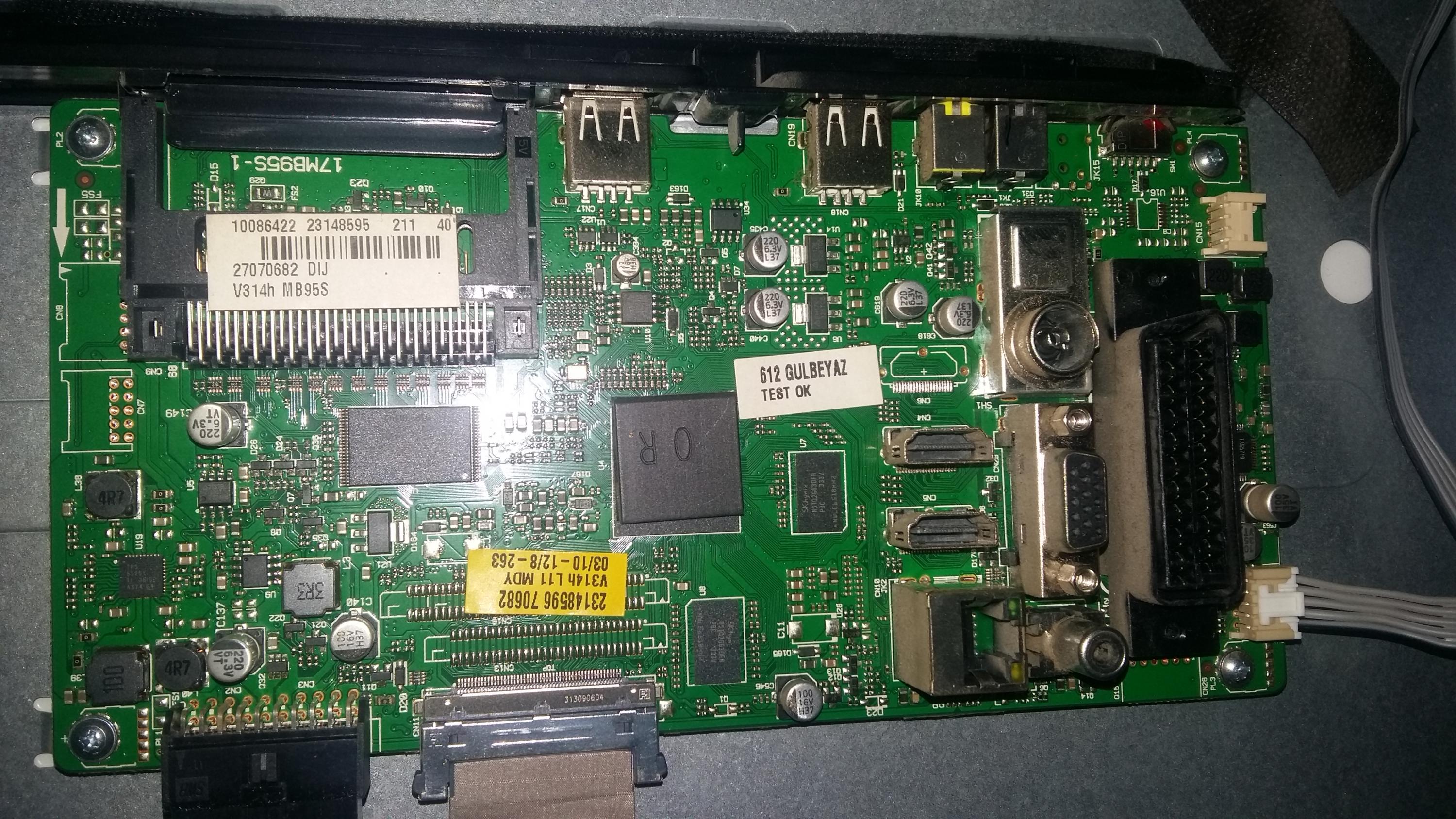

      This might be a firmware issue. Do you have a programmer?
        I don't have one I'm afraid. Is there anything else I could do. The lady I had it off said it started only turning on sometimes to now no picture at all.
          Replace motherboard, with correct one suited for that screen.
