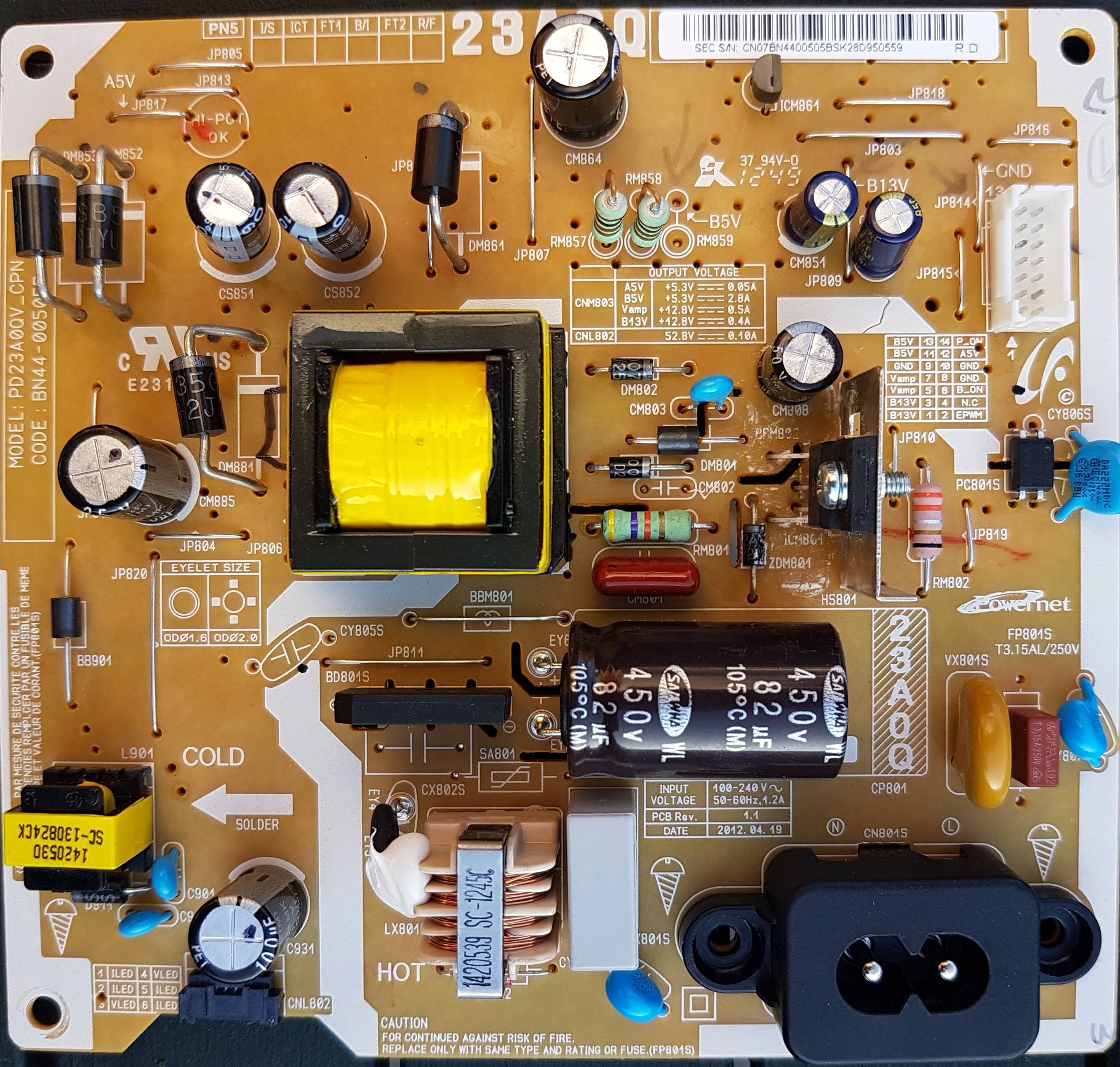

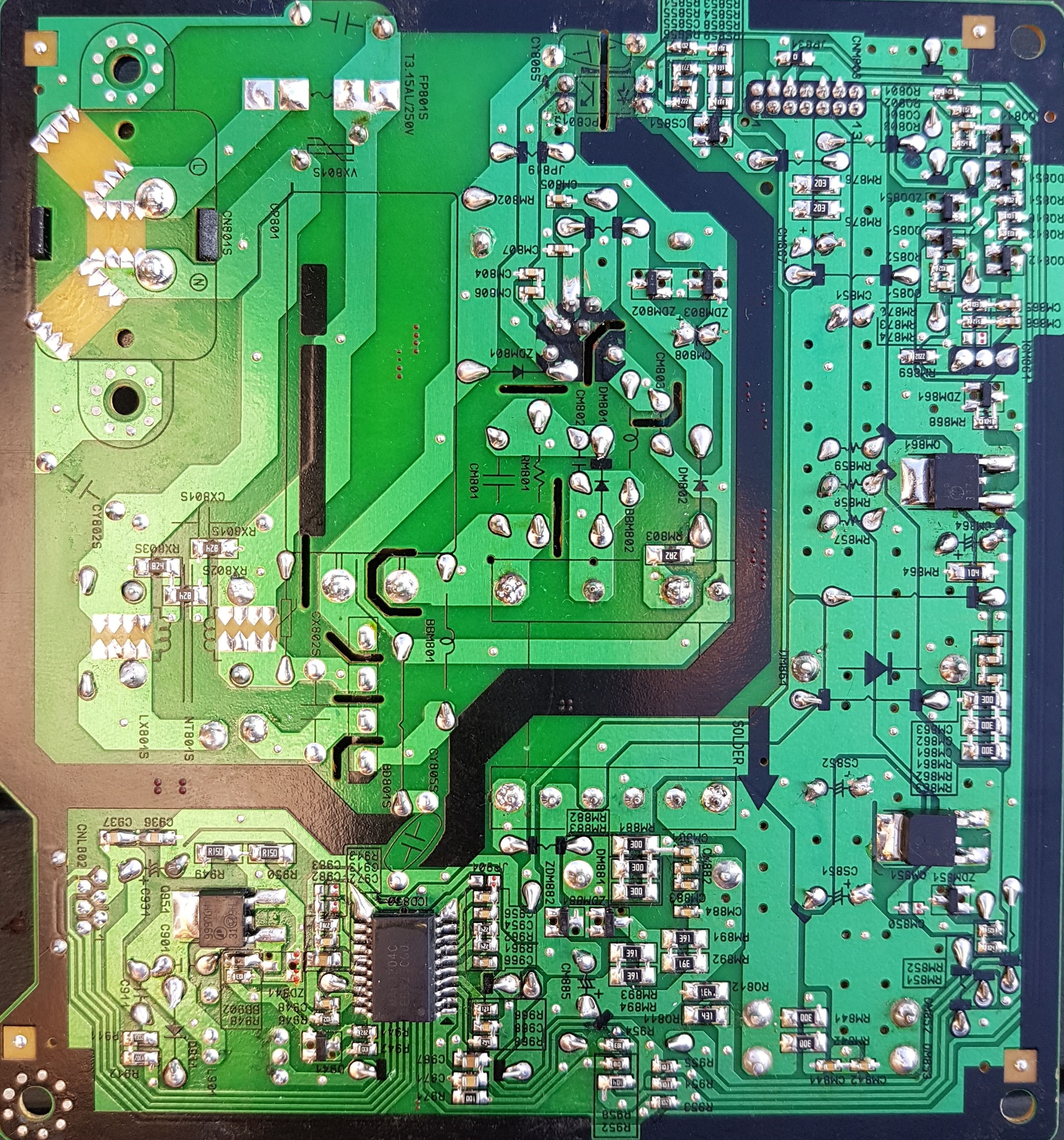

    Hi, I have limited knowledge of electronics and have no access to an oscilloscope. I am trying to fix my samsung tv, and would really appreciate any help I can get.
    So the board I am having trouble with is the BN44-00505B Power board. I have between 1.8 to 2.3 volts at the 5v reference points. I have detected and changed a faulty diode (DM861). I have also replaced any bad capacitors and the IC (ice3br1065jf). I am getting 330v from the rectifier. The output header pins are as follows:
    1-B13v
    2-EPWM
    3-B13v
    4-NC
    5-VAMP
    6-B-ON
    7-VAMP
    8-GND
    9-GND
    10-GND
    11-B5V
    12-A5V 1.8 TO 2.3
    13-B5V
    14-P-ON
    I am not getting any voltages from the pins except pin 12
    The chip on the back is a MAP3204C which I think is a LED driver.
    Any help would be very much appreciated.
    Alan.

                  I have checked the 3 mosfets on back of the board. I am confused by the small 3 pin packages marked ZDM, Q and QQ.

                      Re: Samsung UE22ES5000 Led tv no standby
                      Did you replace CM808 capacitor?
                      What number diode did you use to replace DM861?
                      Check that QM861 is not shorted
                      Also what is the voltage measured at the cathode of DM861

                            Originally posted by budm
                            What dc Voltage do you get if you measure between cold side circuit ground and the Cathode of DM861, 852, 881?
                            DM861 5.4 to 6v
                            DM852 1.6 to 2.3v
                            DM881 9.1 to 9.4v

                                    The voltage I wanted you to check with DM861 removed was the A5V (cathode of DM852) By removing DM861, that will eliminate anything after that diode, so the A5v should come up. If it does'nt there could also be a high load on one of the other secondary lines or the primary side is not operating properly.
                                    have you checked RM803, DM802, ZDM803 & ZDM802? Also check JP831 0Ω near the cnm803 plug
                                      So checked the voltage with diode removed and it is stable at 5.22v.
                                      0 ohm across the resistor jp831
                                      all components seemed to check out ok. I assume ZDM803 and 802 are a zener diode?
                                      Thank you for taking the time with this.

                                        Those zeners are likely ok, if the A5V standby is working with DM861 removed, then I suspect there is something loading the circuit After the DM861.
                                        What is the resistance measured across CM864 and CM867?
