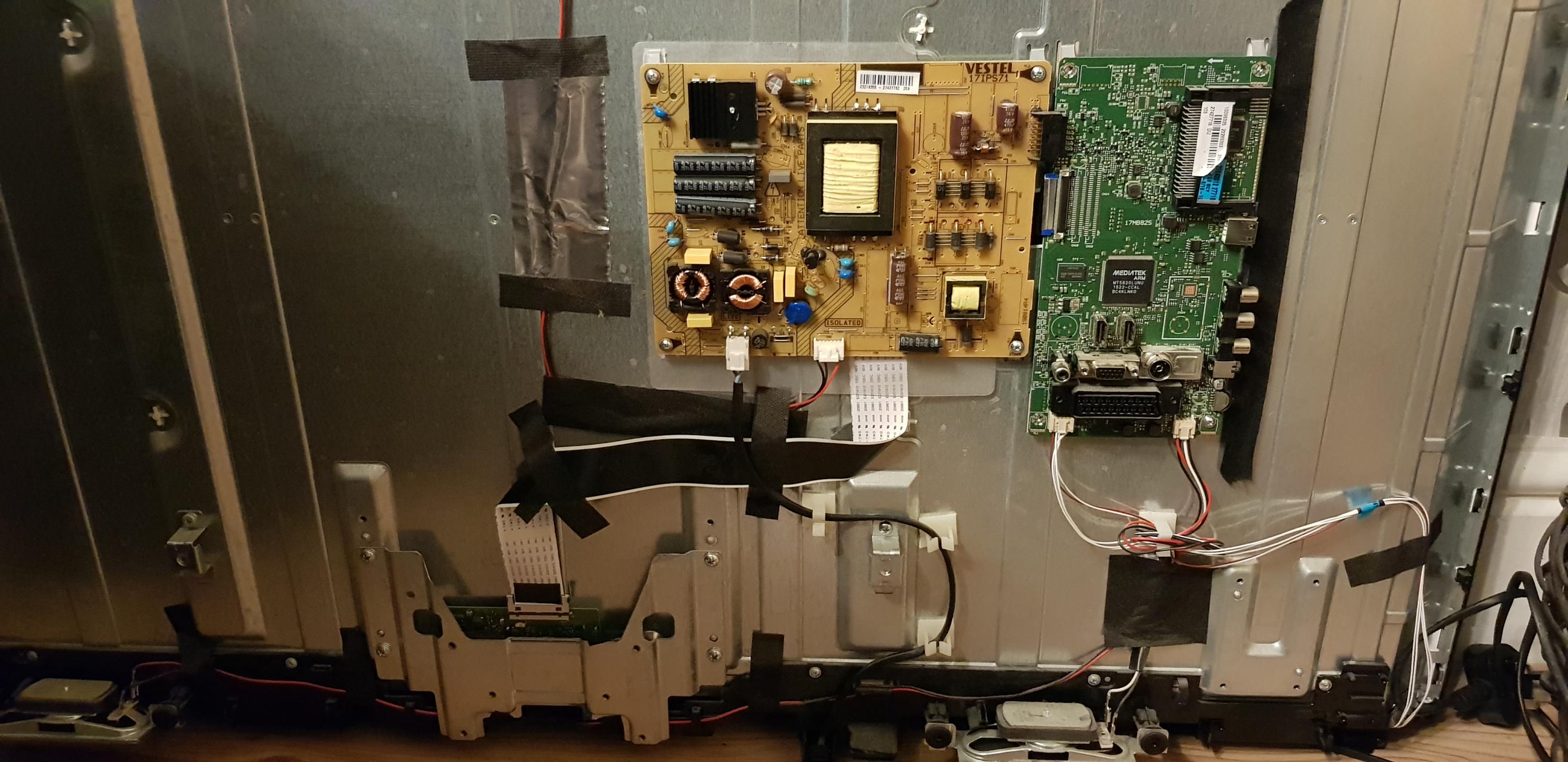

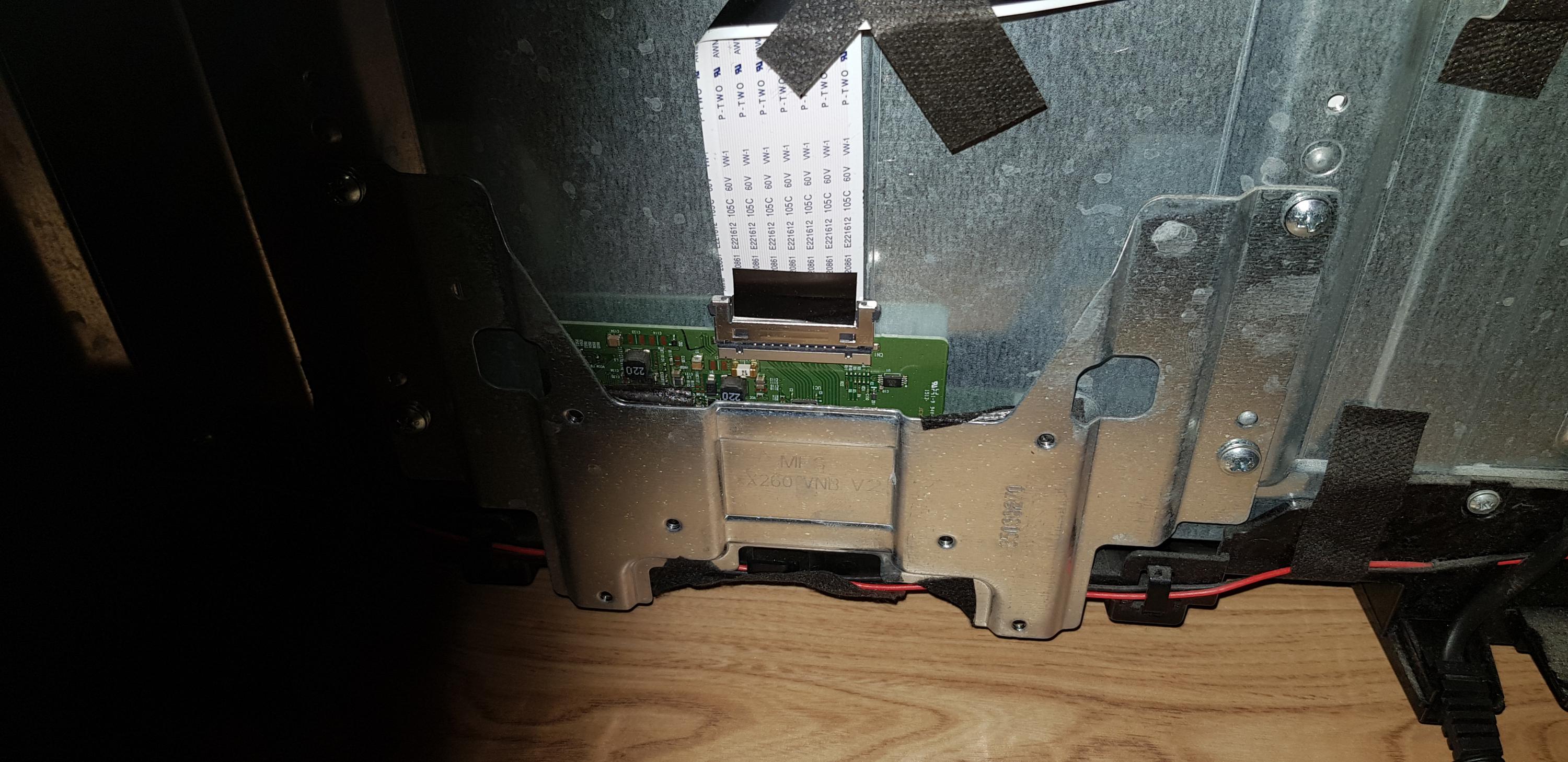

    There are 3 boards on the back. Power board, av main board and at the bottom left I think is the t con board. The wires heading to the bottom right is for the remote sensor and standby light. Plus 2 speakers. Are the voltages ok in previous post?

      thanks for the pictures i have just read another thread and the voltages seem too match yours so yes i think you do have a faulty mainboard .

        Ok thanks for the info. I will order the main board and get back to u if it works.

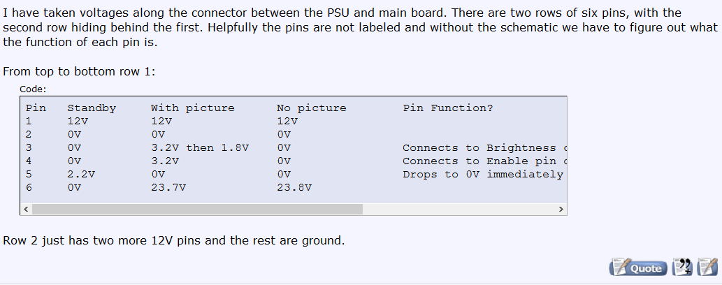

            can you retest the voltages on cn4 connector test the outer row of pins 3,5,7,9,11 all boards connected tv switched on multi meter dc volts black probe tv chassis if you still have you old power supply maybe test both supplies.

              Ok i will re check both boards later after work.

                Your old power supply should be ok, if both boards read the same voltages you could re sell one of them and get some money back towards the main board or just keep as a spare of course.

                  Sorry for late reply. I've tested with all boards and components connected but power and av board are off the chassis ( I can't test all pins with boards fitted)
                  Following pins have voltage only the rest are zero v
                  Pin 14 12v
                  Pin 12 12v
                  Pin 10 12v
                  Pin 13 12v
                  Pin 11 12v

                      once the replacement mainboard arrives and is fitted can you update the thread and let us know if its fixed your issue thanks.
