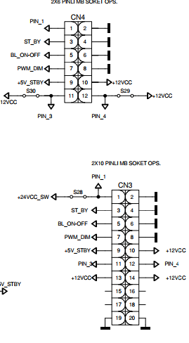

                            Re: Dead digihome tv
                            Ok The confusing part is matching the diagram up ro the connector and the board has no marks to say which pin is which. I can only assume that cn3 diagram matches the 20 pin holes on the board cn3. Am I right reading this diagram refers to looking at the back of the board? Pin 20 top left pin and bottom left pin 2.
                            • Jay morris
                              • Nov 2018
                              • 19
                              • England
                              Ok I've tested the pins with the board off the tv with no av board connected and mains powered.
                              These are the pins with voltage
                              Pin 7 2 or 3 v
                              Pin11 11or 12v
                              Pin 12 11 or 12v
                              Pin 13 11 or 12v
                              Pin 14 11 or 12v
                                usually looking from top of board what i do is too put the red probe tip down the side of each of wire im testing the voltage on going into the connector block, the probe will touch a metal connector on the end of the wire and allow a reading to be taken, Their are also few revisions of the schematics for that psu board number, can you upload a picture of your psu used in your tv thanks.
                                • Jay morris
                                  • Nov 2018
                                  • 19
                                  • England

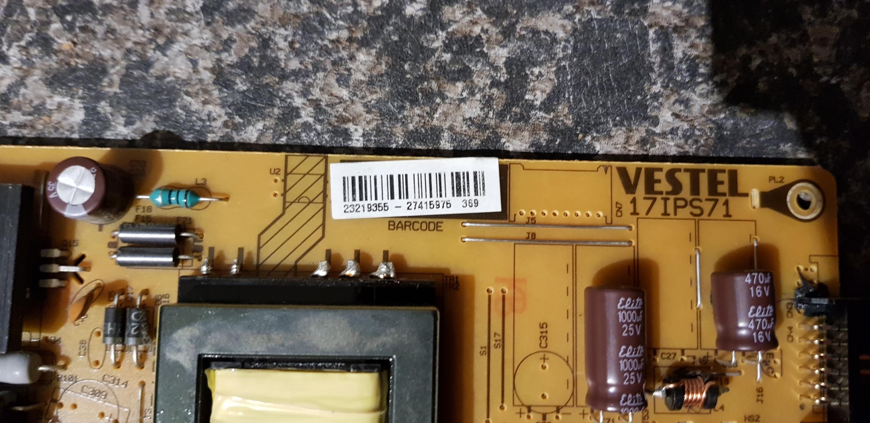

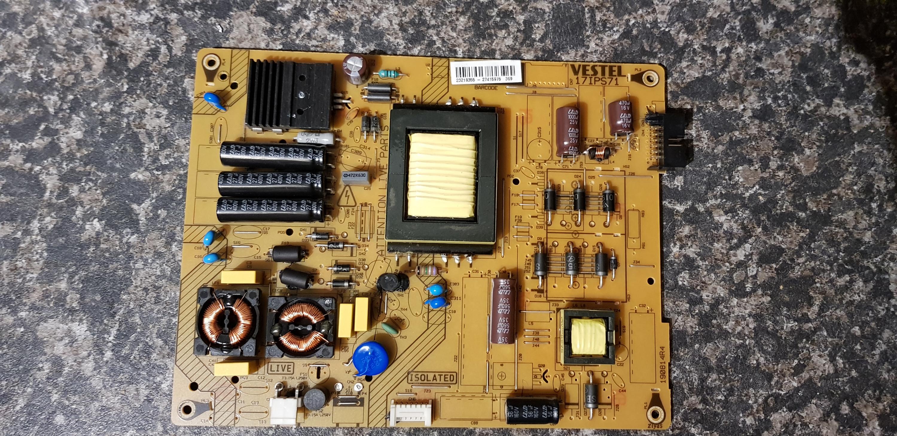

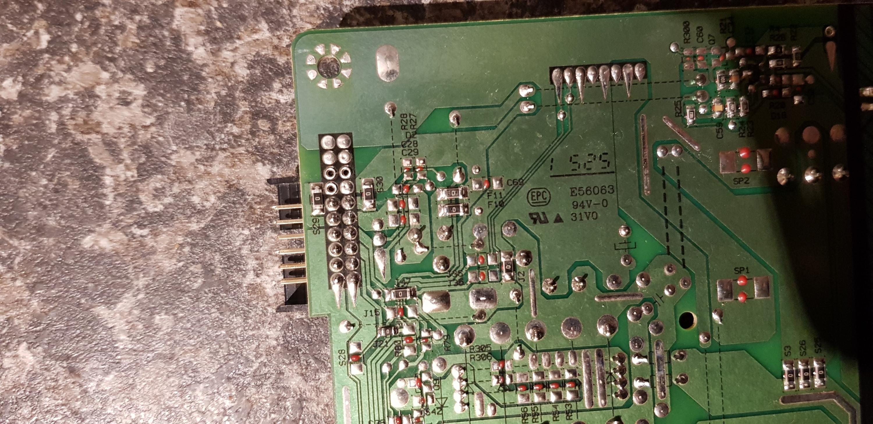

                                  Thanks for reply. I've also included the cn3 connector pins aswell in the pic.
                                  • Jay morris
                                    • Nov 2018
                                    • 19
                                    • England
                                    Pic of The board
                                    • Jay morris
                                      • Nov 2018
                                      • 19
                                      • England
                                      More pics
                                      • vinceroger69
                                        • Mar 2012
                                        • 6714
                                        • uk
                                        side mounted connectors are always a pain too test, maybe easier too test voltages on mainboard end? the bottom center white connector where does that go too? can you post a picture of the back of the tv with all the boards connected together
