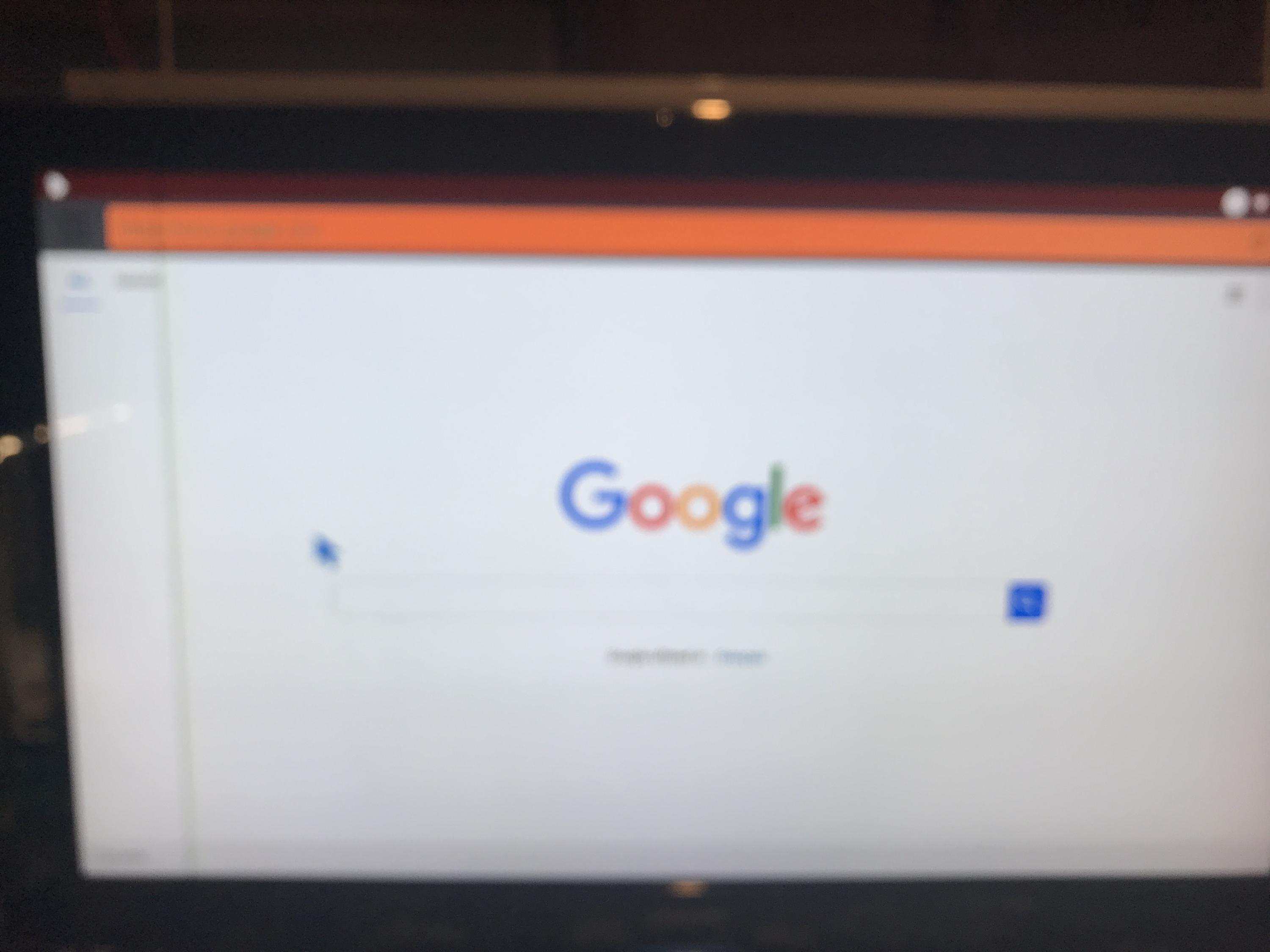

    Hi guys
    I have a Samsung 52" TV with a vertical Color Line from Top to Bottom. It looks like rainbow colours starting from the right with Yellow ending with blue or purple on the left.
    Do you have any ideas or is the panel bad. It is such a nice TV, would really like to have it fixed.
    Thank you
    Henry

    Re: Samsung LNT5265FX/XAC Vertical Line
    Bad panel, had several like this. You can try cleaning the ldvs cable on both ends. Maybe you'll get lucky.
      Thank you tvtimmy. I was hoping for a better diagnosis, but that was what I expected. Thanks for your time reading the posting.
          May be able to shim the bad tab bond if that's the problem, youtube has many videos on the subject.
            Example of confirming: https://www.youtube.com/watch?v=vCExlSnG4yY
              Example of shimming, might find some that go into greater detail but it's a pretty simple procedure: https://www.youtube.com/watch?v=8l5ORKjQF5U
