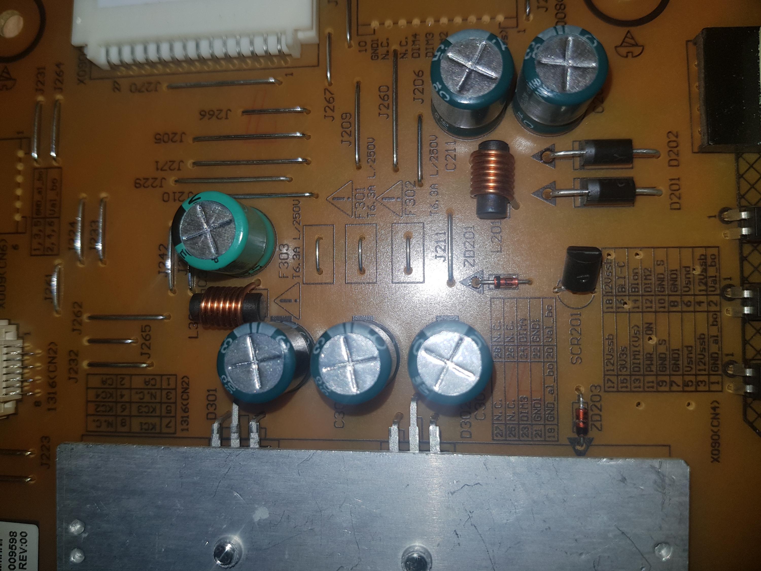

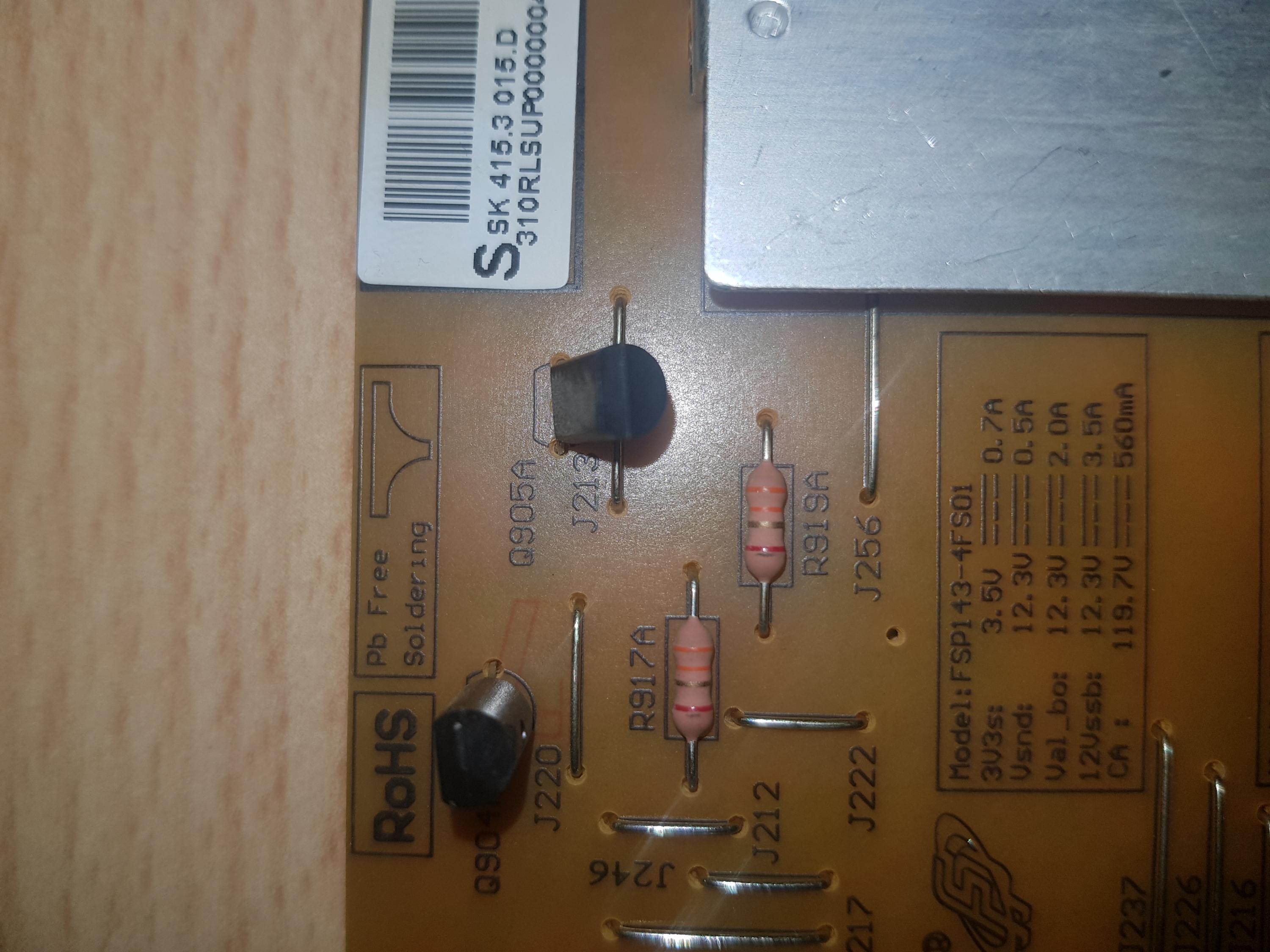

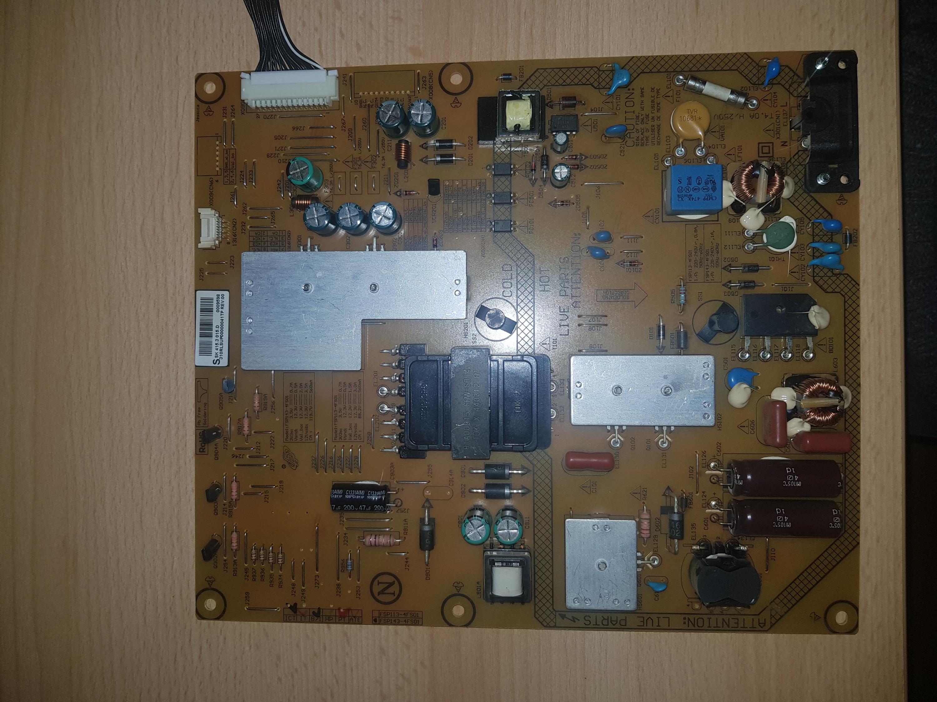

                        its hardware, you need to upload photos on the power board and main board,
                        with this one second you need to read the back light voltage if they are stable or drop down, with the age of tv i first suspect back light always,,
                        logo come for 1 second dosent mean back light okay too,
                        • Alschepmist
                          • Jul 2018
                          • 70
                          Re: Philips 55pfs8159 android tv bootloop
                          Backlight power at board CA should be 119.7volt but at my measurement it jumps 80v to 150v can be capacitor issue ? And thanks for all the reply
