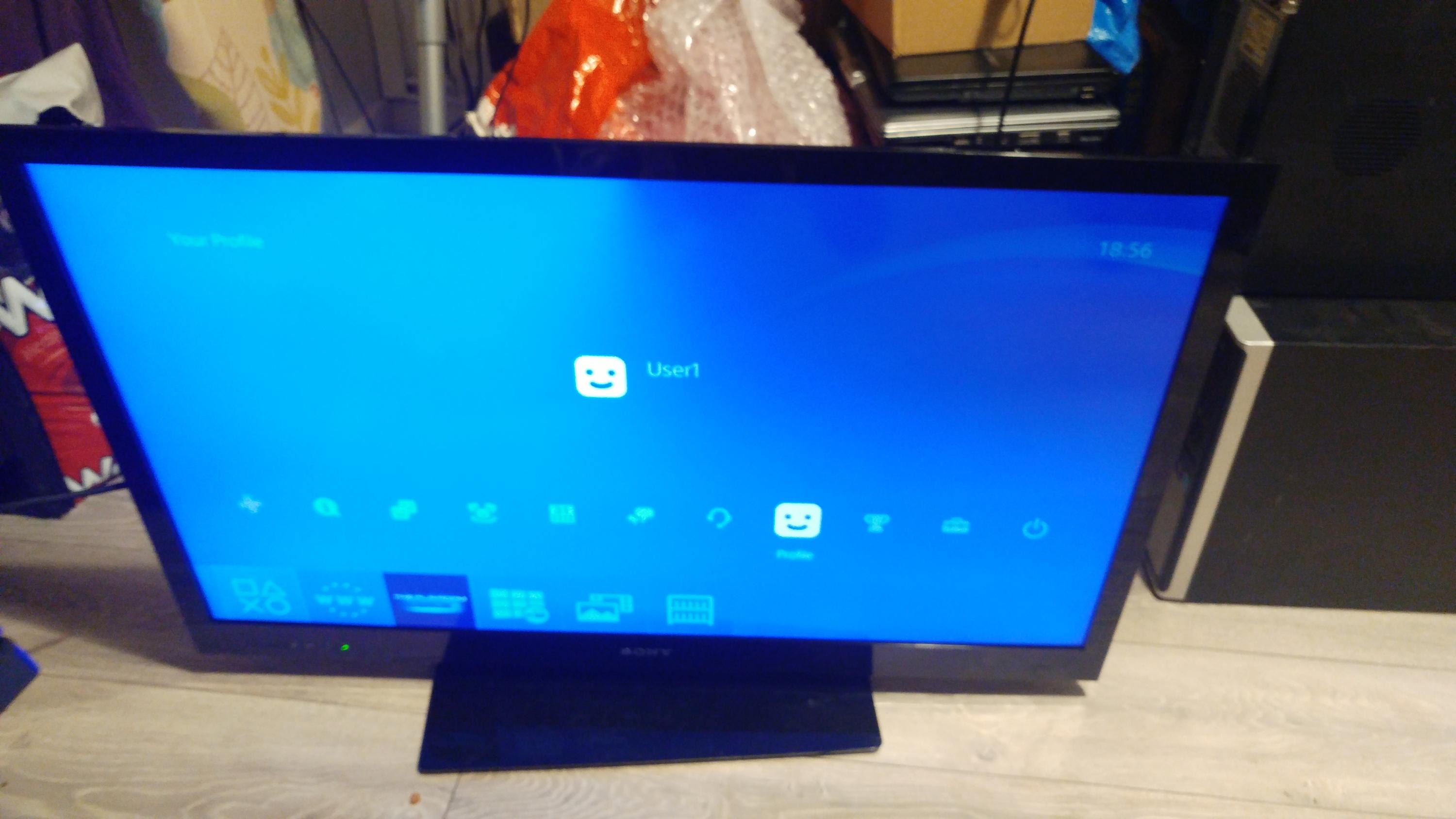

    Anyone able to provide some help with this before I begin taking it apart.
    Basically the top right corner of the screen has became dark, sometimes if you leave it off for a day it'll kick back in but only ever lasts a hour tops.
    Is this just dead/dying leds?

    Bad Backlights. You would have to crack open the Panel and change out the backlights.

      I thought as much, thanks for confirming.
      Are they generic or model specific?
        Re: KDL-40EX723 Dimmer Screen Top Right Corner
        Try turning down backlights to as low as possible but still watchable and see if it will work OK without dimming down in that section for long period of time. If it is OK then I would use it until the LED fail completely.

          Tried that already, its got to the point now were it works when it feels like, sometimes I'll get flickering then nothing othertimes it'll flicker then work for a bit

            Just a bit of a update on this
            Fiddled with the settings a little, set the Eco Power setting to low or high and setting the scene as cinema seems to fix the issue, I went for the low eco power, as I can still adjust the backlight to 5 to prevent flickering and still have half decent brightness.
