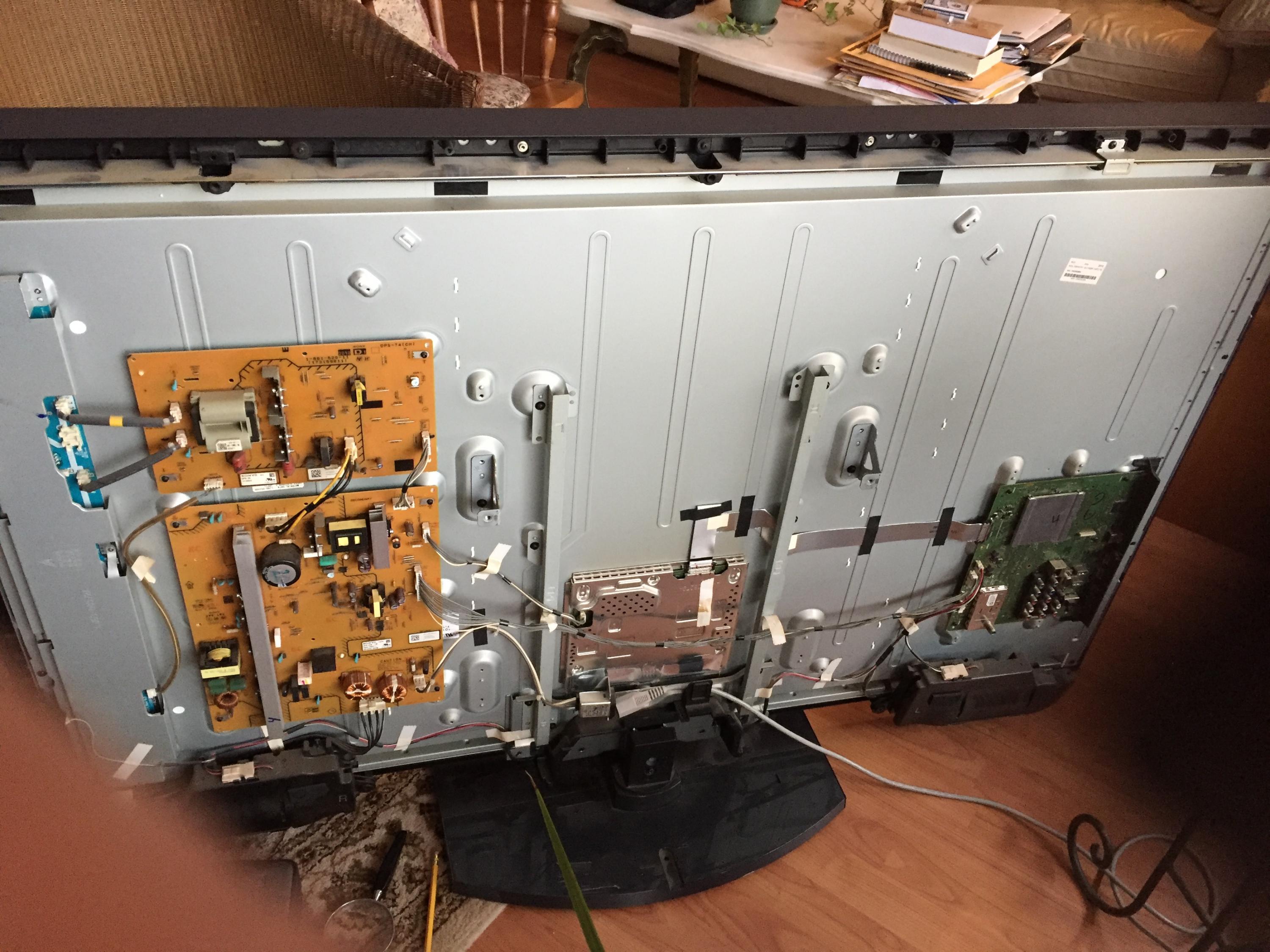

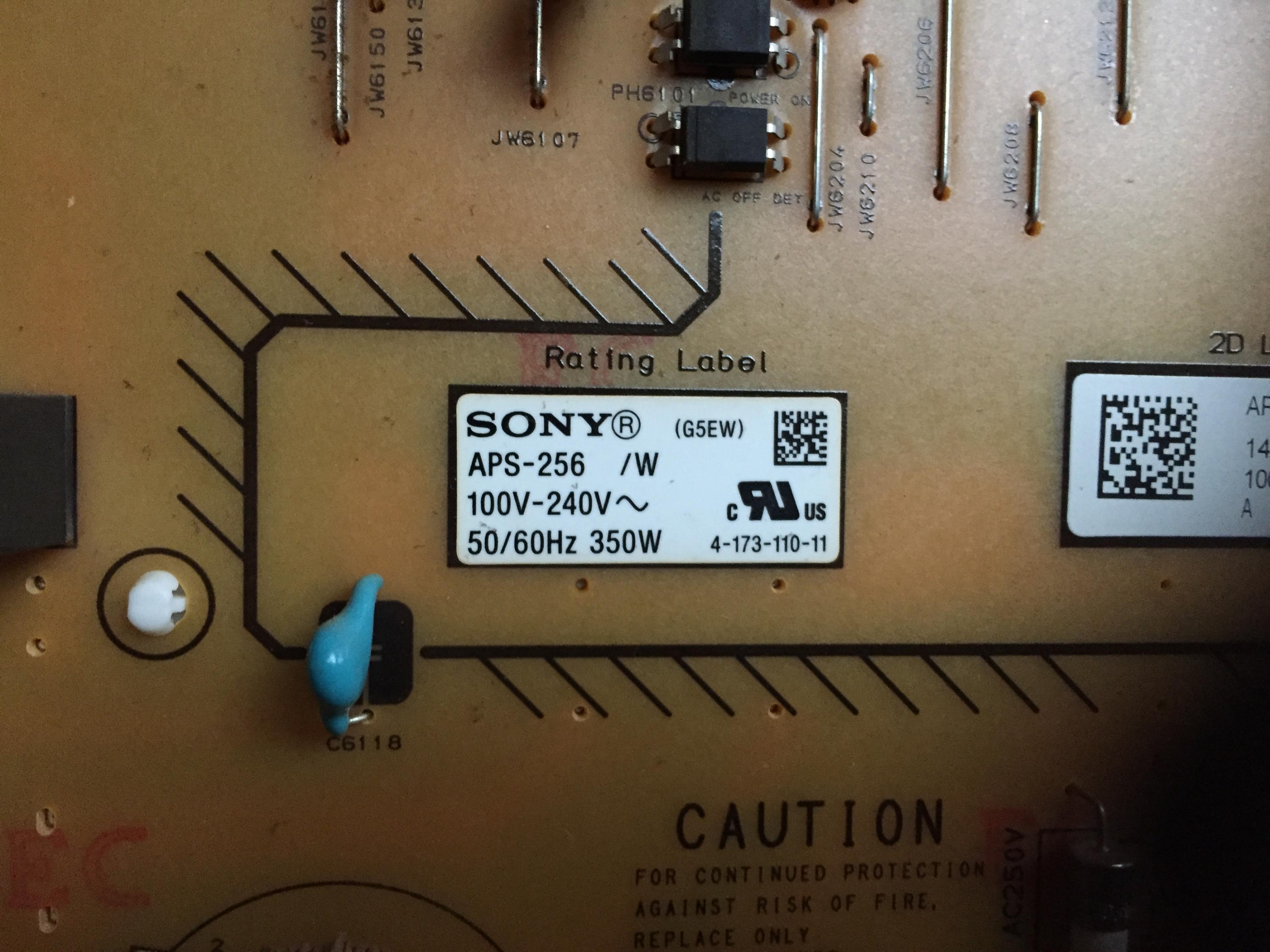

    I am working on a Sony KDL-55HX701 LCD TV
    The TV is displaying a 7 flash fault code.

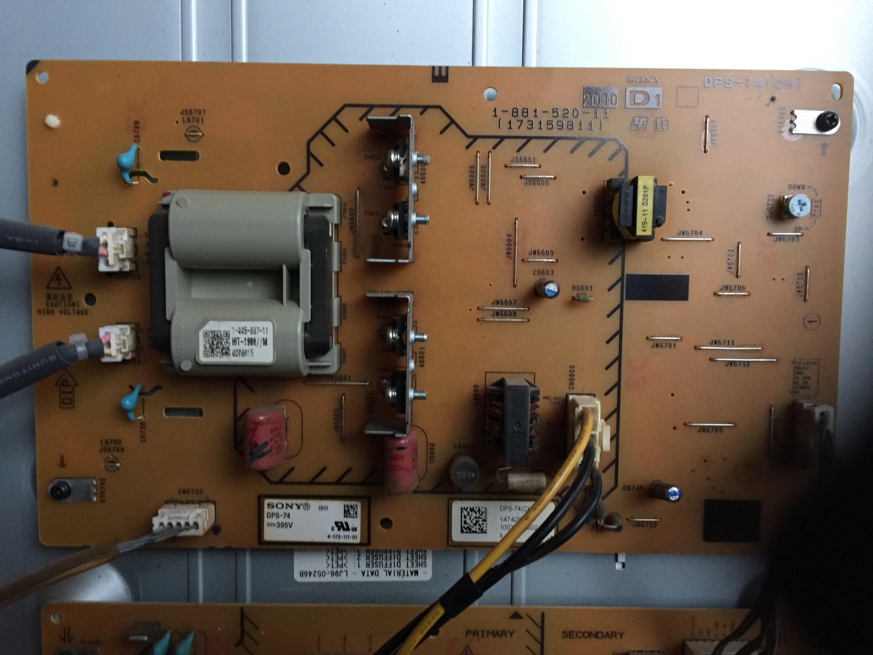

    The primary Power supply is DPS-74
    The secondary power supply is APS-256
    The standby voltage as marked on the secondary supply is supposed to be 3.3 volt and it tests as 6.4 volts with a meter.
    I am assuming that is the reason for the fault code.
    As I am a senior on limited finances I would like to attempt repairing rather then replacing the boards.
    Any advise or direction would be much appreciated.
    Thank You
    Re: Sony KDL-55HX701
    Are you 100% sure that your meter battery is not LOW? Try testing some AA or AAA Voltage with your meter to see what it will show the Voltage as first.

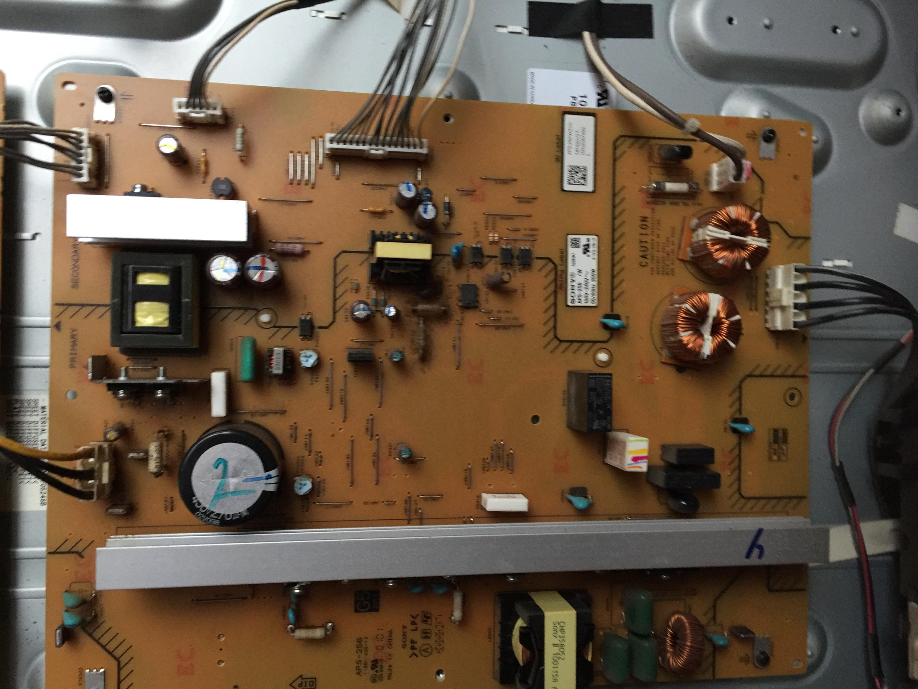

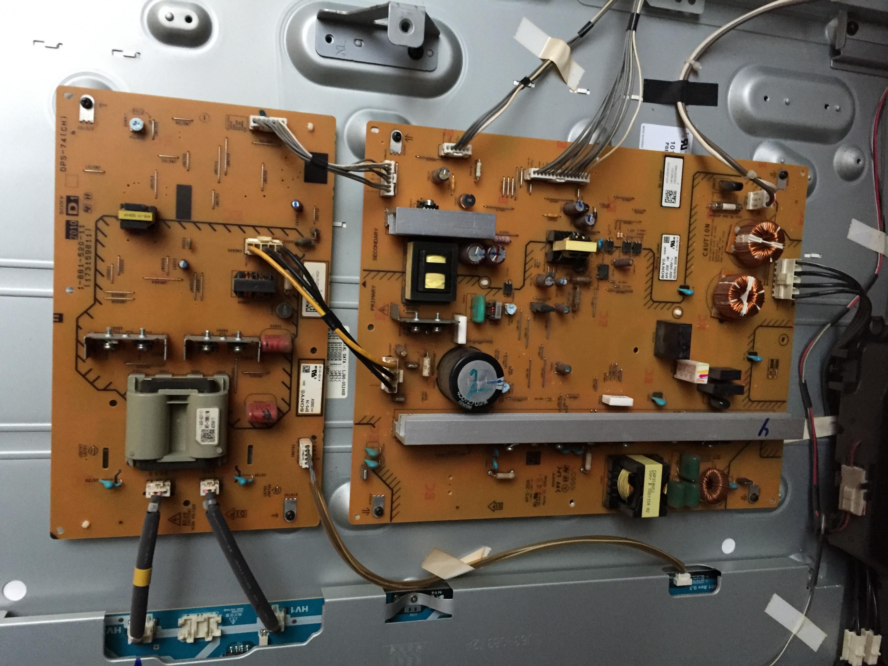

    How about the pictures of the whole backside of the TV showing all the boards?

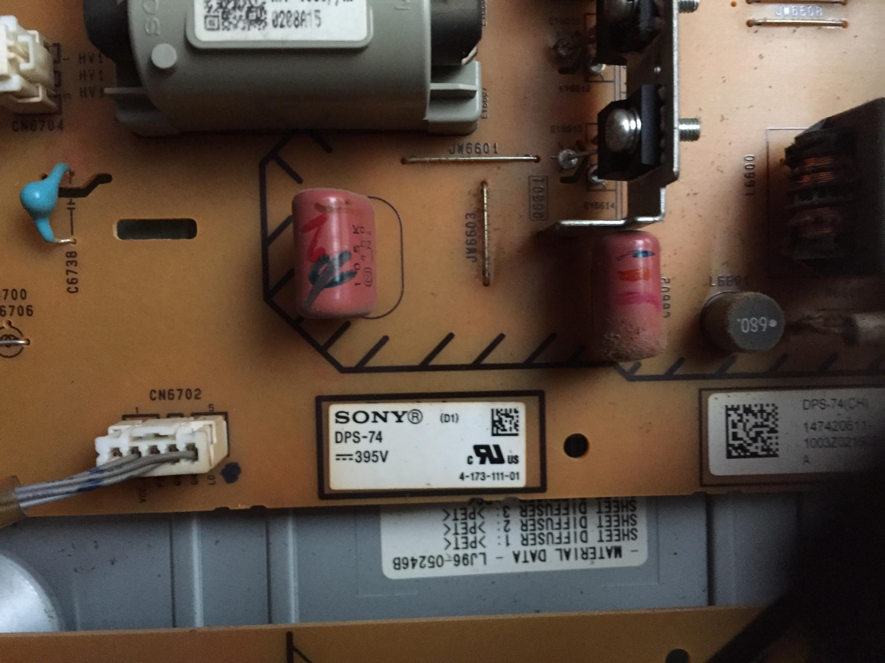

    'The primary Power supply is DPS-74' That is not valid part number.

        7 pics attached
        Thank You for responding.

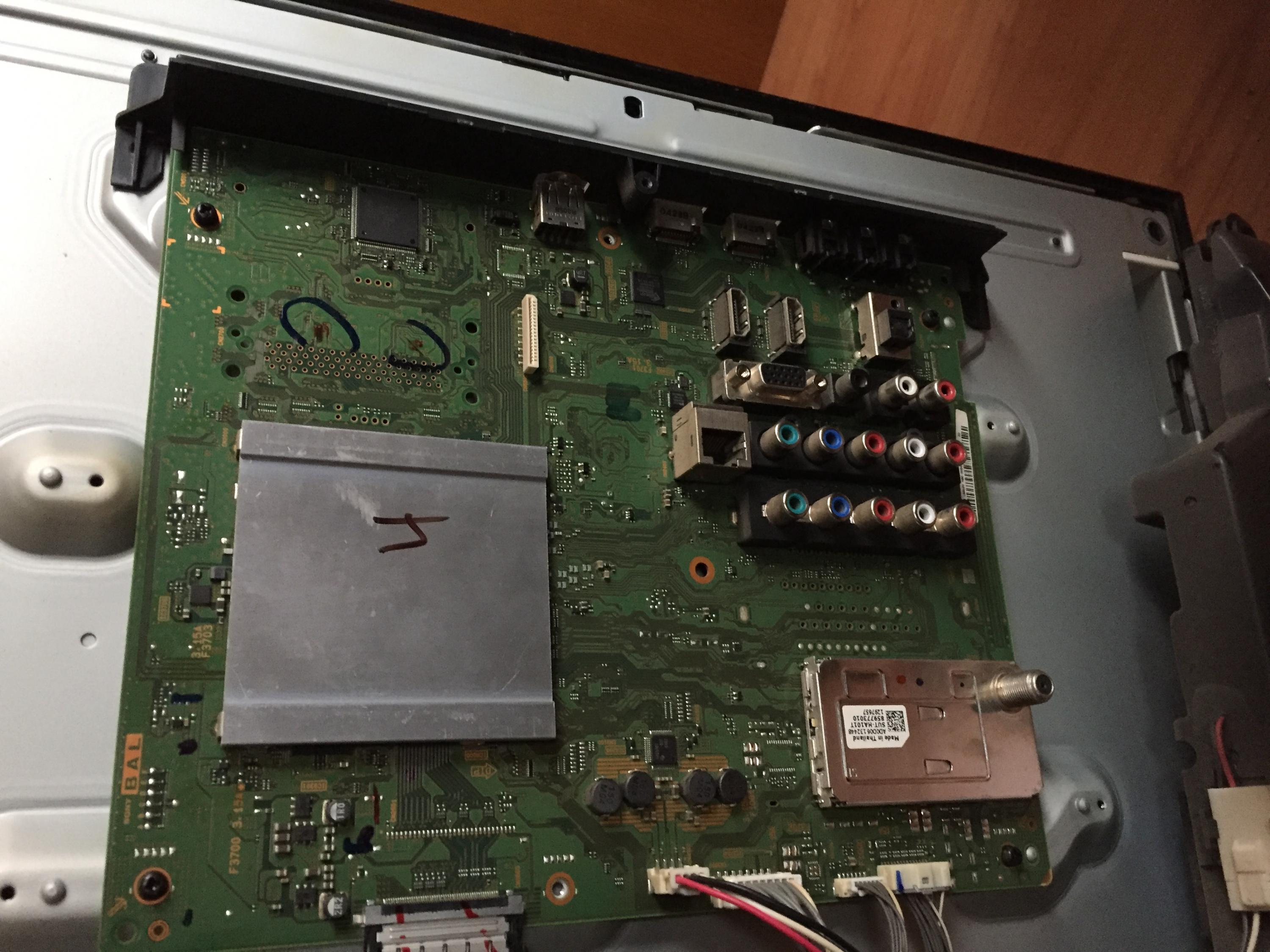

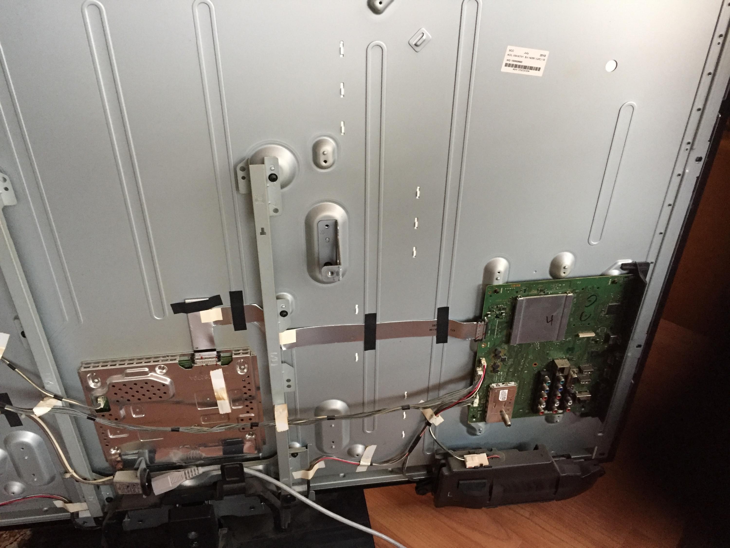

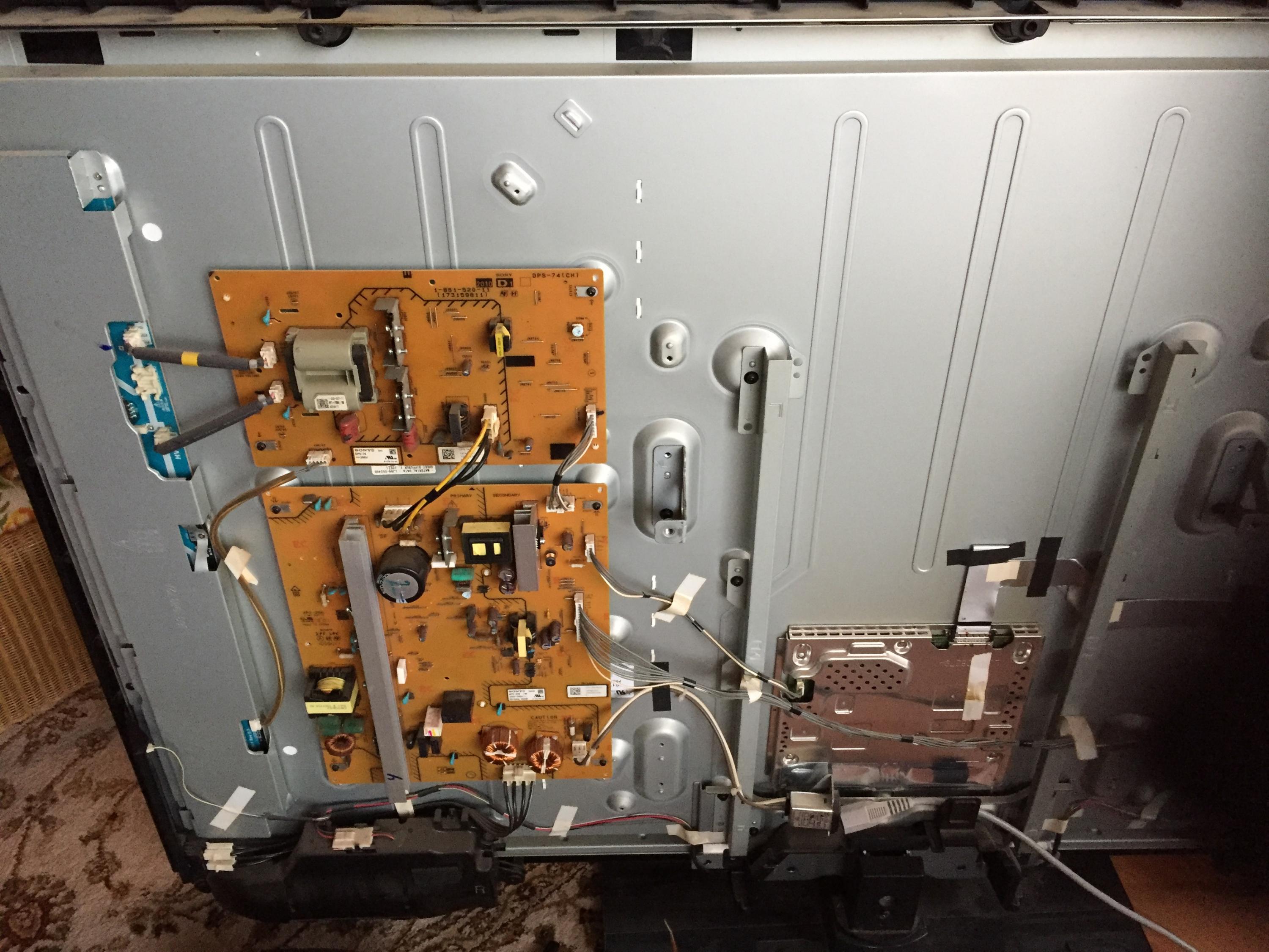

          3 more pics

            I accidentally had the meter on AC. I do have 3.3 volts DC on the standby terminals.
            I do not know what else to check.
            Any help is appreciated.

              Can you please verify for sure that you have 7-blink code?
              7-Blink is for Thermal error.
