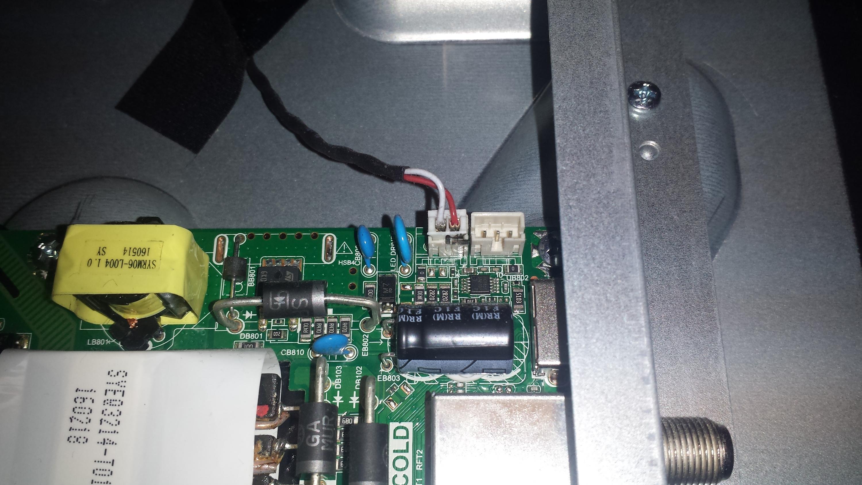

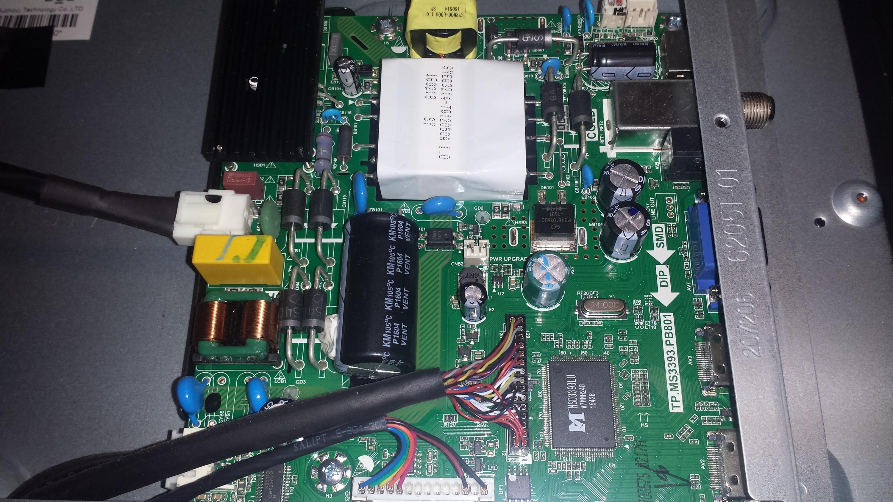

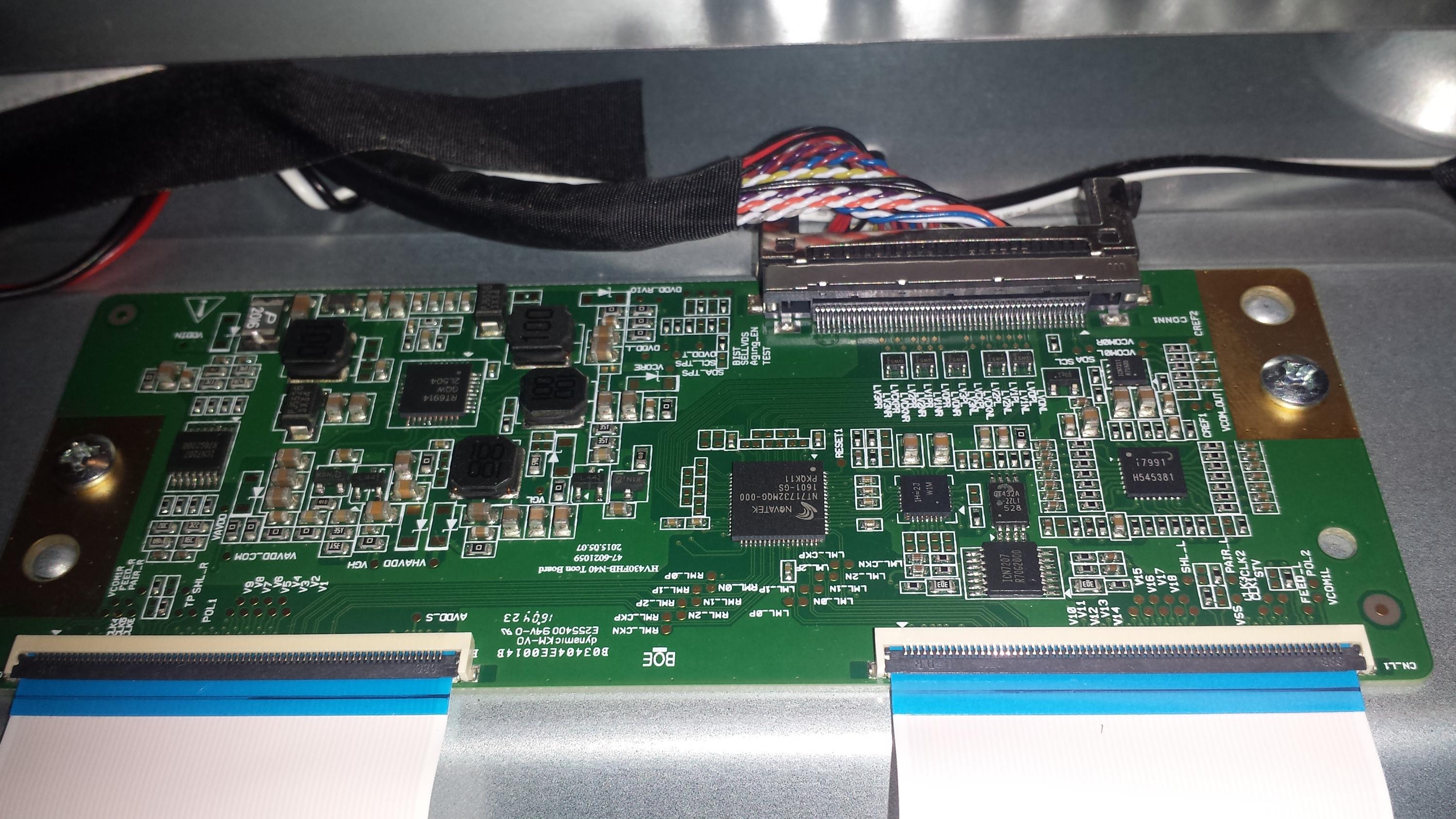

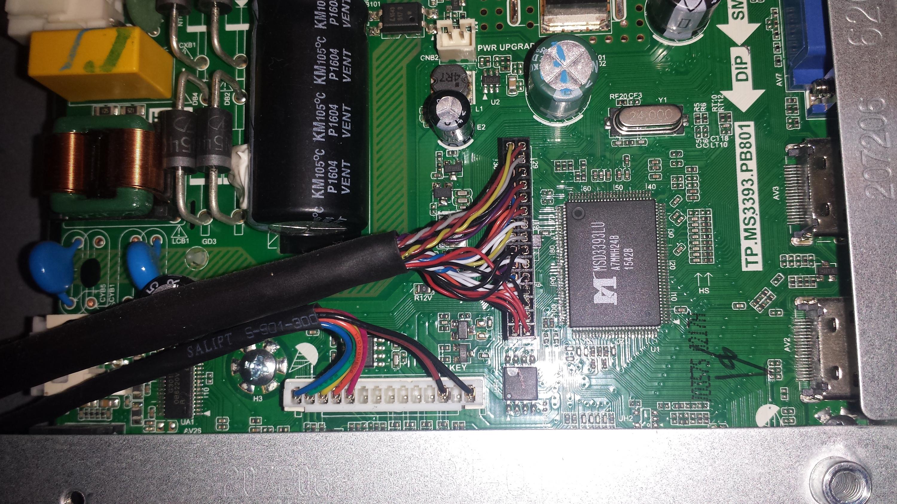

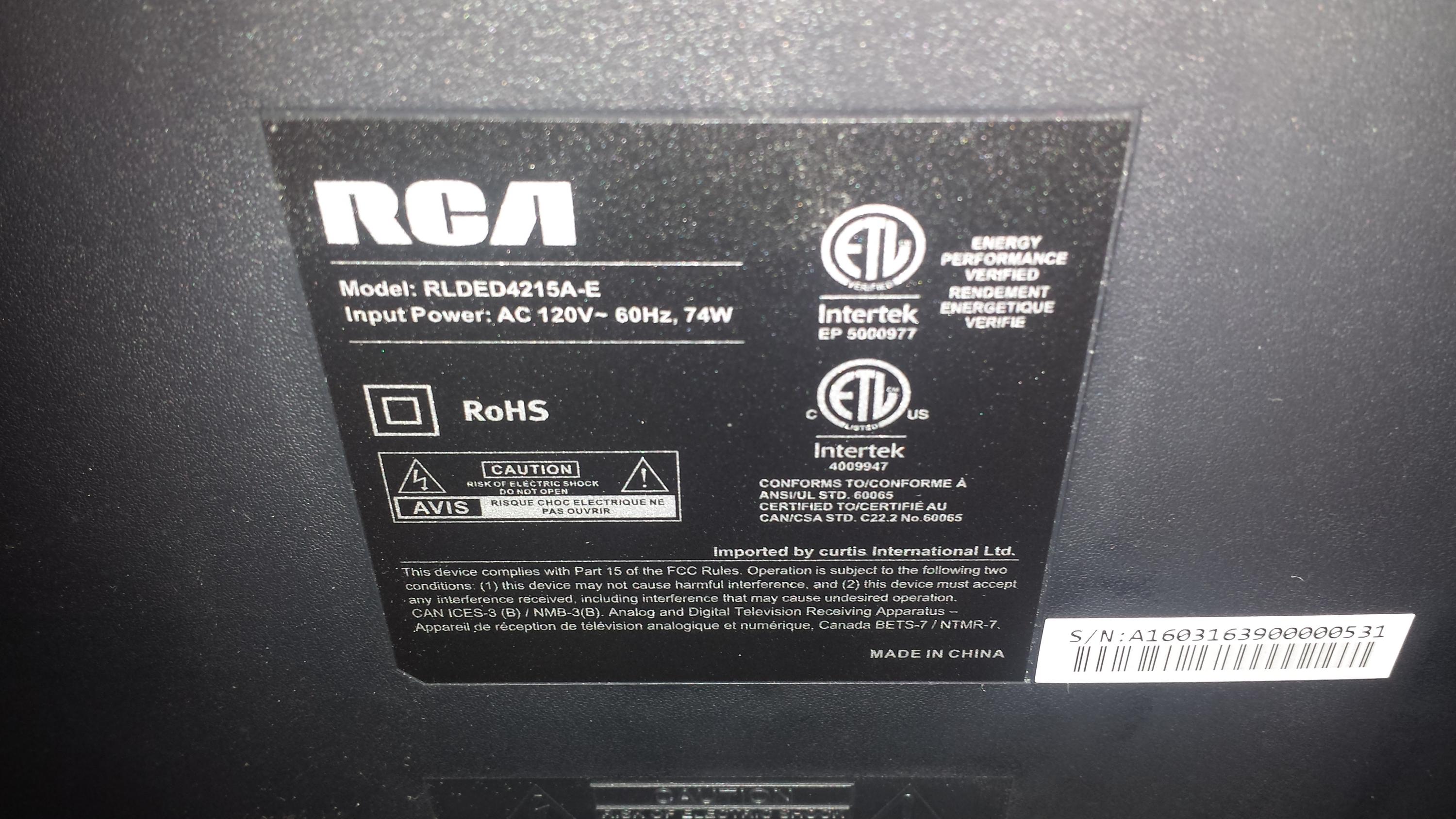

    RCA 42" LED TV - No picture - RLDED4215A-E
    I have this newer LED TV and there is no picture when I turn it on. The blue light comes on but there is absolutely no backlighting. If I flash a light on the screen, I can see the picture in the background. There are only two boards on this when I take the back cover off. I have attached pictures of the unit and the boards. Nothing looks like it got hot and can't find any bad caps, solder joints etc. Any ideas? Thanks in advance
  • ducky29
    • Dec 2015
    • 369
    • Europe
    Re: RCA 42" LED TV - No picture - RLDED4215A-E
    One or more leds are burnt. You need to teardown the whole screen and then you either replace the bad strips or the bad leds. There are few tutorials on youtube if you have never done that before.
    • bwilliams60
      • Aug 2014
      • 109
      If it was one or more LEDs, would I not see a partial screen?
      This was like the whole screen went out all at once.
      • R_J
        • Jun 2012
        • 9623
        The led's are in series, if one goes open, none of them will light
        • bwilliams60
          • Aug 2014
          • 109
          Are they not hooked in series across the screen, but in parallel off of the side boards? I haven't opened up the LED portion yet but I would assume that if the backlight is out, that would mean every LED would have to be out. Is there a way to test the whole LED section or do I need special tools.
          • bwilliams60
            • Aug 2014
            • 109
            Okay so I found the LED connector and measured it with my DVOM. On Standby, I was measuring -53.3 VDC with my leads in correct orientation. When I turned the TV on, it climbed to 173 VDC and then down to 68 VDC where it stayed after about 15 seconds. No lights. So one would assume that the lights are in fact burnt out. Any thoughts?
            • R_J
              • Jun 2012
              • 9623
              They are usually all in series if there are only 2 wires going to them, 173v means the power supply is working, without any load the voltage will drop down.
              If you do remove the lcd be carefull removing the fragile lcd screen and pay attention to the order and direction of the diffuser sheets
              • bwilliams60
                • Aug 2014
                • 109
                Unit needs new LED strips. Tested each one at 27 volts and bottom row fails.
                All good.
