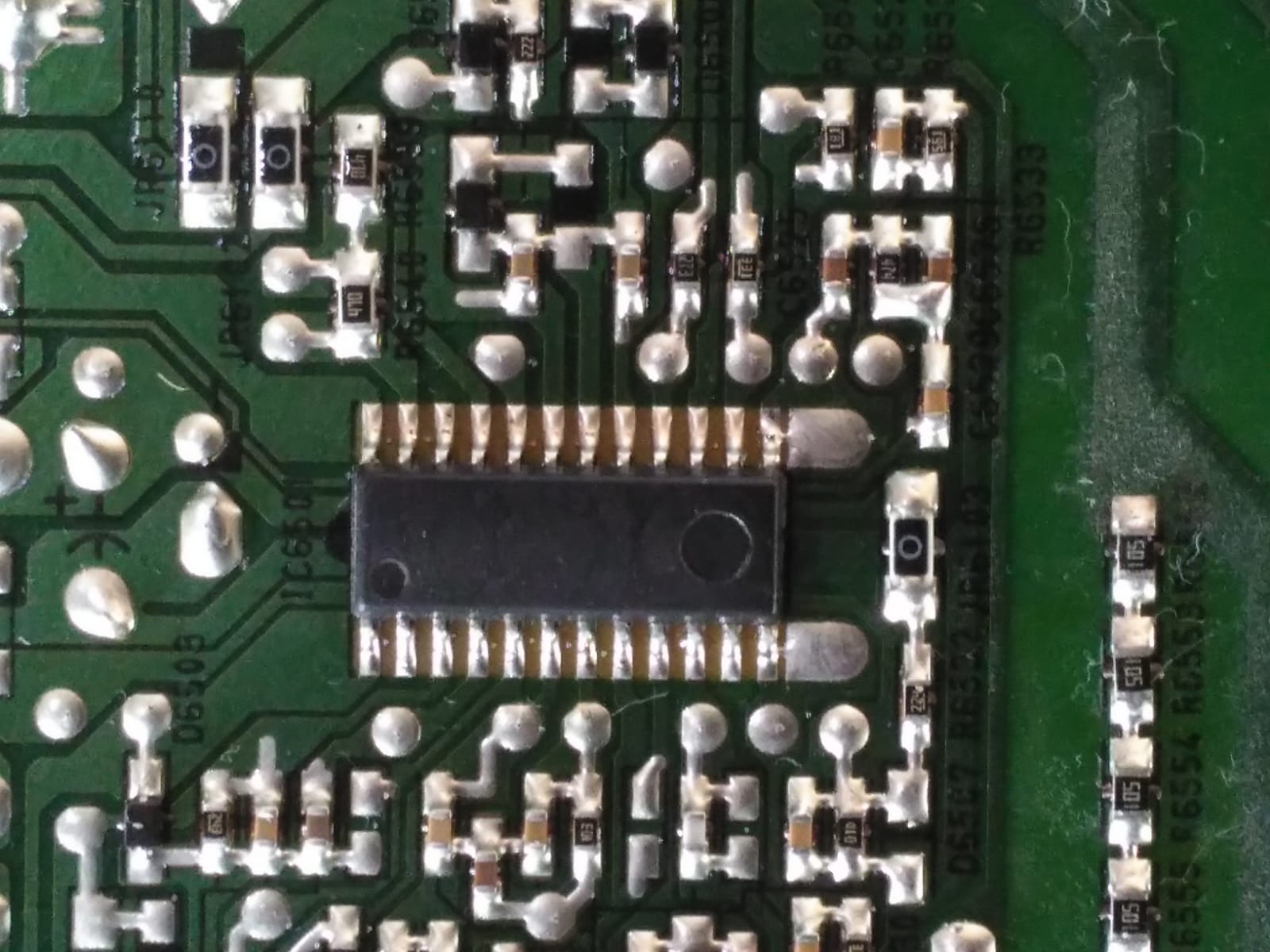

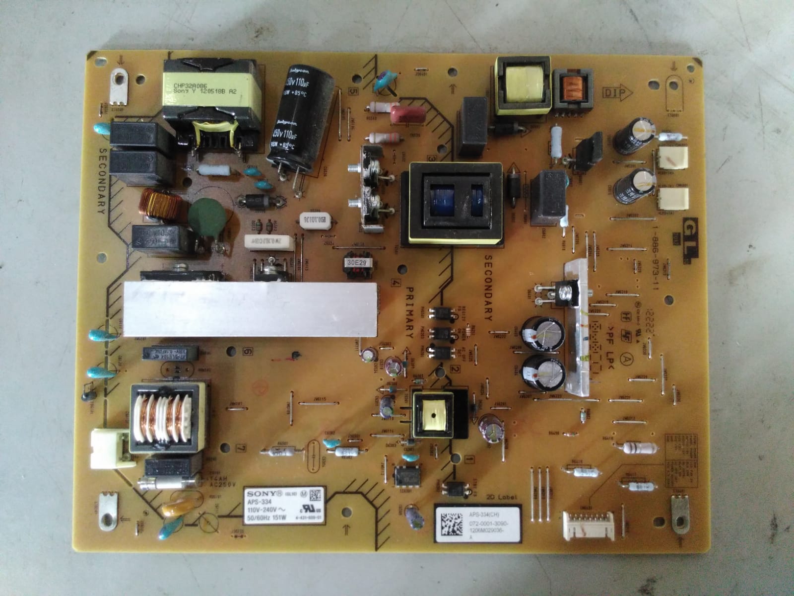

    Hi
    This tv is dead but i am getting the 3.3v stand by and 3v for the power on on the power supply.I currently suspect IC6501 on the power supply but there are no markings on it. The power supply is a APS-334 and I would like to know that ic part number. Thanks.

    Sometimes the markings for SMD ICs are below. Why do you suspect this IC. Did you try a self test to turn on the PSU?

      Re: Sony kdl-42es441 Dead no standby light
      I don't know how to self test the PSU. How do you do that?
        Can we see the pictures of the whole backside of the TV showing all the boards?
