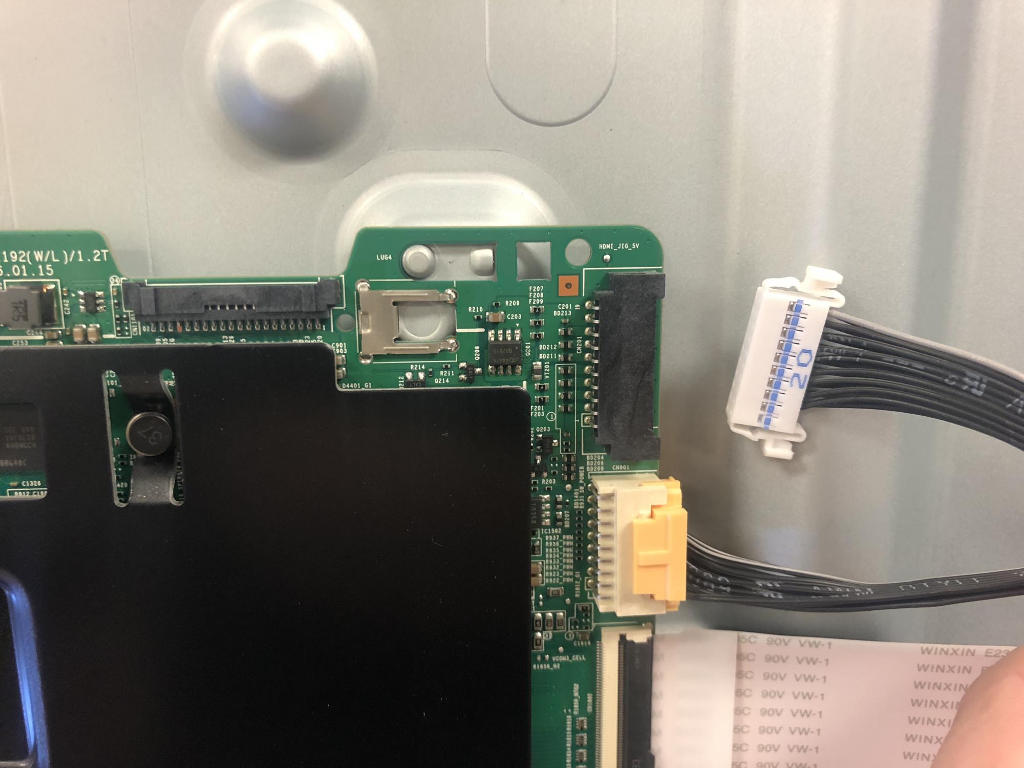

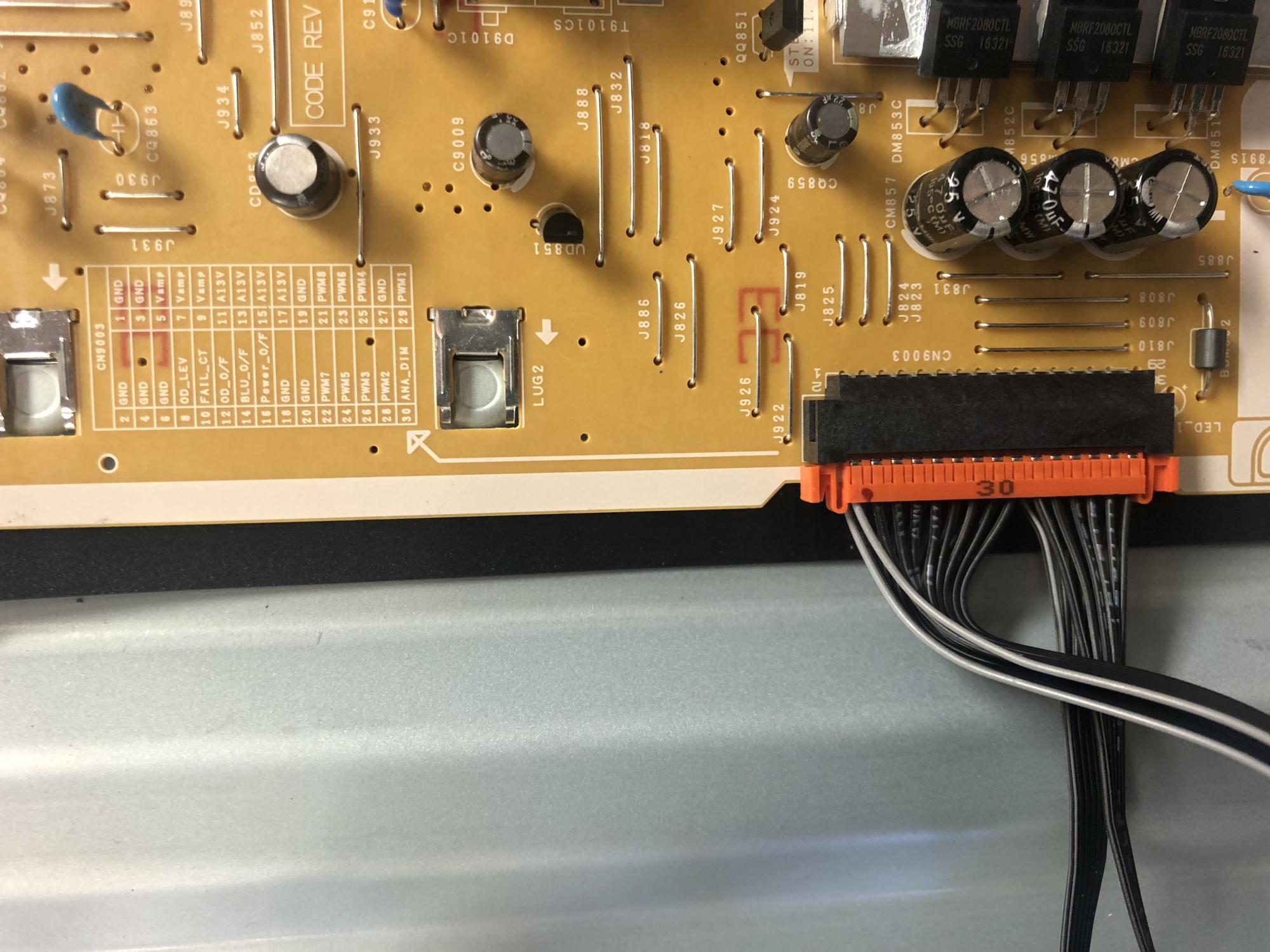

    Samsung UN55KS800DF
    Hey guys this unit power cycles with no image but backlight does come on and then shut off. Unplugging the cable in the picture makes the backlight stay on but no response other than that from it. I am assuming main board is faulty wanted to double check before I spent money. Thanks!!
  • CapLeaker
    Leaking Member
    • Dec 2014
    • 8352

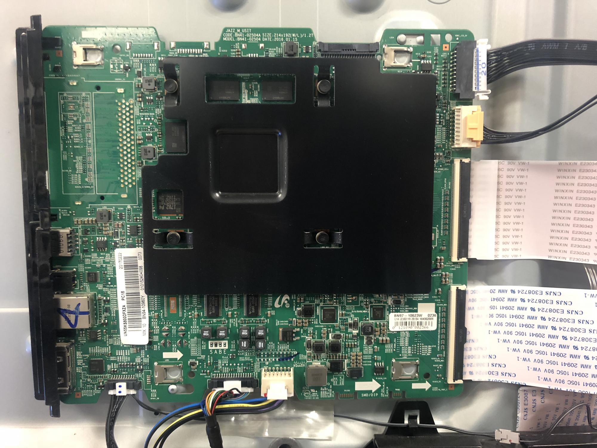

    Re: Samsung UN55KS800DF
    Main board trouble indeed! One more test. Put all the boards back into the TV and disconnect the WiFi module and power the TV on. Another thing you can try is to freeze the EEProm on the main board with a can of air upsidedown and see what happens.
      Know error with these sets.
      Possible culprits are mainboard (- in combination with the one connect box ) or display.
      This set does the same when the FCC cables are disconnected so there is no need to try that. We saw several of these where the mainboard and one connect box were defect, some even have a defect mainboard in combination with the display.

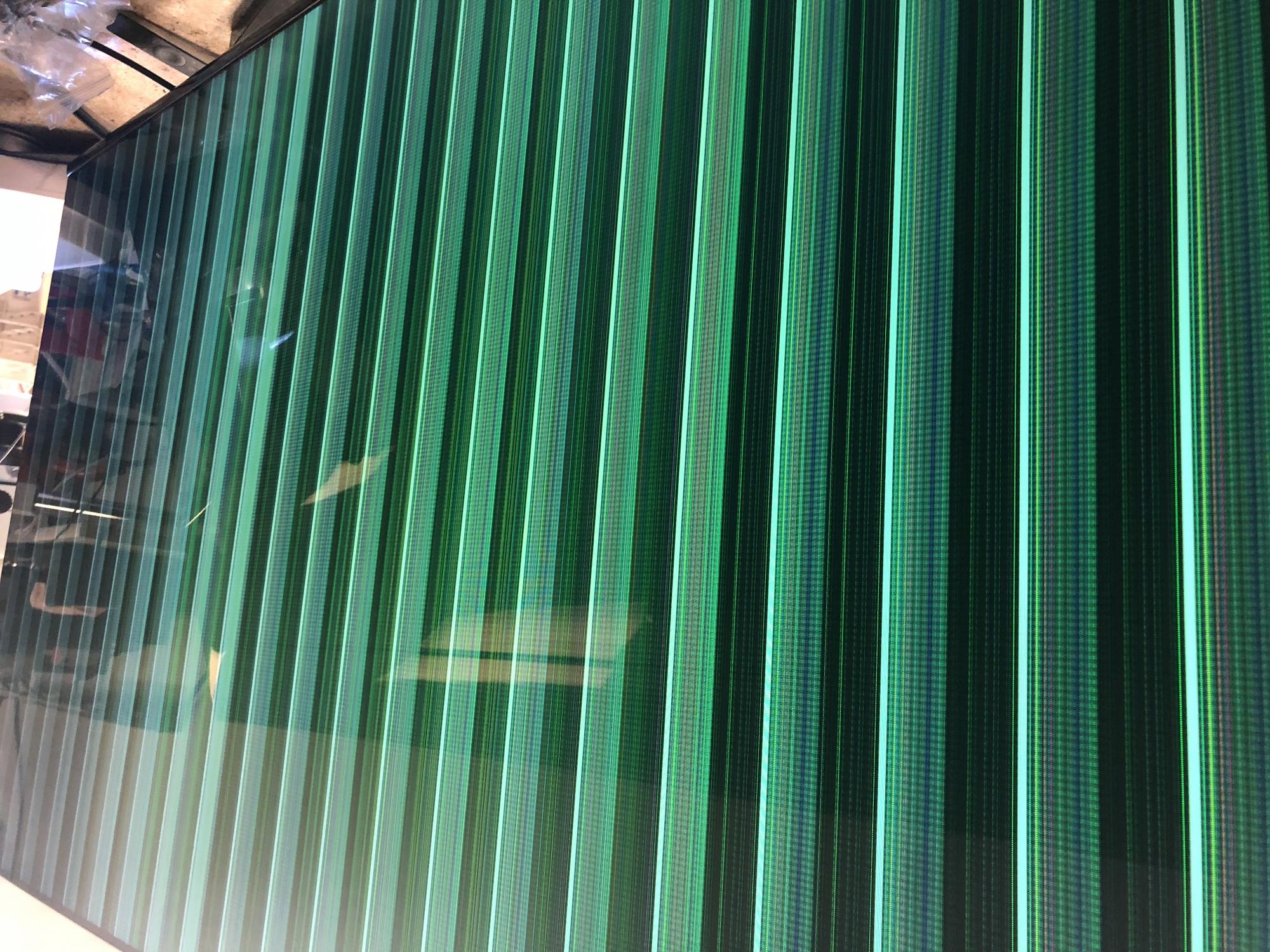

        Ok purchased new main board. Now I'm getting a display but it's showing up like this?
        • CapLeaker
          Leaking Member
          • Dec 2014
          • 8352
          does the OSD work?
          • Jtroutt19
            • Aug 2011
            • 164
            no the OSD does not work.
            • CapLeaker
              Leaking Member
              • Dec 2014
              • 8352
              Can you borrow and oscilloscope? Probe the LVDS cable between the main and Tcon, while flicking the menu on and off. If you see a difference on the oscilloscope while flicking the menu on and off, your next stop is the Tcon. Measure around the Tcon for voltages.
                    So this doesn't have the normal tcon board.
                      It has integrated T-CON into the LCD panel tab bonding board.
                            Are the BN94-xxxxxX numbers the same on both mainboards?

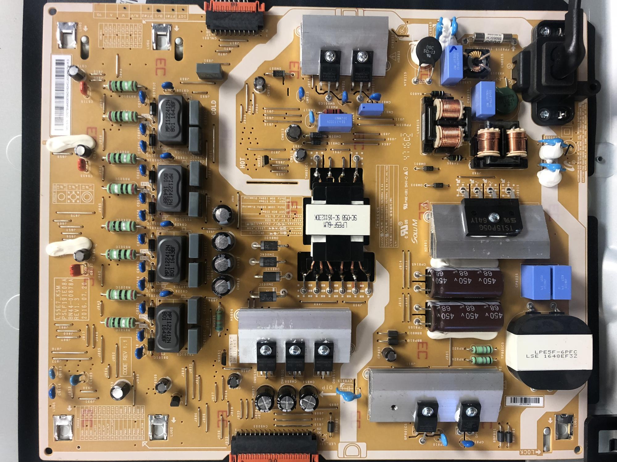

                              I have same model. Tried 2 sets of P.S. & Main. Board #s match. Ver. # match. Same symptoms. Why do back light stay on ( no dark areas ) with #20 plug disconnected from main if display can be the problem? Shouldn't set light up w/o one connect attached? Is it excessive draw by back light causing cycling? Thanks.
                                I Ordered complete set of boards from SJ for about 90.00,got them in yesterday.Swapped them all out.. Tv works perfect now. Cant beat it for only 90.00!
