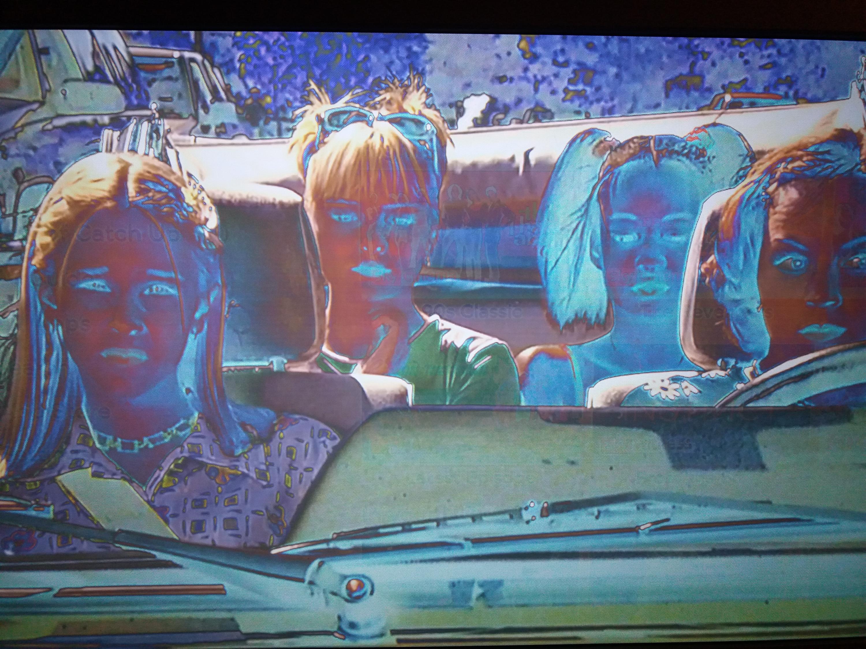

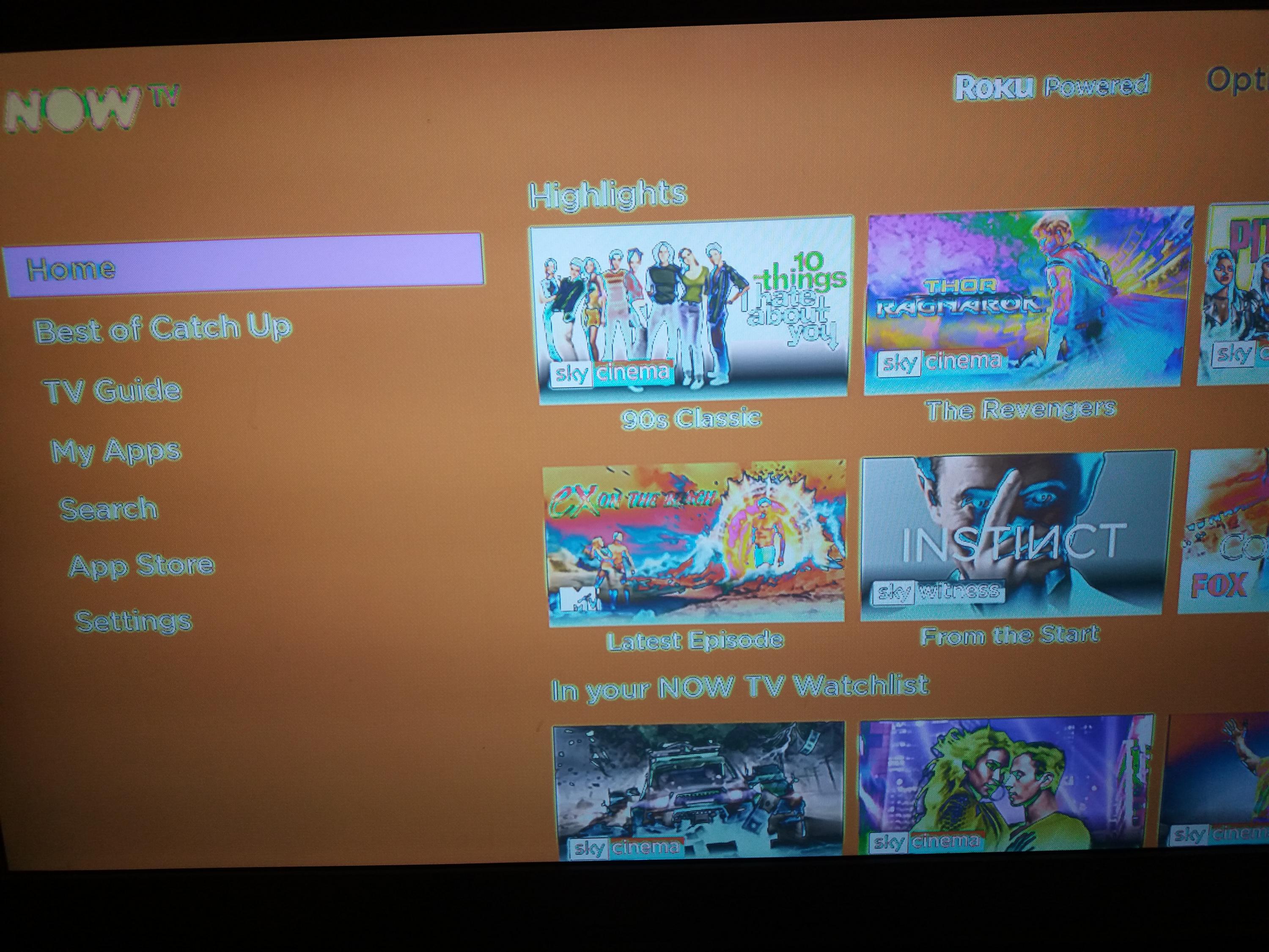

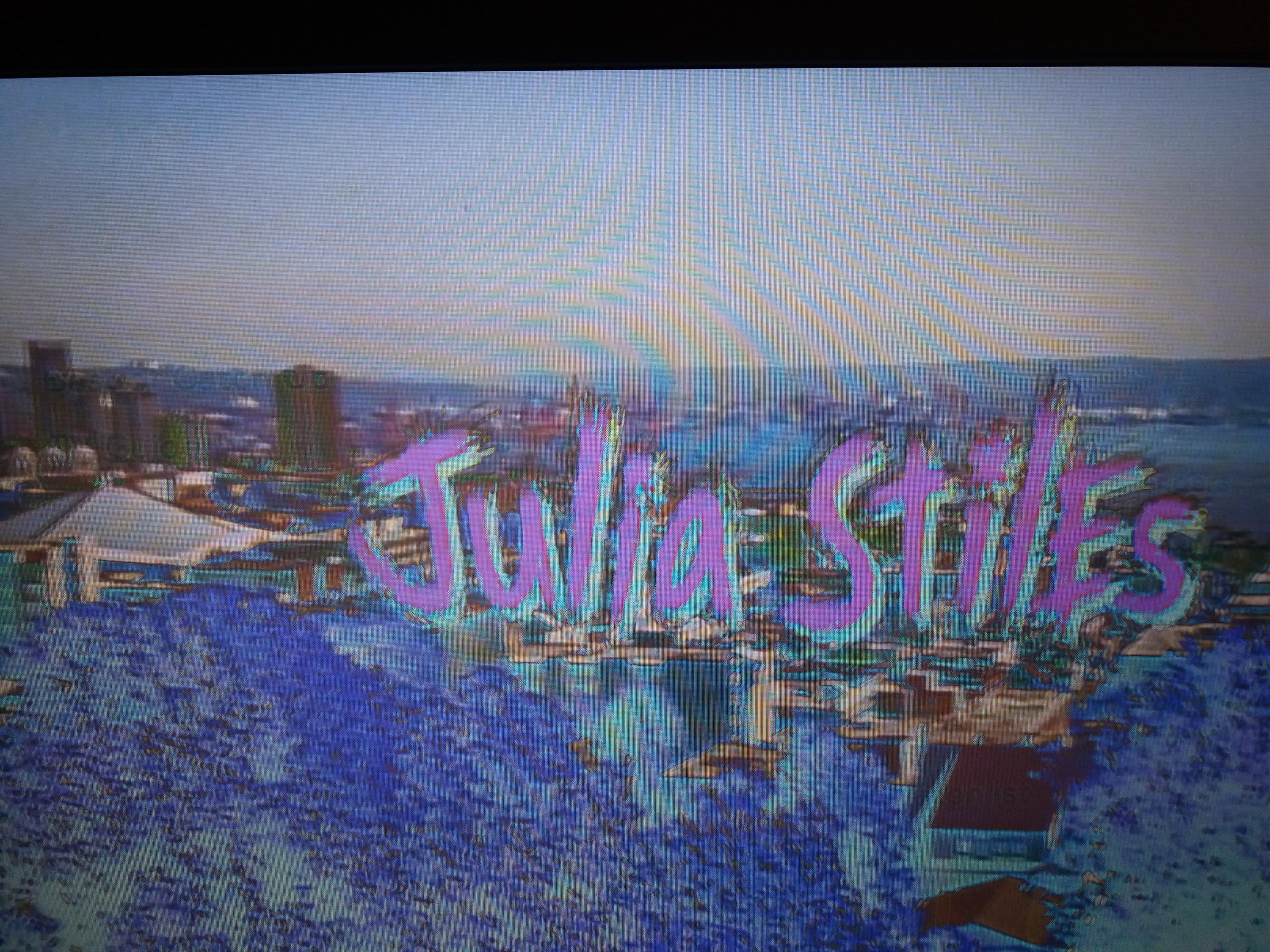

    Colour problems and image retention.
    Replaced the T-Con board but still the same, guess it could be possible the Ebay board is also faulty but sold as working and tested so have no reason to disbelieve them.
    Tried factory reset in Service Menu but still no change.
    Exactly the same symptoms on both HDMI 1 & 2, Scart and USB video playback.

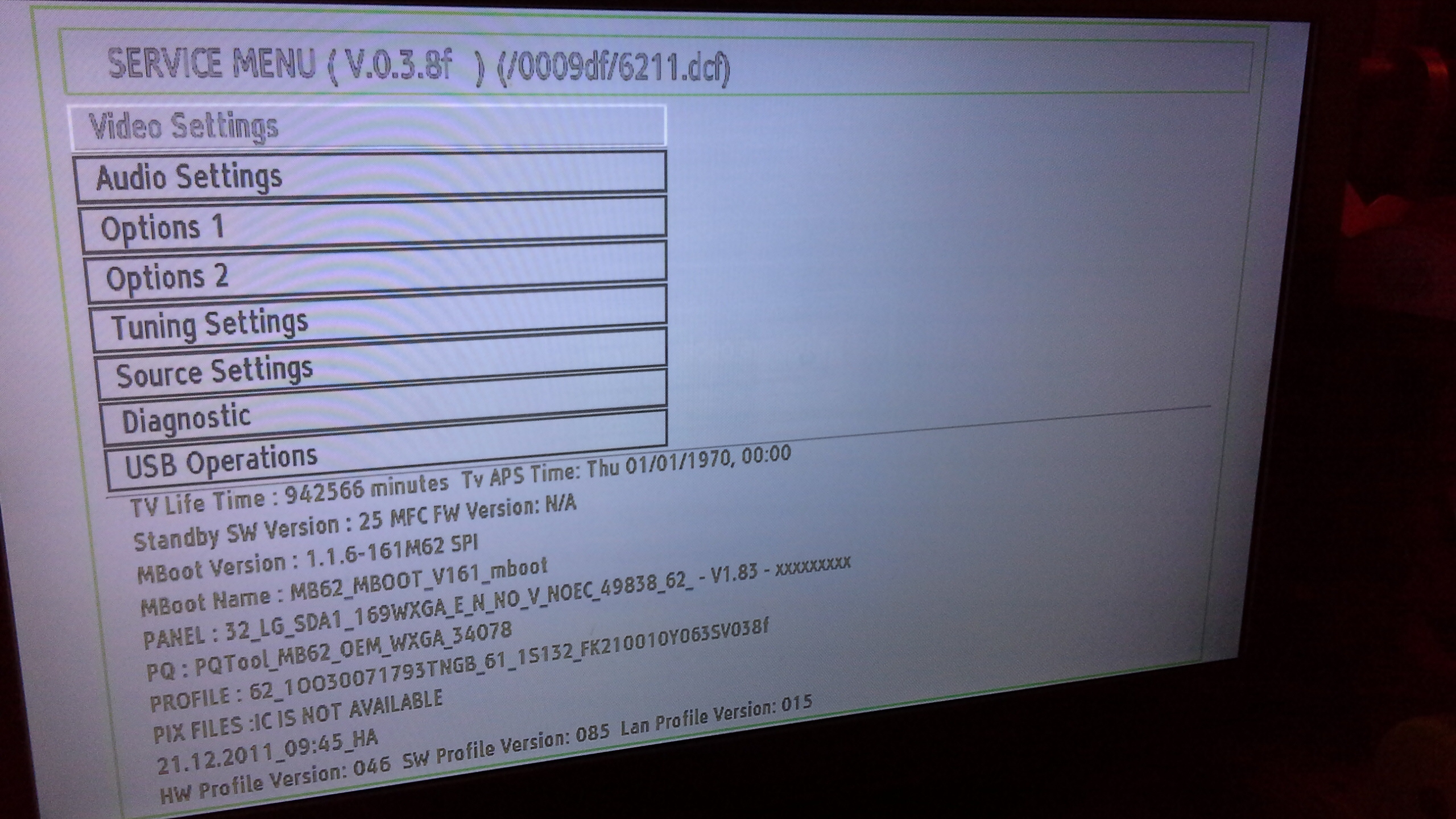

    Try changing the panel type on the service menu.
    • notallbad
      • Oct 2012
      • 1190
      Re: Bush LED32982HDT video / image problems
      There doesnt appear to be an option to do that on this tv. Mostly all options are 'read only'.

        Have you tried flashing a firmware?
        • notallbad
          • Oct 2012
          • 1190
          If I could find one I would!
          17MB62-1 V3
