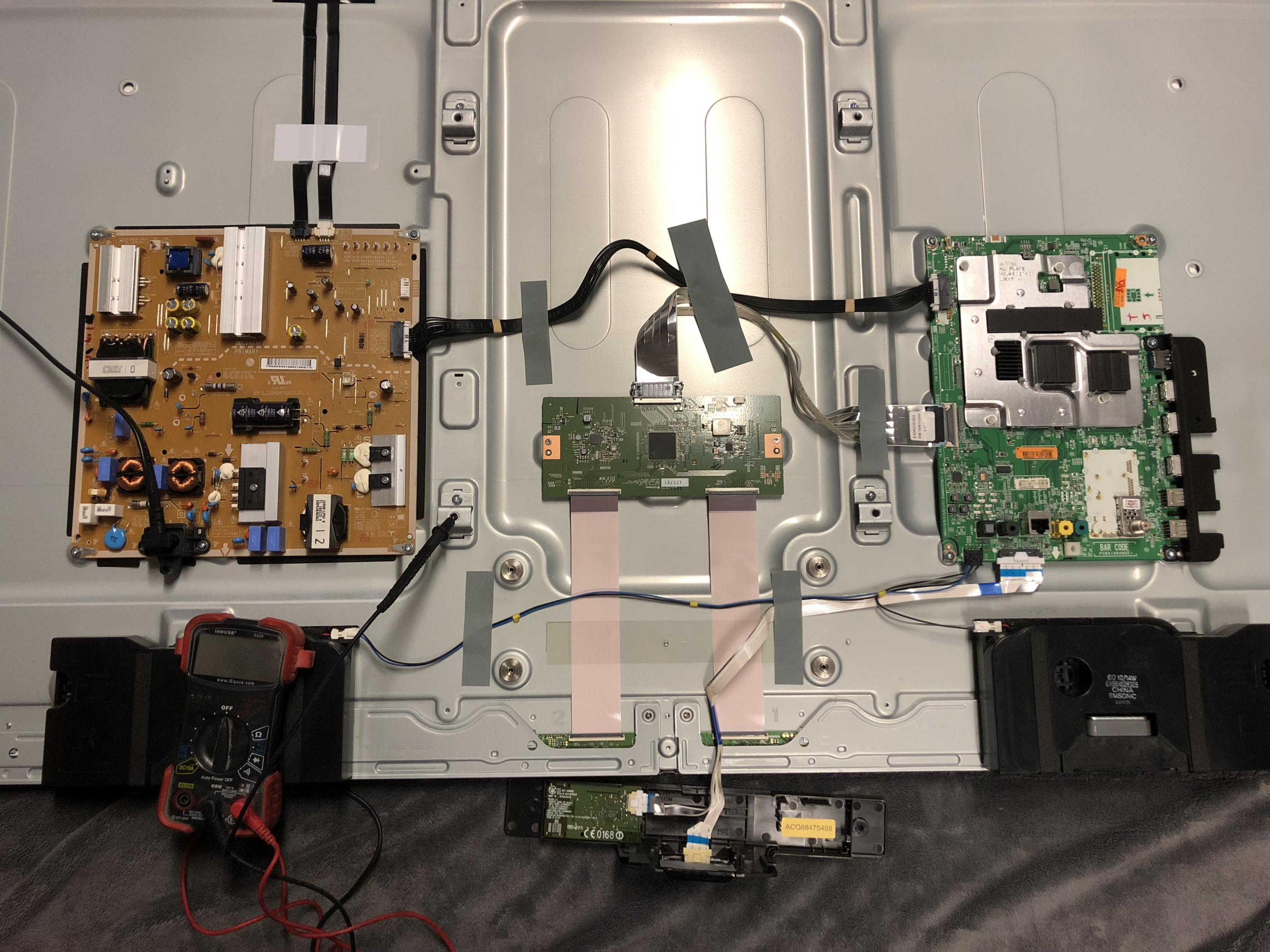

    I am new, so hopefully I don't sound like an idiot. I am looking for some help diagnosing this tv. I don't have picture but have a standby light on the front of tv. When I turn the power button on the back light does not come on. I cant seem to figure out where the standby is on the power supply to test volts. Attached is a picture of what im dealing with and the volts I am reading for each one. First Set of numbers is when tv OFF second set is when its ON.
    TV WAS IN A POWER SURGE WHEN THIS OCCURED
    OFF / ON
    0v / 2.2v
    0v / 6.4v
    2v / 55.9v
    0v / -5.2
    8.3 to 9.5v / 13.3v (first set of numbers keeps fluctuation up and down)
    8.3 to 9.3v /13.28v (first set of numbers keeps fluctuation up and down)
    0v / -5.4v
    0v /3.49v
    0v / -4.5v

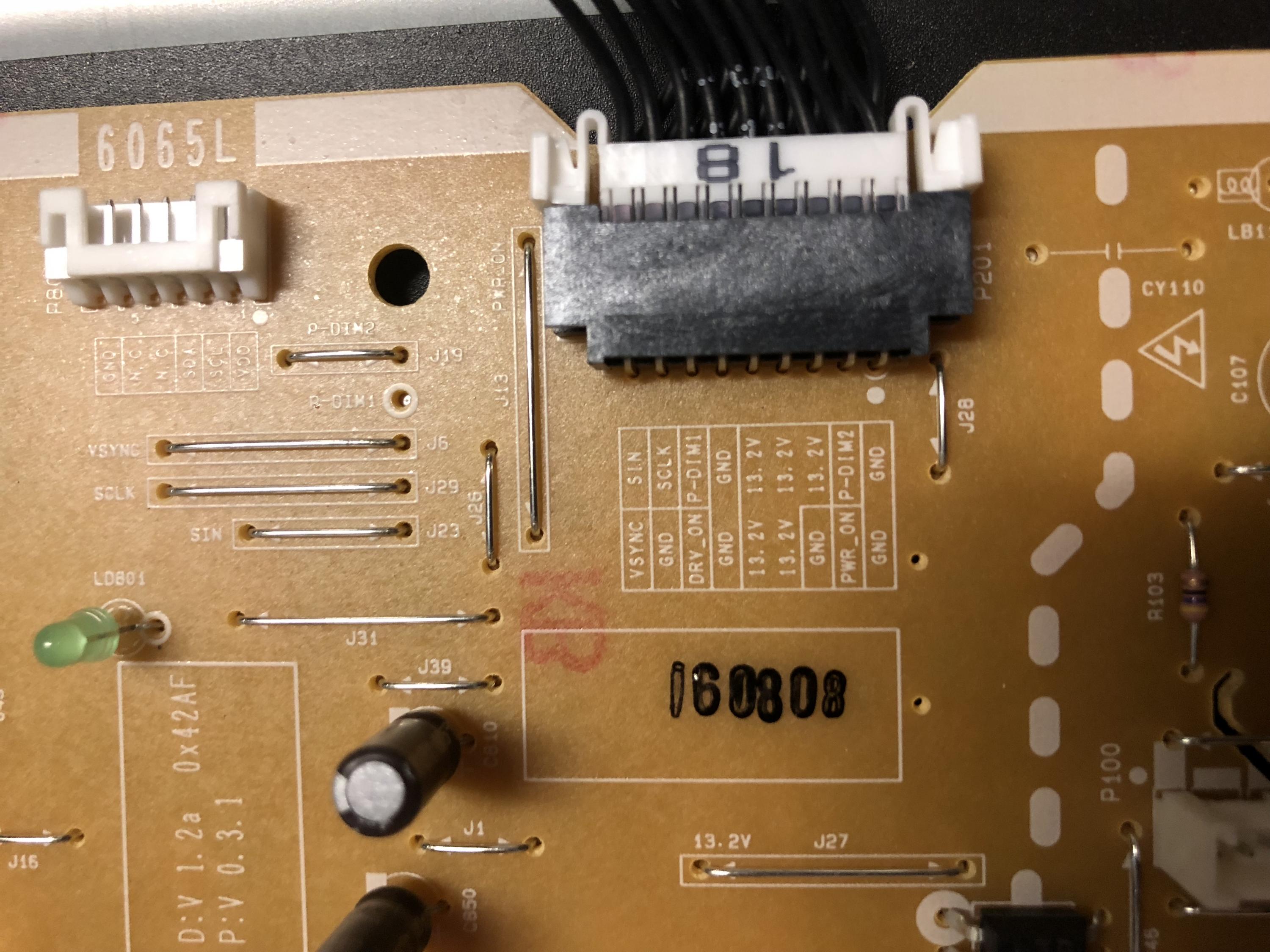

    Re: LG 65UH7650 (4k UHD)
    https://www.badcaps.net/forum/attach...9&d=1536624905
    1) That connector has 18 pins, those pins you can see from the top side of the board are ODD number pins, the white dot indicate pin 1, so the next pin will be 3, 5, 7, 9, .....
    The EVEN number pins you cannot see from the top side of the board so you need to use skinny tip probe to probe from the wire entrance side of that female connector.
    2) Each pin has pin name so to get help from us you MUST put down the pin name and follow by the DC Voltage reading of each pin for us to easily see what each pin has when TV is OFF and when power switch is activated. As you can see: pin 1 is 'GND', pin 3 is 'PWR_ON', pin 5 is 'GND, pin 7 is 13.2V, ..............
      Thank you for the info! Here is what I have for volts with the tv plugged in not turned on. (I have a standby light showing on tv)
      PIN#s ---DC volts reading
      17/18 --- 0v / .1v
      15/16----0v / .1v
      13/14----2v / 0v
      11/12----0v / 0v
      9/10-----8.3 to 9.5v / 8.3 to 9.5v
      7/8------8.3 to 9.3v /8.3 to 9.5v
      5/6------0v / 8.3 to 9.5v
      3/4------0v /0v
      1/2------0v / 0v
      • ngsss
        • Sep 2018
        • 11
        Vsync/s[n
        gnd/sclk
        drv_on/p-dim1
        gnd/gnd
        13.2v/13.2v
        13.2v/13.2v
        gnd/13.2v
        pwr_on/p-dim2
        gnd/gnd
          1) Is this your board, look at the barcode of shopjimmy and your board. LG EAY64210802 Power Supply / LED Driver Board. http://www.shopjimmy.com/lg-eay64210...ver-board.htm#
          2) Remove the cable between power supply and the main board then check to see if the 13.2V will come up to 13.2V or not.
            budm:
            Yes, that is the power supply I have.
            I removed the cable and it measured 9.8v-10v, in all (5) of the 13.2v ports

                                    I know you have done lots of "good things" to determine source of the problem. Before going further, can you try the "easy test" (if you haven't already)... disconnect, one at time, the cables going from the tcon to the panel and see if it changes the results any. It might point you in a different direction. Not normally a failure as a result of a power surge BUT there are components that may not like that event and can be somewhat isolated with this test.
                                    • ngsss
                                      • Sep 2018
                                      • 11
                                      OK, there is no picture present. When I disconnected the tcon one at a time. The right side flashed real bright like the tv was on, while the left side did nothing.
                                      • budwich
                                        • Jul 2015
                                        • 3097
                                        sorry but I don't understand your observations / report. What cable was off and what was the display doing with respect to that side. Of course, you need to have something input or at least put up a menu perhaps to see something on the screen.
                                        Anyways, please restate your observations a bit better.
