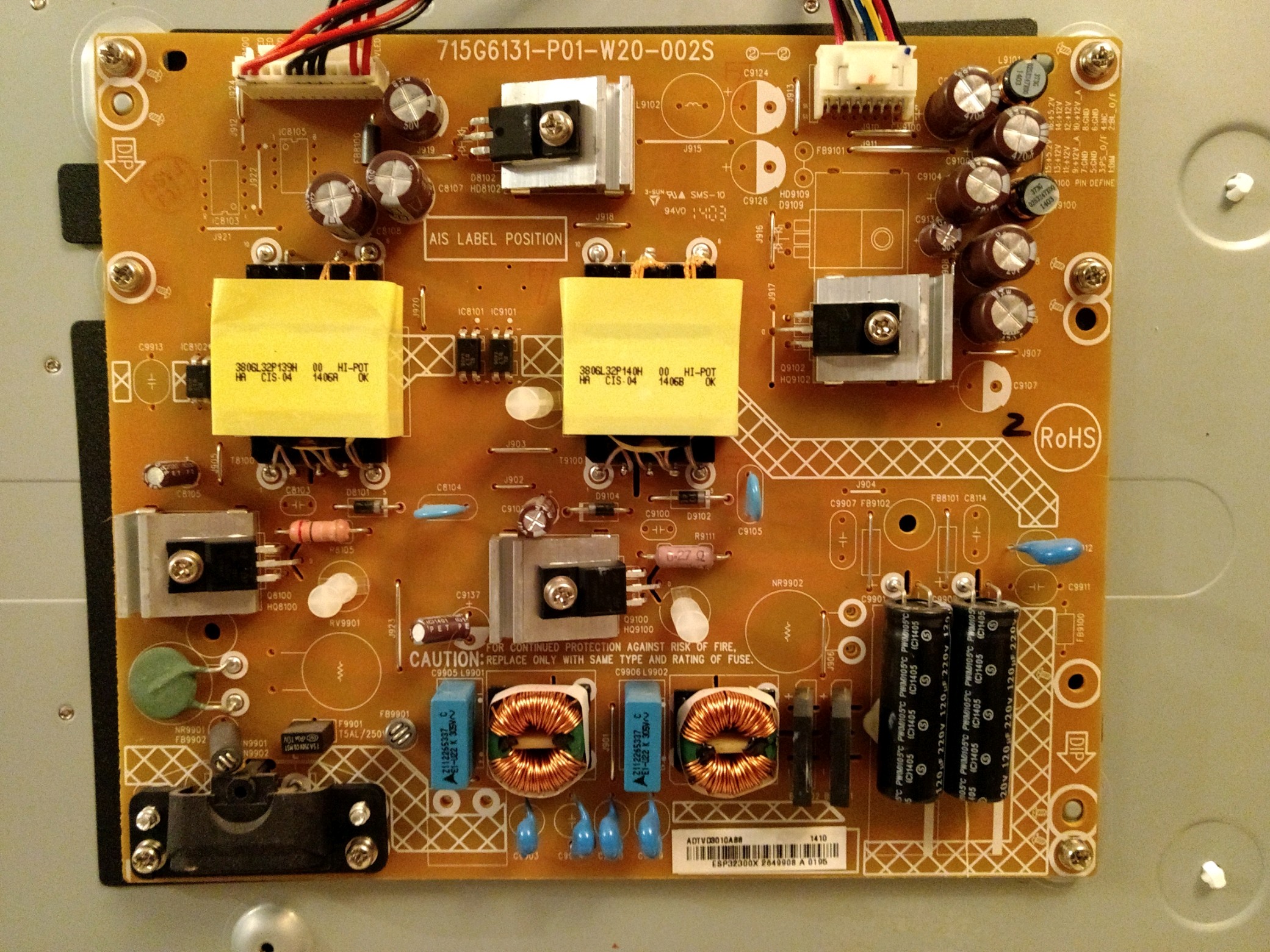

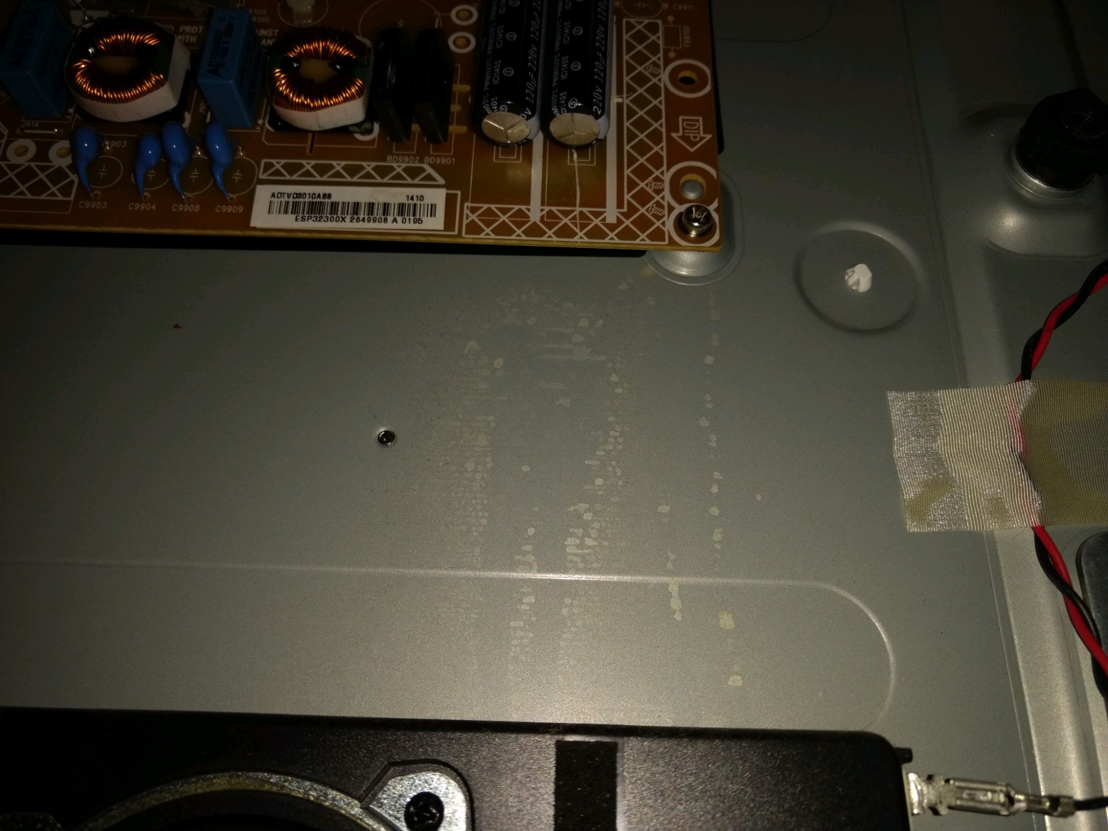

    Today I bought this Vizio M422i-B1 with the complaint of white smoke coming from within the back of the TV. I found the two main caps are blown on top with a trail leading away from them. Even with this jacket the TV still works, turns on and otherwise functions normally.
    My first impression when I saw the caps was “not original”. I could be wrong on that…..but they are rated at 220V/120uF.
    So my question, is this capacitor plague related or should I be looking for a reason they blew?

    The caps are bad for sue but I do not see any liquid coming out on the top based on the pictures, I would say just replace the caps. BTW, the power supply does not have PFC Voltage booster so 220 ~ 250VDC rating caps will be fine.

      Thanks budm, I will order those caps tonight. One more question, the caps have some kind of white paste/glue that hold them to the board. I need to get me some of that. What is it and I'm sure DigiKey has it?

        Silicone RTV will be fine for that purpose, or hot glue.

          So after selecting economy delivery the caps came in this morning, I installed them and all appears to be well!
