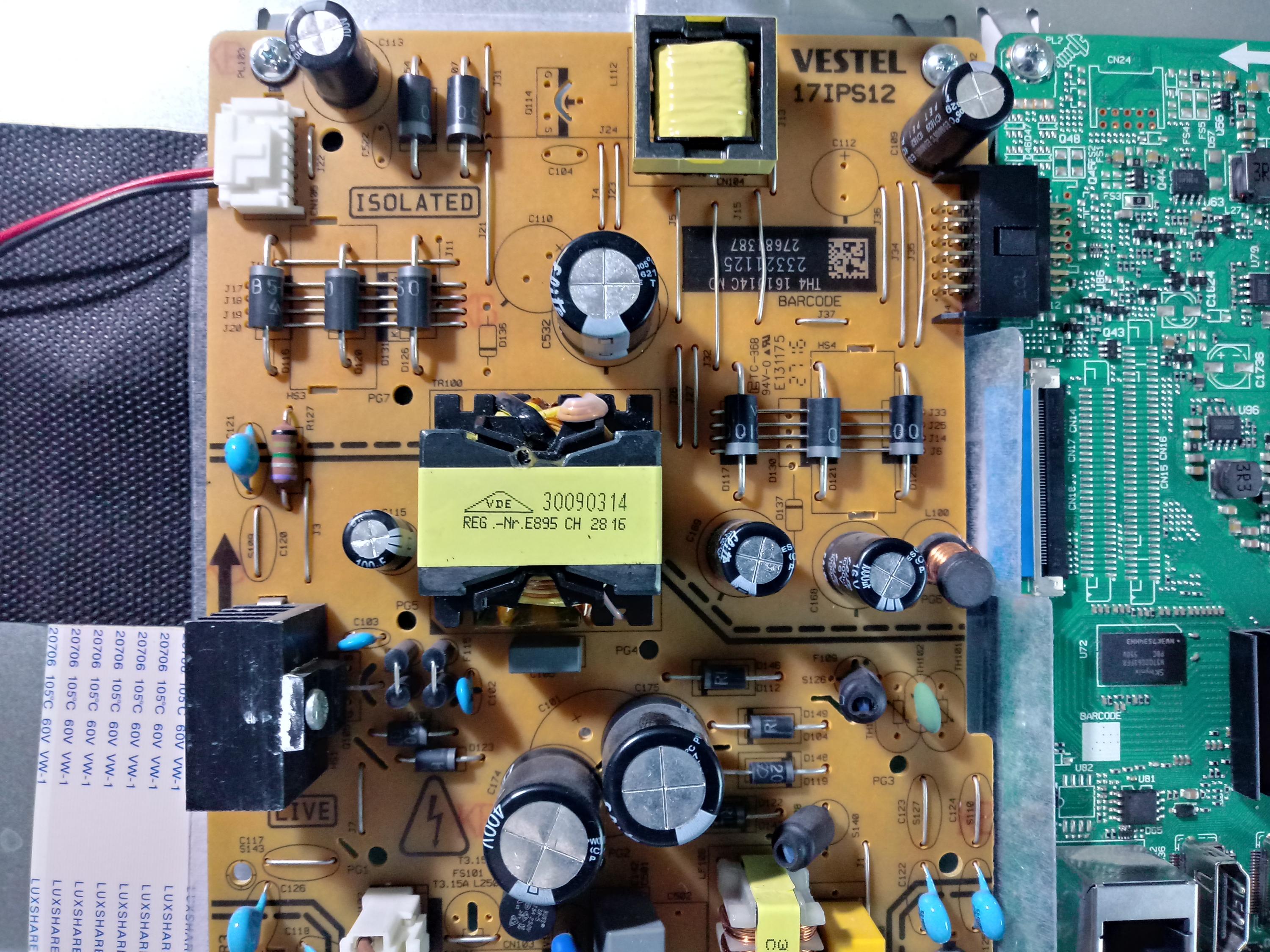

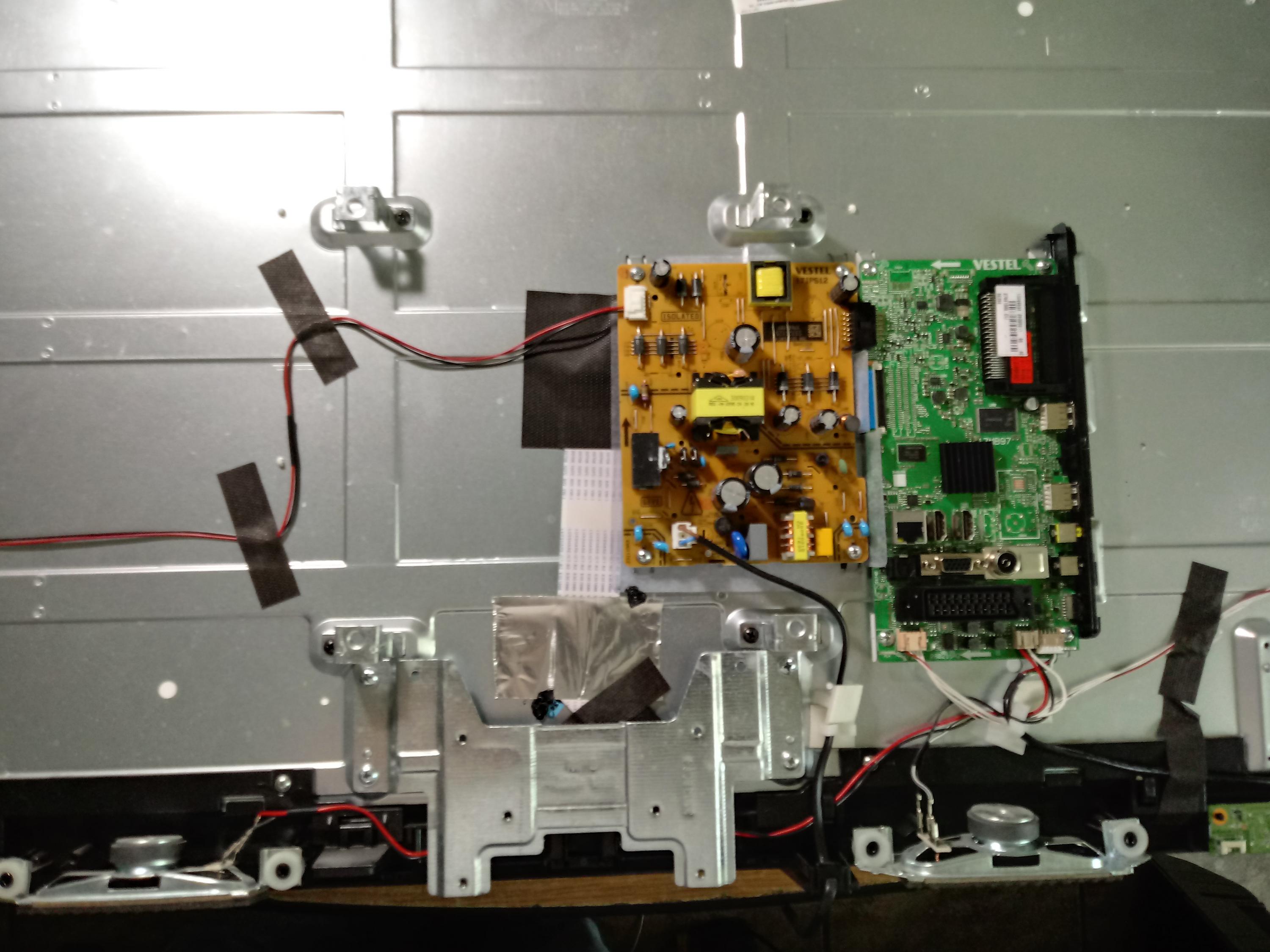

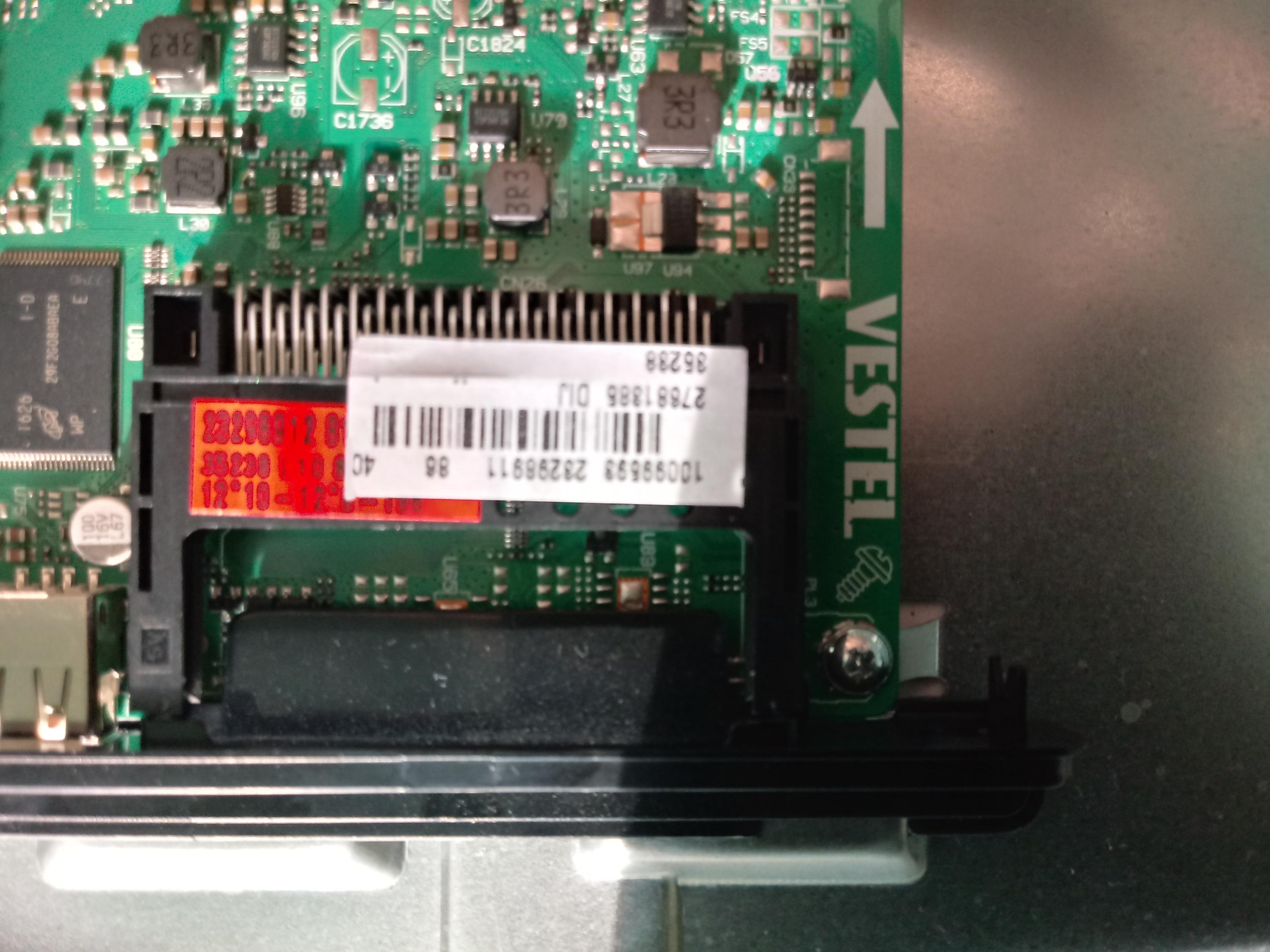

        Re: Tv jvc lt-40v750 no image
        Can we at least see good clear pictures of the whole backside of the TV showing all the boards and also straight shot pictures of the whole board of each board?
        • sorinede
          • Jul 2009
          • 19
          Hello , here are some pictures of boards..
