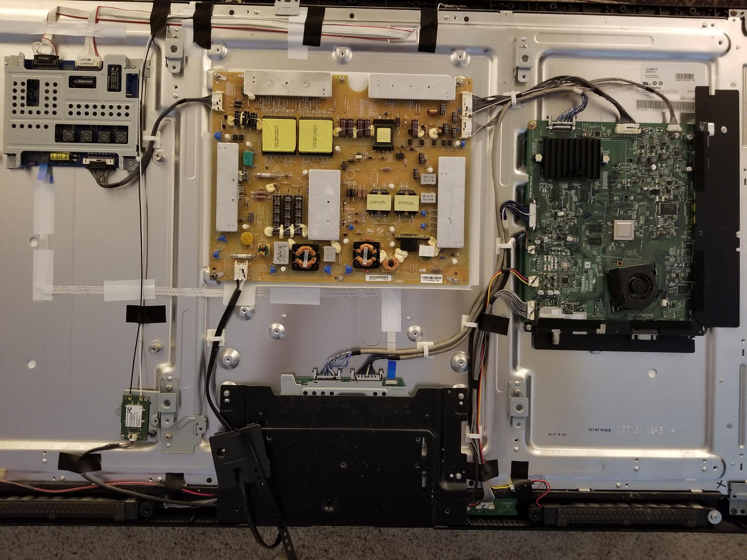

    toshiba 42tl515u problems

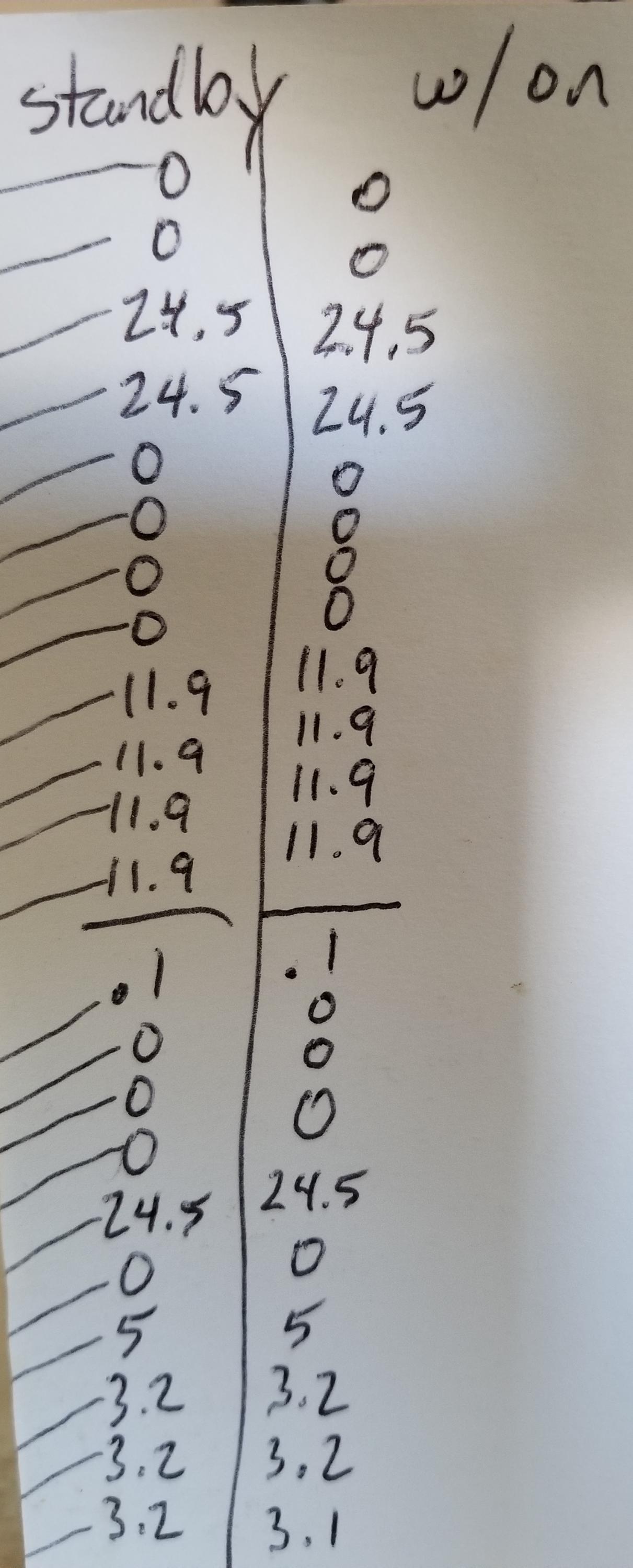

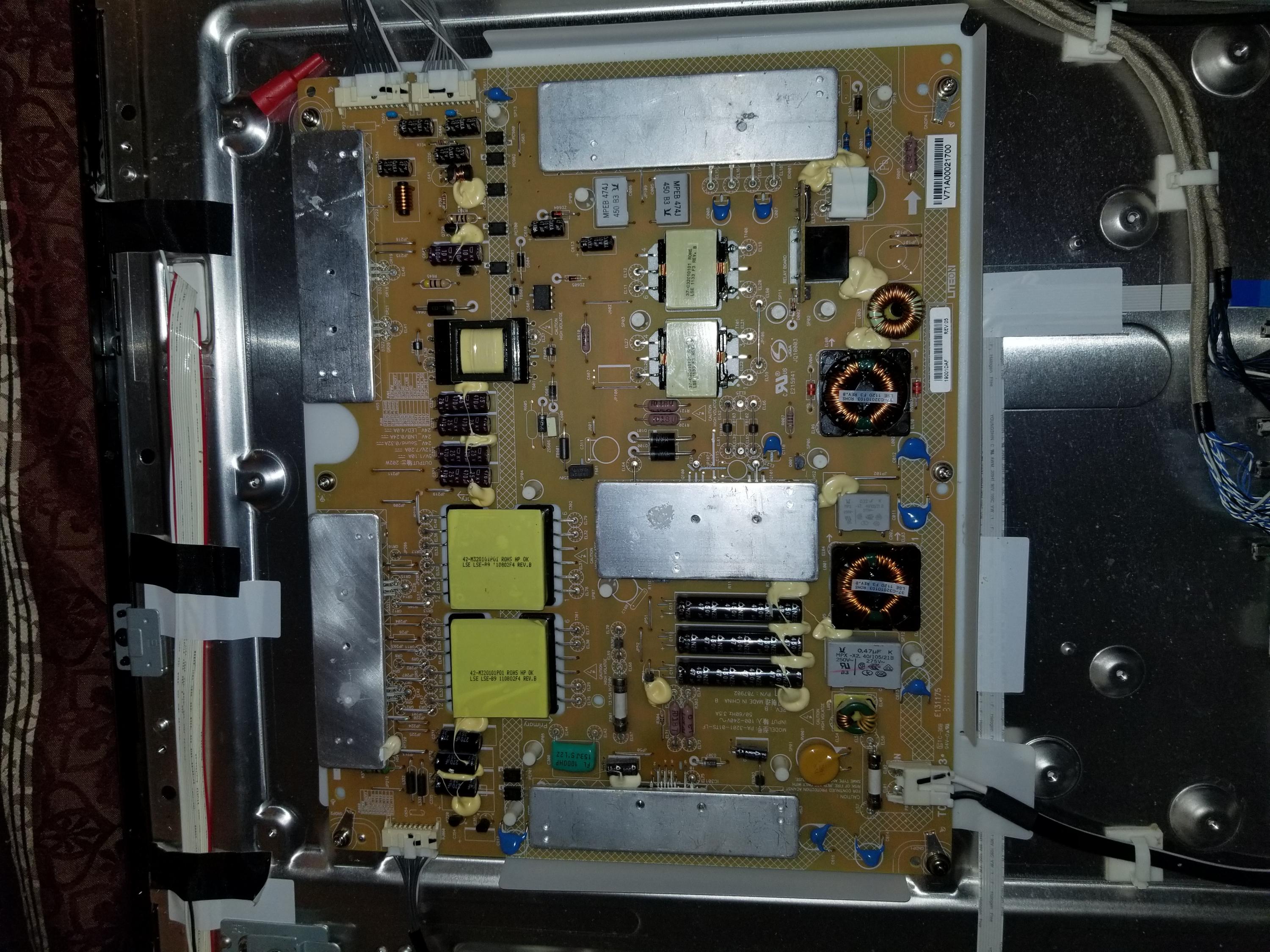

    Hello!
    My father-in-law gave me a Toshiba 42TL515U to fix because there's no picture, no sound, the fan turns on and the green light on the front panel blinks 3 times- pauses- and repeats. I'll be testing for continuity but am I better off saving some time and just replacing boards? I'm thinking power board first...
    Re: toshiba 42tl515u problems
    If I were you when asking for help I would:
    1) Up load good clear pictures of the whole back side of the TV showing all the boards to show how all the boards are connected together, the straight shot pictures of each board.
    2) Post the Voltage reading of the power supply connector that goes to the main board when the TV is off and when the power switch is activated. Each reading should have pin name and follow by the Voltage reading.
    3) Just remember that you have the TV in front of you, the helpers do not.

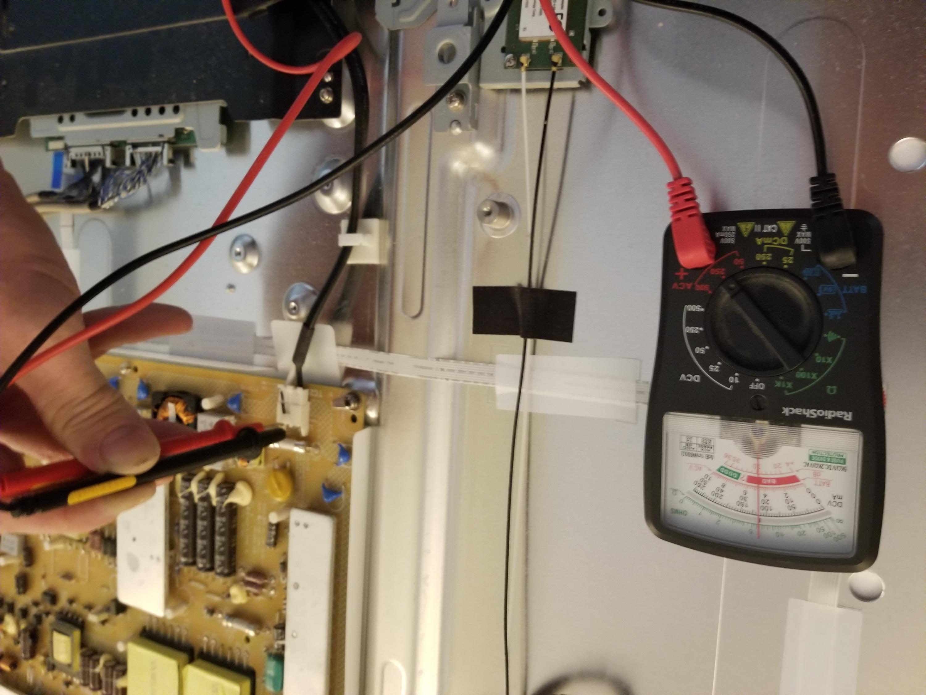

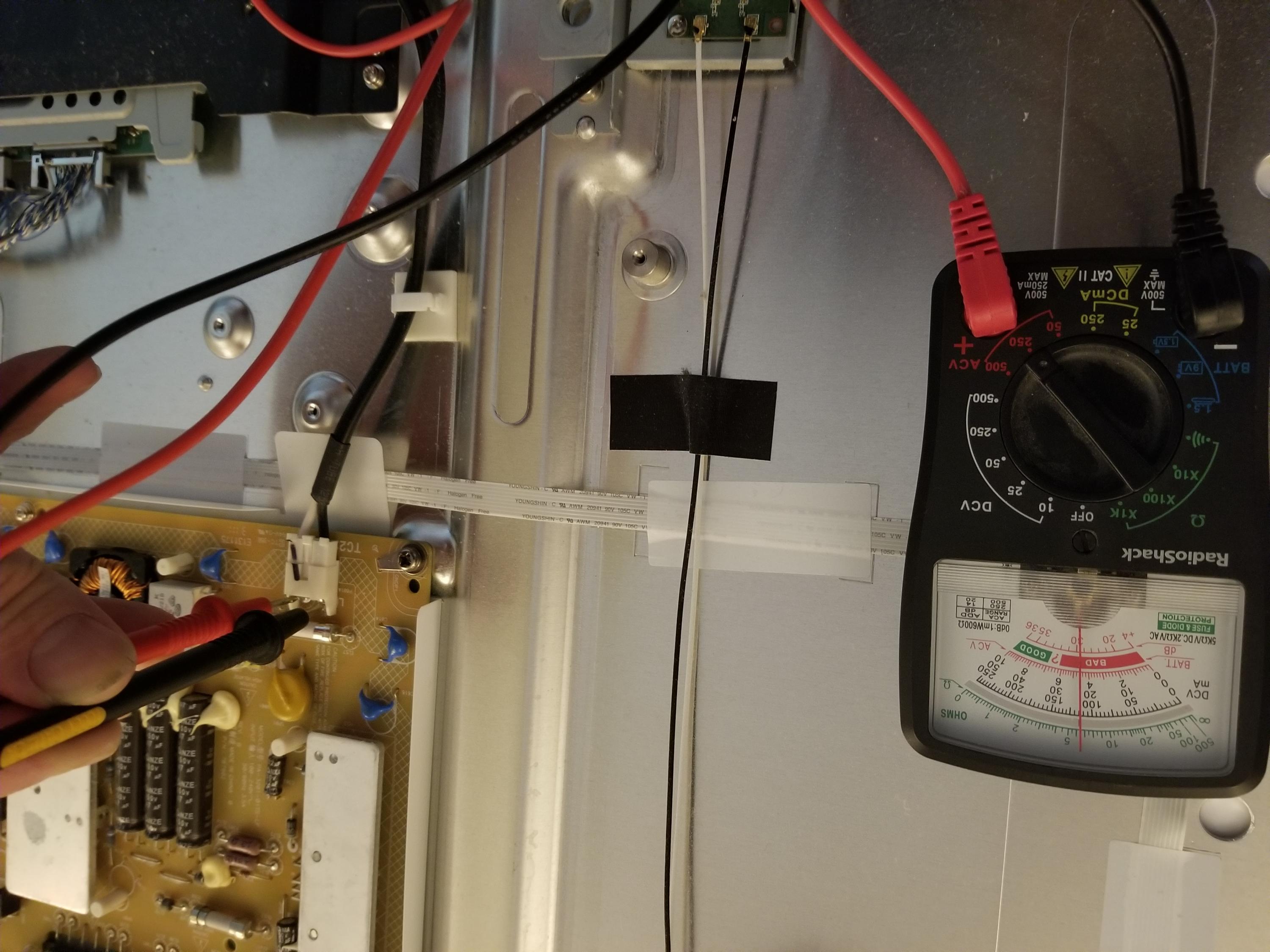

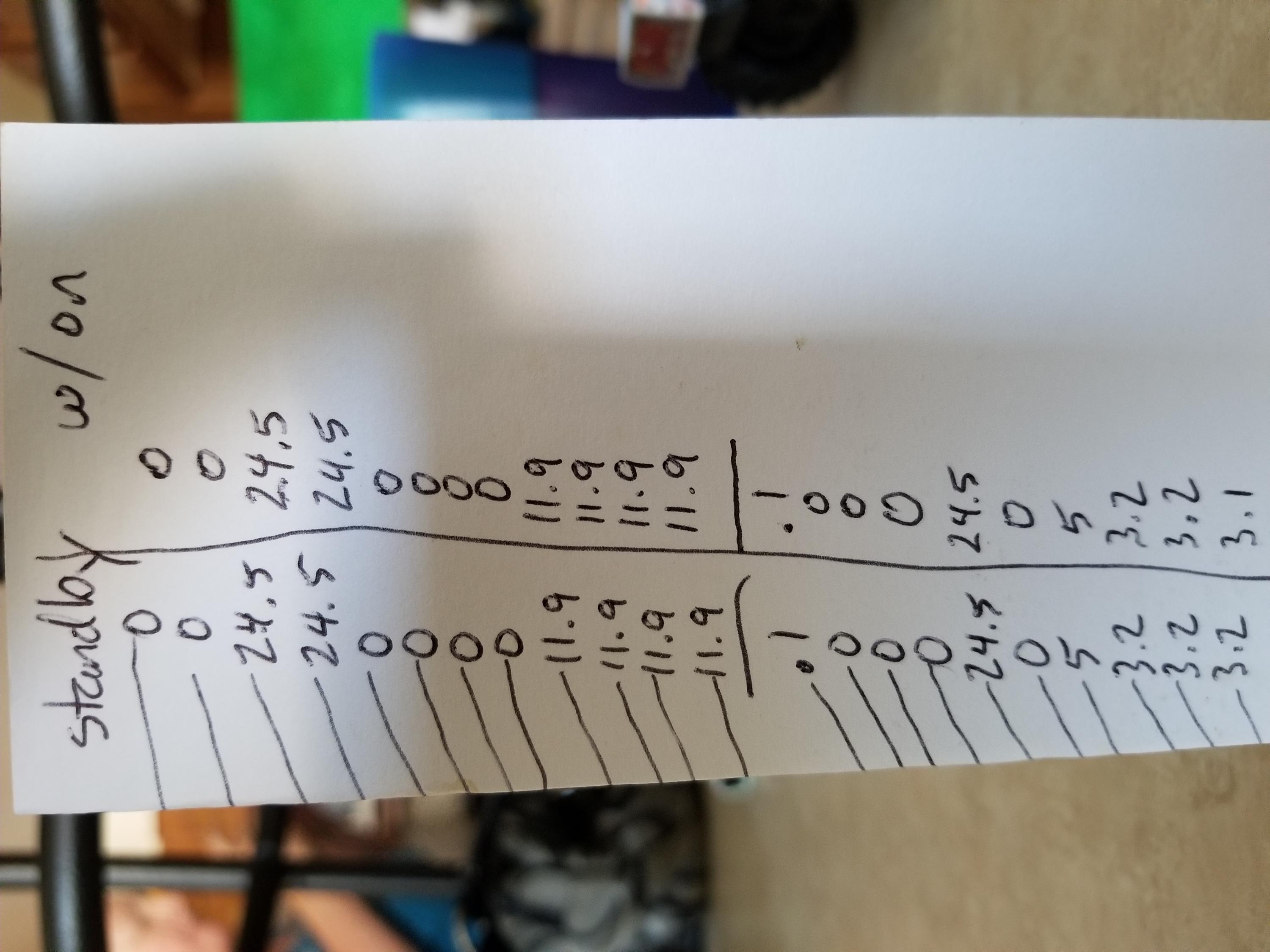

      The meter reading is the same with the set off and on.
        1) You only show the meter reading the incoming AC feeding the power supply board, you need to test DC Voltages on the two connectors of the power supply board that goes to the main board. The pins of the connectors have the pin nmae to tell you what each pin is for, so you need to qrite down the pin name and follow by the Voltage reading for each pin.
        2) You need to get digital meter to get more accurate Voltage readings.
        3) How much experience do you have repairing the electronics down to board level, component level?
          I thought I was doing something wrong there
          ty... will get the correct readings tonight.
          As you can probably tell, experience is limited.
            Parts for your TV:
            http://www.shopjimmy.com/catalogsear...shiba+42tl515u
            This is not going to be for beginner to repair.
                Thanks for the links. I've ordered a digital meter; going to try diagnostics first.

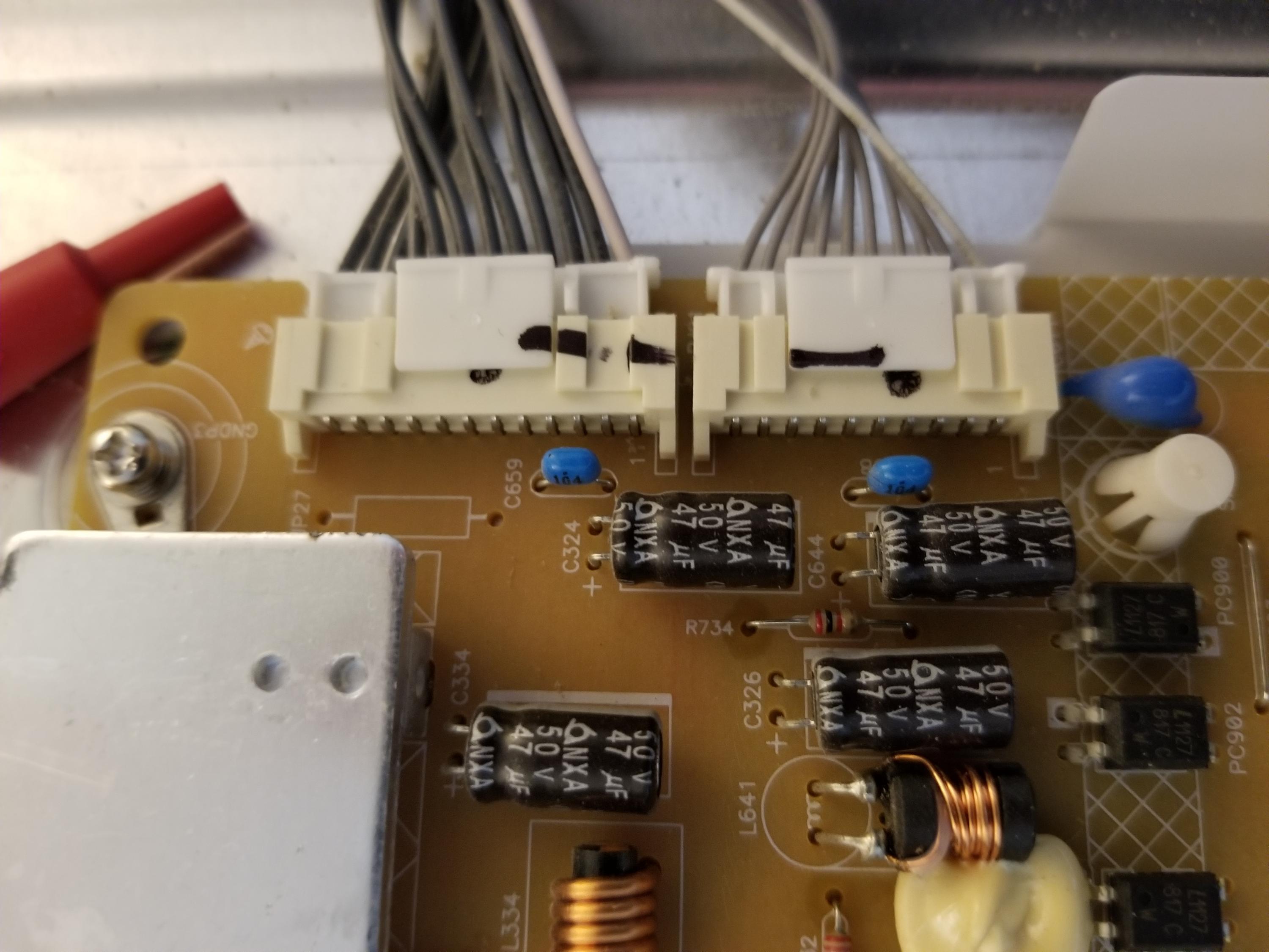

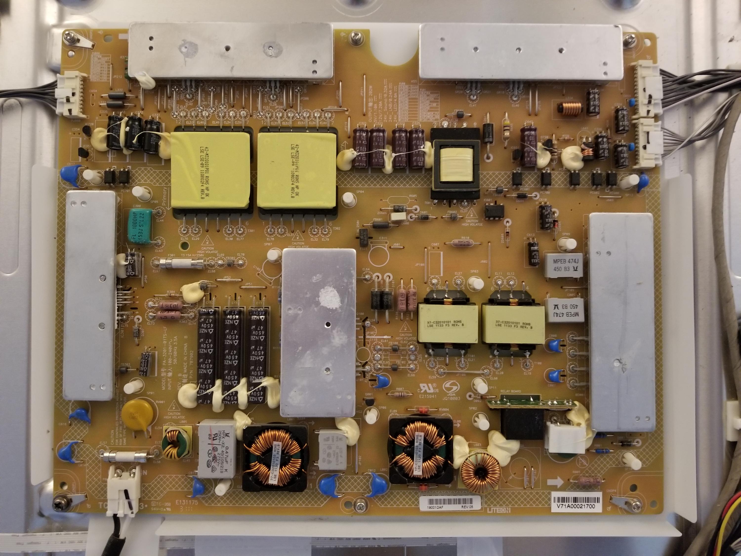

                  Readings taken off wire harness leaving power board going to main board. Would this mean power board is bad?
                  • Wheelman_60
                    • Oct 2016
                    • 15
                    Upon further research I see that I have 5 V supplying the main board so in fact this may be a bad main board.
                      I have the EXACT same symptoms, here are those readings. I noticed the BL_ON pin is low like Wheelman_60's
                      PJ90
                      Pin# - DESC - Standby - Powered
                      1 - 12V - 0 - 12V
                      2 - 12V - 0 - 12V
                      3 - 12V - 0 - 12V
                      4 - 12V - 0 - 12V
                      5 - GND - 0 - 0
                      6 - GND - 0 - 0
                      7 - GND - 0 - 0
                      8 - GND - 0 - 0
                      9 - 24V_SOUND - 0 - 24V
                      10 - 24V_SOUND - 0 - 24V
                      11 - GND_SOUND - 0 - 0
                      12 - GND_SOUND - 0 - 0
                      PJ91
                      1 - AC_DET - 0 - 3.3V
                      2 - POWER_SIG - 0 - 3.3V
                      3 - POWER_TV - 0 - 3.3V
                      4 - 5V - 0 - 5V
                      5 - GND - 0 - 0
                      6 - 24V_LNB - 0 - 24.6V
                      7 - GND - 0 - 0
                      8 - OPTION - 0 - 0
                      9 - BL_ONOFF - 0 - 0
                      10 - PWM - 0 - 0
                      PJ860 (connector to LED driver)
                      1 - PWM - 0 - 0
                      2 - BL_ONOFF - 0 - 0
                      3 - OPTION - 0 - 0
                      4 - GND_LED - 0 - 0
                      5 - GND_LED - 0 - 0
                      6 - GND_LED - 0 - 0
                      7 - 24V_LED - 0 - 24V
                      8 - 24V_LED - 0 - 24V
                      9 - 24V_LED - 0 - 24V
                        Do you have backlights? if not try unplug powerboard from mainboard, turn tv on see if backlights come on.
                          PJ90
                          1 - 12V - 0 - 12V
                          2 - 12V - 0 - 12V
                          3 - 12V - 0 - 12V
                          4 - 12V - 0 - 12V
                          5 - GND - 0 - 0
                          6 - GND - 0 - 0
                          7 - GND - 0 - 0
                          8 - GND - 0 - 0
                          PJ91
                          4 - 5V - 0 - 5V
                          5 - GND - 0 - 0
                          7 - GND - 0 - 0
                          8 - OPTION - 0 - 0
                          10 - PWM - 0 - 0
                          1 - PWM - 0 - 0
                          3 - OPTION - 0 - 0
                          4 - GND_LED - 0 - 0
                          5 - GND_LED - 0 - 0
                          6 - GND_LED - 0 - 0
                          You do not have either BL-ON or Dimming control signals from the main board.

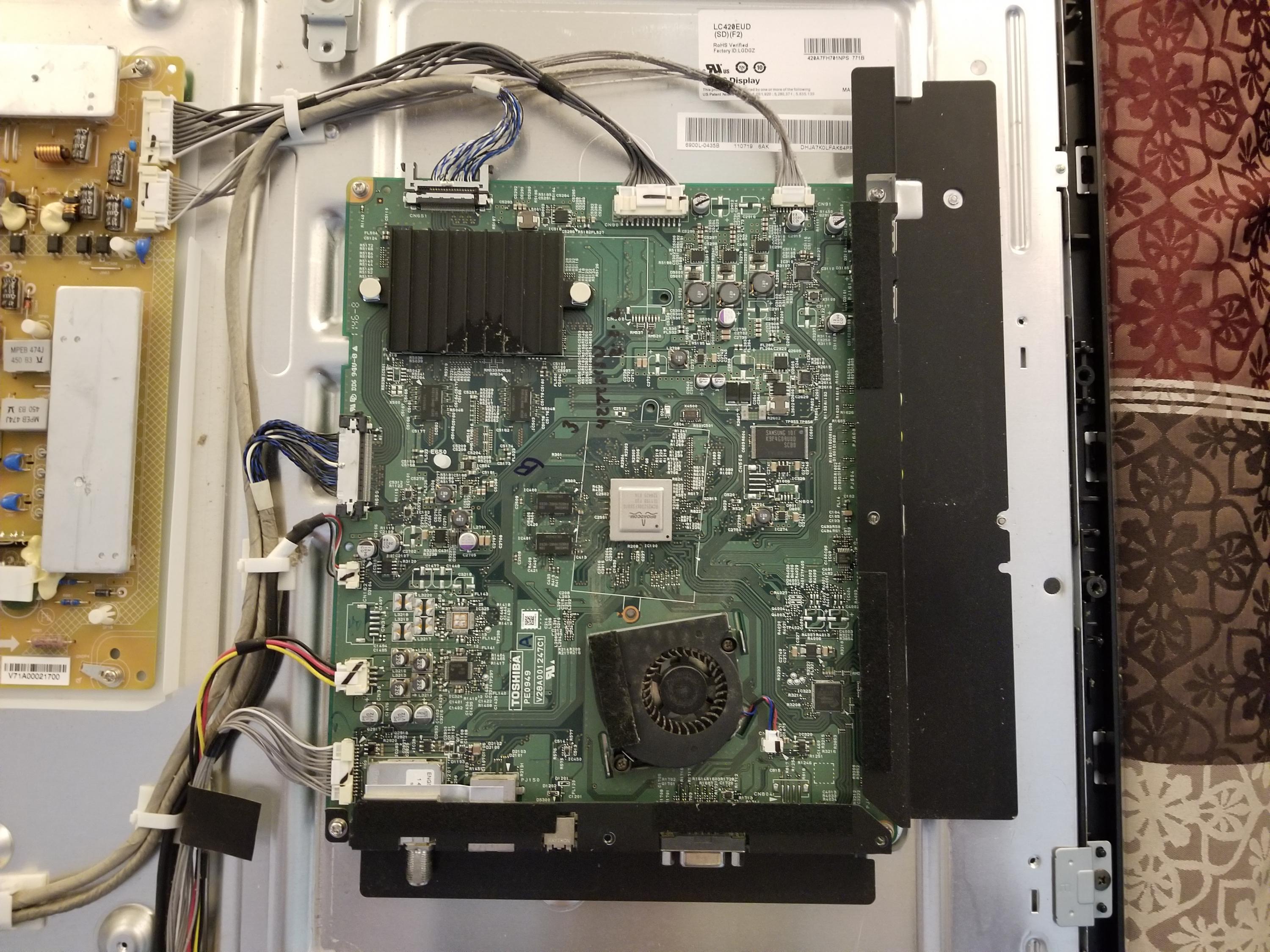

                                    Is this your mainboard? make sure the numbers on the white sticker match. https://www.shopjimmy.com/toshiba-75...main-board.htm
                                    • doesntmind
                                      • Feb 2014
                                      • 65
                                      • usa
                                      This is my board, the resolution in shopjimmys image wasnt crystal clear but from what I can make out the numbers match
                                      • nomoresonys
                                        • Jan 2013
                                        • 12331
                                        • U.S.
                                        Looks like several screen sizes will work for this but sold out at about 7 places I looked online, might need to go with one of the repair services that you send your board to and they fix it if they can and send it back, unless you can do it, this shows which models will work. https://encompass.com/item/8421683/T...e0949a,_Main(f
