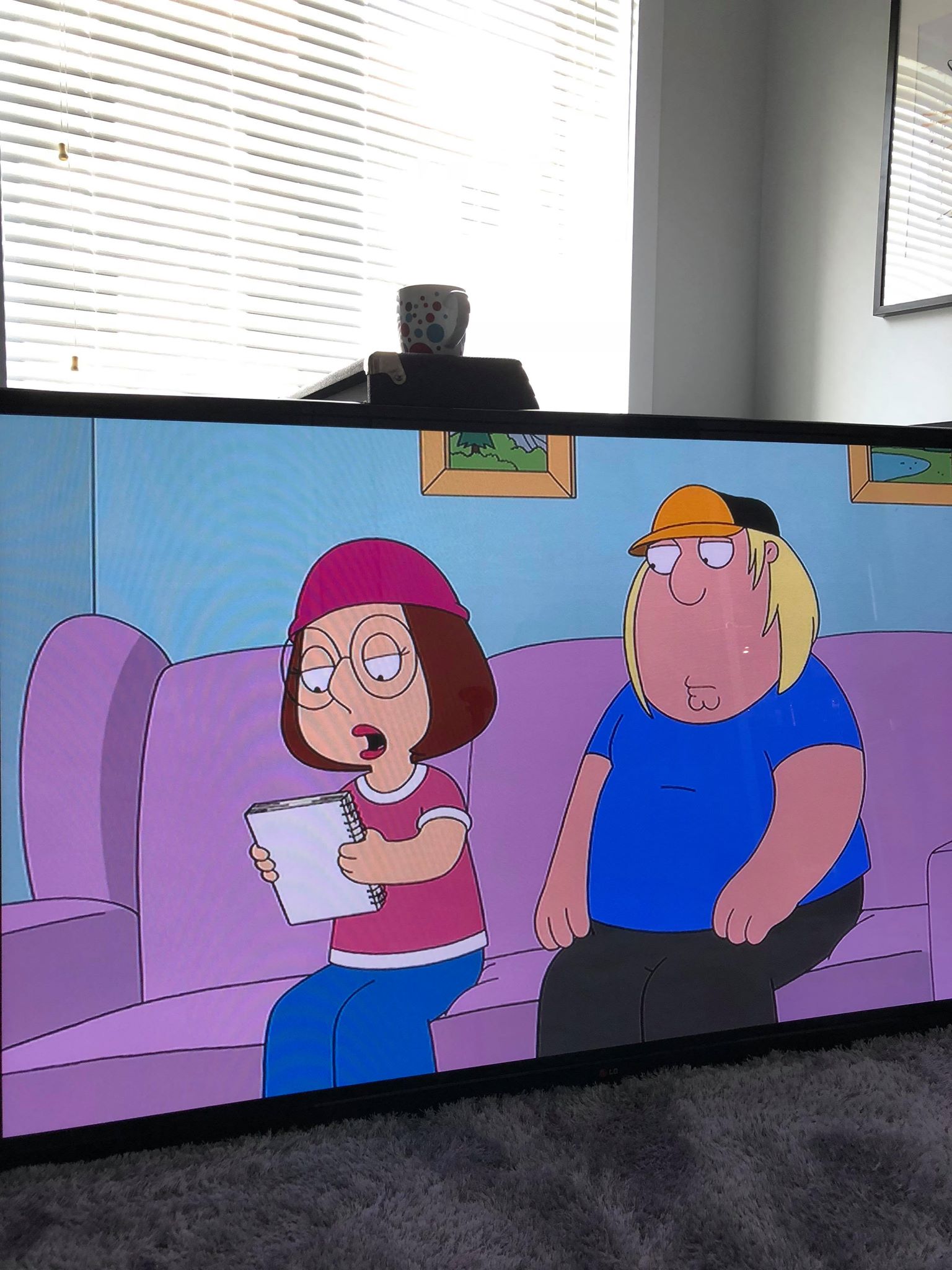

    Hey guys,
    I'm trying to fix my plasma T.V.
    Well, at first I had bad caps on both of buffers, now I have image but the tv "click" and reboot randomly every 5-10 minutes.
    Any help will be gladly appreciate;

      Re: LG 60pb5600 plasma random reboot
      Well, there was no info about the caps for the buffer over the web , at first it was a black screen problem. Then, I replace all commonly broken caps by something equivalent but 3kv instead of 1kv. I dont think its the problem cause it show the image perfectly now just randomly on and off. I'll check for cold solder joints on the PSU and mainboard. Thks
