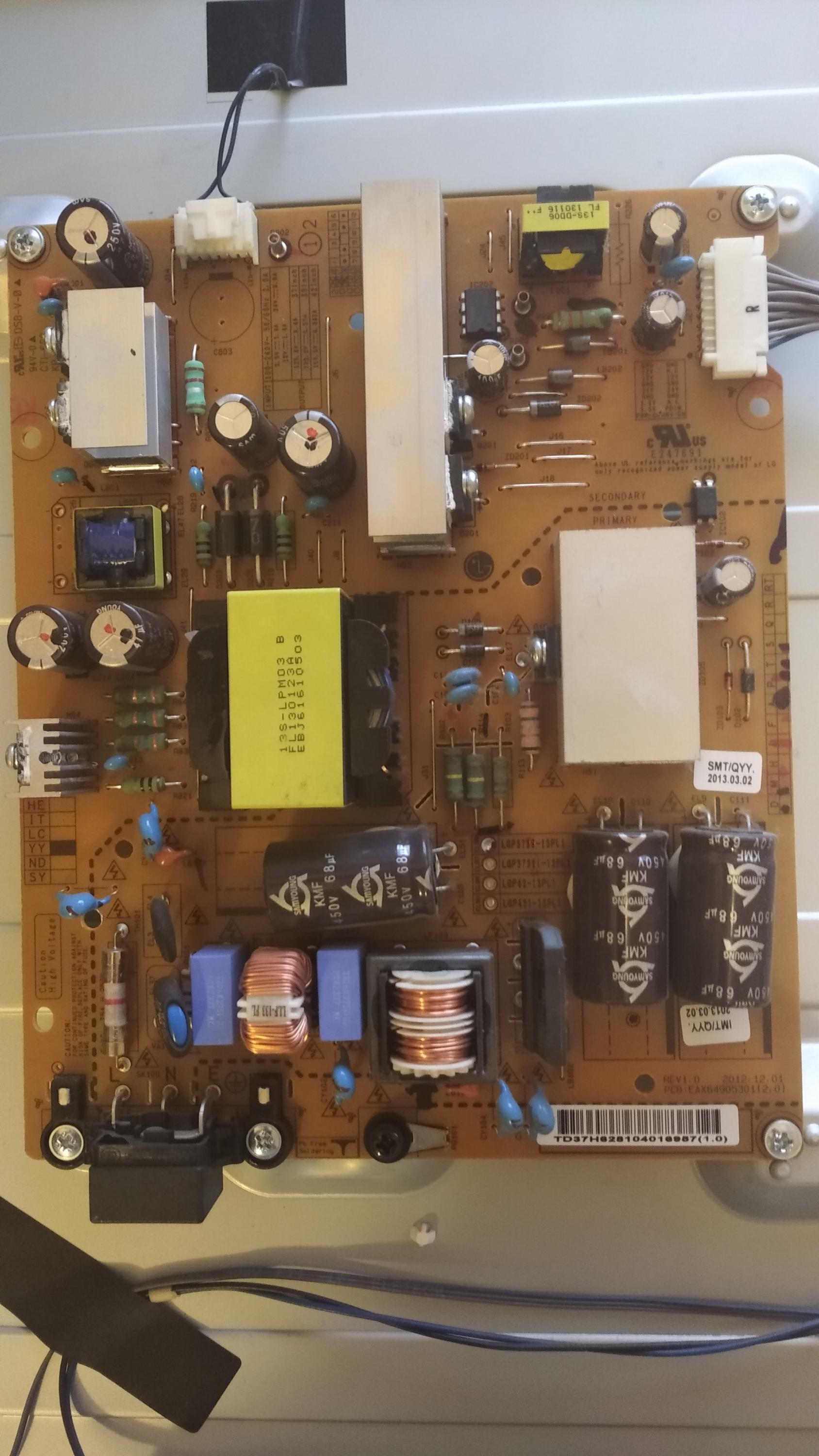

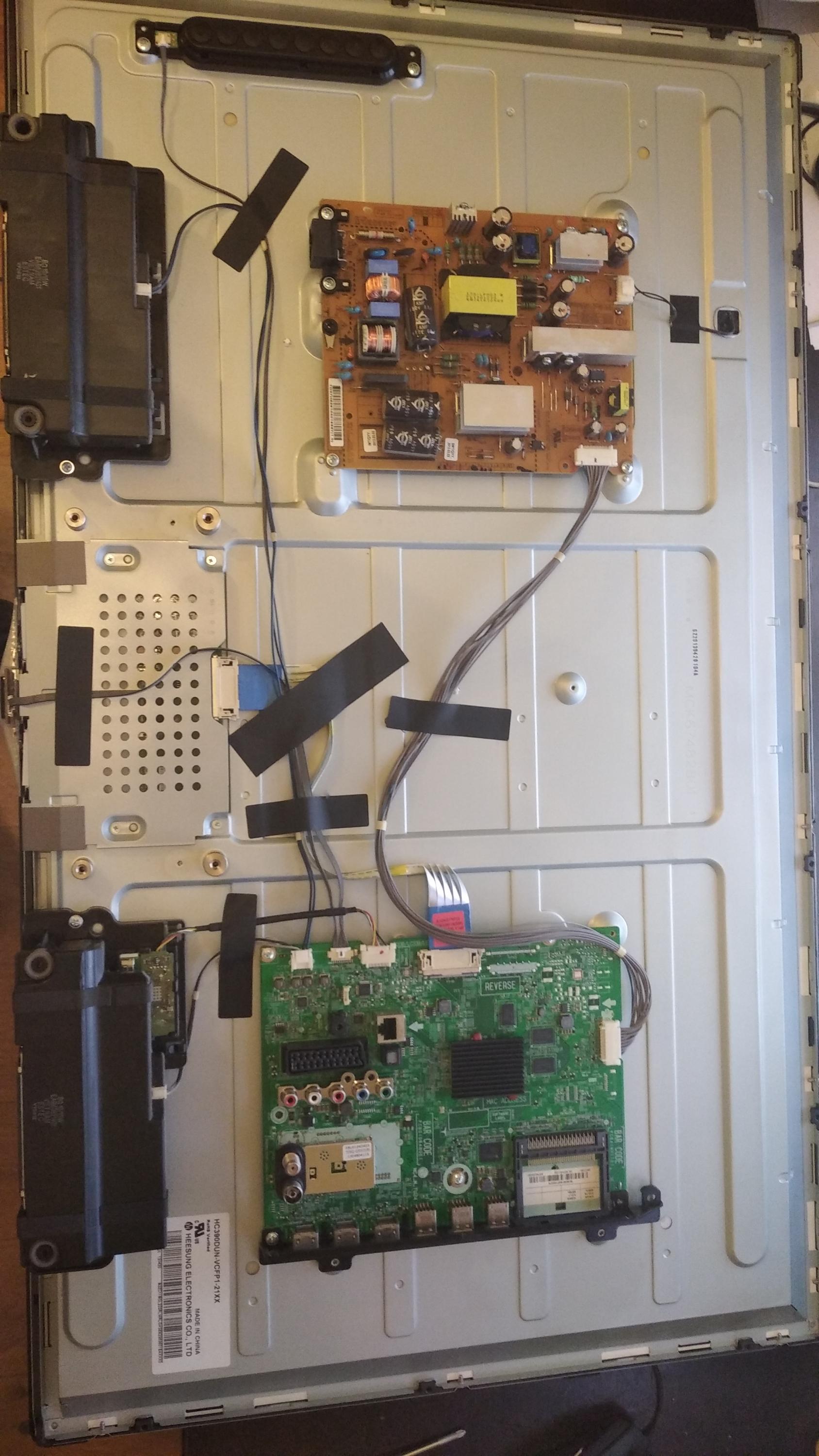

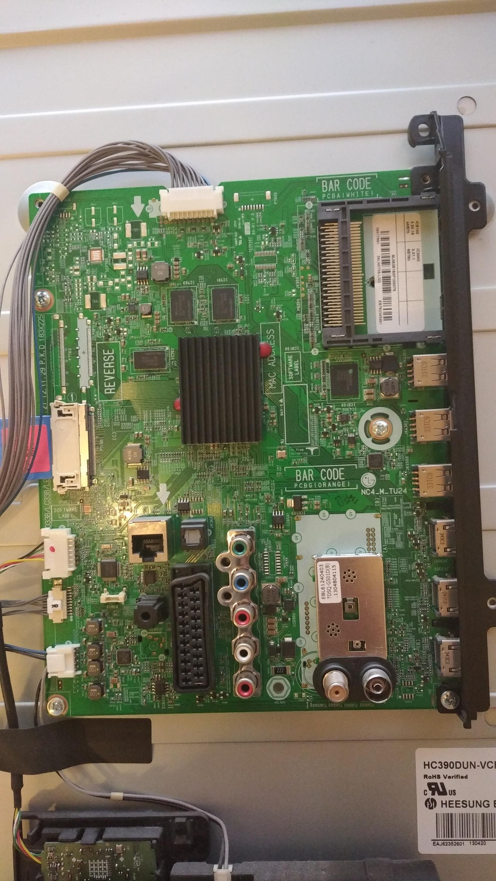

    Inspection of the device gave me the following information:
    - PSB: eax64905301 Rev1.0
    - MB: 183X225 (The other numbers are covered by connectors - that I did not remove so far)
    - Caps on those boards look good from visual inspection.

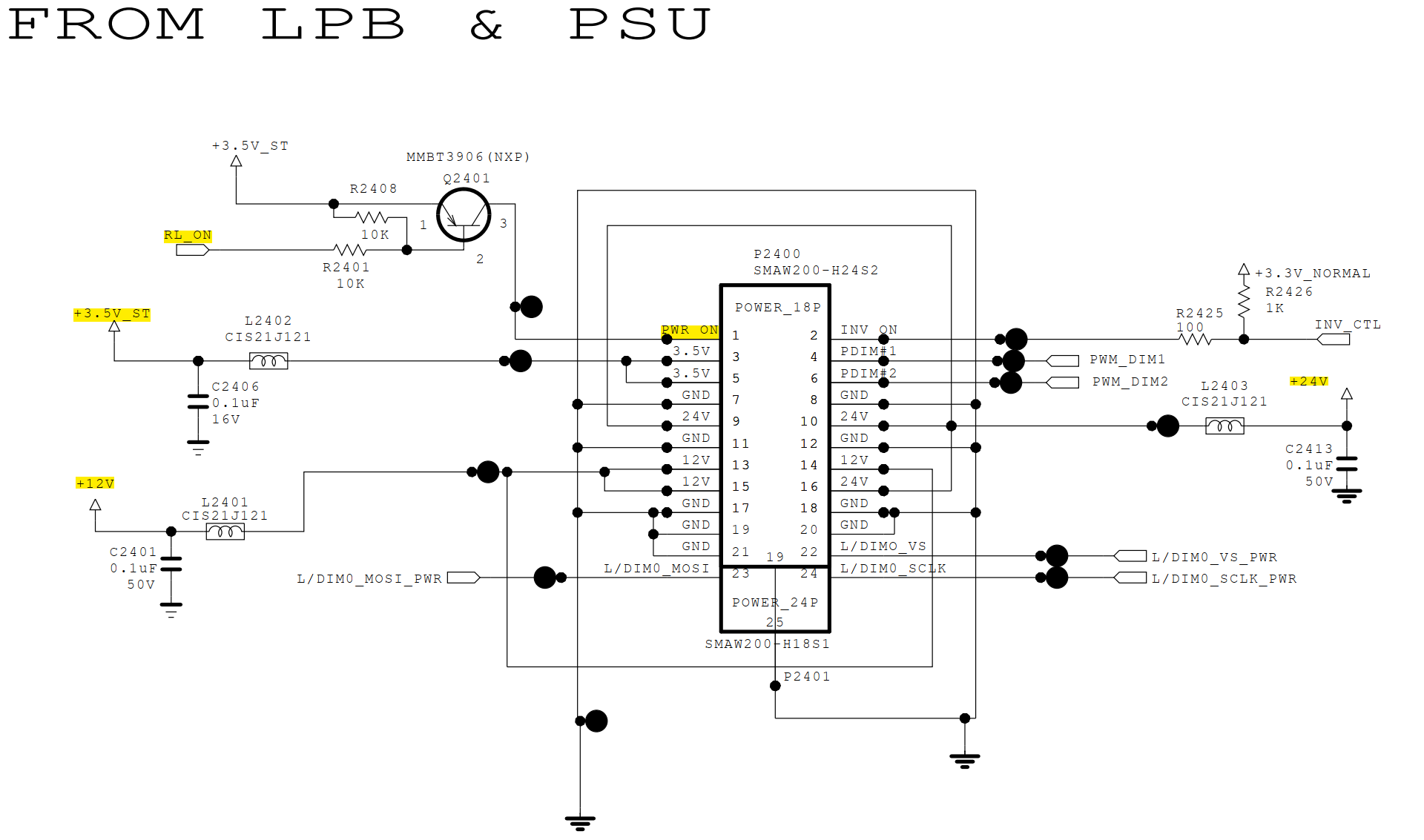

    H/W Measurements performed:
    - I checked the connection between Mainboard (MB) and the PSB. There is a 24p connector with the following pinout:
    PINNUMBER: (PINNAME) V_MEAS_STDBY -> V_MEAS_ON
    17: (GND) 0V
    15: (12V) 0V ->12V
    13: (12V) 0V ->12V
    11: (GND) 0V
    09: (24V) 0V ->24V
    07: (GND) 0V
    05: (3.5V) 3.5V -> 3.5V
    03: (3.5V) 3.5V -> 3.5V
    01: (PWR-ON) 0 -> 3.5V
    18: (GND) ?
    16: n.c ?
    14: (12V) ?
    12: (GND) ?
    10: (24V) ?
    08: (GND) ?
    06: n.c ?
    04: (PDIM #1) ?
    02: (DRV-ON) ?
    - I performed oscilloscope / multimeter measurements with the TV in standby and after switching it on. The results are written behind the pinout.
    - The second row of pins could not been reached because of the connector attached (maybe I will repeat the measurement with another tip - but in the end, there seems to be no voltage on the second row, that is of interest)
    - The PWR-ON Pin was oberved toggeling during the reboot loops desribed above. Everytime, the TV restarted, the PWR-ON Pin switched to low, coming back to high a few moments afterwards.
    - Thus, also the 12V and 24V where switched on and off.

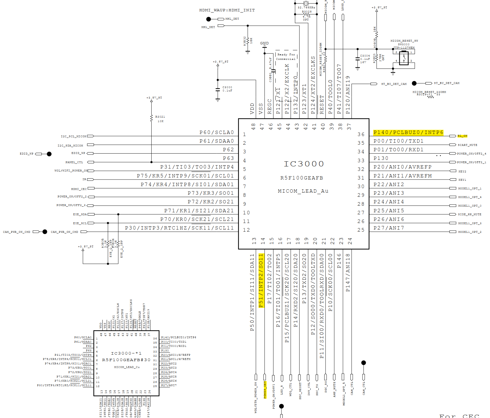

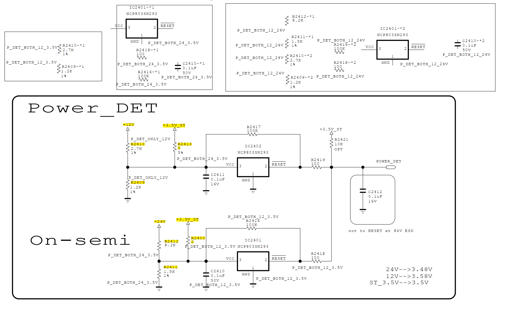

    Following the trace of the POWER_OFF_BY_ACDET entry in the Service Menu I found this post from densmith who performed an excellent analysis on a different model:
    https://www.badcaps.net/forum/showpo...5&postcount=58
    My case might be similar. However, the voltage detection seems to work a bit different on the LG 39LN5859.
    I got my hands on the service manual for my TV. It features the schematics of the MB - I attached the part, where some kind of voltage monitoring is done.
    In contrast to the 52LG50 analyzed by densmith, the LG 39LN5859 seems to not monitor the AC voltage directly (via some Opto-coupling-device).
    Instead it monitors the 12V and 24V rail and uses a NCP803 (a reset monitor, which issues an open-drain reset signal when the input voltage goes below 2.93V).
    The 12V, 24V and 3.5V_ST have their origin on the Power Supply Board. The POWER_DET is connected to the IC3000 - which probably is responsible for managing the power status of the TV (It also has the RL_ON as an ouput, which drives Pin 1 on the PSU connector and switches on the 12V / 24V rails on the PSU)
    What I do not understand looking at the circuit: Why are the Resistors R2413 and R2400 (value both 0R0) hard-pulling the signal to 3.5V_ST. That whould render the 12V/24V voltage dividers (R2412 / R2411 and (R2410 / R2409) useless.
    Am I missing something?
