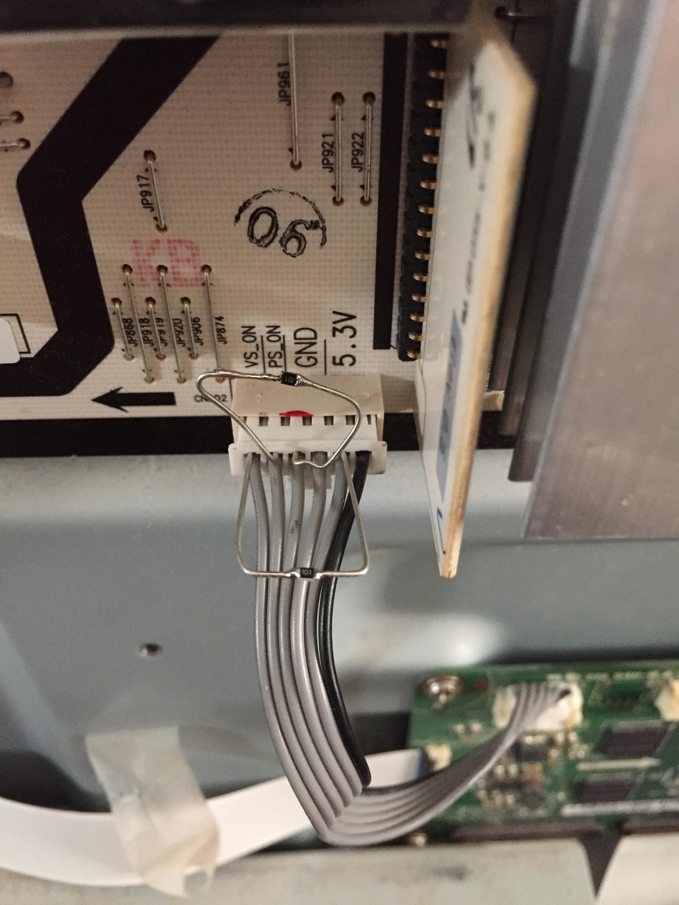

    Just when I swore I'd never fix another TV, this monster plasma found it's way to my door. It's the classic power cycling, clicking relay, no picture kind of failure you guys love to figure out!
    Threads for reference:
    https://www.badcaps.net/forum/showthread.php?t=29327
    https://www.badcaps.net/forum/showthread.php?t=27535

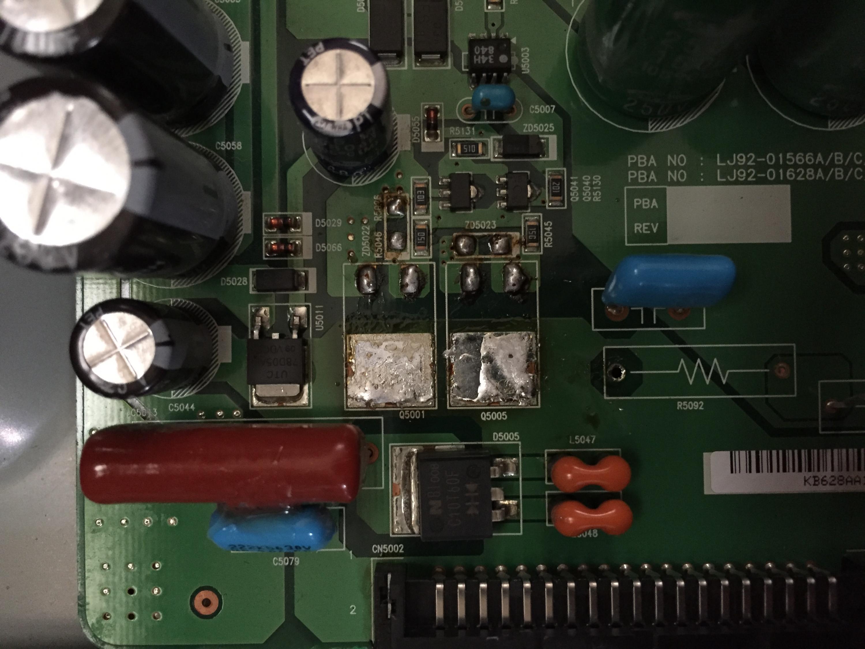

    The curve ball with this set is that it could be anything, allow me to explain why.....
    When I removed the back panel, the connector going to the front panel was disconnected from the main board, along with the speaker connection. Someone was definitely in there, making this my least favorite kind of repair, who knows what they did? Referring to the threads above, I began trying to pinpoint what had failed. When the set has power before cutting off, VS and VA are there(202 & 55). I disconnected the X and Y mains one at a time hoping for a change. Nothing, still clicking. Next up would be the main/logic board. Not having any of the correct value resistors to force power on without the main board, I had to get creative.(Don't judge me, it's not like I can go Radioshack anymore!)
    When I Plugged in the set with the resistors in place, it powered up without clicking( LVDS and power connector from the main board were removed). No grey flicker or any sign of life from the panel. I jumped pins 3 & 4 on the logic board and crossed my fingers, but no test pattern was displayed. I decided to look over the SUS boards one more time to see if there was anything I missed. To my horror, I discovered that two transistors and 2 zener diodes had been removed from the Y board!
    Now I'm at a loss because I have no idea what kind of repair was attempted. In a desperate attempt to make some kind of progress with this set, I pulled a similar samsung Y board from my graveyard, removed what I hope are the same value transistors and diodes, and soldered them on.
    With the Frankenstein Y board back in the set, I repeated the panel test. This time whether or not the logic board was jumped, I got a grey flicker on the panel after power up, followed by grey snow at the top of the screen that slowly faded away. The panel does glow for a short time, then cuts off to black. I wouldn't mind throwing another main board in there since that seems to be the culprit, but the lack of a successful panel test has me weary. Could it be the logic board, the main board, all boards?
    Help me O wise badcap veterans, you're my only hope!

    Re: Samsung PN58B650S1F Power Board Clicks, No Picture
    does the LED on the control board blink at 1 second intervals?
          Originally posted by WHaThEFLuX
          Yes sir, there's also another green LED on the control board that blinks briefly when I power up the set.
          briefly, or every 5-7 seconds?
          if briefly your CTRL board is not running for some reason - probably a shutdown.
          check 5V supply to control board.
          check VSON signal from control board to PSU.
          compare this VSON drop using a second multimeter to Vs/Va drop - see if VSON drops then Vs/Va drops (scope can also be used for this purpose if it is a DSO)

              It's also worth noting 3 things:
              1. I went slightly "mad scientist" on the main board and removed the two EEPROM ics on the back and put them into a programmer(wasn't sure which one held the right information). One of them was a single line of code with ENG as a note, I'm assuming it's the language configuration. The other one was completely blank, I'm guessing this is the EEPROM that so commonly gets fried when the main board malfunctions.
              2. I re-attempted the panel test in complete darkness. This time, I was able to see 2 lines of color on the panel in the upper left corner. They seemed to be changing color in a pattern, indicating that the panel test is functioning at some level.
              3. I noticed that the transistors(or FETS, not really sure what they are exactly) I replaced on the Y board get hot way too fast when the set is on. I attribute this to either them being the wrong value components or the original issue with the Y board causing these components to cook. This would explain why they were removed in the first place, and also why the panel test is failing(or working in a very minimal way).
              I went ahead and ordered a replacement main board since I think we can all agree that the original is toast, but the control board and the Y board still remain a mystery. If anyone can shed some light on what those components on the Y board are and their values, or how I would be able to find out that information it would be greatly appreciated. Lastly, if I plug all these boards with potential problems into the "new" main board, could I fry it like the original?
                    UPDATE:
                    I have now dubbed this project the “trail of fail”, although I did make some progress.
                    I was able to source the correct components for the Y board, once those pieces were in place I attempted the panel test again, and this time I was greeted with beautiful colors!
                    So I know the panel’s good now, and can assume that the sustain boards are functioning correctly. The original main board causes the power cycle, and the used ebay main board makes the set behave exactly the same way. I found a used control board for a whopping $7 and threw that in there as well with the same result.
                    I’m aware that there’s a good chance the ebay boards could be bad, but other than that I’m at a loss. Do I return the control and main board, then try my luck with another main from a different seller? Are there any other diagnostic tests I can perform that will give me some clarity?
