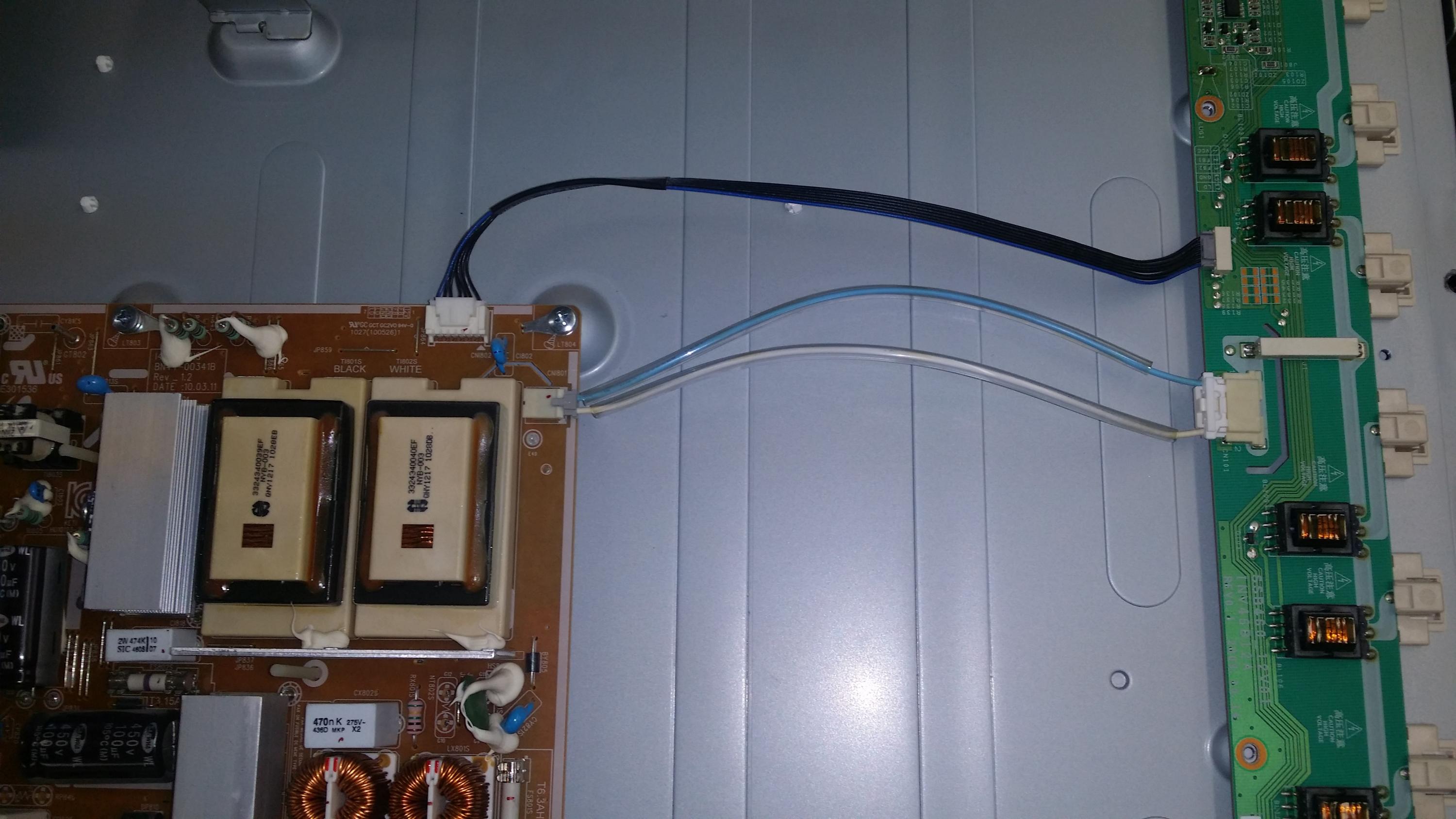

    i can see a dim picture in the dark w flashlight
    this is a lcd pannel
    first time working on them
    i have fixed a lot of led backlights

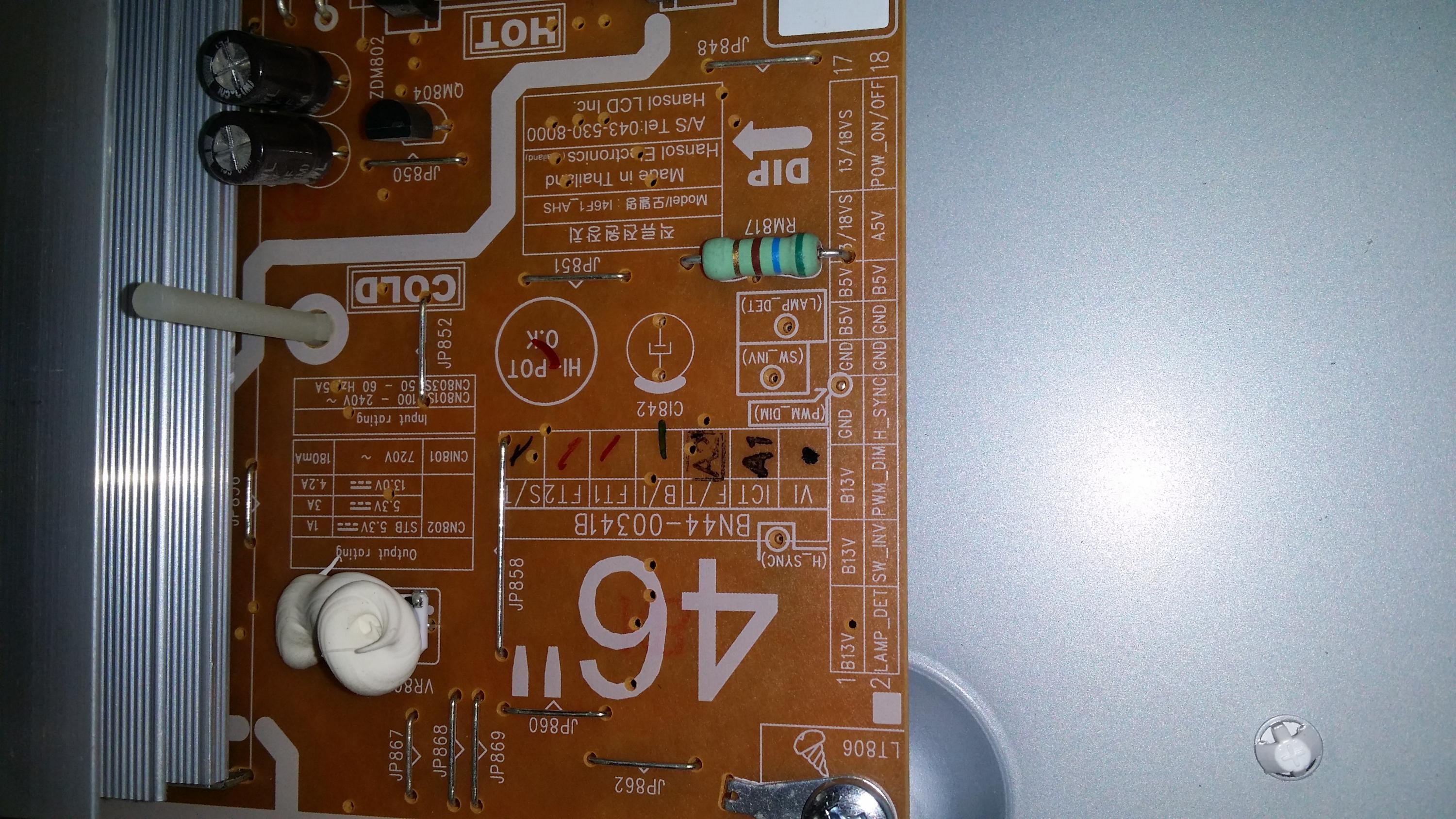

    voltage table in attachment
    1/12.3v
    2/0v
    3/12.3v
    4/5v
    5/12.3v
    6/2v
    7/0v
    8/1.6v
    9/0vv
    10/0v
    11/5v
    12/0v
    13/5v
    14/5v
    15/12.3v
    16/5v
    17/12.3v
    18/0.8v

    Re: Samsung LN46C610N1F picture/sound ok, no light
    We need to see the voltages on the LED connector. Measure the voltages on the +ve and -ve pins WRT GND ie BLACK lead of DMM on the chassis (GND). Report your findings.

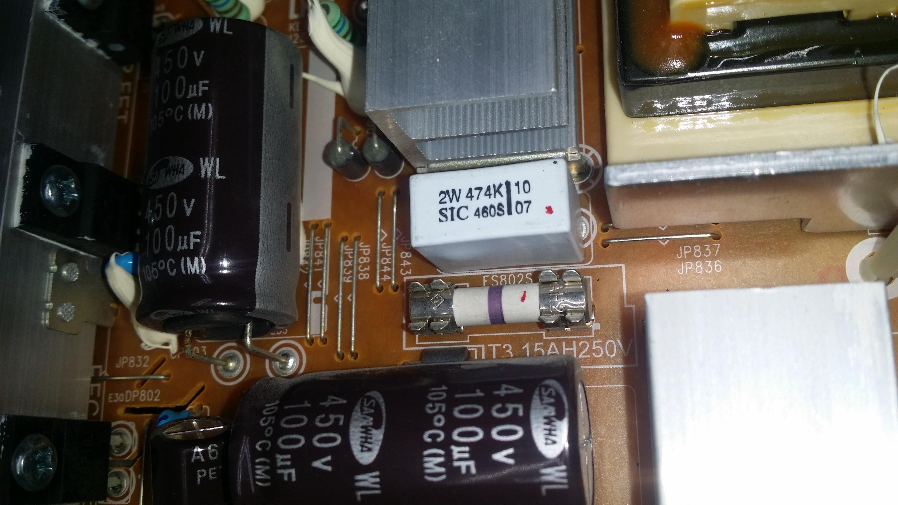

          Lets see the straight shot pictures of the whole top side of this power supply board.
          Do you have about 380vdc reading right between the two legs of the main filter cap in the primary side?
            I suspect that it has bad cap CI818 (2W 474K).
              help me out here
              you want the voltages from the blue and the white cable?(check attachment)
              they are 0v from chassis
              blue to white is 3.5v at startup drops to 0v
                    1) See post #6 to see if that cap CI818 has any sign of bulging.
                    2) The fuse right next to that CI818 is good, correct?
                          The CI818 is the commonly failed cap in the inverter circuit section, it will be bulging on the sides and lost its capacitance.

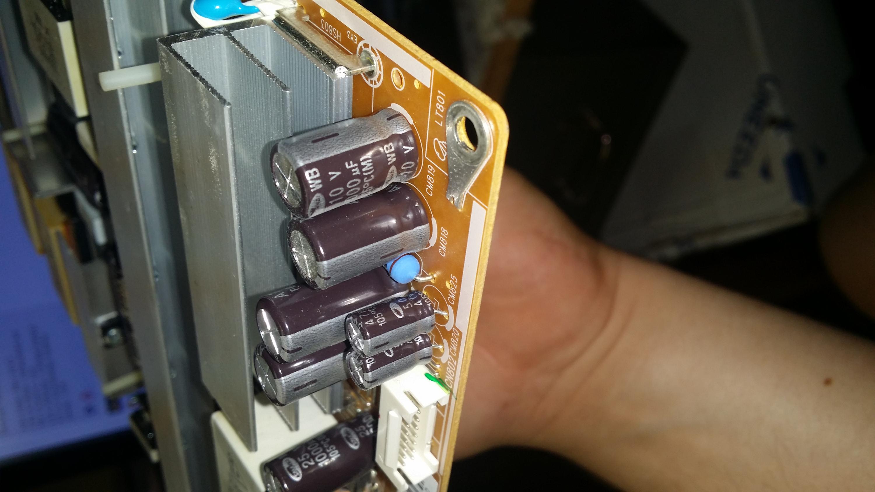

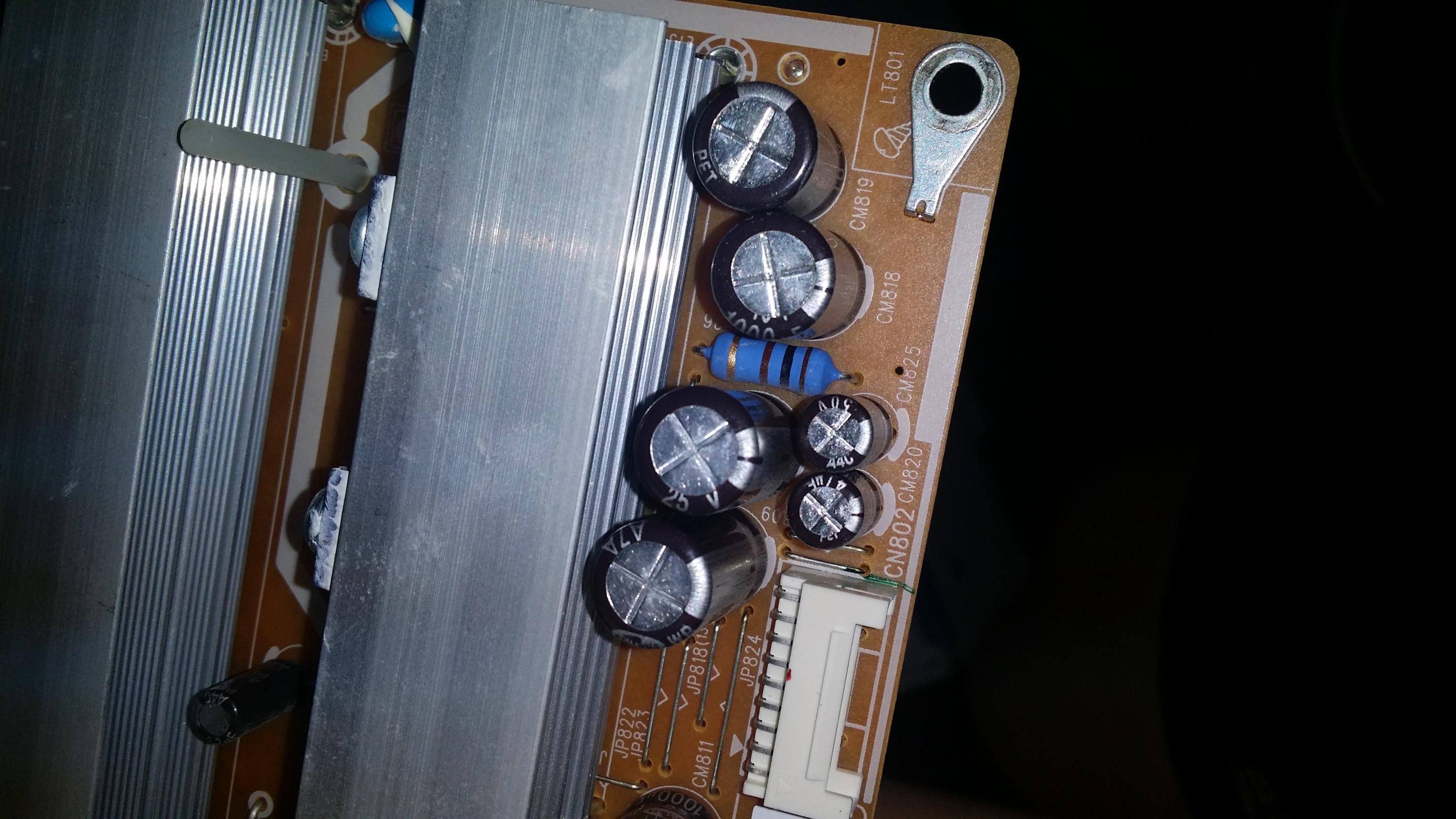

                            checked the cap and the surrounding ones
                            it is called cm818 on my board 10v 1000qf
                            they are in perfect shape
                            and 100% on the esr meter
                              Nope, It is CMI818 white rectangular shape cap right next to the fuse in the middle of the board, it has '2W 474K' printed right on the top, it is Polypropylene type cap not Lytics cap.
                                found it
                                its bulging too
                                thx guys
                                  Yep, typical failure.
