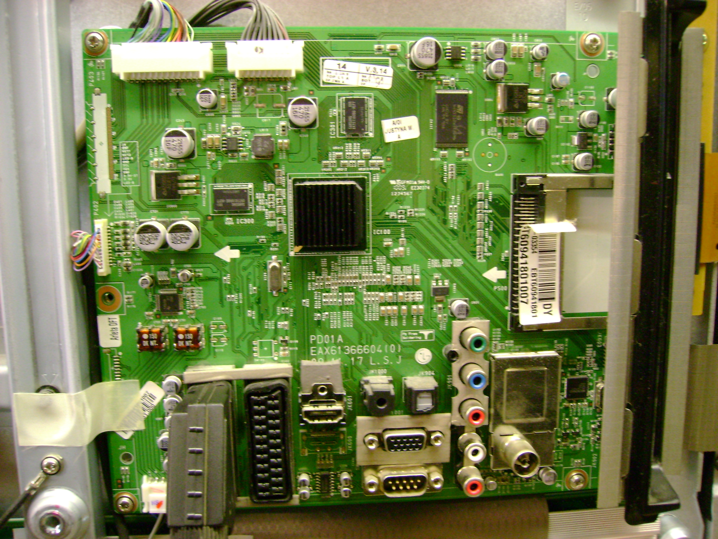

    Turns on fine with good sound but no picture. All voltages are present and
    correct and it seems that the Y and Z boards are doing their job because
    the heatsinks are getting warm. The curious thing is that there's a LED flashing
    on the LVDS board with a sequence of two short flashes, then a longer one, then another short one, then a very long one. This keeps on repeating and it
    looks like a fault code. Any ideas?

            Hi John, Can you post photo's of your circuit boards and how they interconnect?

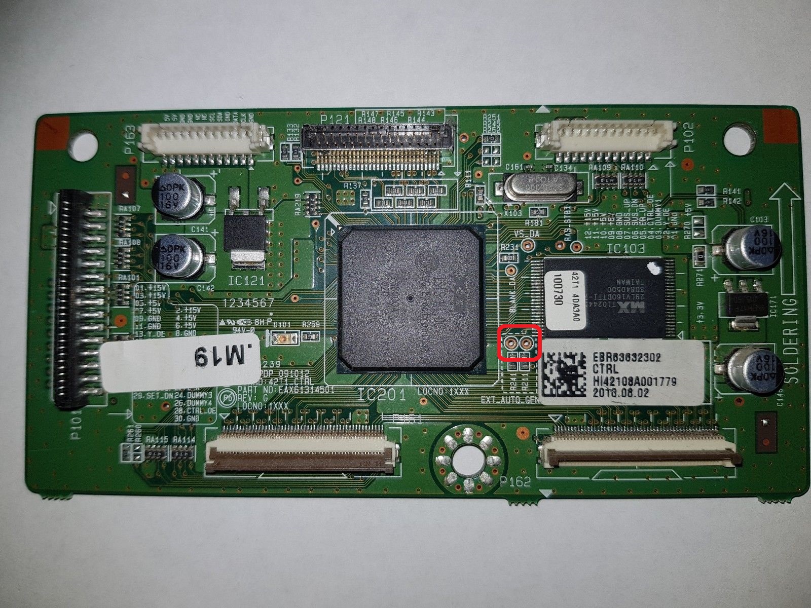

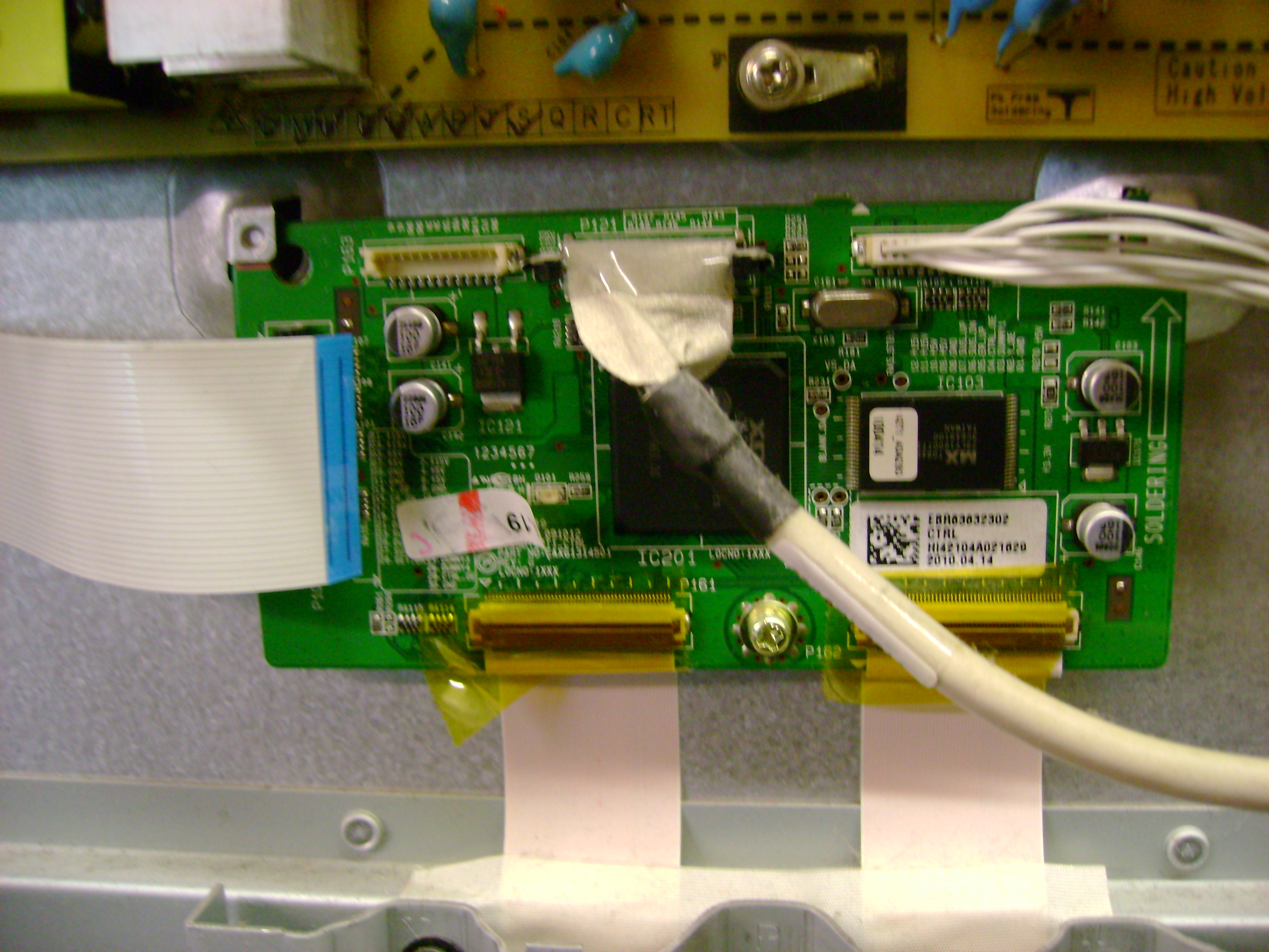

              Re: Lg 42pj550
              Disconnect the ribbon cable between the mainboard and logic board and short the two pads marked Auto Gen on the logic board. Power up and you should see test patterns displayed on the screen.

                Re: Lg 42pj550

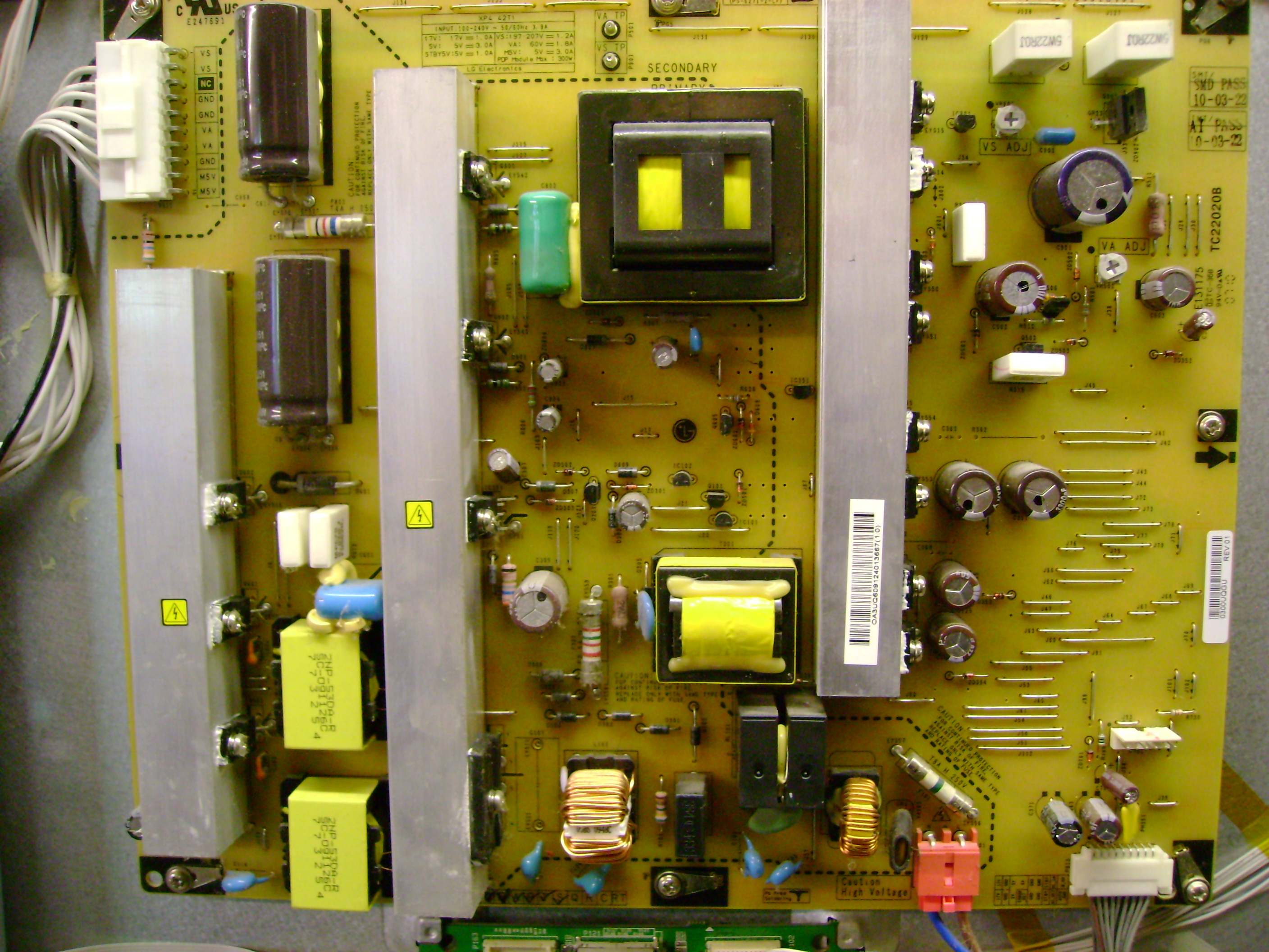

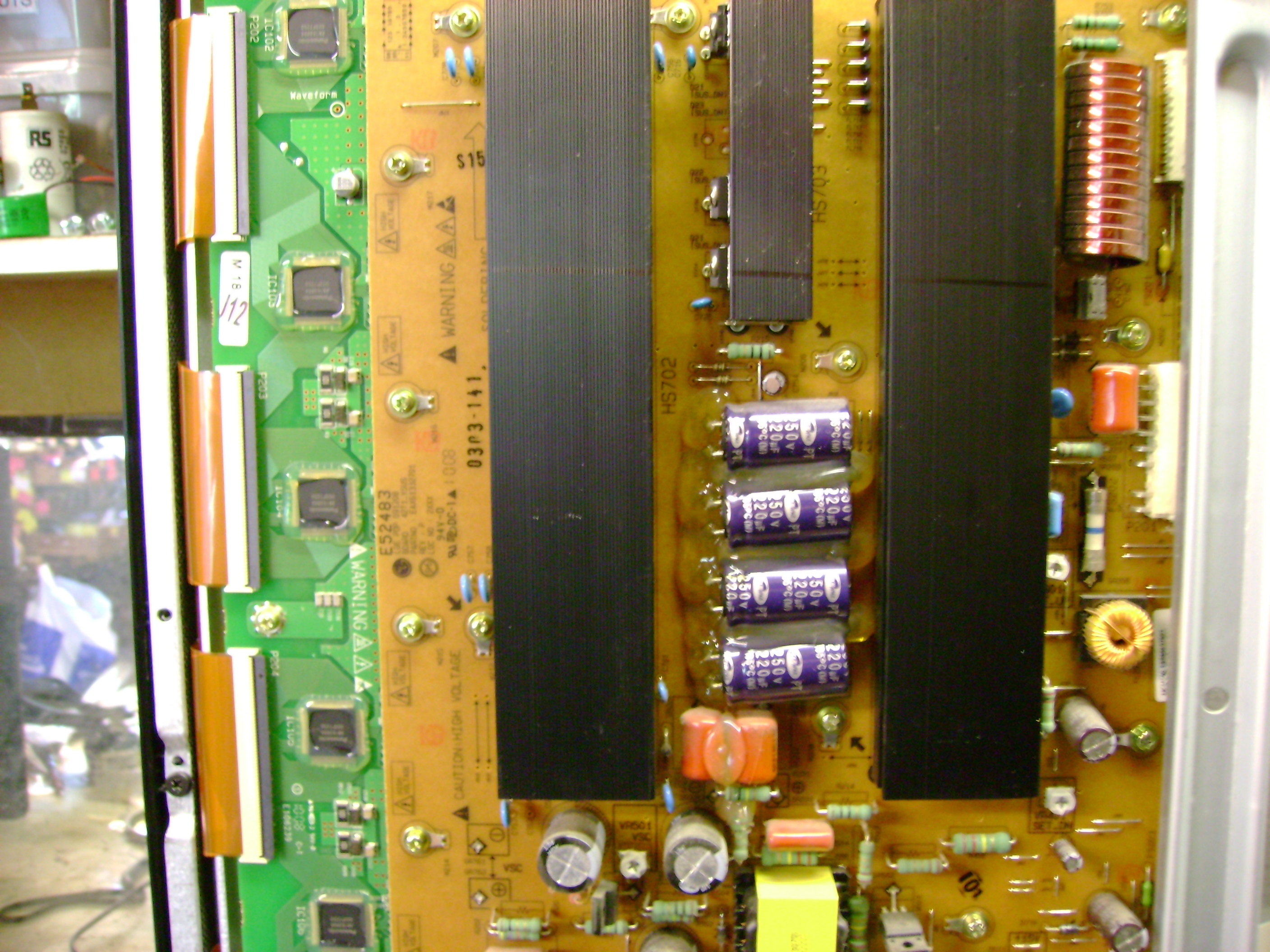

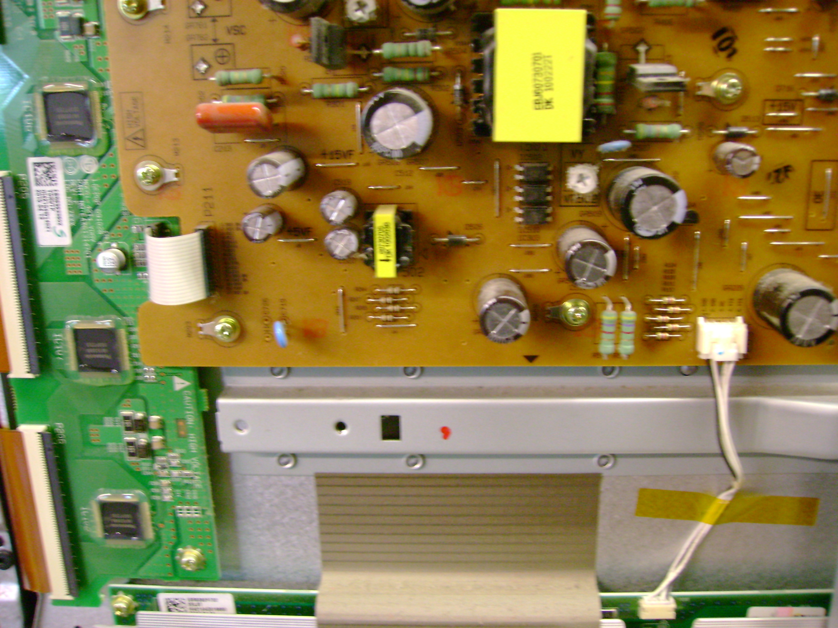

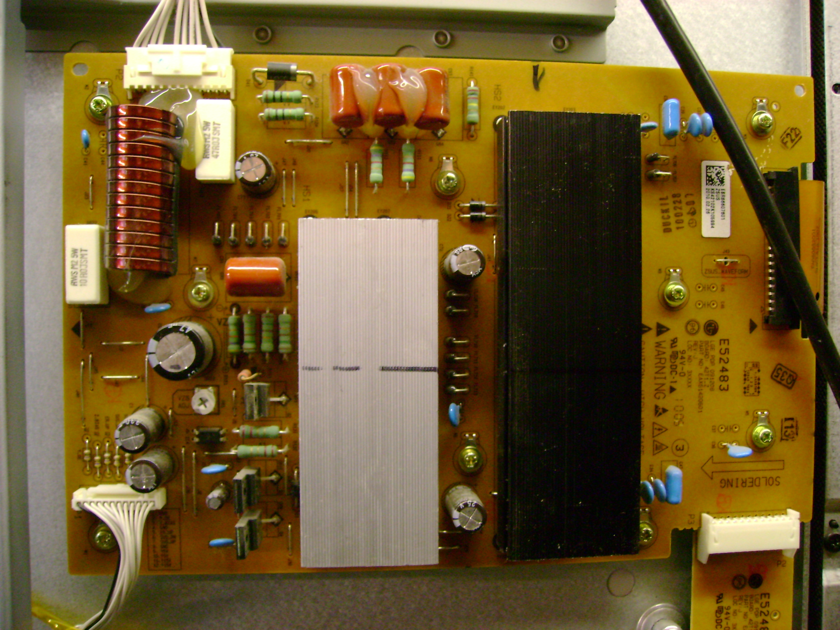

                No still no raster or test pattern. Here's some pics of the boards.

                  Re: Lg 42pj550
                  Here's the pics this time!

                    Re: Lg 42pj550
                    OK so you need to measure and give the readings taken of Va, Vs, M5V, 17V, STB5V, 5V, Vz, +15VF, +5VF, VSC etc voltages along with all the others highlighted on the circuit boards. Possible logic board fault.

                      I also noticed that where there are high voltage warnings on the 5 screw connections between the Y board and the buffer board there was only 45v on
                      the bottom screw and barely 8v on the other 4. Surely this should be higher?

                        Re: Lg 42pj550
                        Va, Vs M5V and 17V supplies all look good. However it looks as thought the voltages on the Ysus board are fluctuating.
                        On the Ysus board measure Vsc which you measure between the two points marked and also measure the +15V point
                        Unfortunately your photo's are very blurred so I'm not sure what you mean about the screws. All screws should be firmly screwed down but not overtightened so as to crack the pcb.

                            Re: Lg 42pj550
                            Y-SUS Bd. not generating a proper 5V for the Logic Bd. to function. Yes I will say the issue is on the Y-SUS Bd.
