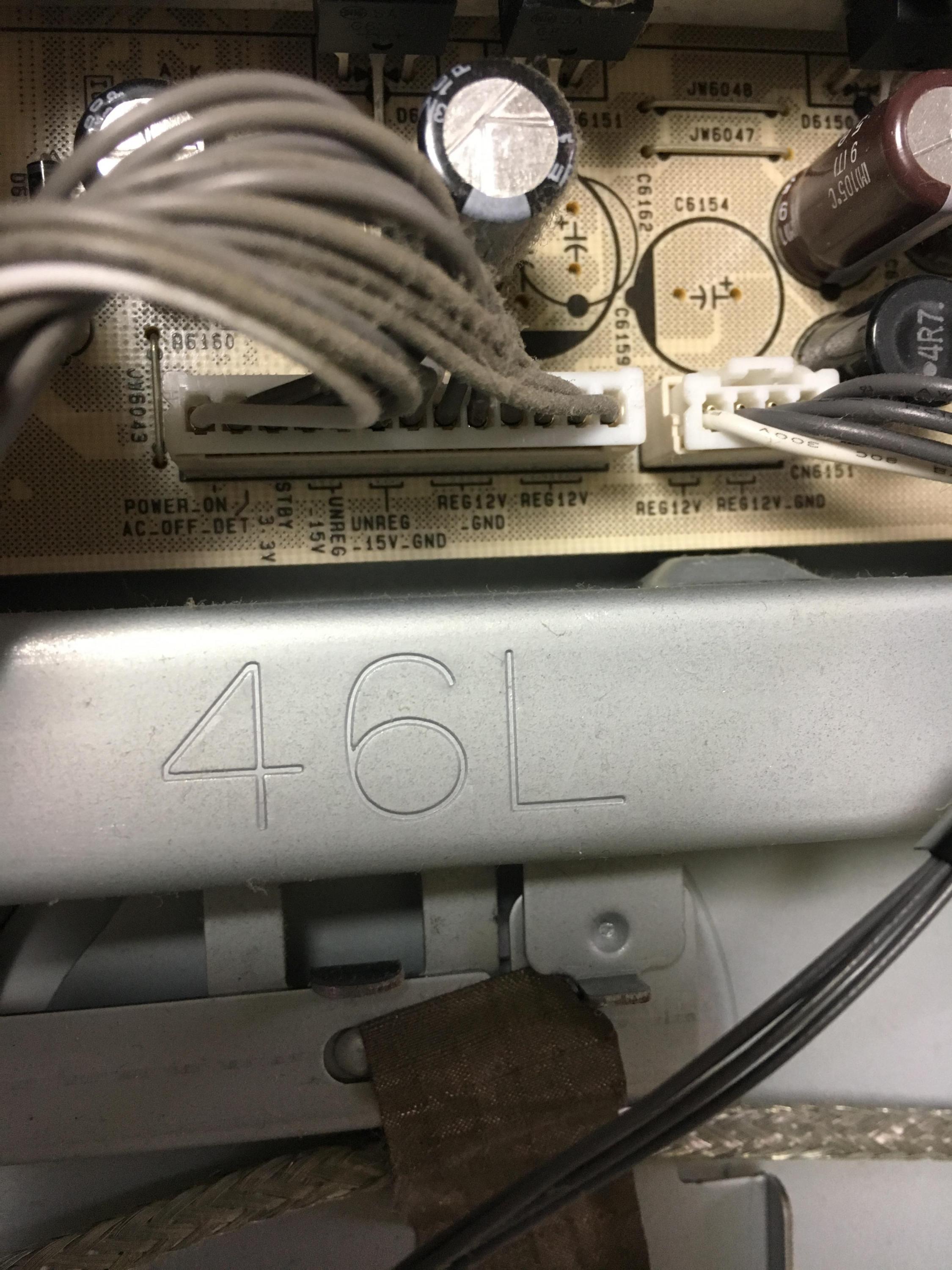

    - Power supply board: I have my standby 3.3V and ON/OFF 3.3V, and the 15V & 12V going to main board. I also have 12V going to the TCon board.
    Things unsure about power supply:

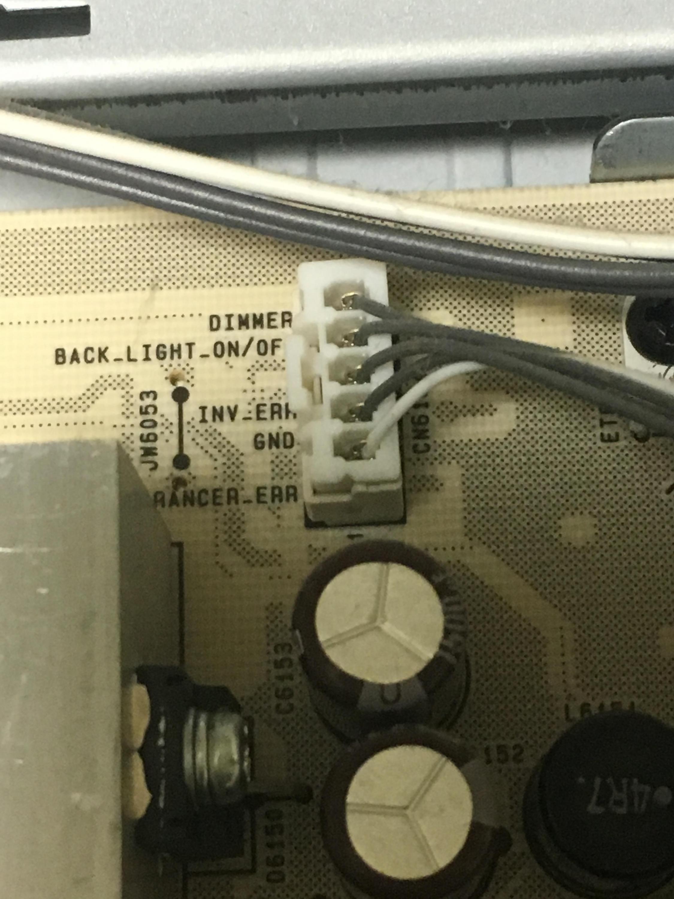

    - Dimmer(.49V), backlight on/off(1.15V), inv_err(2V), gnd, & barancer_err(0V), this connecter i measured at, leads to the main board. I assume these voltages are not correct and it should be more?

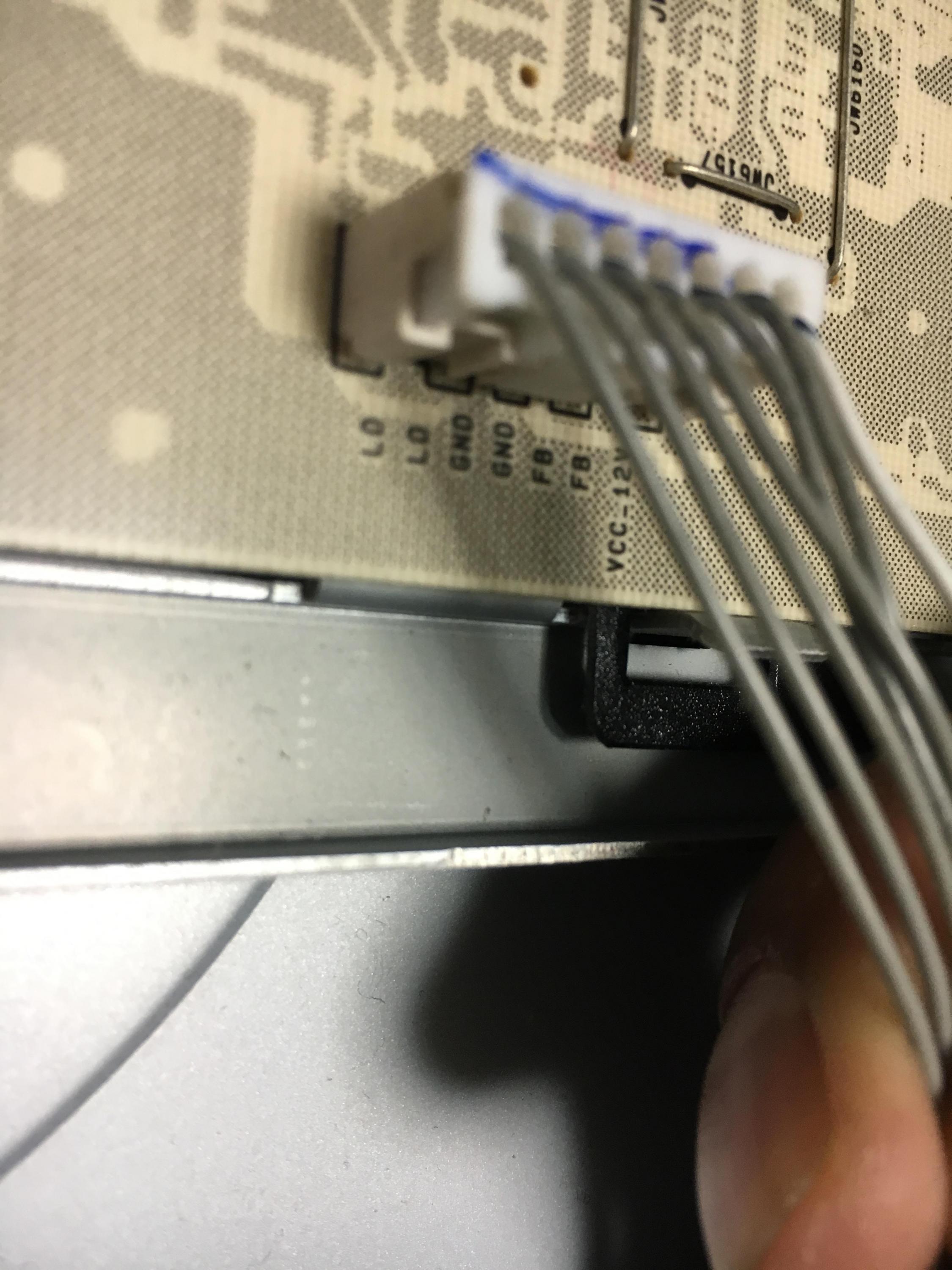

    - VCC(12V), FB(0), FB(0), GND, GND, LD(11.4), LD(11.4V), this connector leads to the inverter board. Are these voltages good or no good? I get 11.4V on LD and 0V on FB and i don't know what these are. The VCC 12V is there tho and that's what the board is marked at so that should be good.
    I also checked the power supply fuse and that's good. So after reading the troubleshooting guide again, I'm thinking the main board. Please let me know what you think, thank you in advance!

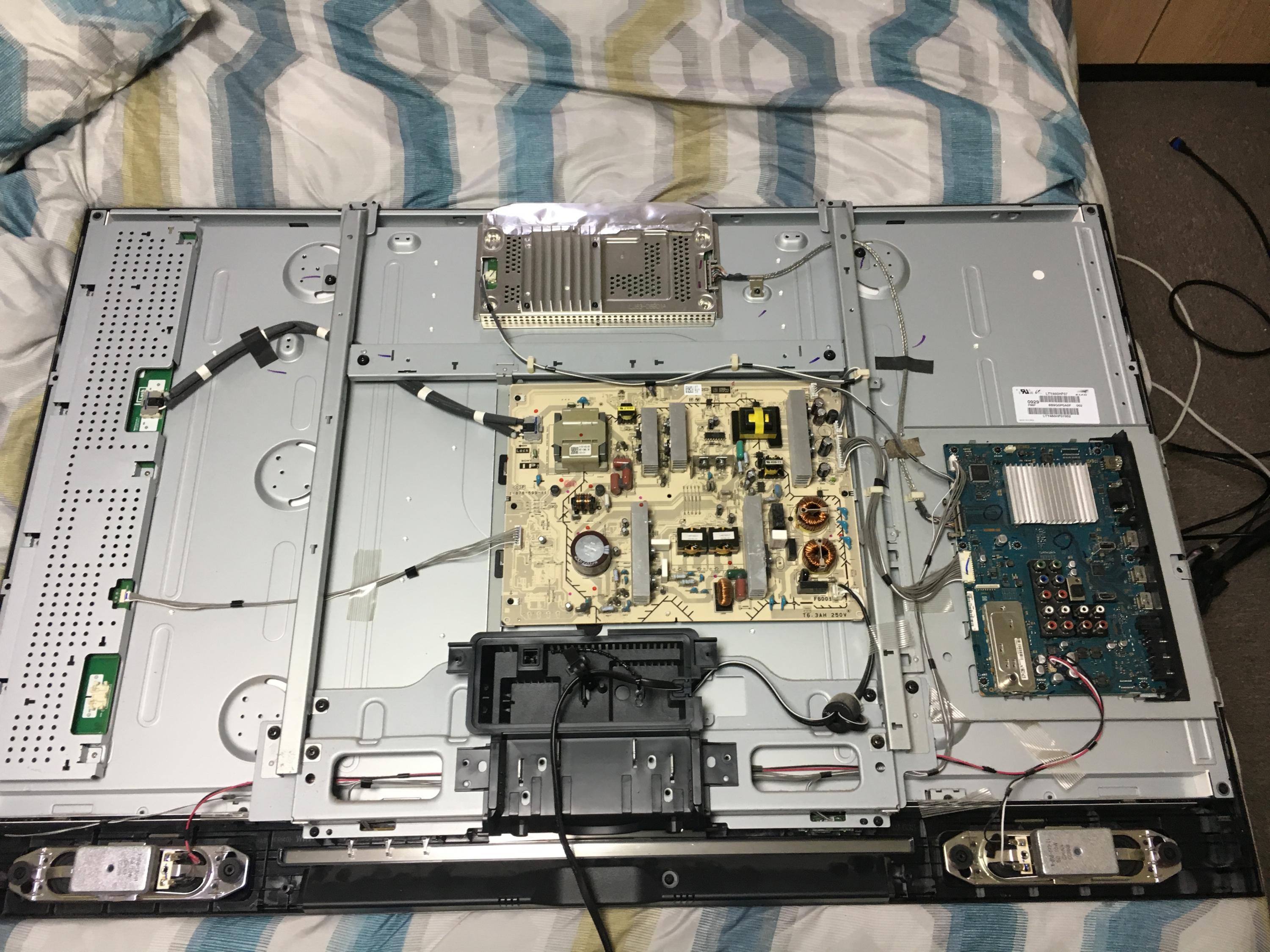

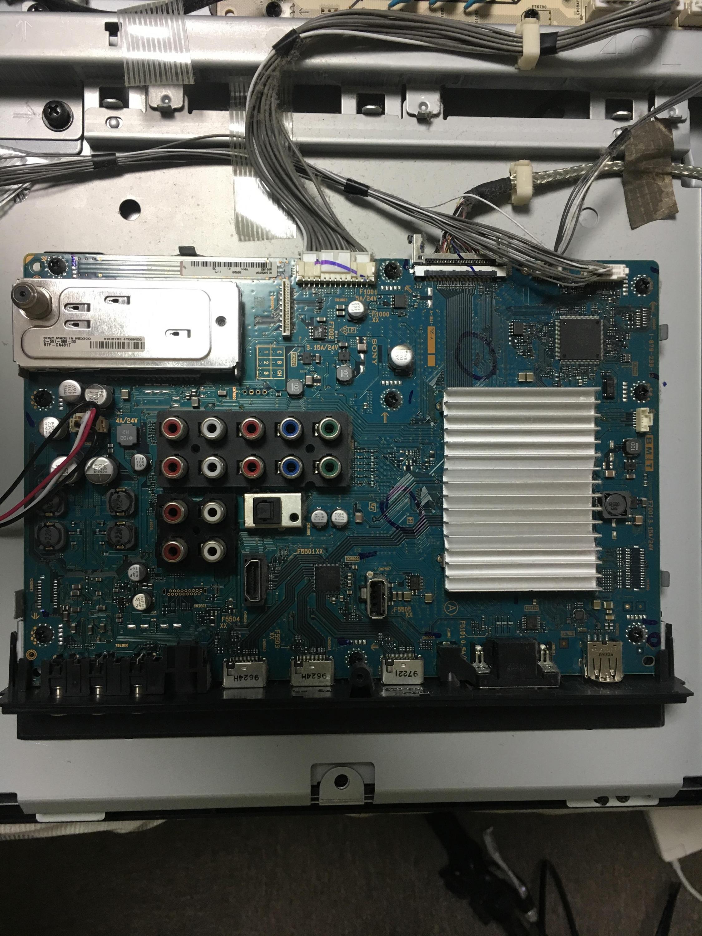

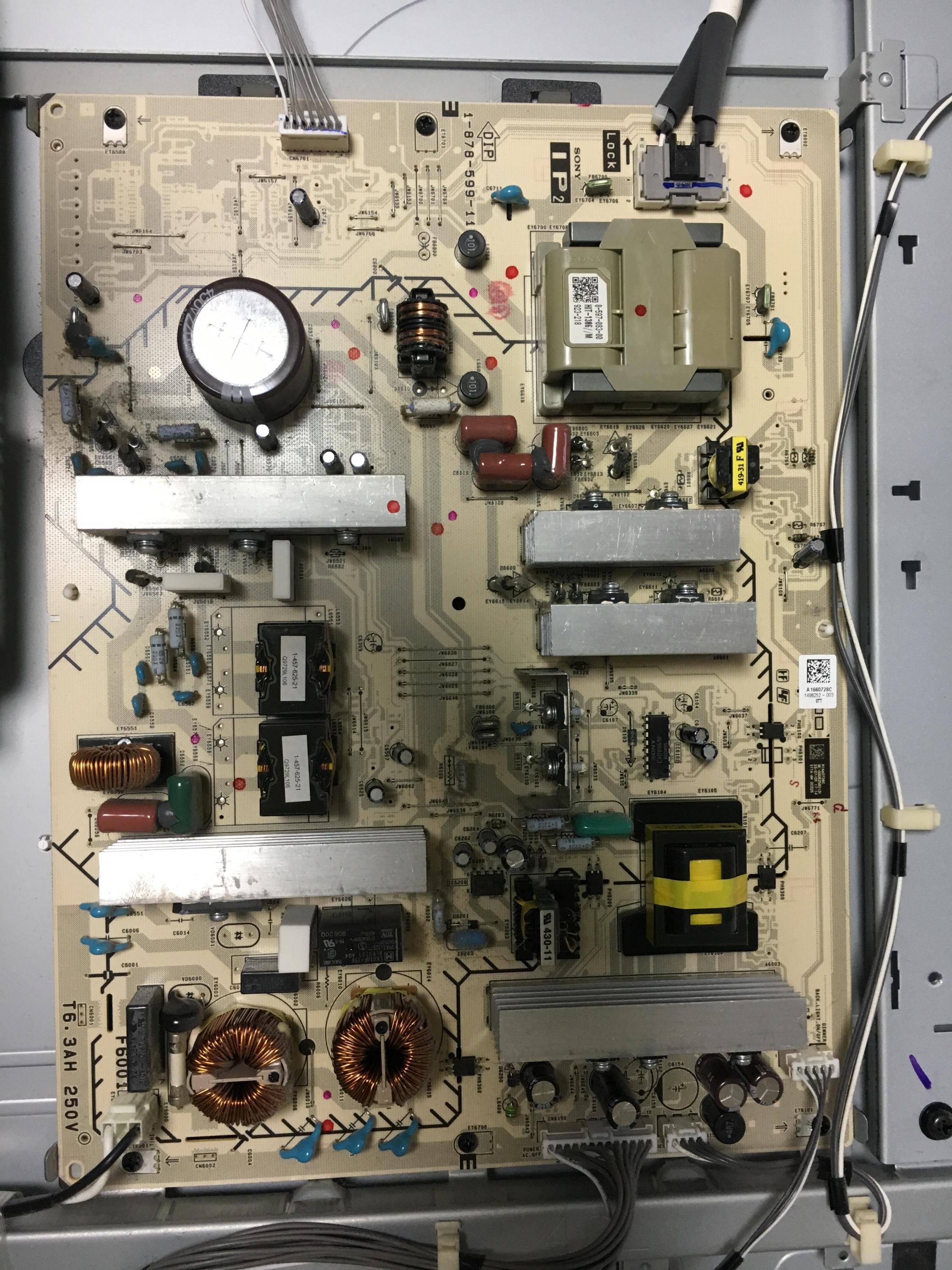

          For us to help we will need good clear pictures of the whole backside of the TV showing all the boards, and the straight shot pictures of the whole top and bottom side of the power supply board so we can read the printed texts on the board.
          It is hard to do long distant troubleshooting without seeing what we are dealing with.
          The more details we get the better chance of finding the cause of the problem.

            Here are the pics, please let me know if you need closer pics for any of them. Thank you again!
