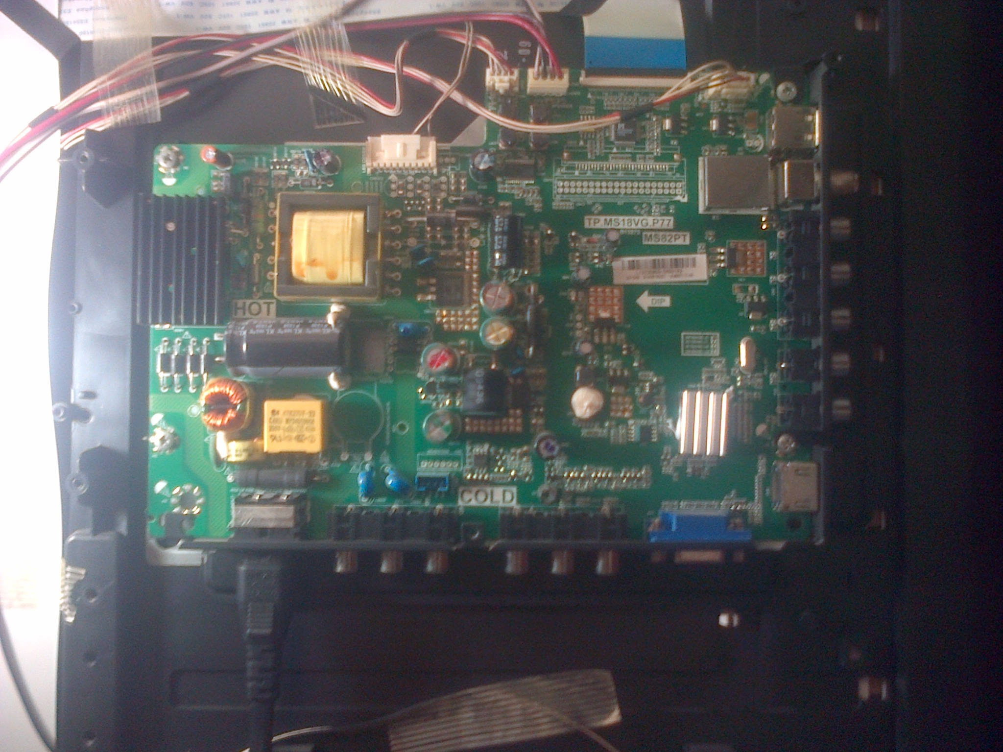

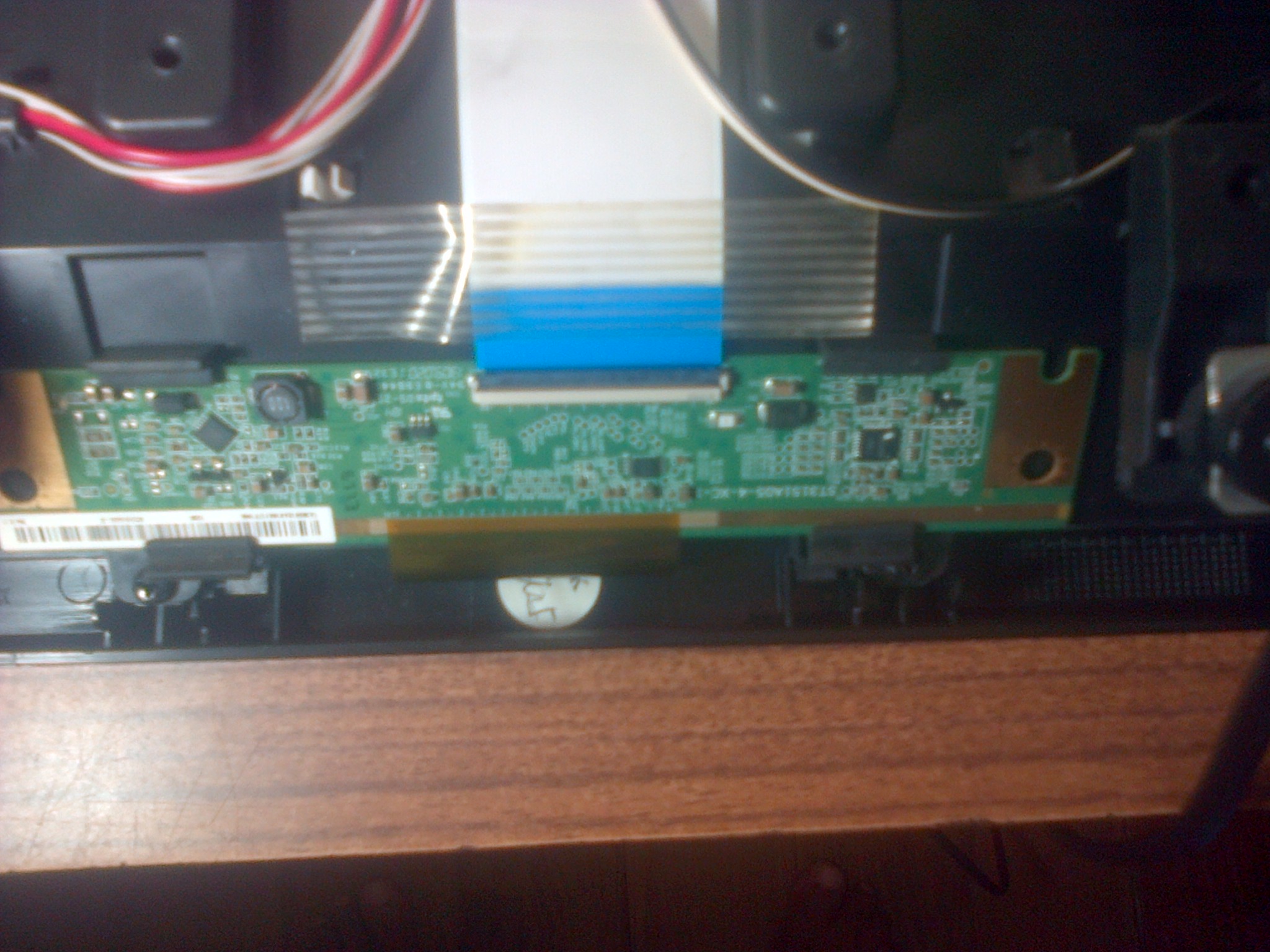

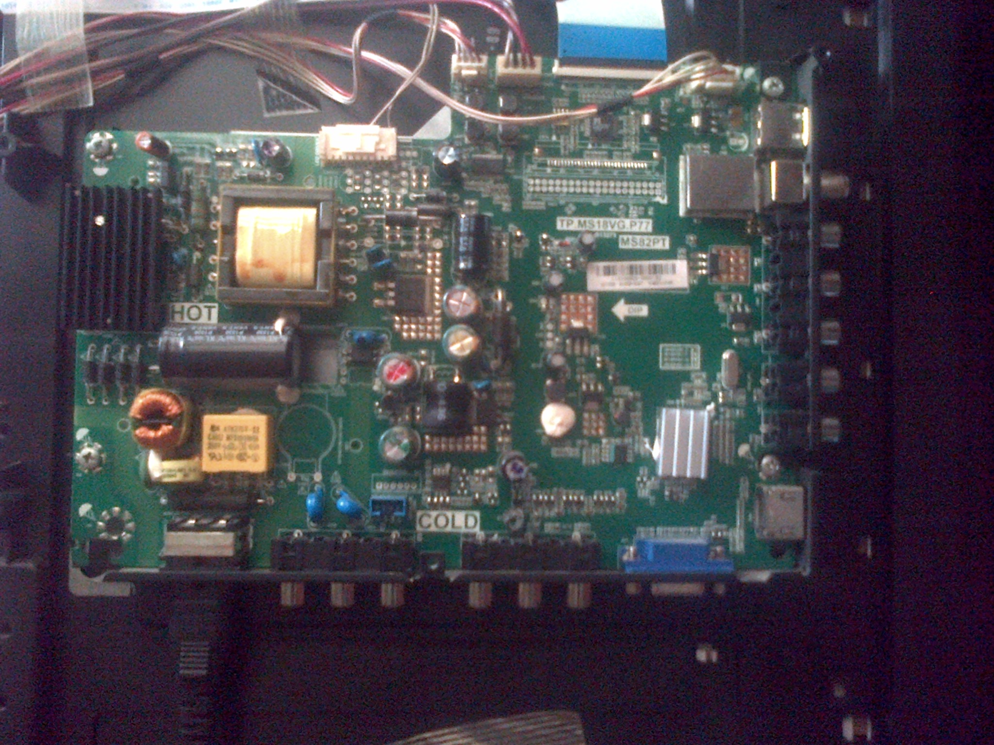

    I am servicing a TCL L32B2500 with no screen light.When I press the remote
    to switch on the television there is a dim flash of light on the screen and there is no picture. When I look to the back of the tv there is no led light.I do not have a service manual for this tv but the voltage on the cable which goes to the
    LED backlights is 45v and I do not know if this is correct.

    Is this your schematic Your photo's are to out of focus to be able to compare your board with the schematic.

      Looks like you have bad backlights. Change out all the strips at the same time. I fixed a few of these in Trinidad.
