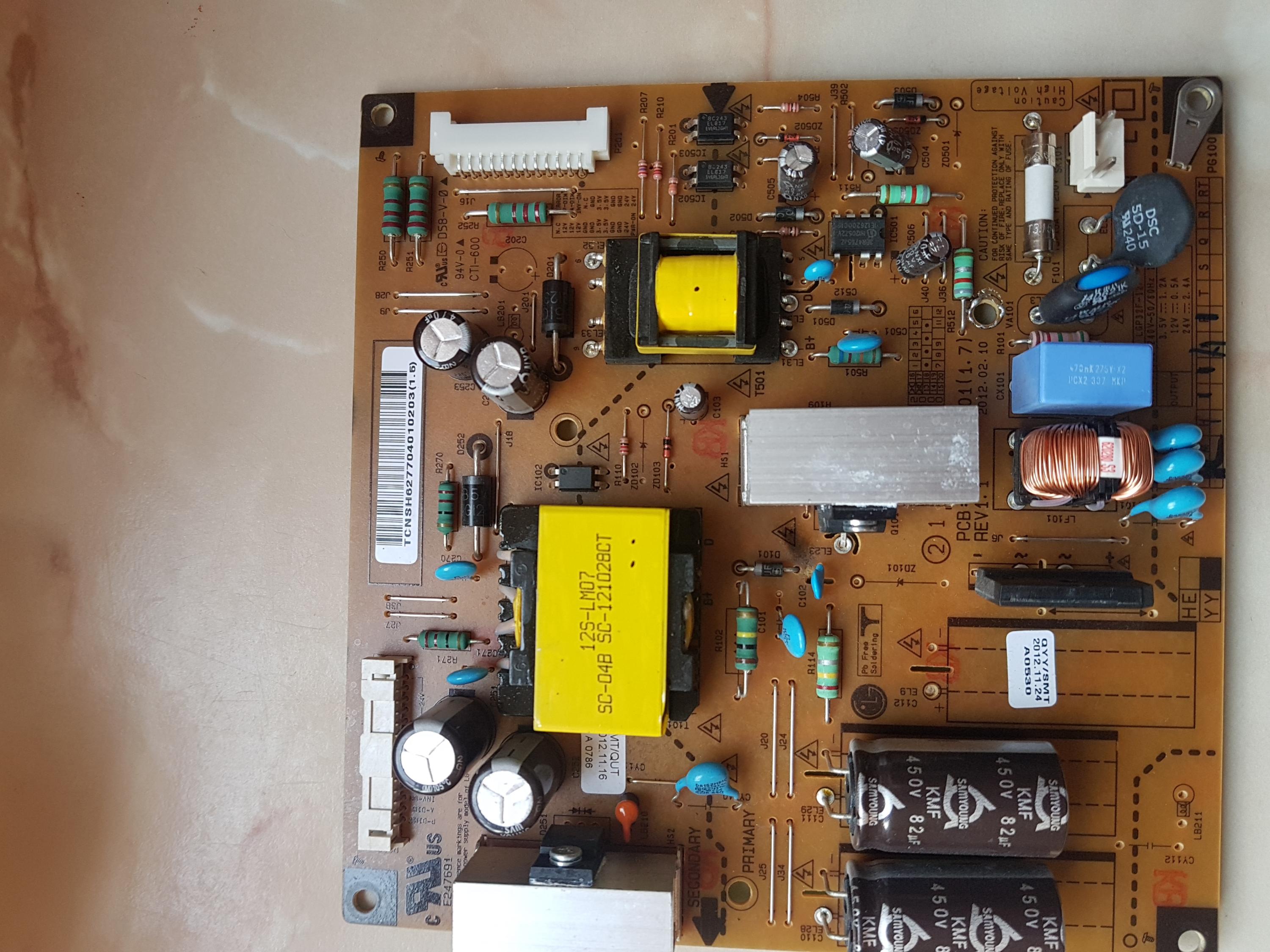

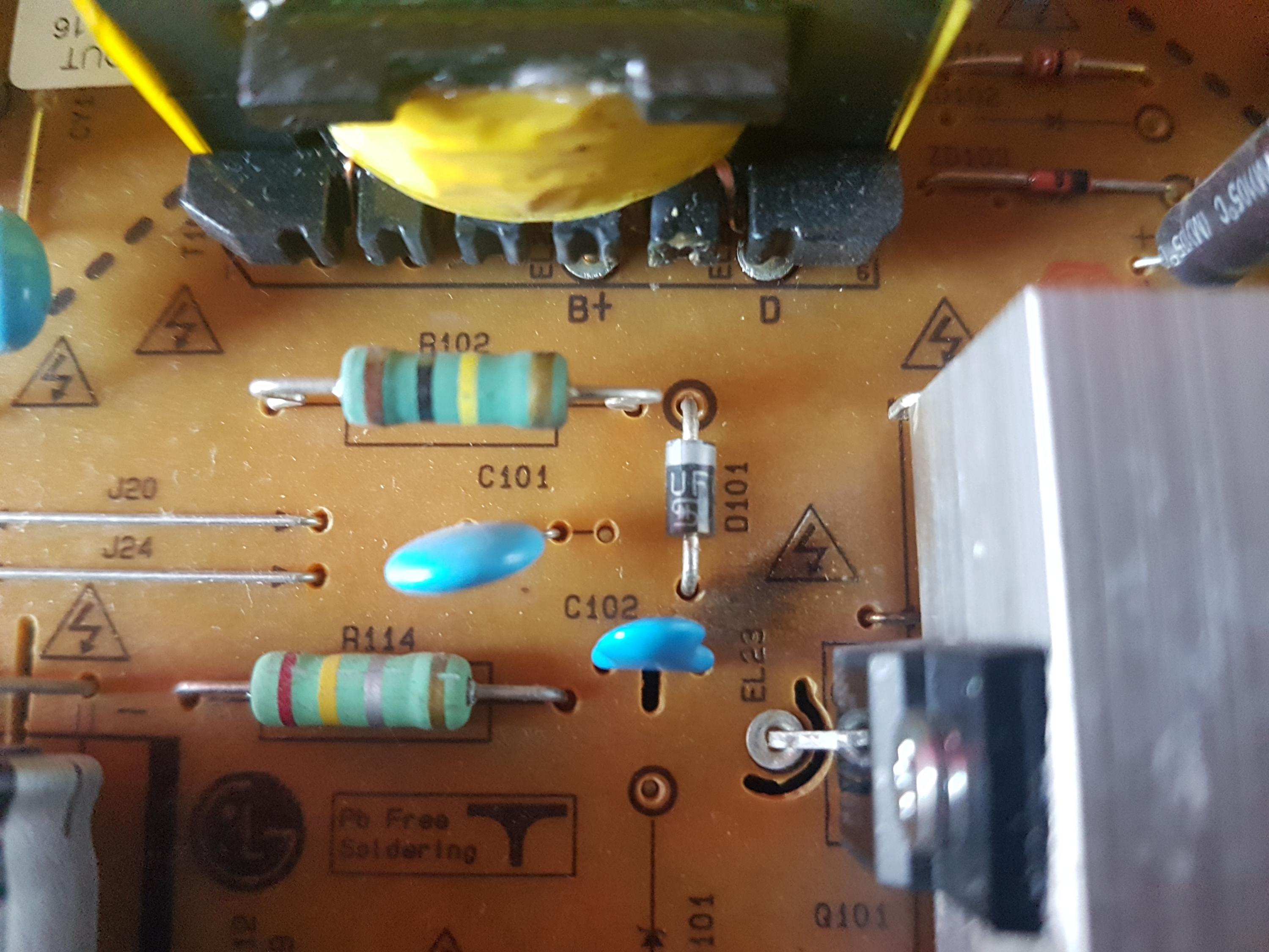

    Hi guys! Set is completely dead! Checked the psu and a blue ceramic cap had exploded also the fuse was dead so I've replaced both of them with the correct value replacements but it's still dead nothing voltages from psu to mainboard are all 0! I haven't got a multimeter at the minute though ( cheap Chinese one fell apart so ordered a better one) does anyone know what are the main causes of a completely dead set are? I've read alot about lg sets with faulty mainboards! Cheers!
  • jonny78
    • Apr 2017
    • 72
    • United Kingdom
    Re: 32lm3400 dead no standby
    psu is EAX64560501
    mainboard is Eax64909901

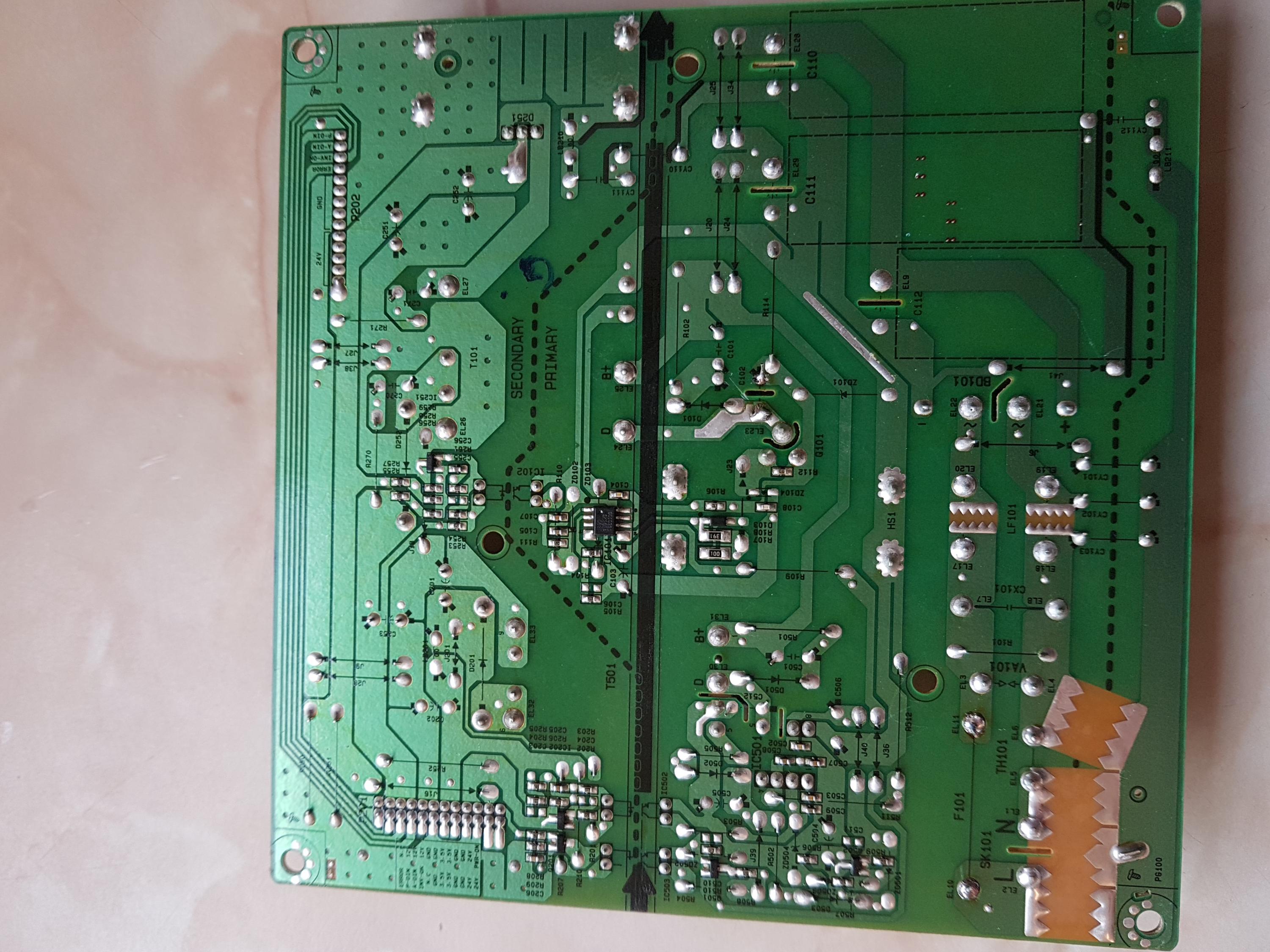

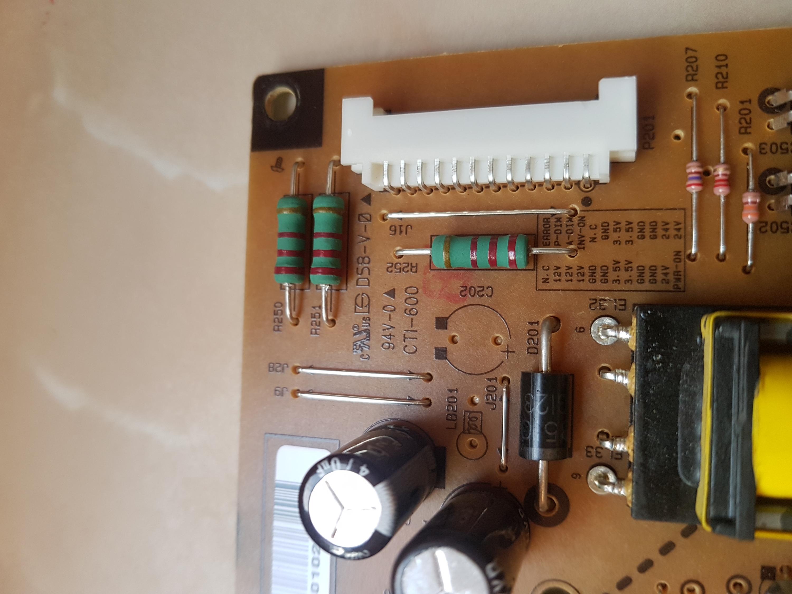

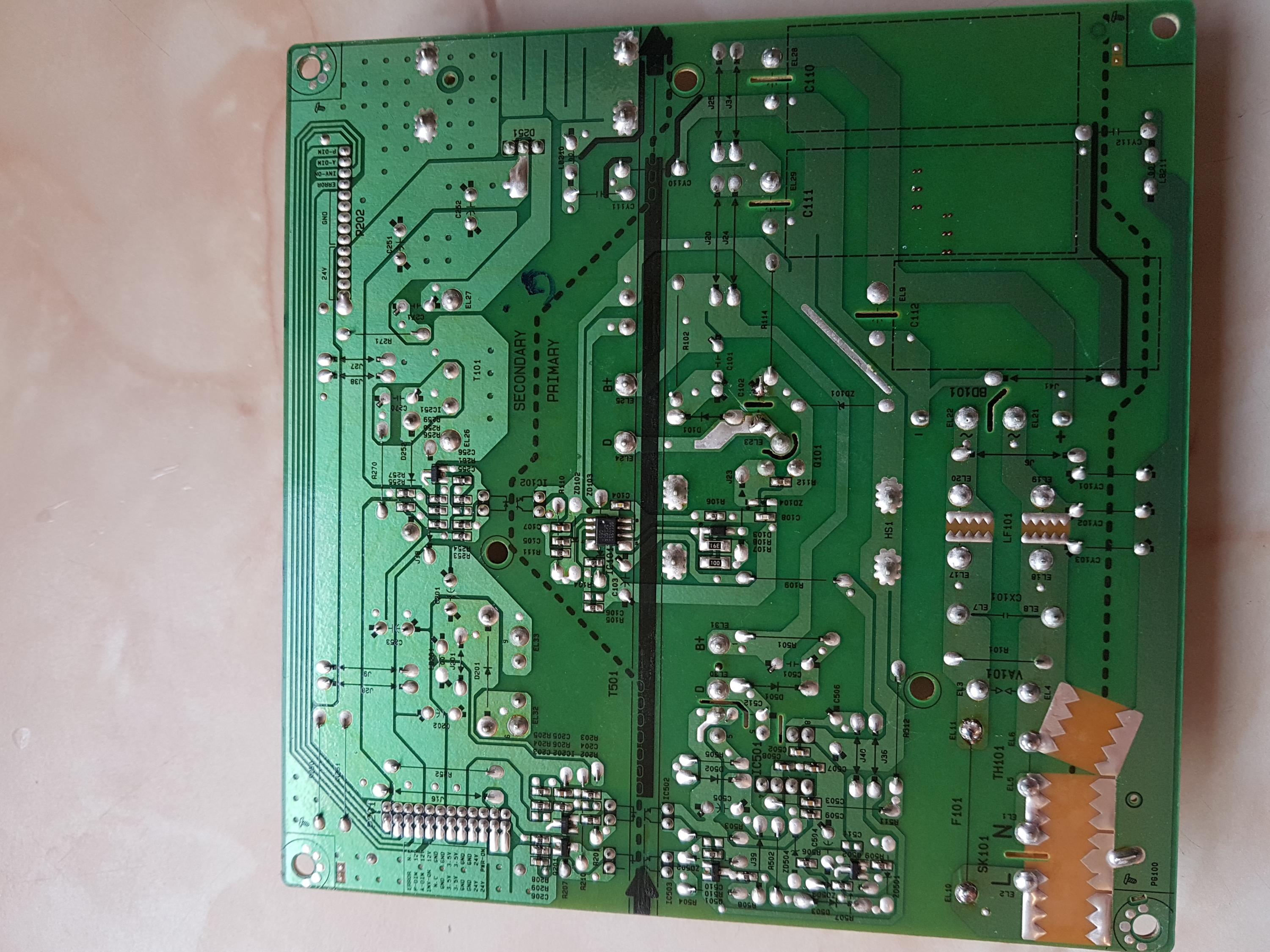

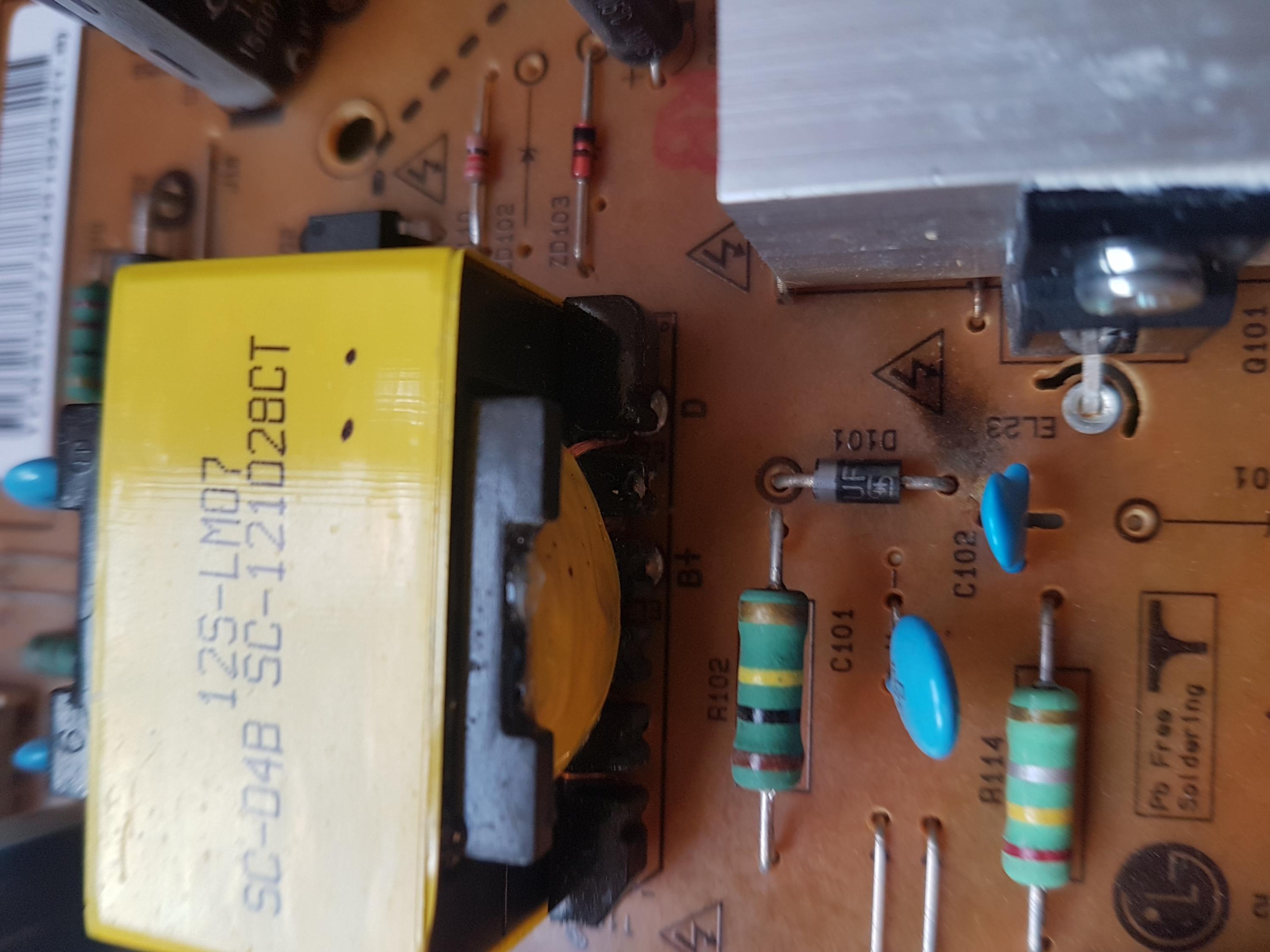

        Hi sorry! please see attached photos! blue capacitor replaced is C102 ( you can see burn mark) and F101 (FUSE) also the readings are as follows:
        N.C=0
        12V=0
        12V=0
        12V=0
        GND=0
        GND=0
        3.5V=0
        3.5V=0
        GND=0
        GND=0
        24V=0
        PWR-ON=0
          You have two power supply sections:
          1) The SMPS IC 501 is for the always on 3.5V standby power supply section.
          2) That C102 is the snubber cap for the MOSFET Q101 which is for the switched power supply that will only come on when PWR-ON control signal is present.
          Right you do not have Standby power to run the main board so that will be the section you need to test first.
          What DCV do you have when measured right between the two legs of the main filter cap C110?

                            There appears to be some marks on the circuit board alongside C102 which I would check is not damaged. Also check the mosfet alongside it Q10x? is not short circuited.

                              hi ive already replaced c102 as it had blown.. will check the mosfet shortly! ive now only got 1 replacement fuse left though as they are fine but when i solder them in and turn the power on they seem to be blowing

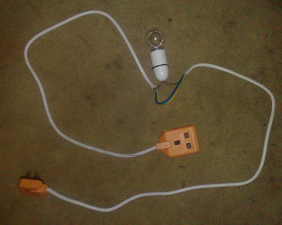

                                use a dim bulb tester saves blowing parts if it glows bright and stays bright when you power the psu on you still have a short circuit
                                have you tested the bridge rectifier?

                                  Don't put the fuse in until you find what is causing it to blow.
                                  You need to check the mosfet since the snubber capacitor was damaged and so is probably also damaged.
                                  Hopefully you can find the fault. With the set disconnected from the mains and just using your multimeter set to ohms check the mosfet.

                                    hi thanks for the replies! you are right..the mosfet is shorted! ive uploaded the data sheet i cant find any of these in the uk only china and i cannot wait that long! would there be an equivalent one ?? many thanks!
                                    • jonny78
                                      • Apr 2017
                                      • 72
                                      • United Kingdom
                                      MDF10N65B is the fet in question!
                                        You need to verify that R114 is also OK or not, it should be <1 Ohm + your meter probes resistance.
                                        Hopefully that IC101 is not damaged when that MOSFET shorted out otherwise you will damage your new MOSFET.
