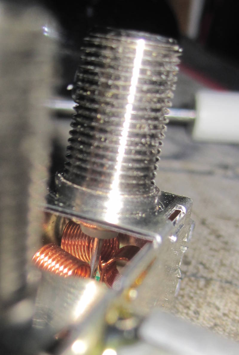

    Kind of strange though maybe not. The NTSC F-connectors tend to be attached fairly sturdily to to the tuner box, outside soldered to the shield. I think the manufacturers have been pretty diligent to strengthen it as the connector is threaded - torque on the cable goes straight to the box.
    However I've noticed that the cable tends to break before the receiver box, which is good. I've seen many of the compression and crimp connectors break.
    I don't work on these things that much (but enough to curse at trying to screw the connectors together! GRR... talk about frustrating!) so you may need to wait for some other opinions.

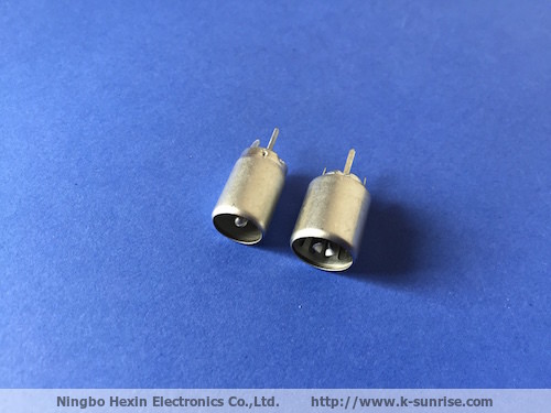

      I have repaired hundreds of F connectors broken on tuner modules, it works best if you have the original broken piece, I just solder them back in place ( I use 5% silver solder for this), being carefull with the heat as to not melt the plastic inside. Then use a thin piece of wire to connect the center conductor to the tuner board. The last one I did was quite easy as the tuner cover was easily removed. For the ones that I don't have the original F I use a F61 or one of these.
      Most of the tuners I have seen have removable covers to gain access in side.
      I found the pal ones here: http://www.k-sunrise.com/html_produc...nector-82.html

        Thanks for your tips. My own personal TV which has got the problem is very challenging. The tuner module is in turn soldered to the mainboard in such a way as you'd need to be a microsurgeon to remove it. Popping the tuner cover doesn't give access to where the connector needs to be soldered. If I had my way I'd be converting those over to f-connectors wherever I could if it was not too hard a job. Naturally our Pay-TV operators have specified F-Connectors from day 1. It's not even as if PAL connectors are an Australian standard or anything - just convention. It would be so easy for manufacturers to just specify f-connectors and include a PAL adapter. Very quickly we'd find the transition to f-connectors had occurred. Even wall plates are PAL connectors, with f-connectors on the reverse side of the wall plate. Most TV antenna installers say the weak link is always that cheap fly lead used from the wall plate to the TV.

              Post a picture of the main board and tuner area, You say you were able to remove the cover, so did it only show the tuner pc board? It may not be that hard to repair.

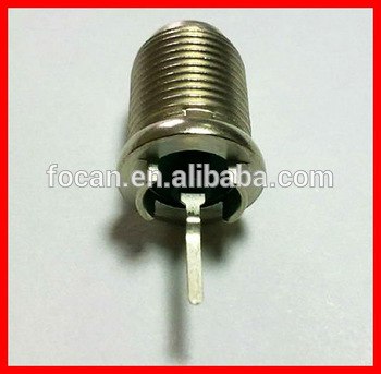

                              • DXseekerMO
                                Samsung PN51F8500AFXZA broke off the tuner's F connector, can't get tuner de-soldered
                                by DXseekerMO
                                I can hear Fred Sanford now...."YOU BIG DUMMY".....I pulled the "F" connector out of the tuner by accident. The tuner number is BN40-00248B. Low and behold I had a scrap board with tuner number BN40-00248A. Although the tuner is different (according to Encompass.com) it's footprint on the board is exactly the same as the 248B so I decided to de-solder the tuner off the scrap board to see what I was getting in to.
                                As you can see in the picture the terminals and solder pads are super small. No matter what I tried I could not get either the terminals or support...
