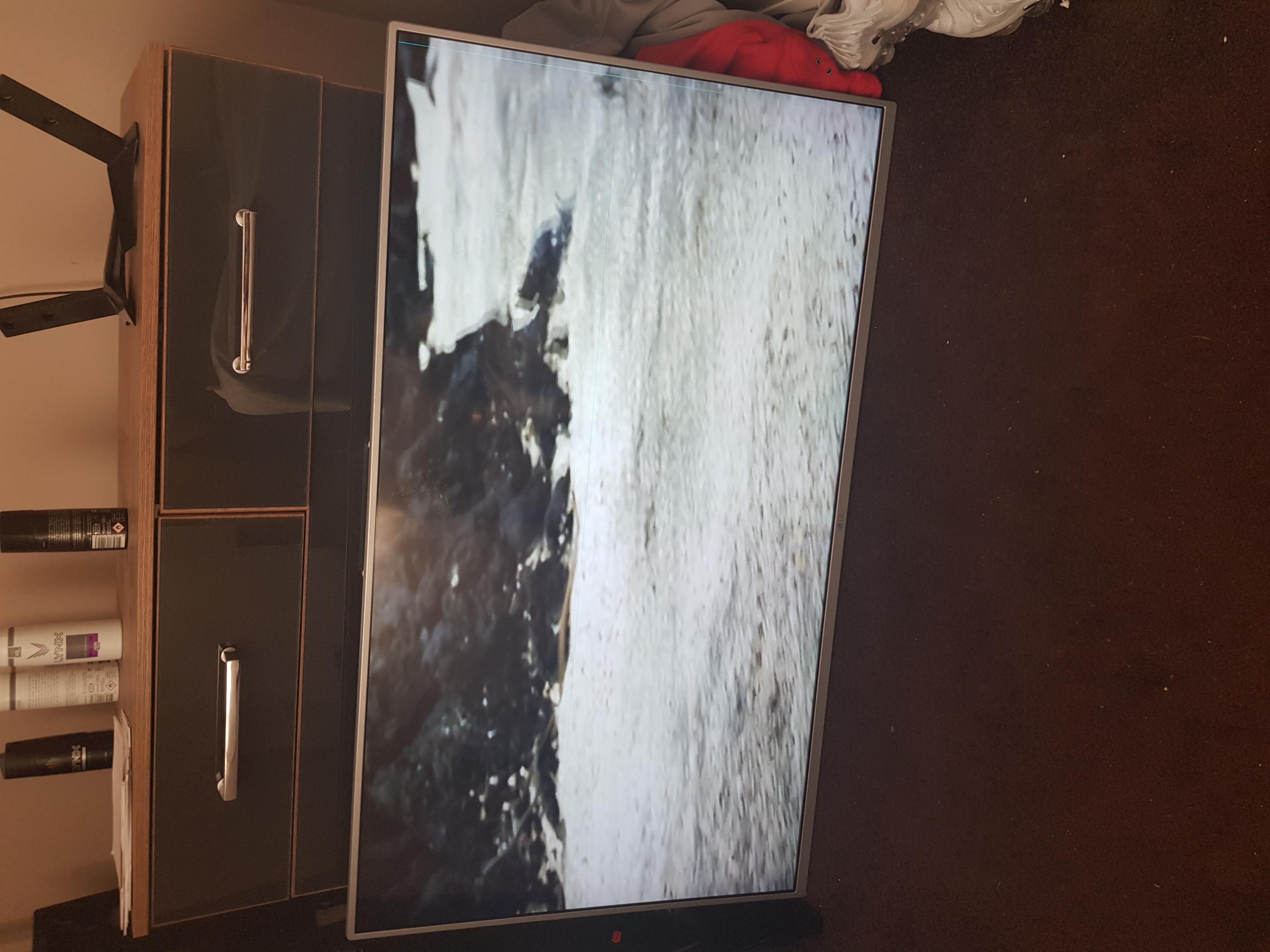

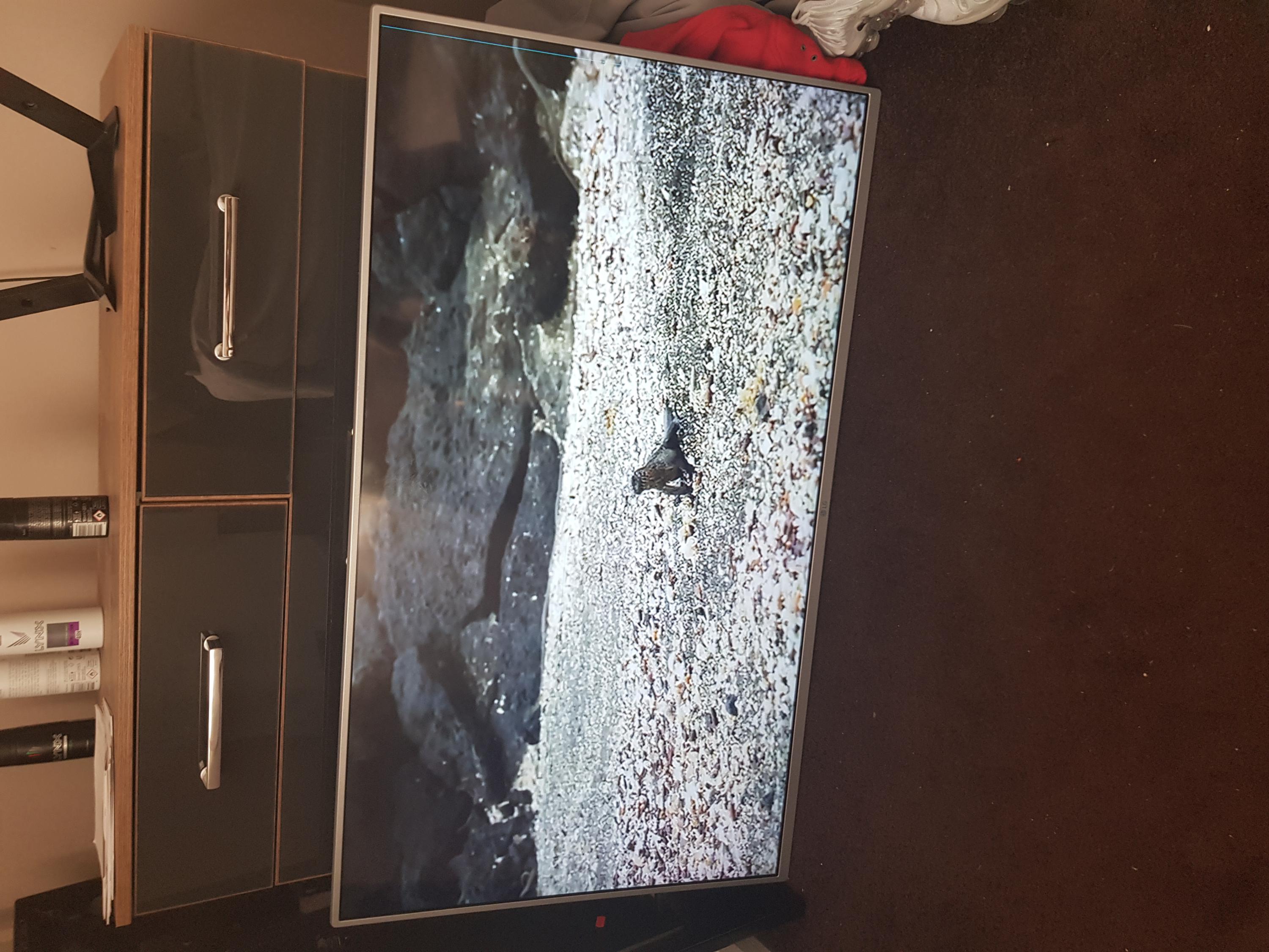

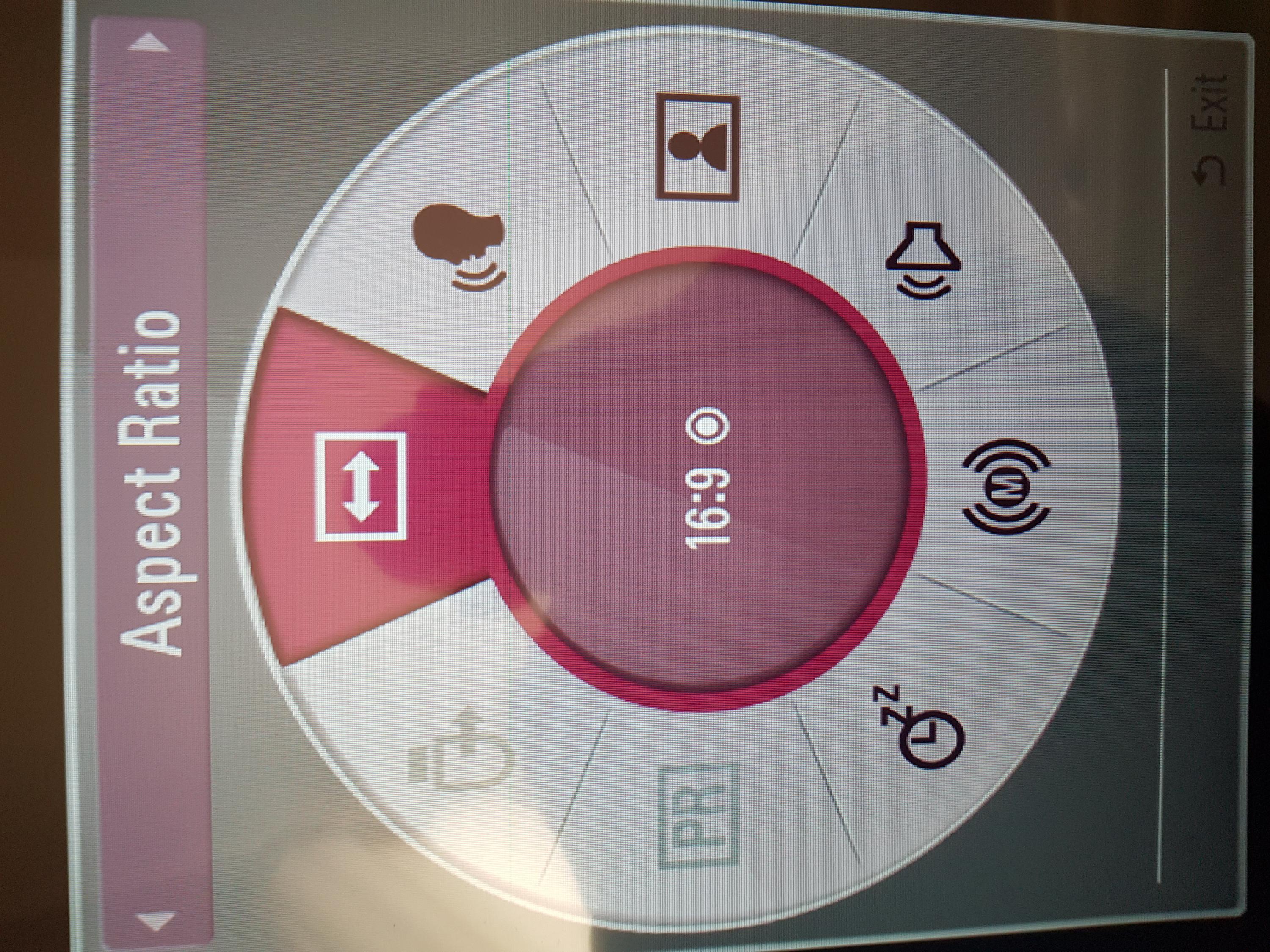

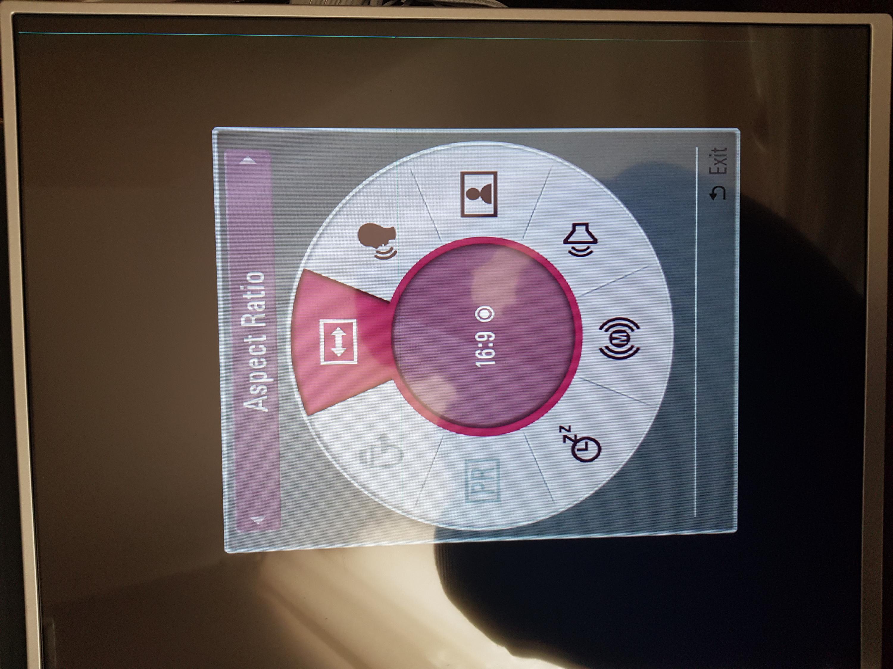

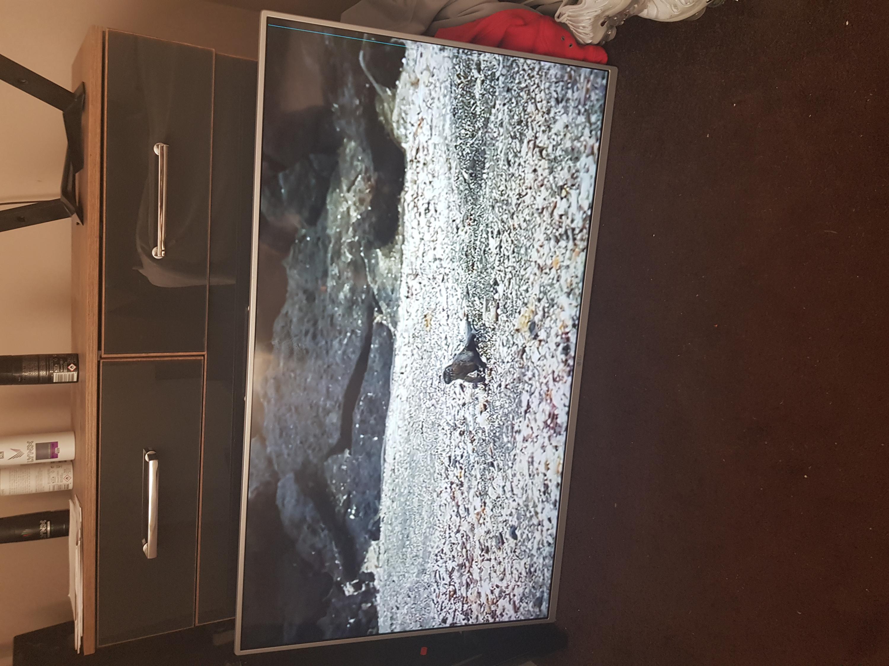

    Have a 2015 LG 49LF540V that has 1 thin vertical line on right of screen and 1 thin horizontal line across centre of screen, have tried to picture them as best as I can. Have cleaned ribbons and contacts on T con board to no avail, fear it may be a bad LCD panel, any help grately appreciated.
  • dick_barton
    • Aug 2015
    • 6643
    • Wales
    Re: LG 49LF540V lines
    I think you may well be stuck with that 1 line. You could try putting a little pressure on the panel tabs to see if it will go.
    • Bloopeta
      • Jun 2018
      • 526
      • United Kingdom
      Tried mate, unplugged, cleaned and re plugged everything, wiggled everything whilst on, no change. Such a shame as its a really nice tv n picture is good appart from the lines, as I mentioned only 2015 Tv too!
      • Diah
        • Feb 2013
        • 6599
        this is first age of young panel manufacture , its pixel on lcd it self, no tap or any can fix it
        • Bloopeta
          • Jun 2018
          • 526
          • United Kingdom
          Such a shame, ill just donate it to someone who needs a TV and doesnt mind the line
