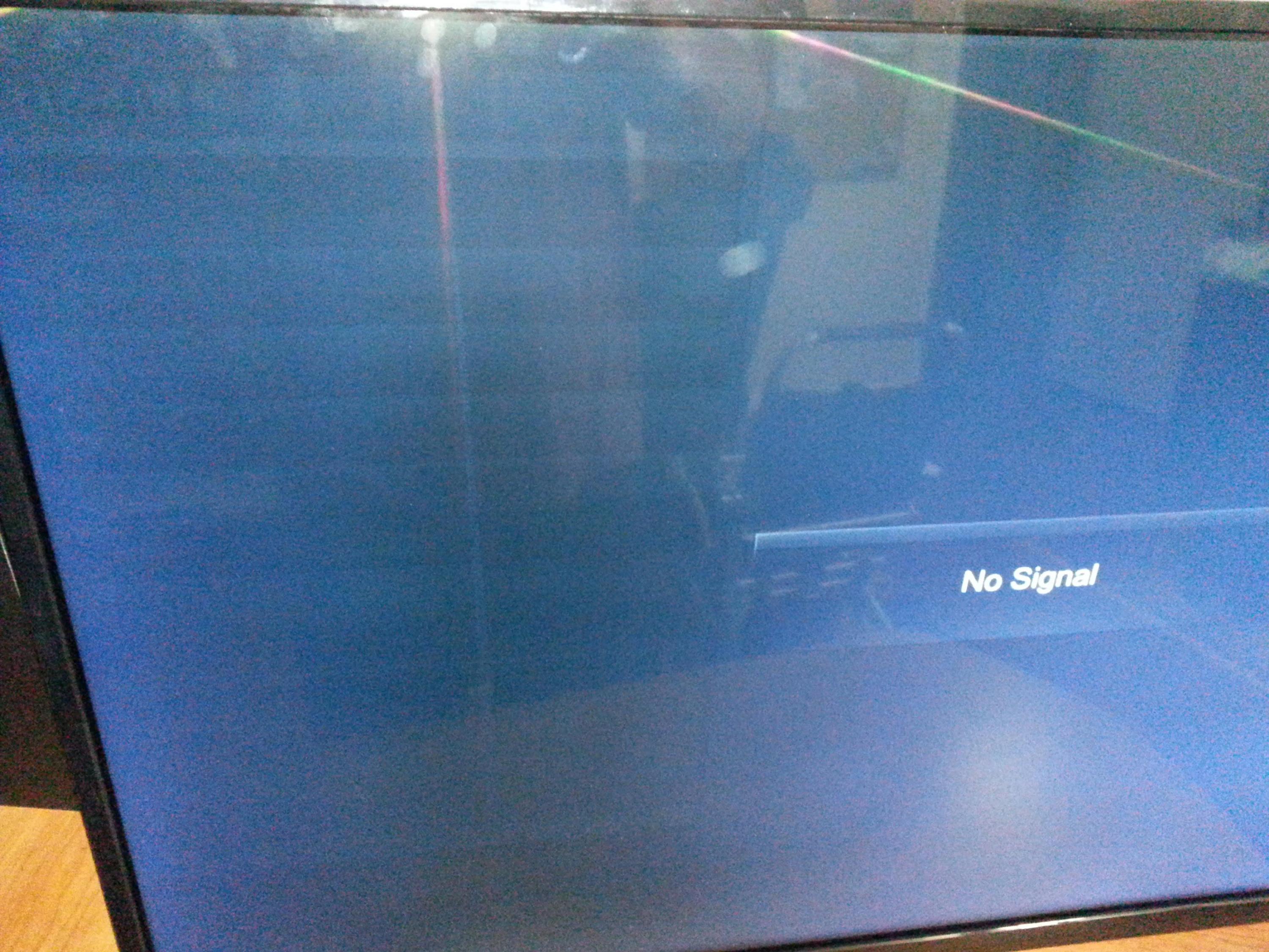

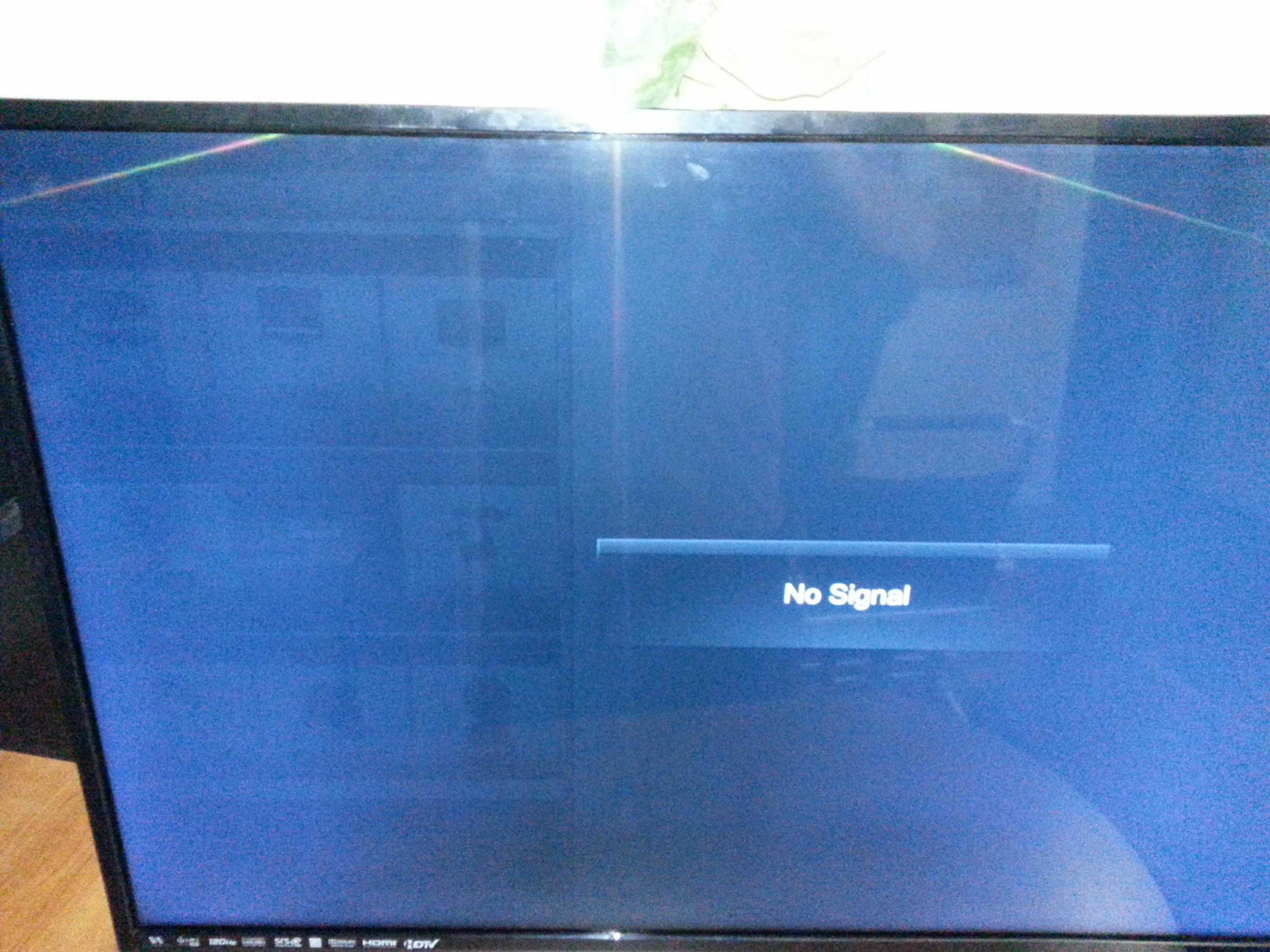

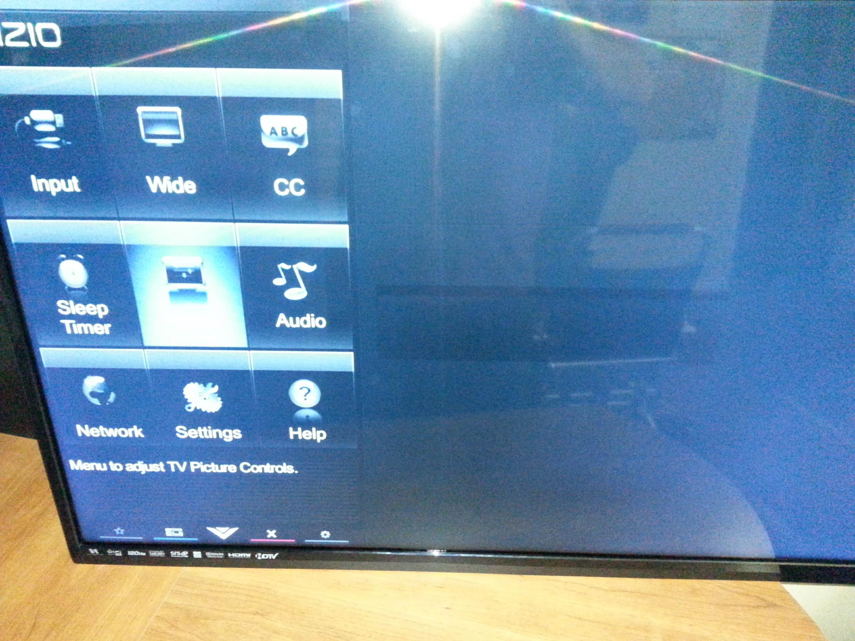

              Sorry it took so long to get some pics. Have been busy. Not the best but hopefully these help some.
                Re: Vizio e470i-a0 - no HDMI inputs and image ghosting
                Looks like a bad Panel. Thanks for the pics. Could you post a pic with a signal so we could see what the Panel is doing there? Have you tried adjusting the brightness, contrast and backlight settings?
