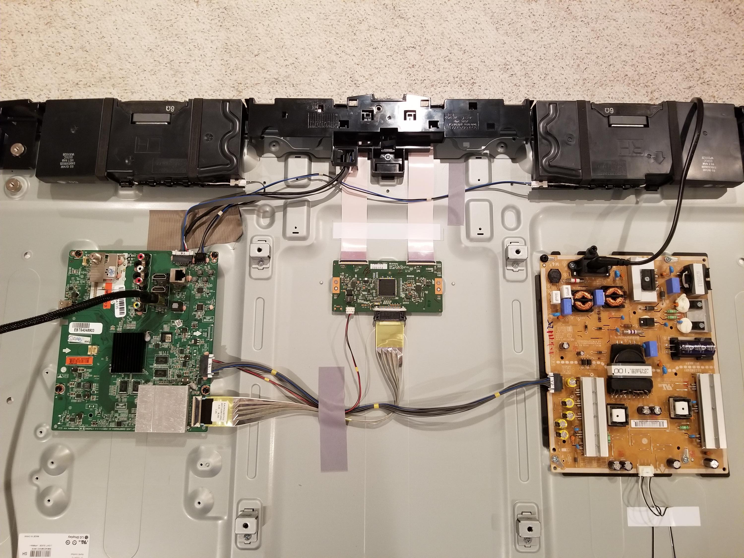

            back a way, you did a test by unplugging the small cable on the tcon and the backlights came on. Can you do a similar test, but this time leave the small cable connected and disconnect both of the tcon to panel cable at the same time... what happens when you power up?
              Re: LG 55UF6450 No Backlights
              Per post #1: P-DIM1=0, P-DIM2=0 are 0V, but you have BL-ON signal (DRV-ON).
              That small connector on the T-CON is more likely to be for dimming control, you are able to get the backlights to come on by disconnecting that small cable, you should then check the Voltage aging on those Dim control pins to see what you have.
              Since you are able to get the light source to come on, then you should see pictures if the main board, T-CON board, and the panel are OK.
              Can we also see the pictures of the whole backside of the TV showing how all the boards are connected together?

                  Budm, I get 3.26v on both DIM1 and DIM2 pins with small connector unplugged and 2.5mv on both pins when plugged in. Now that I got this main board back in I can not get the TV to switch inputs or find the DVD player, all I get is static sound for a while then it stops completely for a while then the static sound comes back on.

                    #29
                    Pic of lay out

                      #30
                      Sorry the pic is upside down. Just a note here, there is a red light that is on steady on main board.

                        #31
                        Well I have had the main board checked twice and it's working so I orded a tcon board and installed it today and I get the same issue, no changes. any idea's where to go from here? I also checked the backlights and all are working so they appear to be fine.
