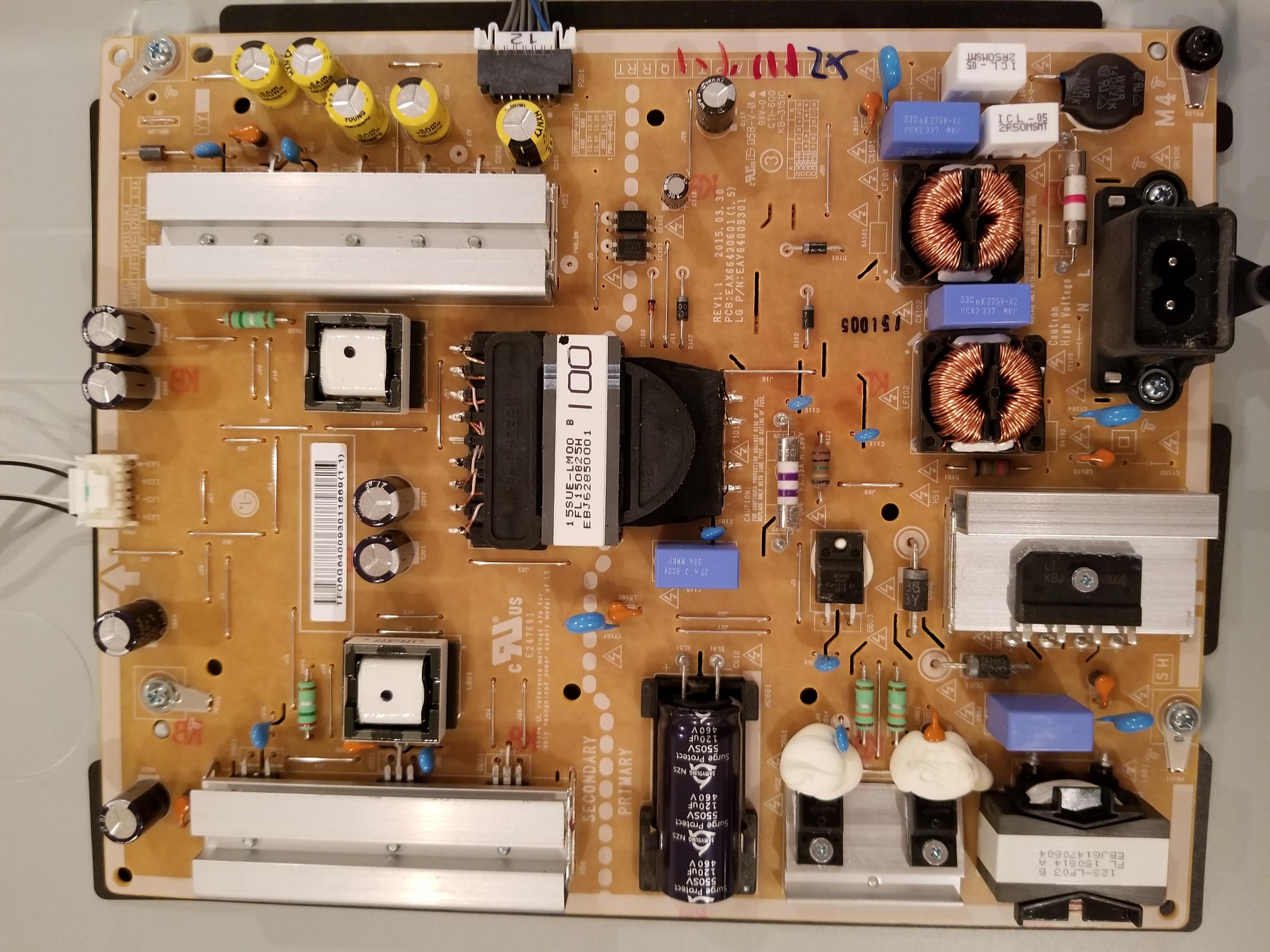

    I have this tv that i'm trying to fix for a family member, LG 55UF6450 Ultra HD 4K LED tv. They said the picture went out but it still had sound, they no longer have the original remote so I have no remote to work with.
    This is what I have so far.
    I can not see any image on screen using flashlight.
    i'm not sure of what input it is on and can not see menu to change the input but have tried all HDMI inputs but it made no difference so no image and no sound so far.
    When powered on the red light on bottom front of tv blinks 2-3 times and lights on main board come on but no flash at all of backlights.
    Voltages I have checked are as follows.
    Main Cap is 160v-off/400v-on
    t-con fuse reads 13.2v-on
    Led+ is 129v on both positives when powered on and 62v when off.
    Voltages on the connector when powered on are as follows.
    PWR-On=3.3v
    GND
    13.3v
    13.3v
    GND
    DVR-ON=3.4v
    P-DIM1=0
    GND
    13.2v
    13.2v
    13.2v
    P-DIM2=0
    Not sure of which one of these controls the BL_ON.
    Any idea's would be appreciated.

      The DRV-ON pin would be the one to turn on the Backlights. If you say you have on both +ve pins to the backlights but does it remain at that voltage or does it go down to a lower voltage and did you measure the -ve backlight pins WRT chassis GND, if so what did you get? From what I read so far it would seem you have a bad backlights issue but we need more info to correctly guide you.

              Are you sure the backlights are not on? 129v - 8v = about 120 volts to the led's.

                    if the back light voltage as you wrote show 129V. the LED should be light on when tv turn on and this you can easy to see them. if voltage there but thy are out then you have broken ( CUT OUT ) Led one or more.. but in this case with flash light you can see some things on the screen, look close at turn on in the middle of the screen or the top left.

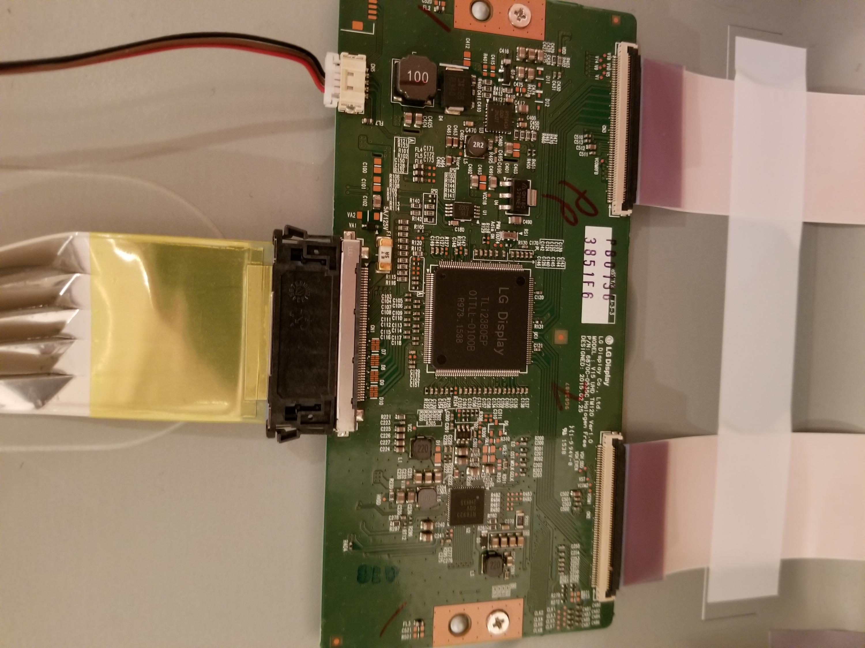

                            Pic of t-con bd, fuse F1 13.2 volts to both sides

                              This is where you take out your scope and check the signal on the lvds cable, without it the problem could be with the main board or t-con, I suspect main board myself.
                              If you disconnect the small white plug from the t-con do you get brighter backlights?
                              • eagle00799
                                • May 2012
                                • 322
                                Re: LG 55UF6450 No Backlights
                                When I unplug the small white plug the lights come on full screen.

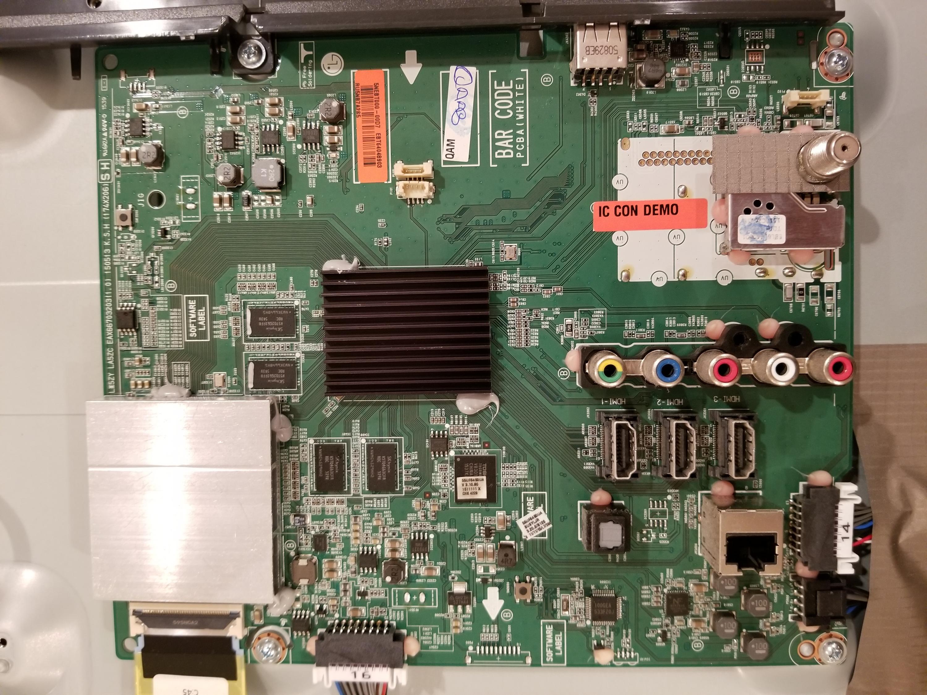

                                  Ok, so your backlights are ok, and the power supply is ok, others have had problems with the mainboard. Shopjimmy had all 3 boards for under $90.00 but are out of stock.
                                  • eagle00799
                                    • May 2012
                                    • 322
                                    Thanks for your help guys, I will see if I can find a main board. I have done some browsing and have seen many different boards for the LG 55UF6450, curious if any of those will work if I can't find the exact board that's in this tv.
