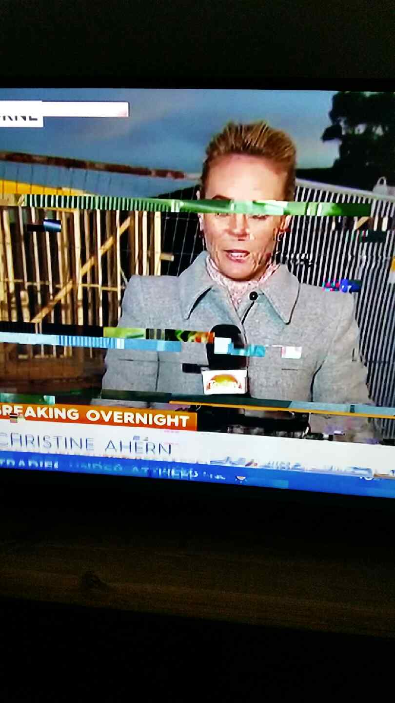

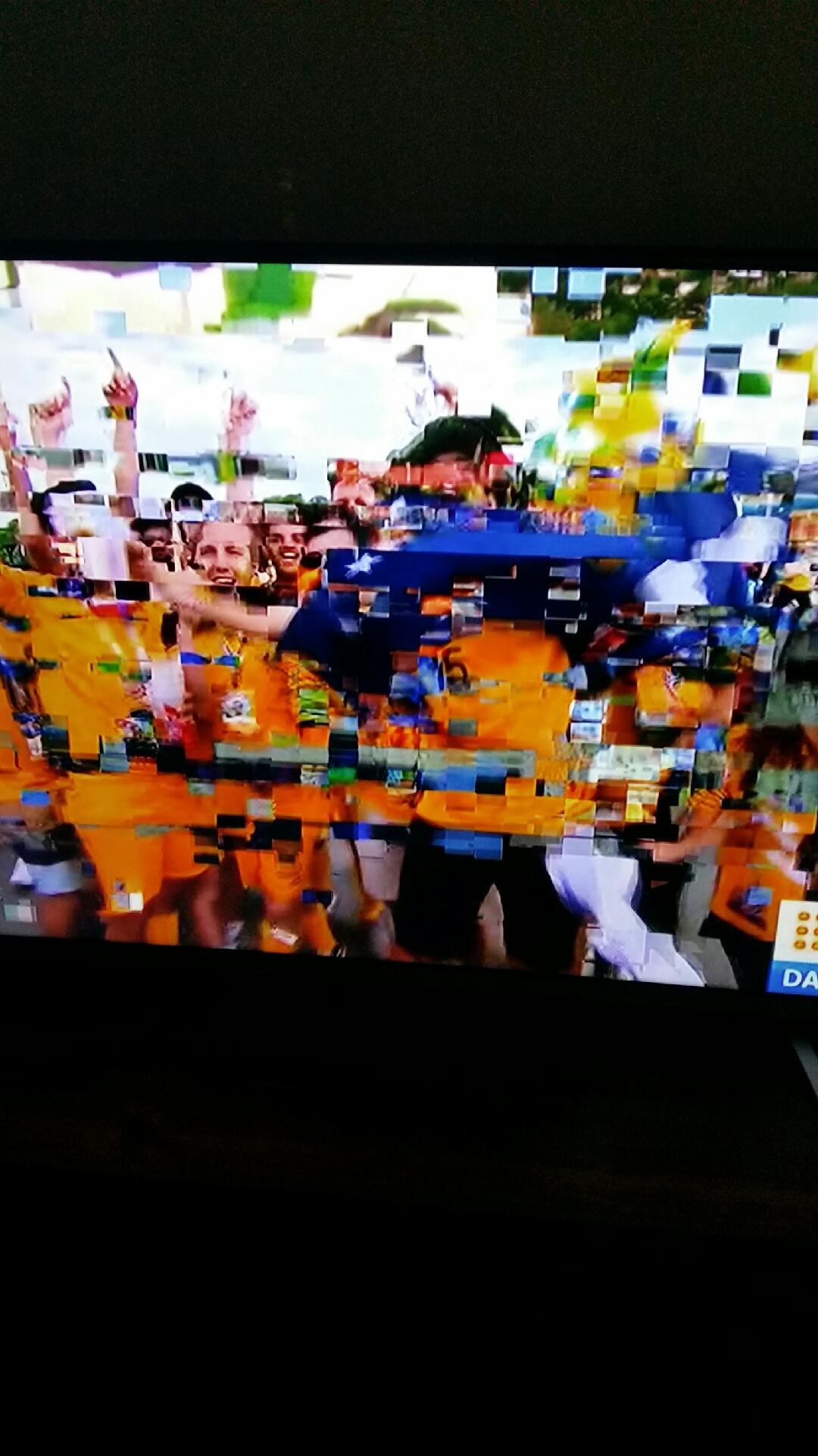

    A neighbour asked me to look at their main TV "as it is pixelating". Went in and set turned on and operated perfectly. Asked them to send me pics next time problem occurred so today two arrived and are shown below. They had antenna man in and he okayed that source as good. They have a small set as well and it goes OK. I will test with various inputs and also retune as matter of course but do have a suspicion could be local interference from some nearby source. Any observation or pointer for this problem welcomed.

    That looks like a signal loss problem, not the tv's fault but tuner sensitivity does vary between makes/models which could explain the difference between the 2 tv's

      When you have this pixelation turn the channel, if other channels come in ok, then probably just signal loss as stated, try different antenna or moving antenna if possible.

              Spot on R_J as I saw they were home so went and had a look at menu where a good diagnostic of signal showed all channels near or at 100 for strength out of 100 whereas quality was only showing 5 out of 100 with an intermittent jump to 41 but then straight down again. So it appears tuner is not converting the very strong signal into a quality output??? Perhaps voltage regulator not working right or cap gone off but this is outside my limited experience area so pointers very welcome. Of course my thinking may be awry and could it still be antenna or wiring.?? Sorry didn't get model as set against wall but think it may be 55P20US. Owner couldn't find handbook and some menu items including reset needed password. Did a retune but exactly the same. Set didn't show fault in the 30mins I had it on.

                  well, of course, you have now found that you have "strength but no integrity"... :-)
                  basically, it might be that the incoming signal is "over whelming" the tuner section of the tv.... since you have no way of knowing if "100%" is actually "150%". "Quality" is only somewhat related to signal signal strength in that "no or very little strength", will more likely provide "little or no quality" but the other way around isn't as true.
                  Further, you indicate that "they have a smaller set and it works OK", was it moved to the same location / wiring? Still further, how is the antenna feeding the sets? Is there an external antenna "amp" with dual outputs? or just a splitter?
                  IF just a splitter, try a quality replacement, if an amp (with dual outputs), try swapping the outputs. Further, if perhaps the signal strength is "overwhelming" try adding a "2 tap" splitter to that run which should "half the signal" and see if that changes anything (especially now that you know about the menu items for signal diagnostics).
