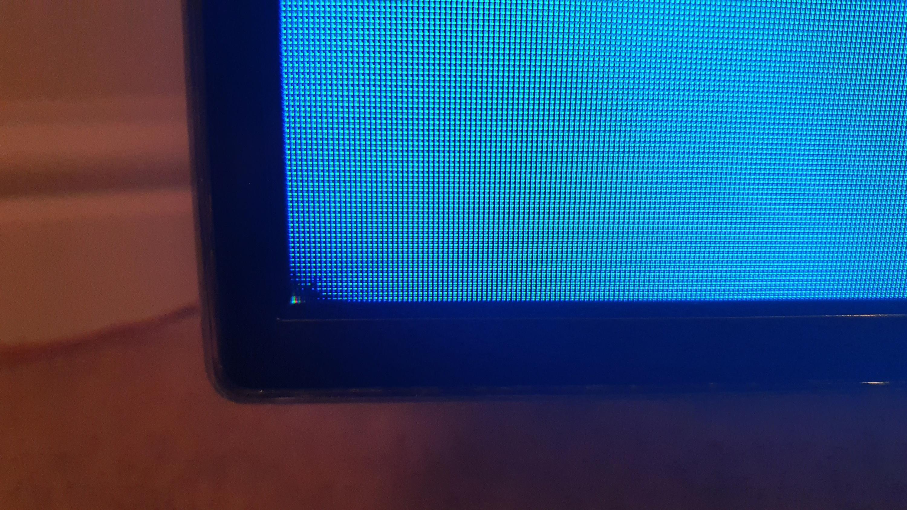

                    Re: Samsung UN50H6201 panel problem, half screen
                    So my TV just stopped work again. But before that i noticed some small burned pixels on the bottom left side corner where i put the tape (1st attachment).
                    Then i switched the TV off for a while and i switched it on again and it was working again but sometimes the same corner is going to lights up more than usual (2nd attachment).
                    So, i do not know what to do now. May be i need to tape more pins on that ribbon cable ��...

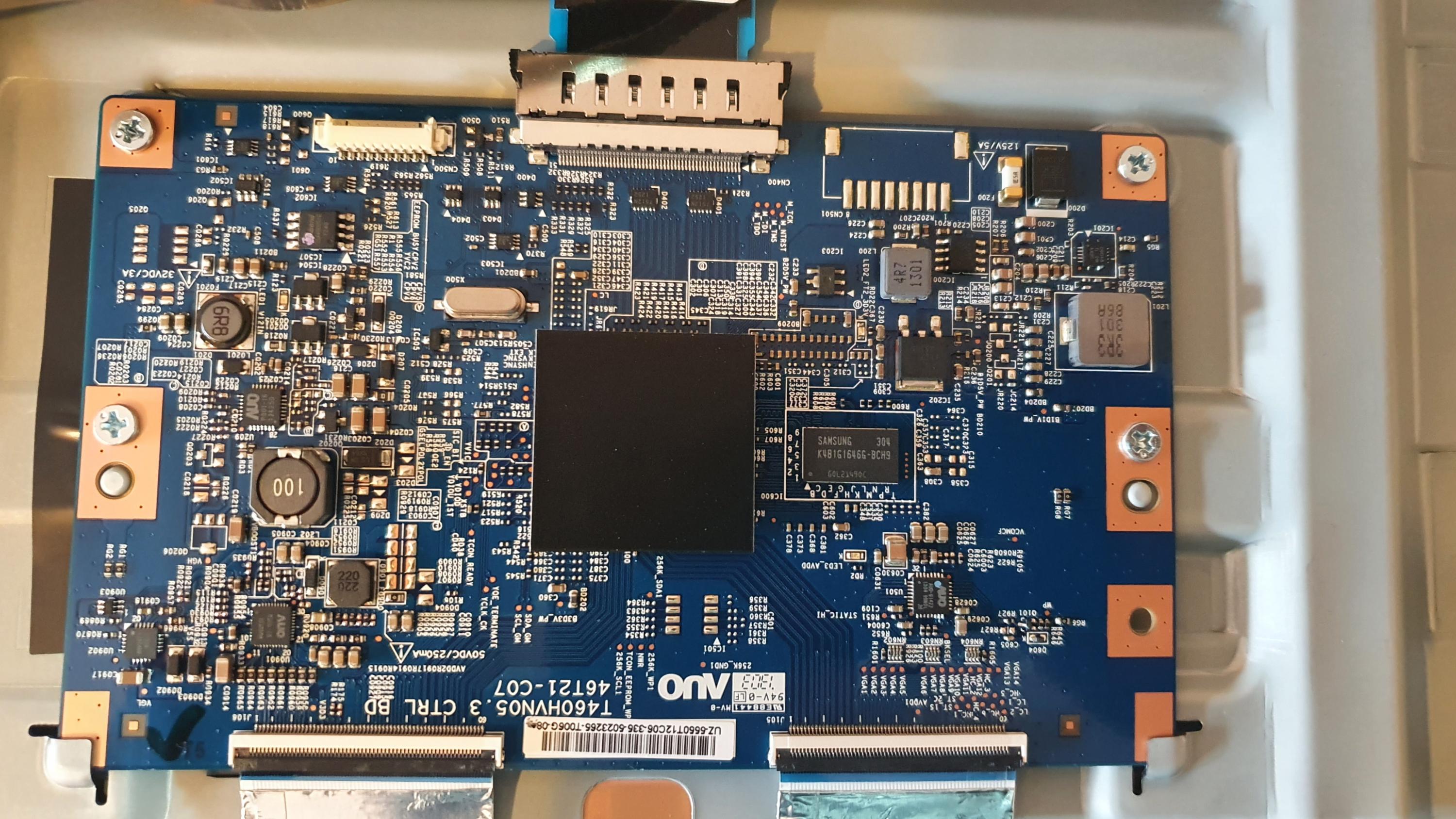

                        Ok guys. I just replaced the TCON board and it is working now. But i am wondering about these 3 blue leds on the TCON. Should all of them be on if everythings is ok? Because i've got only 2 on and led3_avdd - off. Could that be a problem? I am interesting and about the normal temperature of the TCON board. How can i understand if it is overhearing?
                        • Dobsuk
                          • May 2020
                          • 127
                          • England
                          #32

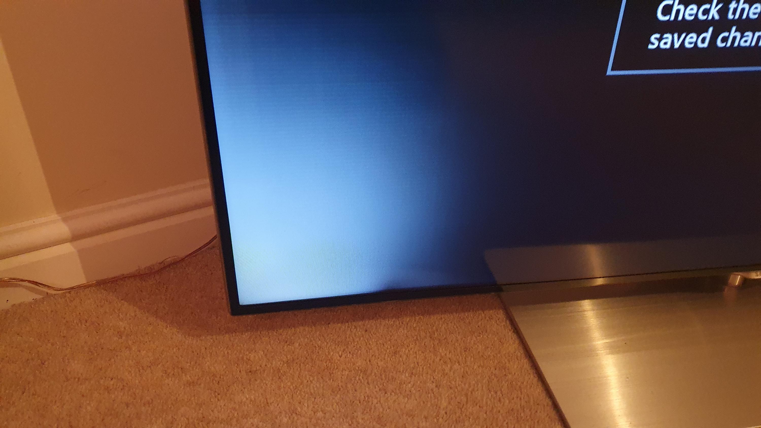

                          Just found now that the third blue led on the new TCON does npt come on does not matter if the ribbon cables are connected or not ?!? Is that mean faulty TCON?
                          Then i put back my old TCON and i can see all three leds on. The tv is working but this flash in the corner.
                          With the new TCON the tv looks to work normal even that led3_avdd is off but i am afraid to leave it working for longer before to hear your opinion.
                                  First time when i tried my "new tcon" was with tape on the pins as it was with the old tcon. And it was working but i was afraid to leave the tv on for longer because i saw that this led3_avdd does not come on and I did not want to damage the "new tcon".
