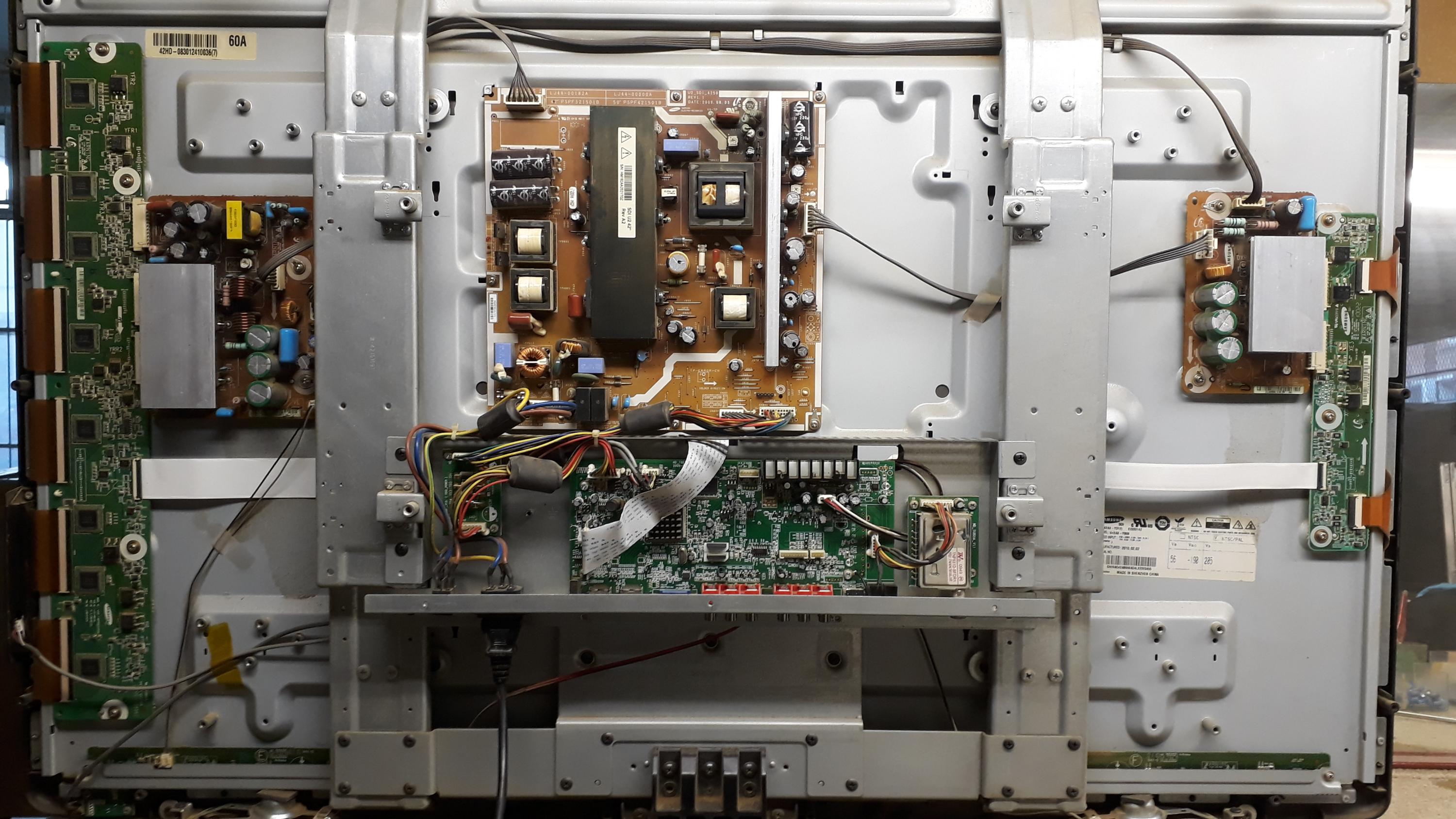

    Hi guys. I have another set with a very unusual fault. When inserting power to the set i notice that after a few seconds the standby light starts flashing rapidly but there is no picture on screen. You do hear a relay click in, thats all. I found many caps bloated, some other with high esr. I changed about 15 caps on y-sus, x-sus, psu and main av board. This made no difference. I then stripped the tv until i got to the logic board and noticed the following. Upon powering up the set, the led on the logic board makes one quick flash... then comes on continuously for about 4 seconds and goes off permanently. The VS-ON pin going to the PSU does activate for about 4 seconds. Va = 55, Vs = 205 and Vscan = -190. These are all spot on according to plasma label. I checked all fuses and two green micro fuses and they are good. I checked all mosfets on y-sus and X-sus and y buffer... could not see any shorts. I then checked voltage regulators on main av board. It has two LM1117 regulators both being supplied with +5.2V. One steps diwn to 2.5V but the other steps down to 3.16V. I thought this to be strange and replaced the LM1117 with another one but got the same 3.16V. The output of the LM1117 measure in the kilo ohm range so no short there.

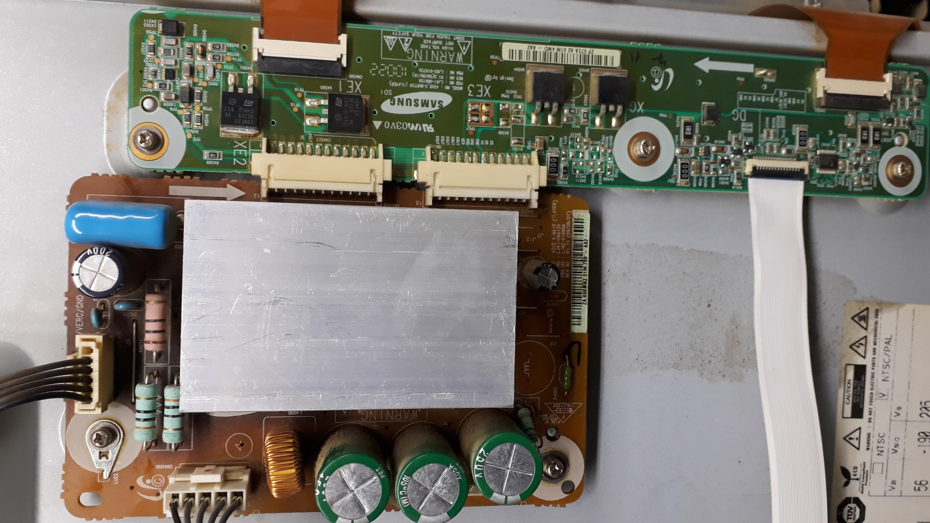

    What i notice is that the tv starts up but the logic board shuts down the y and x boards. Some error i cant identify. Is there something else i can check or test?
    Kind regards

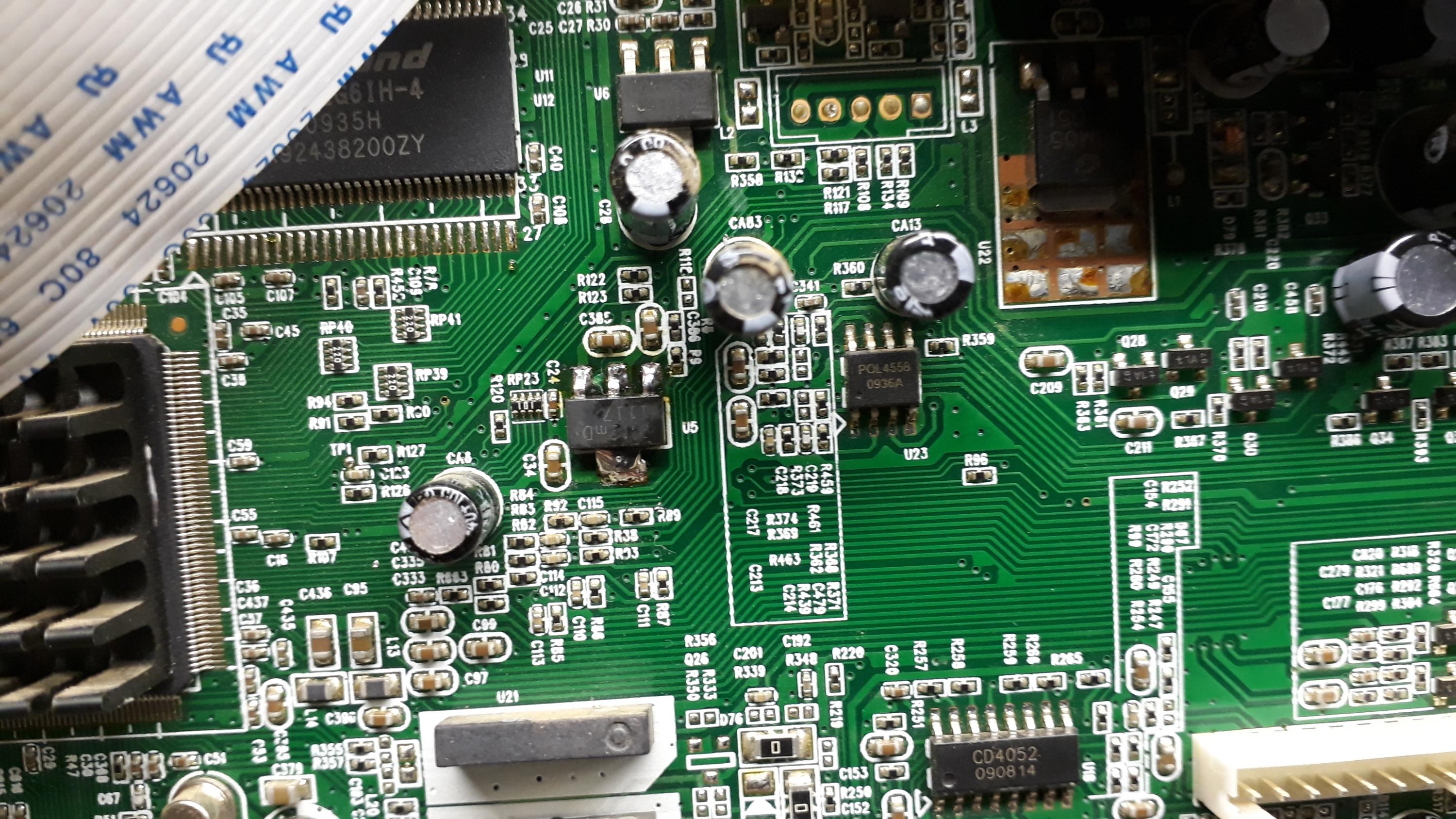

    The LM1117 is available in 1.8v, 2.5v, 3.3v, 5v, and adjustable version. they are not interchangeable

      Yes i know, on the above mentioned tv it uses the two resistors which control the ADJ pin on the voltage regulator. It's just a bit strange at which it controls the voltage.
      I still can't make sense of where to look for a fault. I might take oscilloscope readings on the y buffer board and see if i get the correct waveforms.
      It has Yfr and Yrr test points.

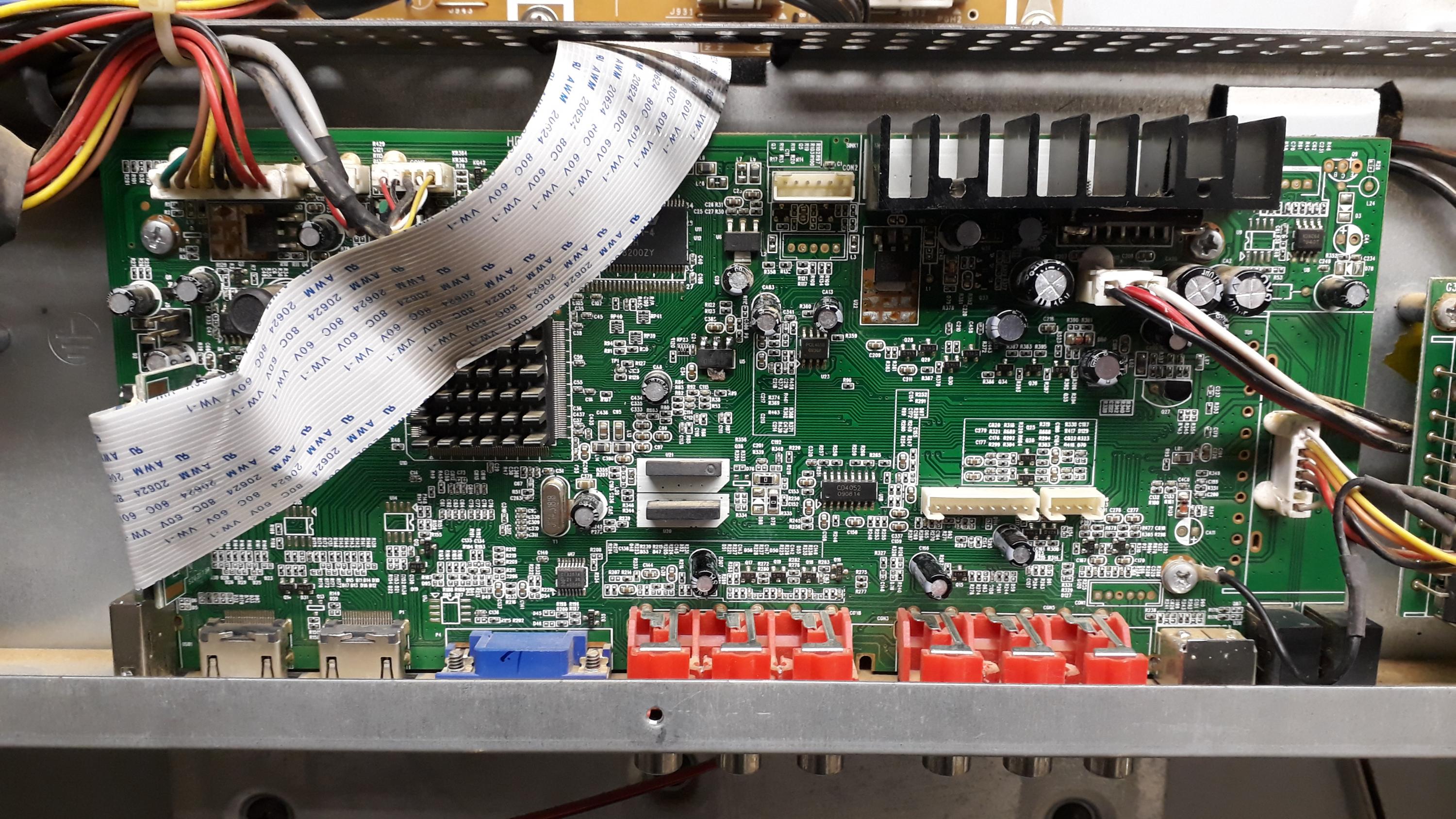

            I spoke to a friend of mine that suggested i replace all electrolytics on the main board. He had weird symptoms and it turned out to be a 100uf cap whose ESR measured fine but the capacitance was way down. I will keep you all posted on the progress of this one.

              If you have a scope, use it to check the caps, if you see a lot of high frequency ripple its not doing its job and is liklely bad.

                Hi R_J, yes i went back to the main AV board as suggested by a friend of mine and replaced the rest of the electrolytics. You cant believe it but when the cap is connected in circuit the ESR value is good but take it out and you get 27 ohms. After replacing all the caps the TV started up and i could tune the RF channels. There is still a problem though. It seems some times when you start the tv the screen remains blank as before except that the standby light does not flicker anymore it stays a solid green color. I now need to investigate what exactly is not starting up. Will keep you posted on the progress.

                  Just an update. After replacing all 26 caps on the main AV board the sets starts up correctly when its been running for a while but on cold start up the Vs volts And Vs-on volts from logic board fall away after the sets power button is pressed (4 seconds) and the sets sound starts without a picture. If however you put the set into standby and again on then it starts up properly and runs.How do i go about determining where the fault originates from. What would happen if i force the Vs-on pin going to the power supply when set is cold. I really dont want to blow mosfets. Has anyone done something like that?

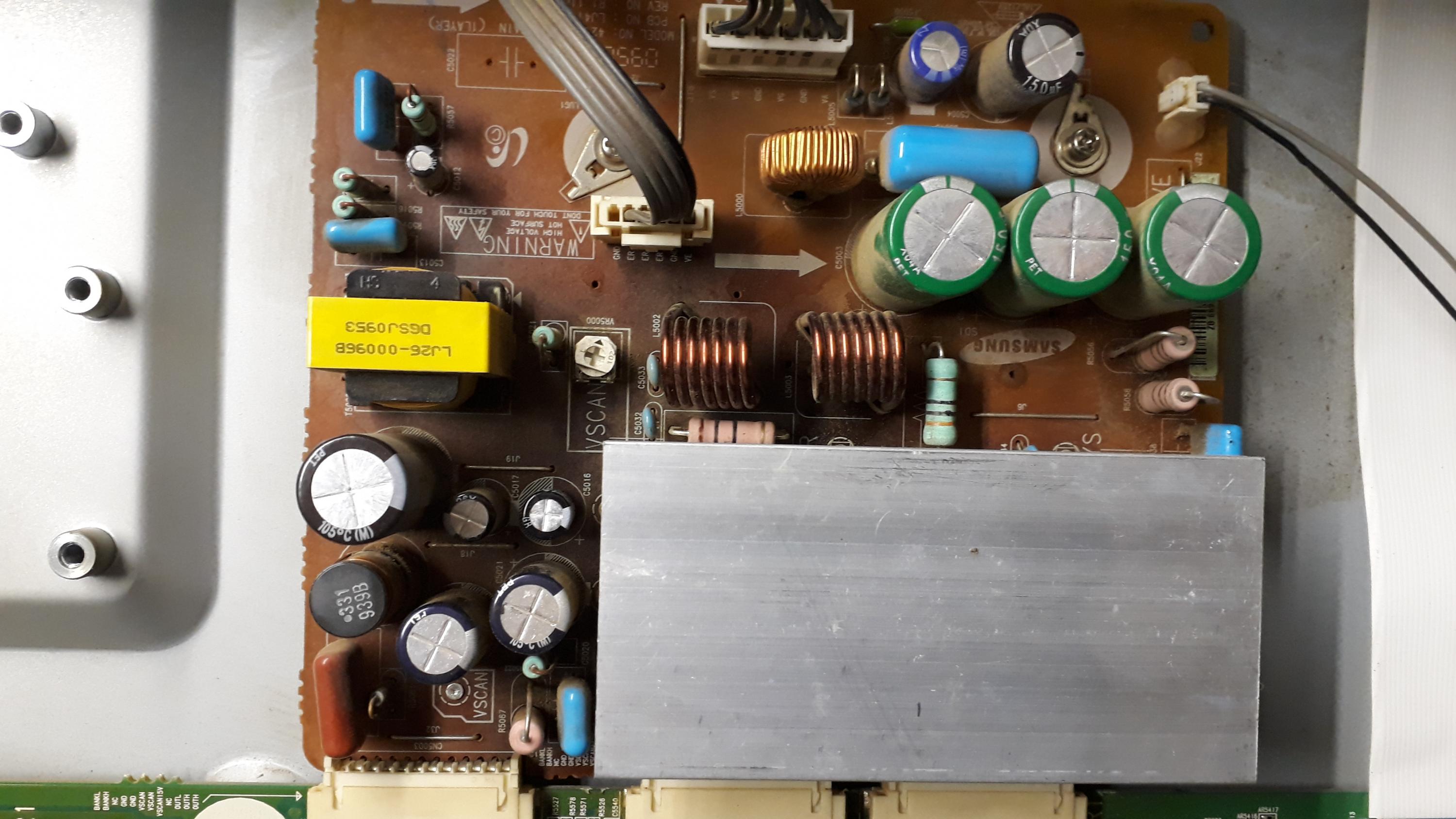

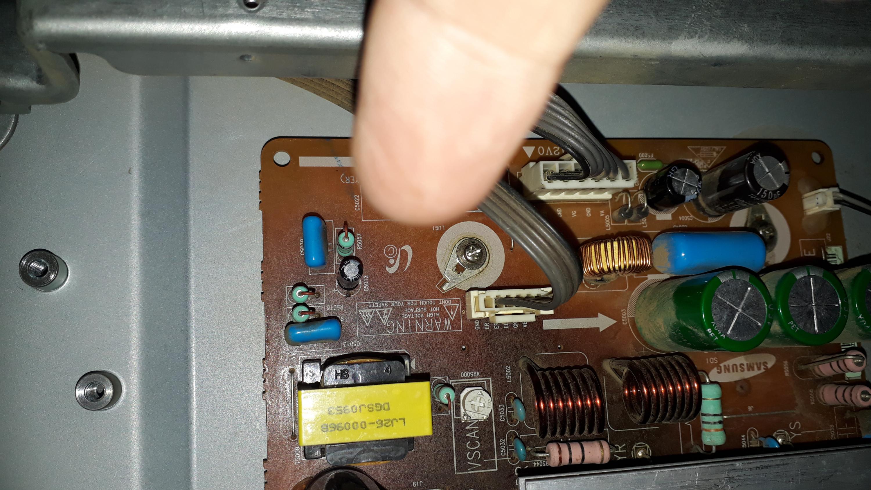

                      Thanks R_J. I dont know how i never ended replacing that cap but check the picture i attached. This 22uf 50V cap had a above 100 ohm esr reading. I had loosened the one point of the cap to measure it reliably but never changed it. I have subsequently replaced it and am waiting for tomorrow morning when its really cold to start it and see what happens. Check pic.

                        That cap seems to be for a small smps ic that supplies a few voltages on the ysus

                          After a cold start this morning i realised that it was the cure. Done and dusted. I replaced 32 capacitors on this set. Whew.

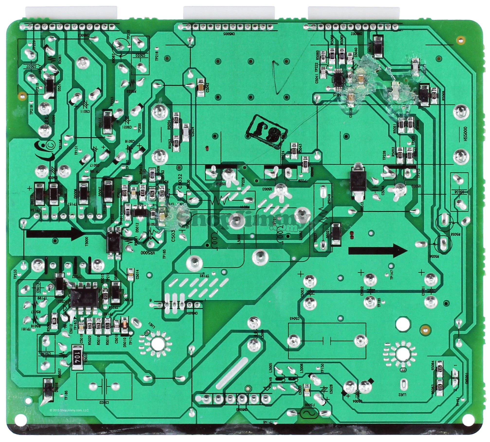

                                    Anybody with plasma repair experience able to run me through this set?

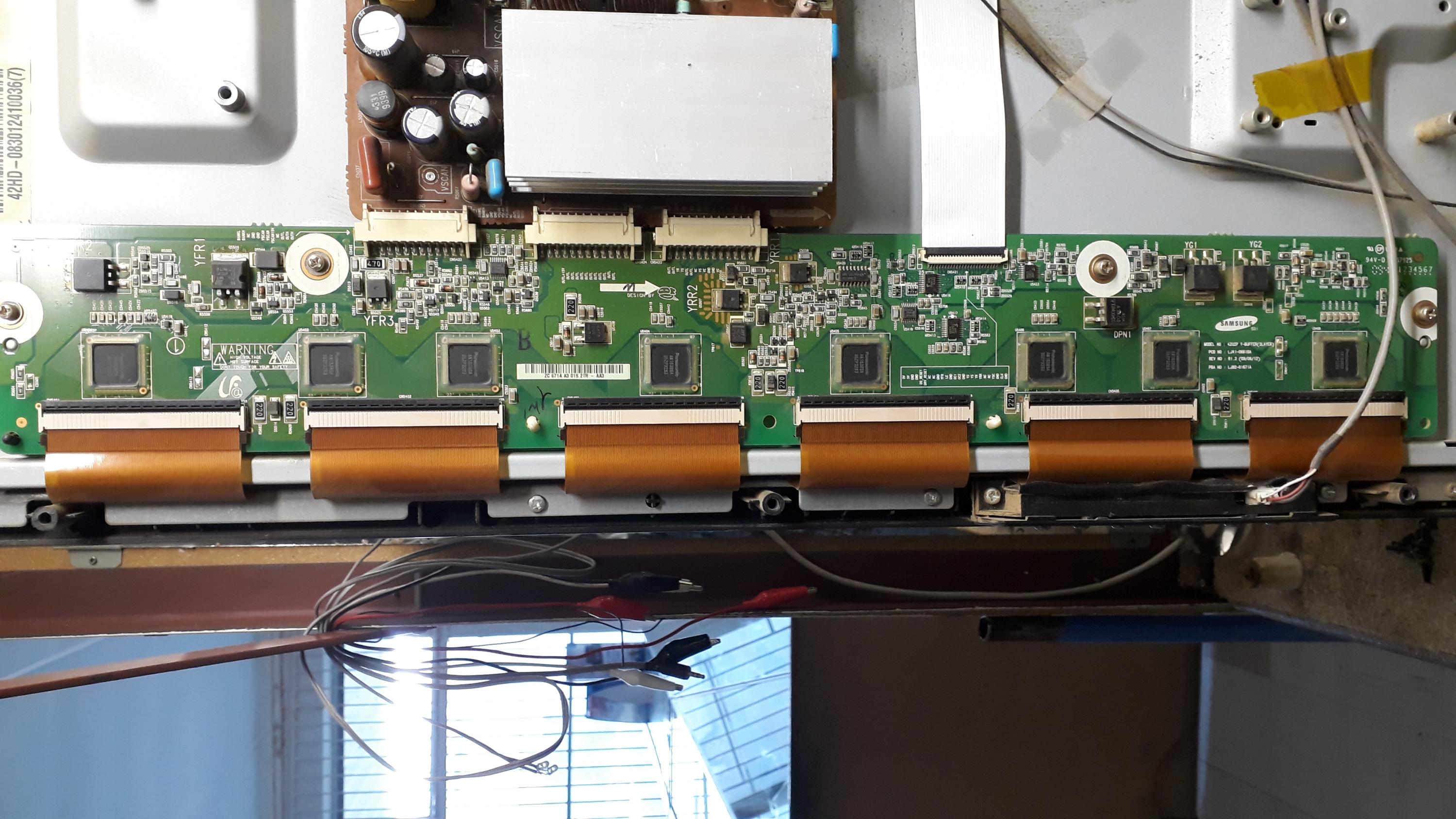

                                    I even shorted pins 3 & 4 on Z board (TCON) and i get nothing. Dont have waveforms or any info to help me diagnose where the issue is. Heeeelp.
                                    • lookimback
                                      • Aug 2013
                                      • 1489
                                      Re: Telefunken Vegas 42" plasma TV not starting
                                      Post a picture of the logic board.
