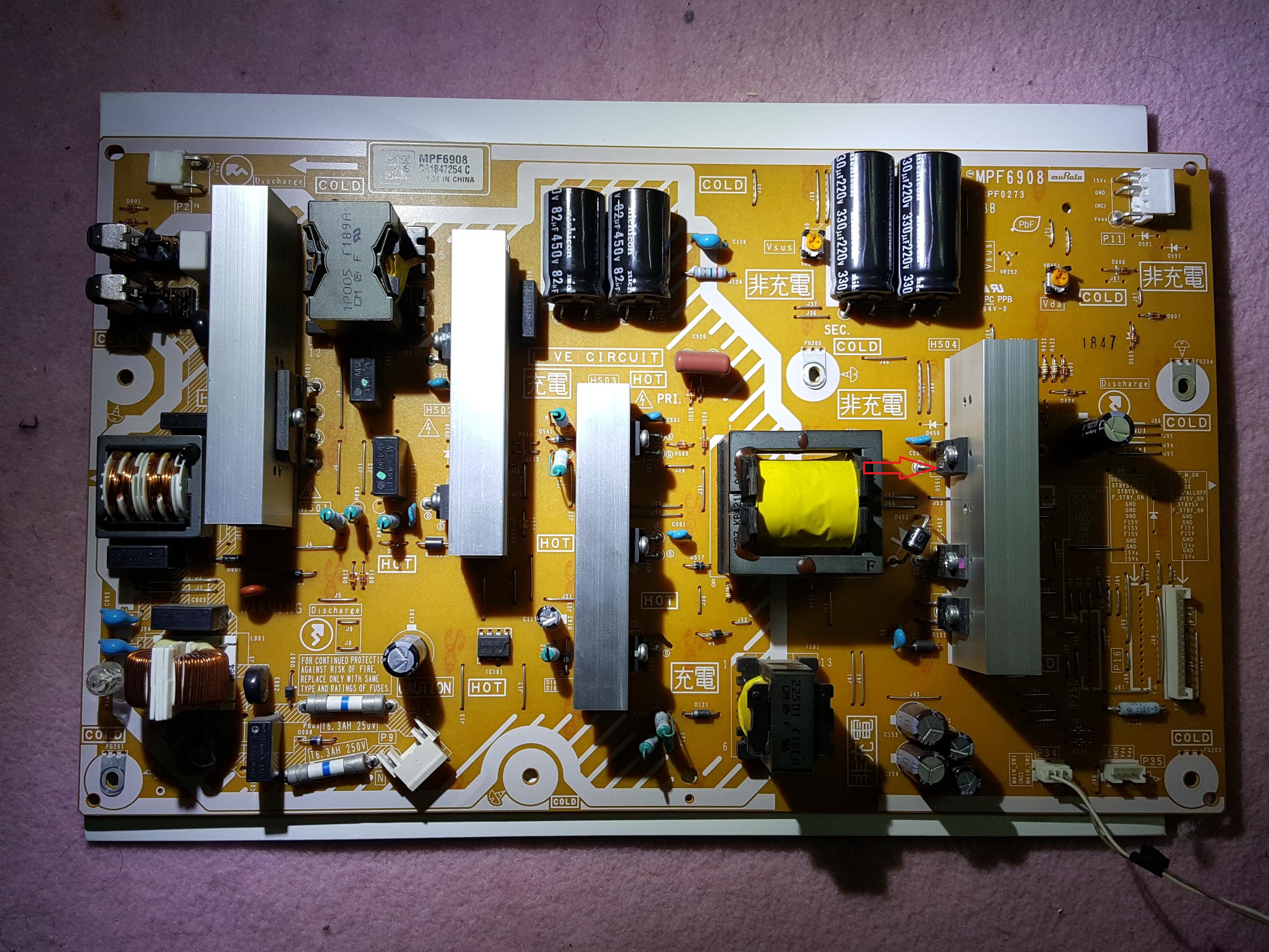

    I need help to fix my panasonic Tv witch dont have power and standby voltage even i chek the fuse also fine but relay dont have click sound when trun on the power
    Is any one help me to find the problems

    Welcome to the site. A good start is as I mentioned in your initial post was to provide good pictures and any voltage measurement you have taken so far. We do not have the set in front of us so the information requested would help.

      Hi
      picter of power supply
      This supply not giving standby volt and not truning on power led light front panal also

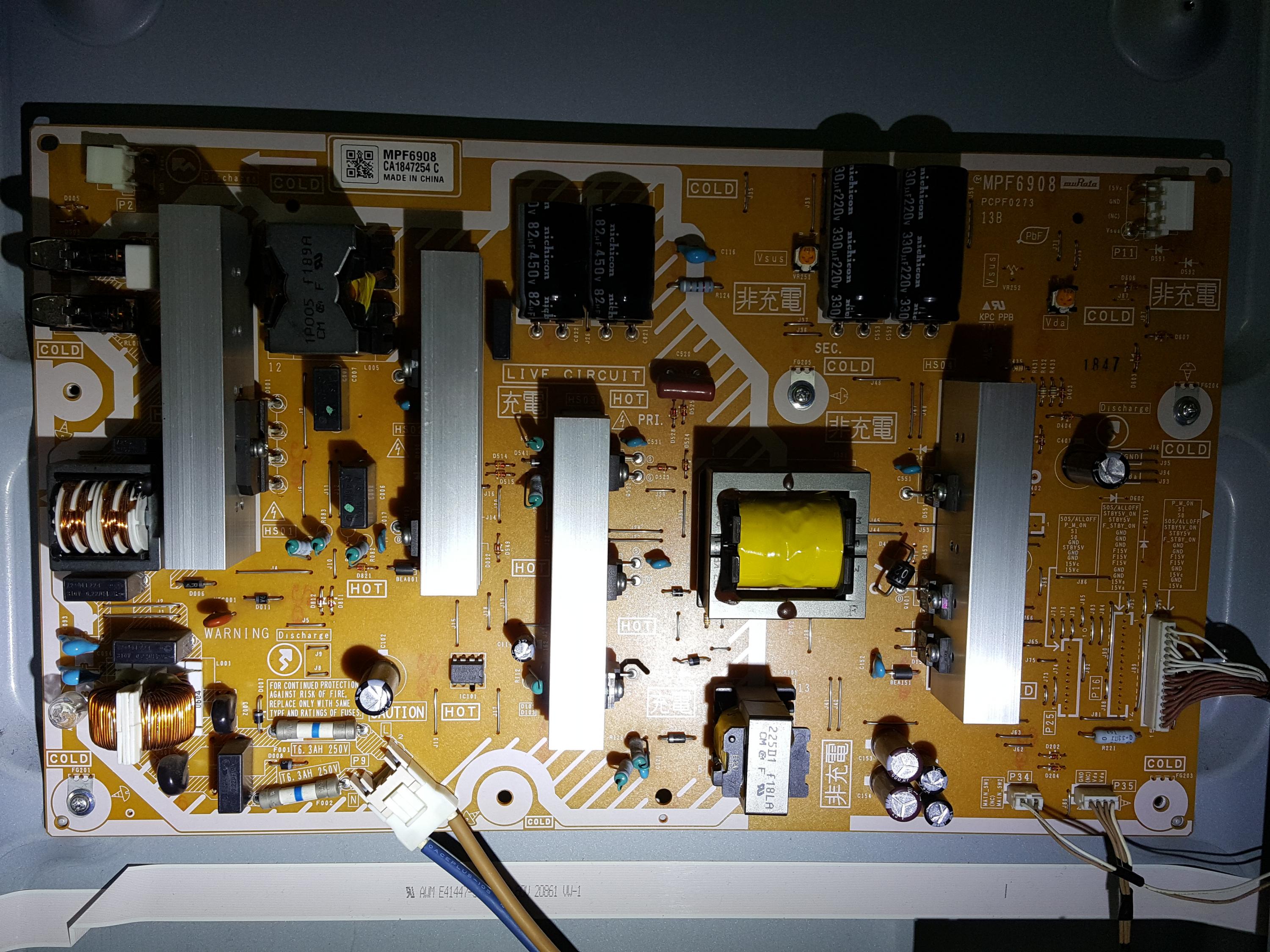

        Hi mr Dick Barton
        I upload the power board picture have you see
        I chek the voltage
        P1 -.5v
        P2 .5v
        P3 .3v
        P4 -.3v
        P5 35.4v
        P6 3.5v
        P7 .5v
        P8 -.5v
        P9 -.6v
        P10 -.2v
        P11 -.2v
        P12 -.6v
        P13 0v
        P14 -.6v
        P15 0v
        When i on the power ac dont have click sound relay
        If i force relay 002 to on the i have this voltage
        P1 .-1v
        P2 9.2v
        P3 8.5v
        P4 -1v
        P5 35.7v
        P6 3.5v
        P7 .7v
        P8 -.6v
        P9 -.6v
        P10 0v
        P11 0v
        P12 .-6v
        P13 .1v
        P14 .-6v
        P15 .0v
        Please help

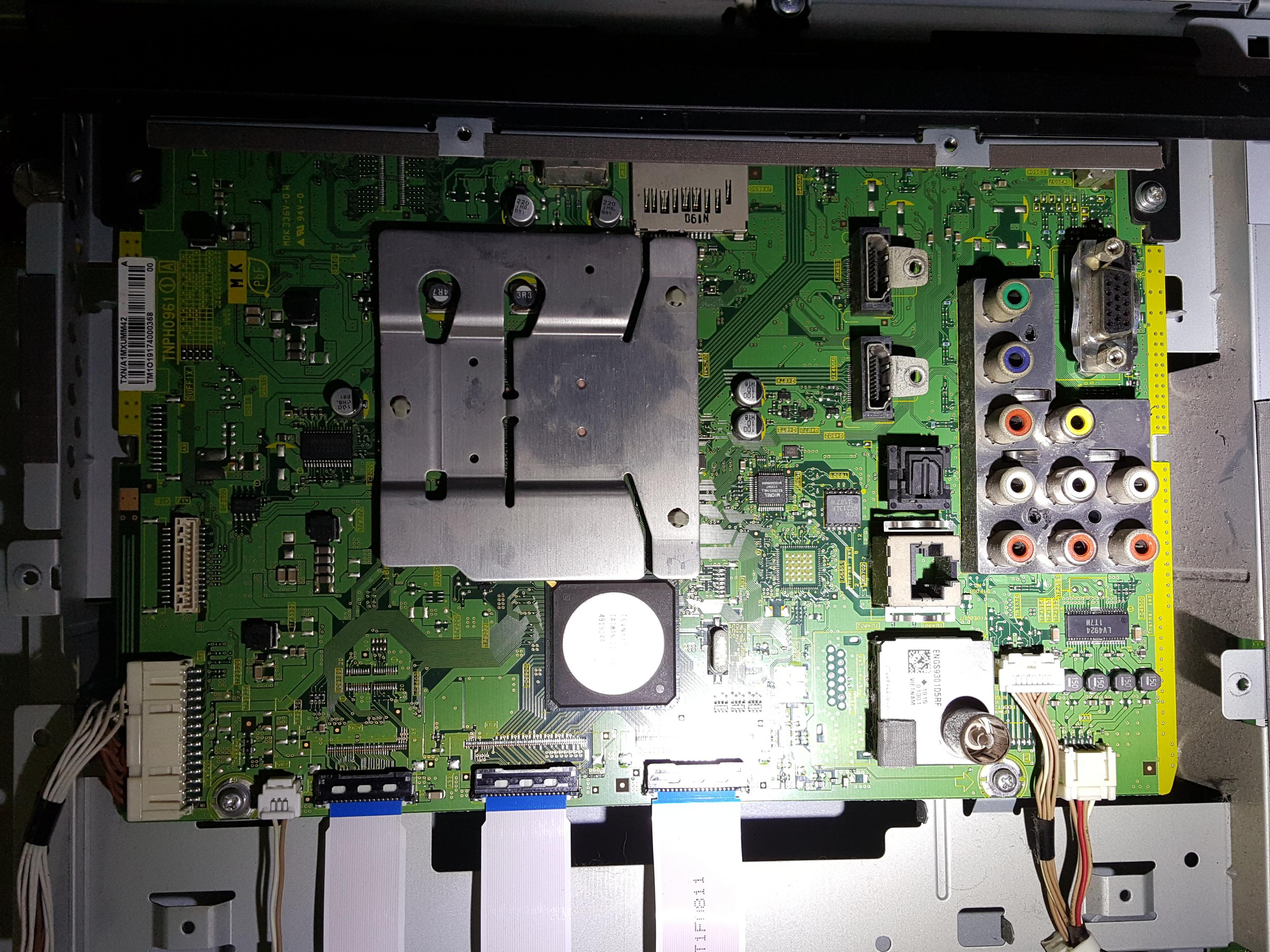

          This is more pictures

            Is there damage to this component?
            Are you certain you have 35V at P5 (STBY5V_ON)
            Read through the following https://www.badcaps.net/forum/showth...+supply+plasma
            Post #2 explains how to test your power supply
