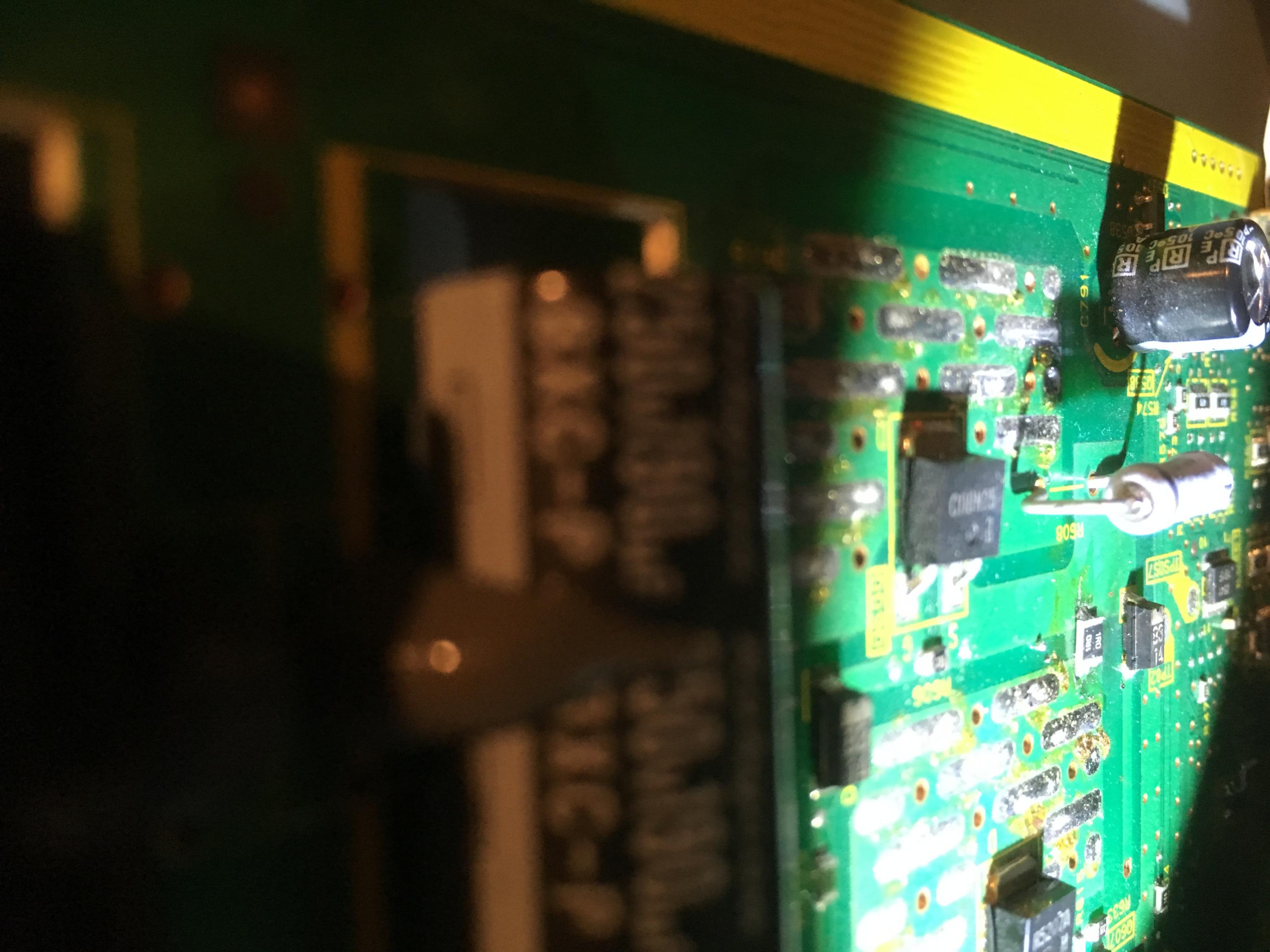

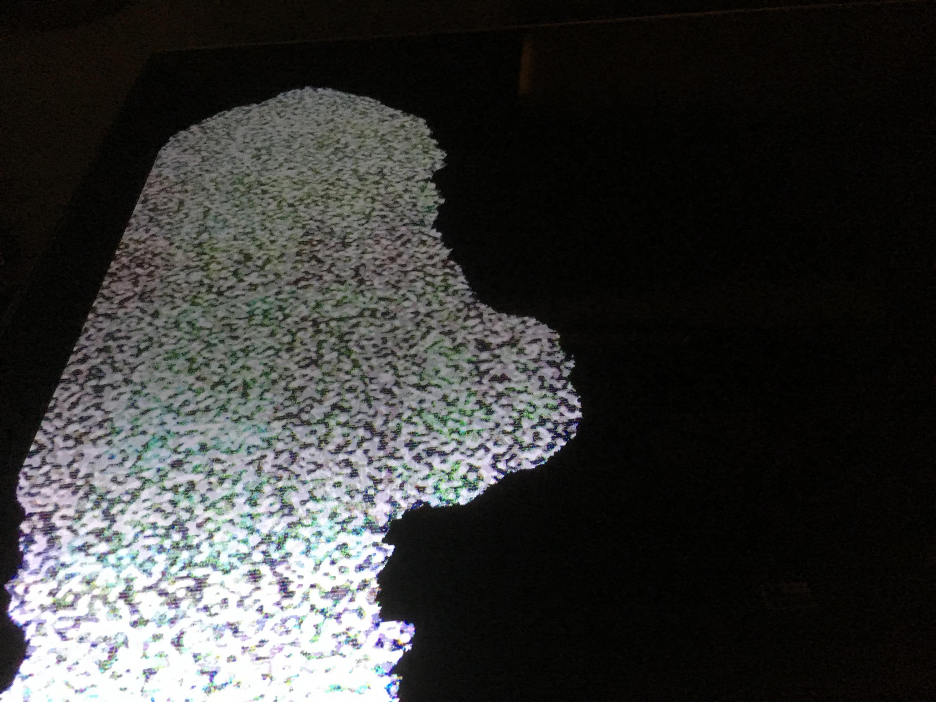

    Hi All
    Ive got A th-p50vt30z plasma was going perfect till it got the 7 blinks of death
    so i replaced the faulty suspected transistors with some cheap ebay ones
    tv went for a few hours the Pop blew up again.. after seeking advise was pointed to a reputable source so got more transistors and replaced those
    now tv turns on to a solid green light ,displays some garbled writing for a split second and stays a black screen
    still faulty board or had something else got damaged in the process?
    link to video.. sorry if its a bit dark
    https://www.youtube.com/watch?v=Ys6T...ature=youtu.be

    Re: Panasonic Plasma fault
    Make sure all screws are in and check wire and ribbon connections.
      You still have a faulty board because you used cheap ( fake! ) parts from ebay. They indeed work sometimes ( for a few mins ) and go out with a bang and damage the board even more.
      I had the same problem , never fixed the board....
            The cheap parts that blew up did more damage to the board. I cant find that model number here in the USA to look at a pic of your board.

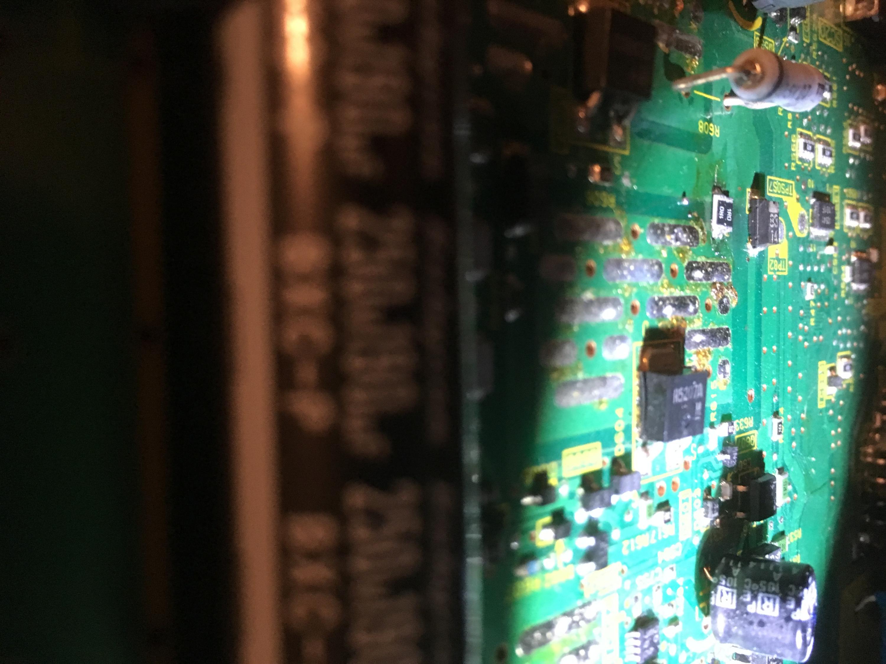

              hers a pic
                any idea what the voltage should be at sc2?
                  Originally posted by boomtheroom
                  nah replaced the cheap parts with good ones..still no go..
                  Yup but you used fake parts on the board which resulted in more damage to the board. I see you used the FGD4536TM to replace the bad parts.
                  The problem with bad parts is that they cant handle the load and literally blow up and take out other parts in the same trace.
                  In europe the voltage should be around 215V on the prong connector.
                  There are more parts defective on the board , could be a resistor but you need to measure every single part......
                  Could you check for shorts on the SS board?

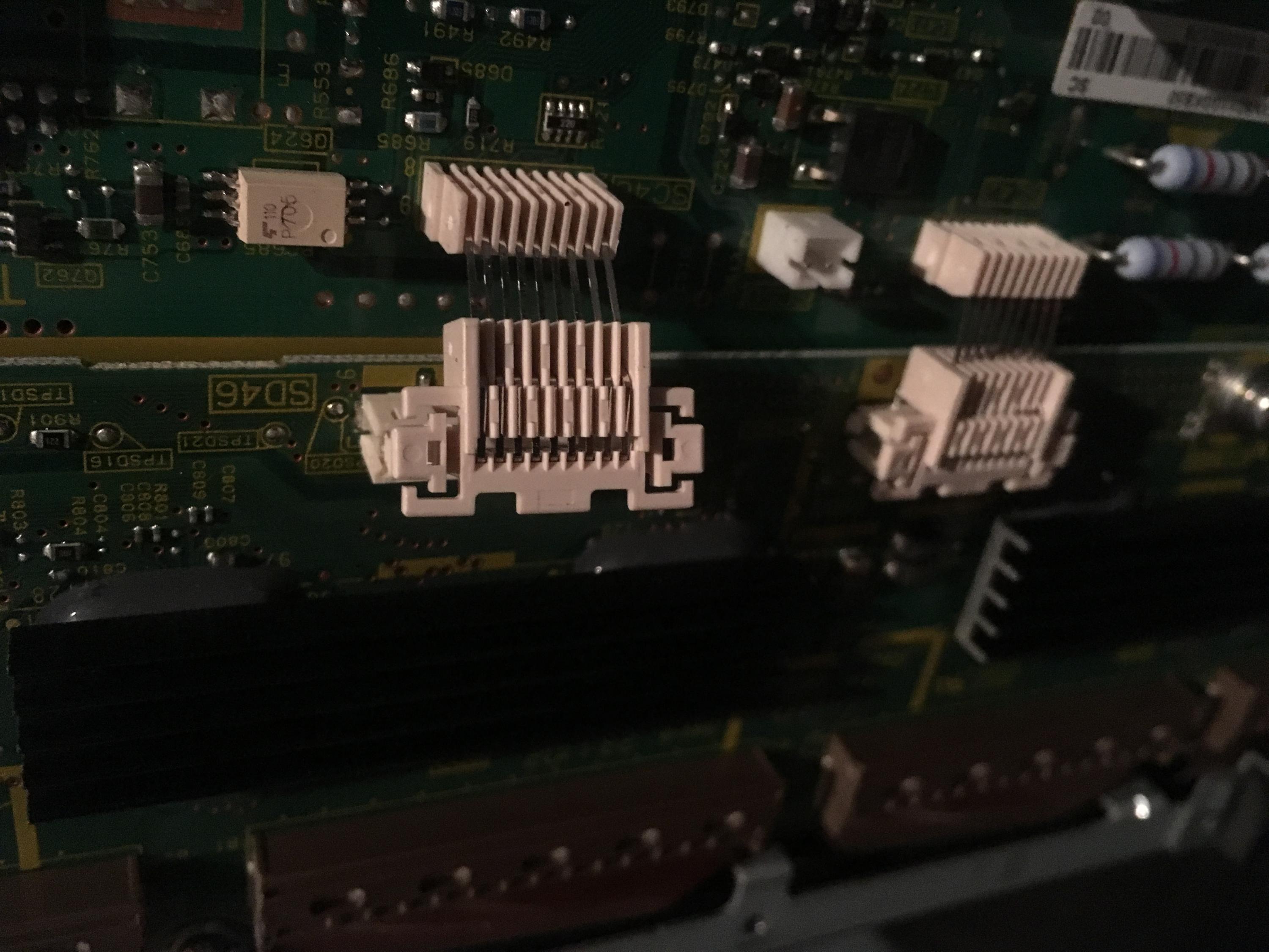

                            found a short on one of the white plugs that connects to the lower buffer board bit of stray solder was shorting 2 pins..removed that reconnected now i get this!!!
                            • boomtheroom
                              • Apr 2018
                              • 28
                              • new zealand
                              anyone ever seen that before?

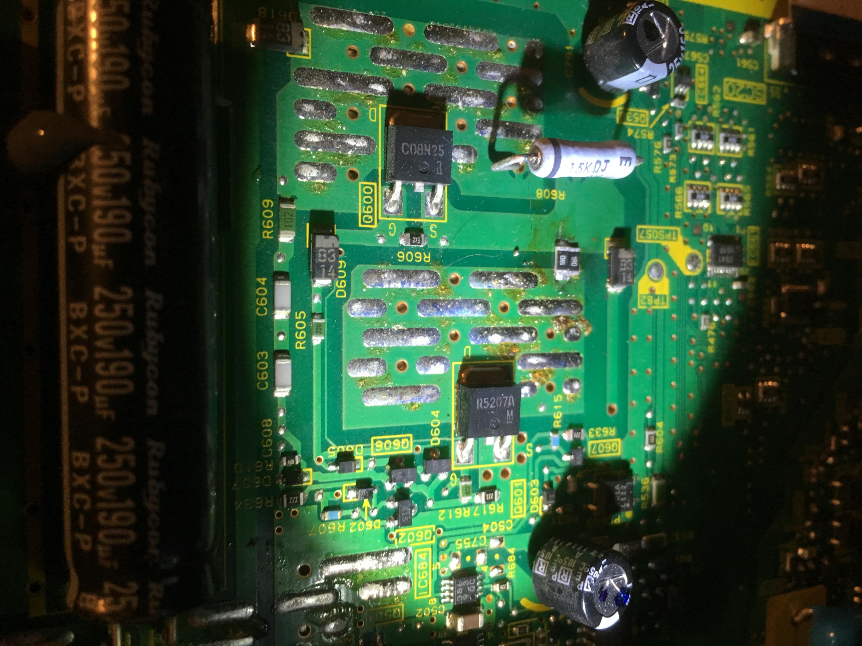

                                  Just found a couple of cracked ics r5207a and c08n25 the first tests ok still but the latter is open on all legs..are there any good or better chips to replace these bot with?
                                    Dont know , you probably need the original ones.
                                    I also ordered the fgd4536tm from monitor09 but mine look different from the originals....im afraid to use them.
                                    Do you have a picture of your FGD4536TM? A non soldered one...
                                      You will need to use the original parts for replacement. Moreno, I told you to buy the fgd4536 from "the guy". I have never had a problem with any of them. I have a 55" up on my buddies wall, at his tavern, that is running 14 hours a day on max brightness. I can send you a pic of mine to compare to yours if you need.
                                        Yes Timmy please do so. I ordered the same and mine look completely different then the ones i had before....
