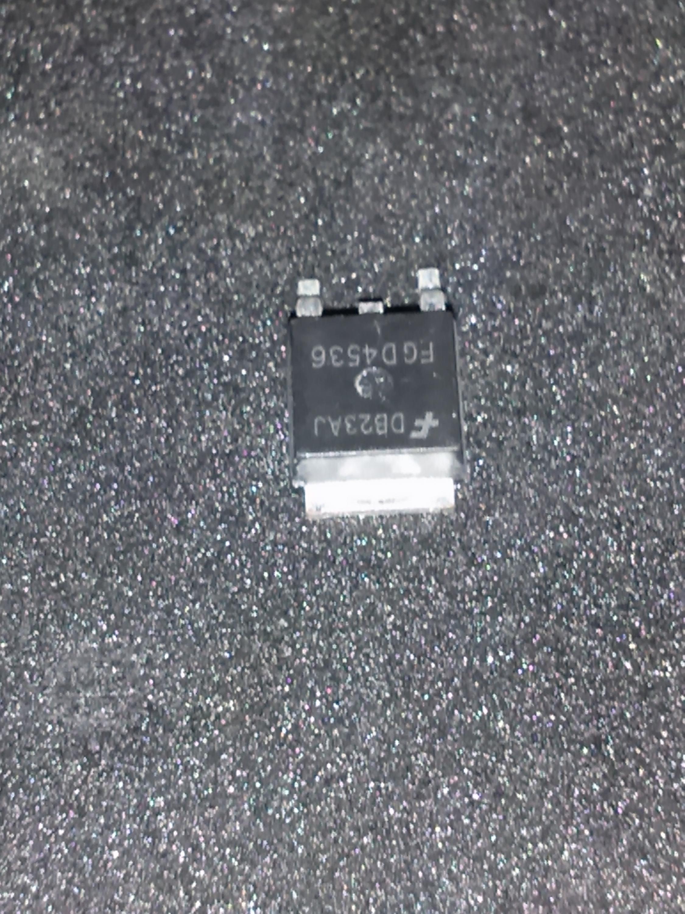

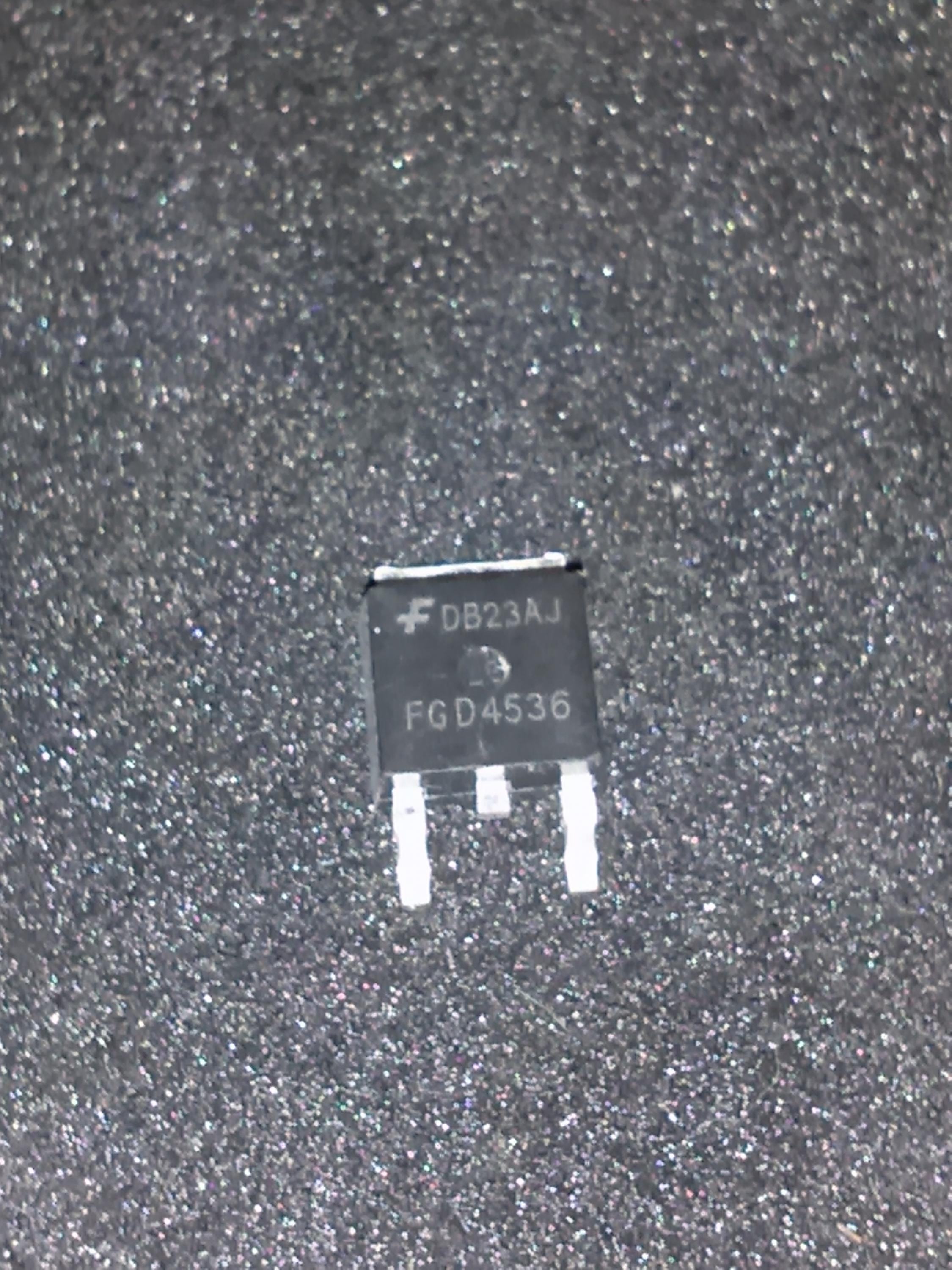

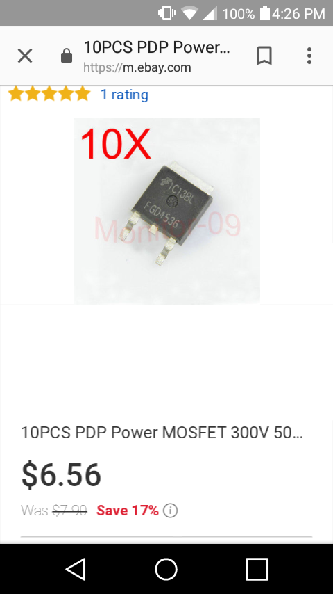

    These are the ones I have used for years.

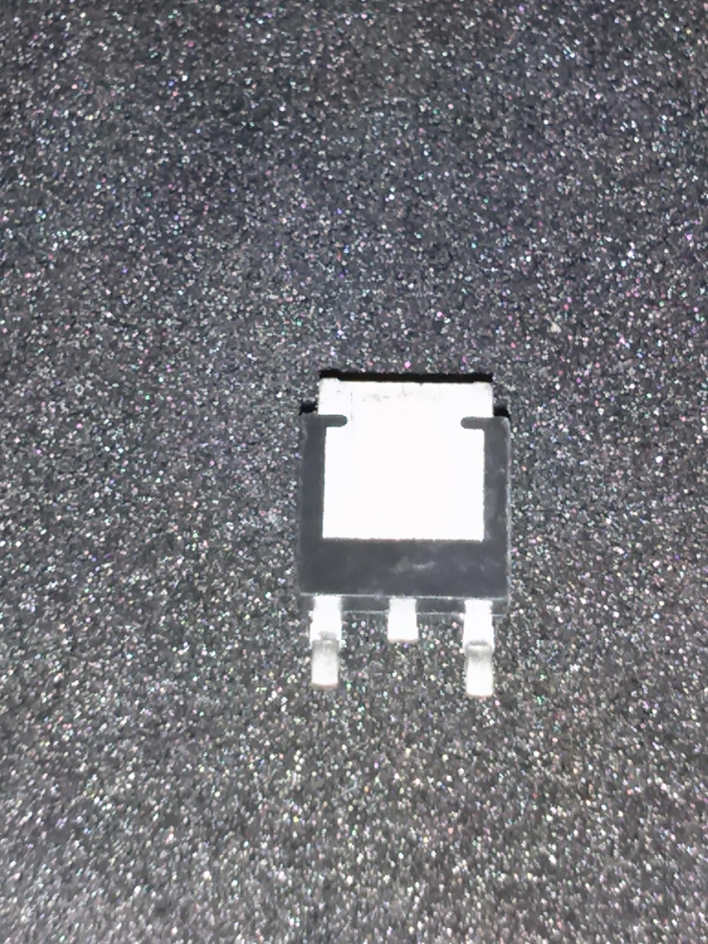

      You will need to use the original parts for replacement. Moreno, I told you to buy the fgd4536 from "the guy". I have never had a problem with any of them. I have a 55" up on my buddies wall, at his tavern, that is running 14 hours a day on max brightness. I can send you a pic of mine to compare to yours if you need.
      Whos the Guy?
      • Moreno83
        • Jun 2014
        • 2008
        • The Netherlands

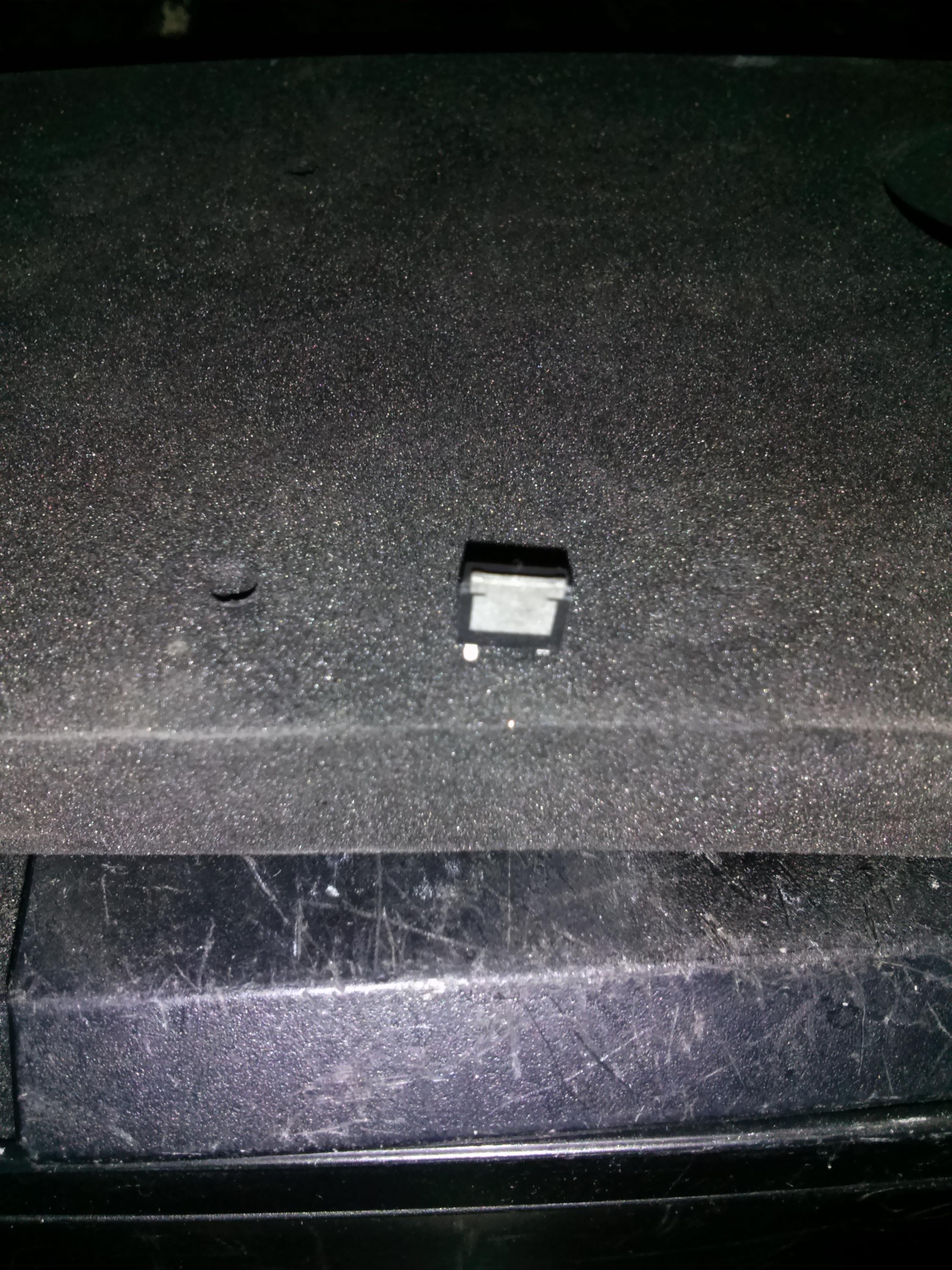

        Re: Panasonic Plasma fault

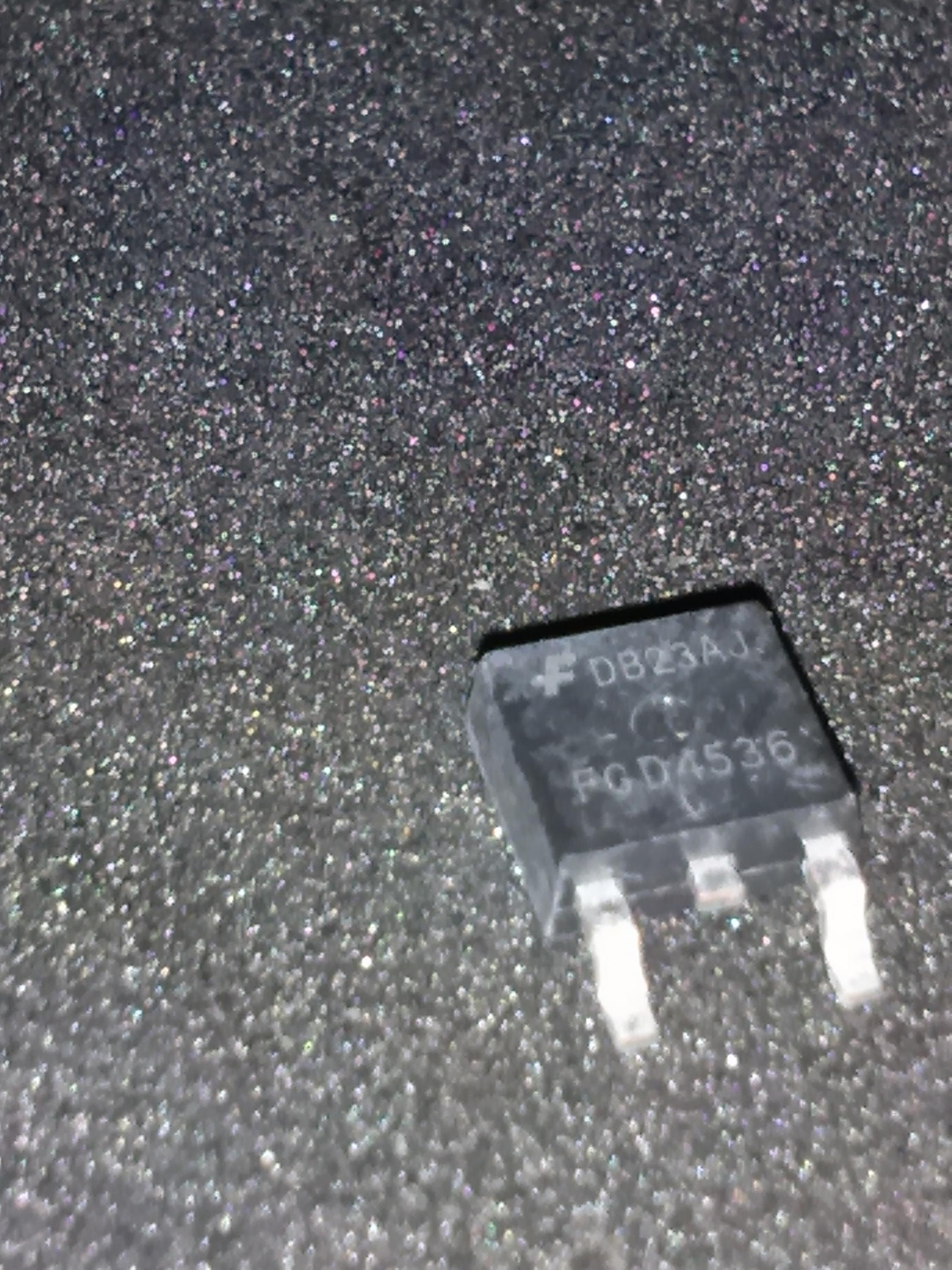

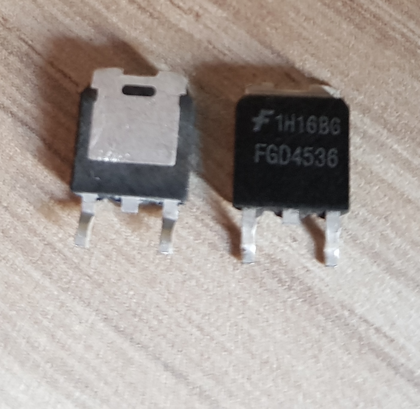

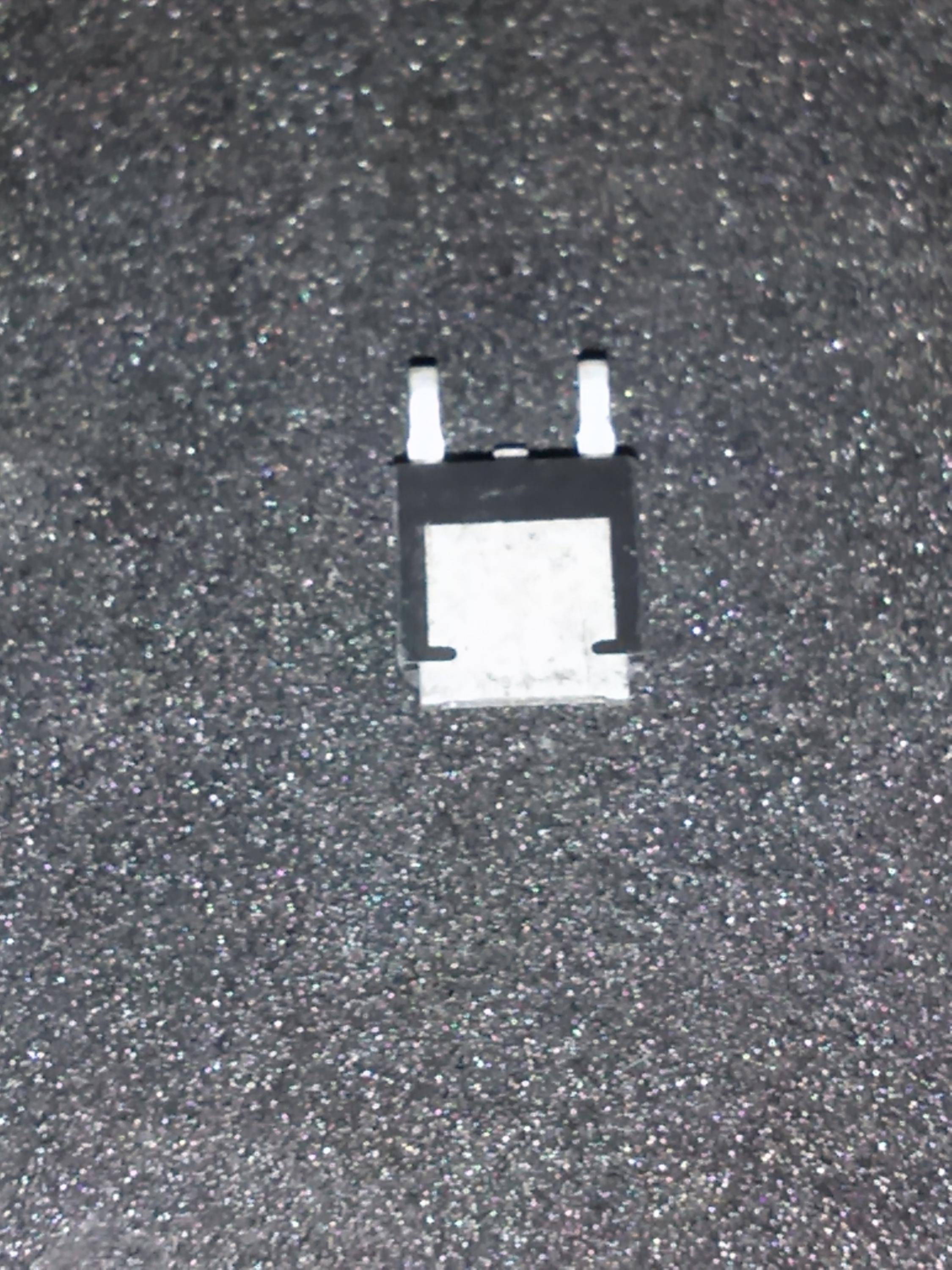

        Look at mine haha. No hole and look at the shape.....
        Im not going to use them.

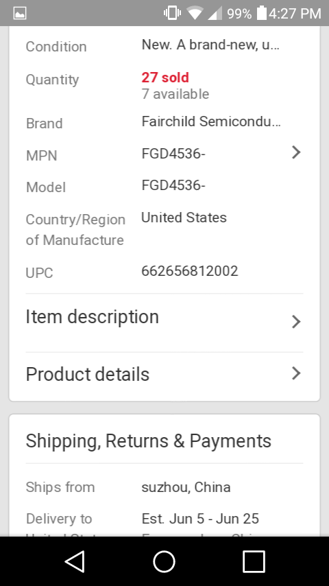

        The guy is the person where you bought it also from on ebay.

            Originally posted by boomtheroom
            Whos the Guy?
            Look in the 10X picture attached by tvtimmy and you'll see "the guy" in the background as watermark...
              I dont buy from monitor9 anymore. They sent me a 30 batch of fake FGD4536. Got my $ back . No hole, or divot in the middle.
