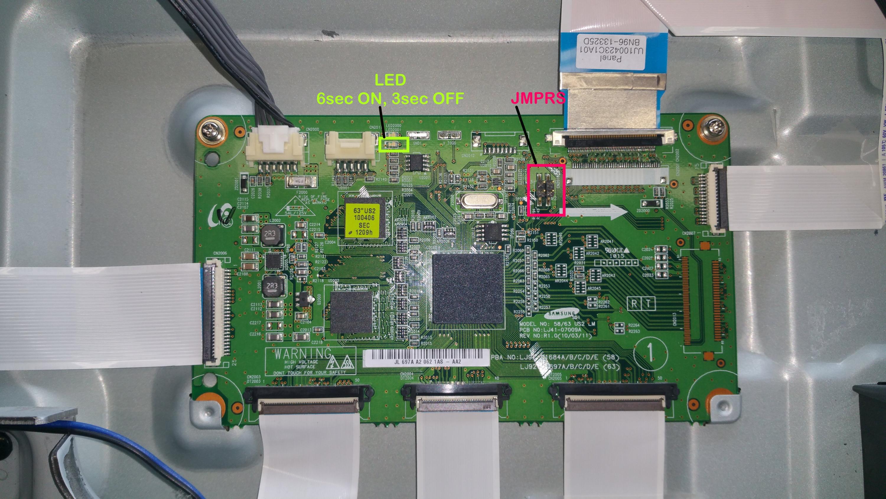

    Re: Samsung Plasma PN63C550 Replaced Y-SUS Voltages Good, Then Drop
    Speaking of the Control Board..
    It has an LED that has a pattern when the TV is turned on.. 6 sec on, 3 sec off, 6 sec on, 3 sec off, etc etc etc...
    There are also a pair of jumpers that, if I remember right, can be used for diagnostics??
      Your plug CN2006 on the control board is NOT seated properly. The leds indicate temperature and indicate the board is working

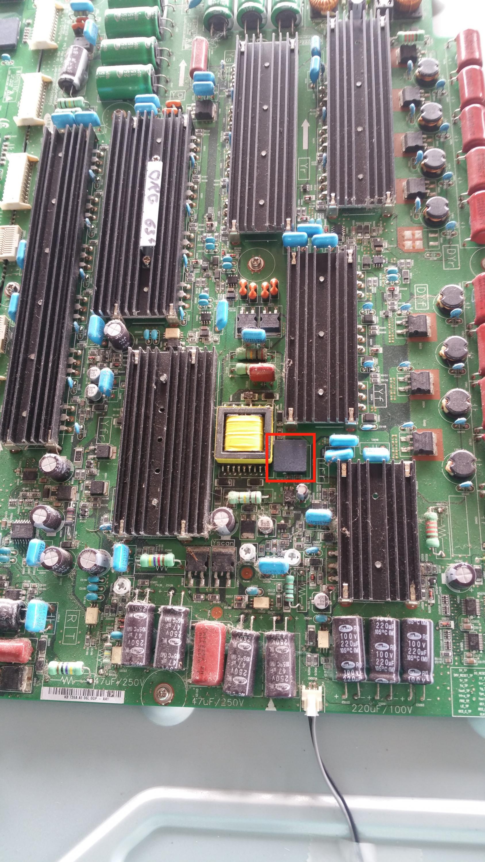

                    Freeze that IC under the wafer to the right of the yellow transformer on the ysus. Then immediately power up. See if you get picture. I believe this is an infinion IC tjat controls VSCAN
                        No luck..
                        I froze the marked component and still got the same.. Sammy tones, no display...
                        The replacement parts should be here Thu... As long as the problem is not a bad Power PCB, I should have this up and running by Thu.
                        Thanx for the reply...

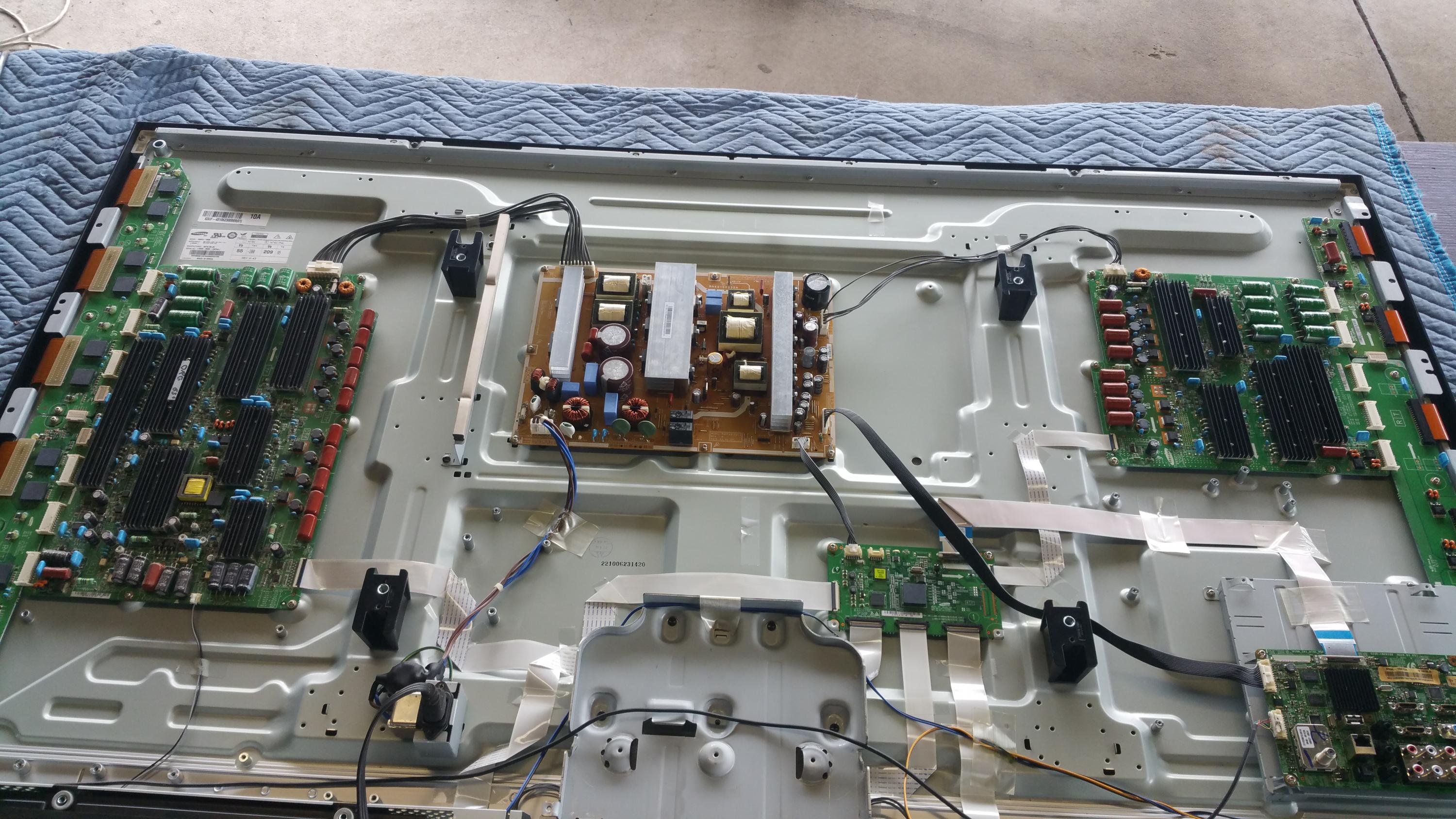

                          OK Looks like the problem was the Y-SUS board...
                          I got the gamut of parts from this model.. All but the Power PCB...
                          Replaced the Main.. Nope.. Still no go.. Replaced the Control Board and then X-SUS.. Nope...
                          Replaced the Y-SUS... Ahhhhh Houston, we have a picture!!
                          So, then I reversed my steps and put all the old boards back in... X-SUS, Control Main... All good..
                          Thanx for all the replies.. Chalk this up as another win...
