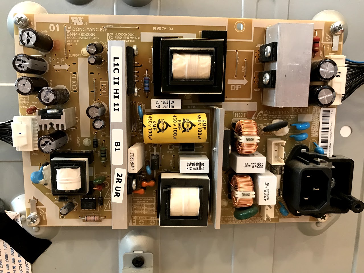

    TV Model: Samsung LN32C450E1DXZA
    Main board: BN41-01334A 2009.01.05 / BN94-02655A
    Power board: BN44-00338B (P2632HD_ADY)
    I checked CM808 (the 18nF cap) on the power board. This seemed to be a fairly common failure with this model as well. My ESR/Capacitance meter said it is 17.89nF.
    I also checked the output caps from the power board.
    CM858 | 25V rated @ 1000uF -> reads 896uF
    CM859 | 25V rated @ 1000uF -> reads 886uF
    CM853 | 10V rated @ 2200uF -> reads 1911uF
    CM854 | 10V rated @ 2200uF -> reads 1918uF
    CM851 | 10V rated @ 2200uF -> reads 1937uF
    -Thomas

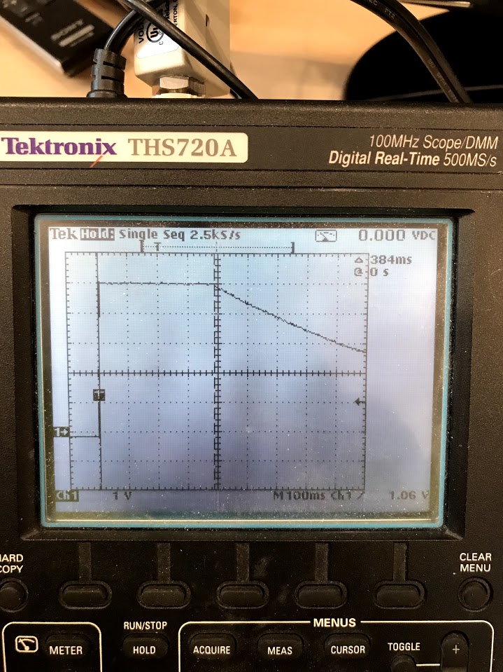

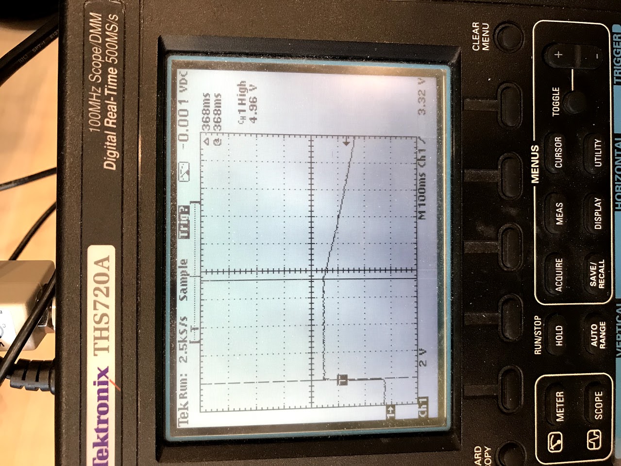

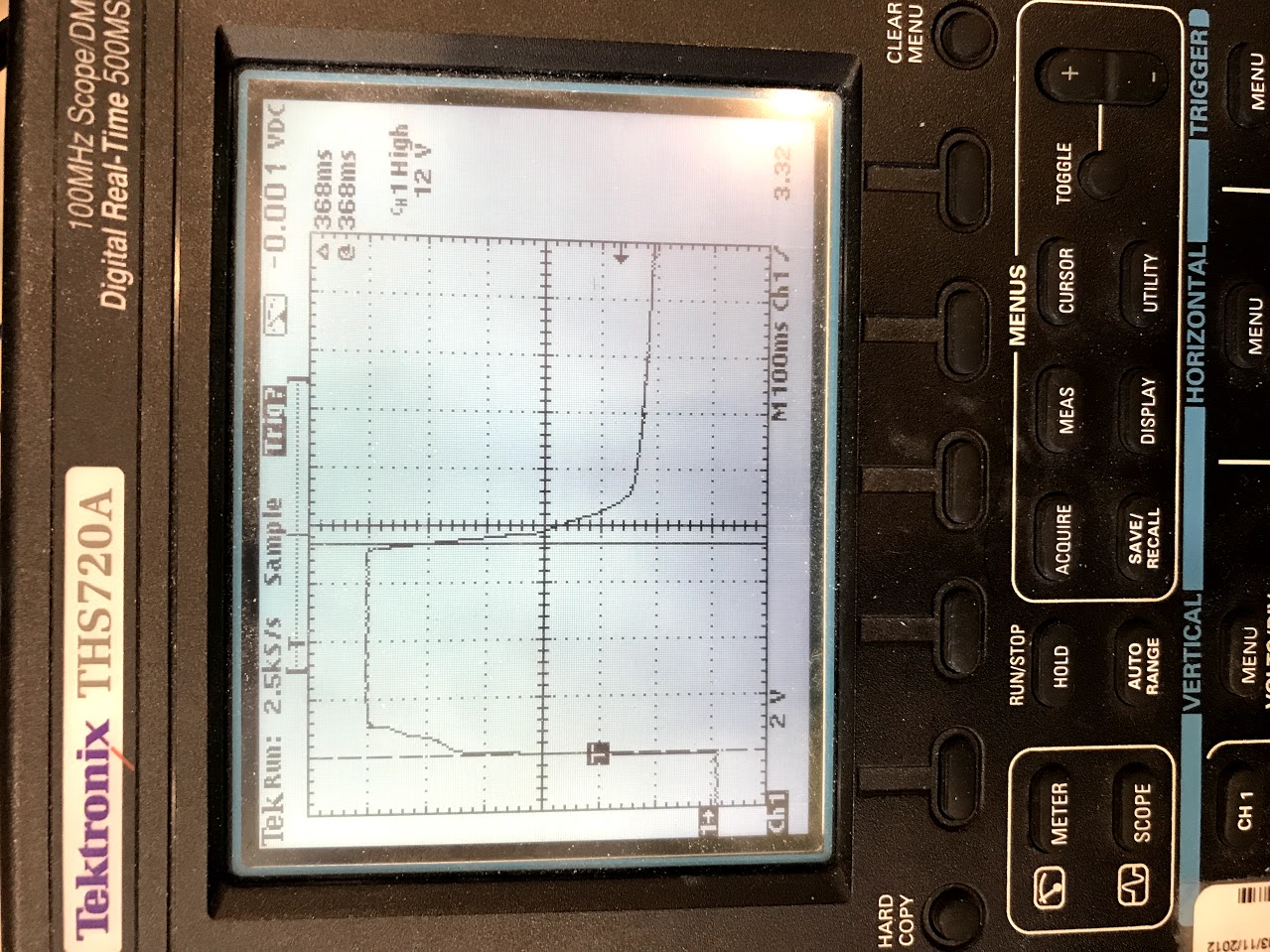

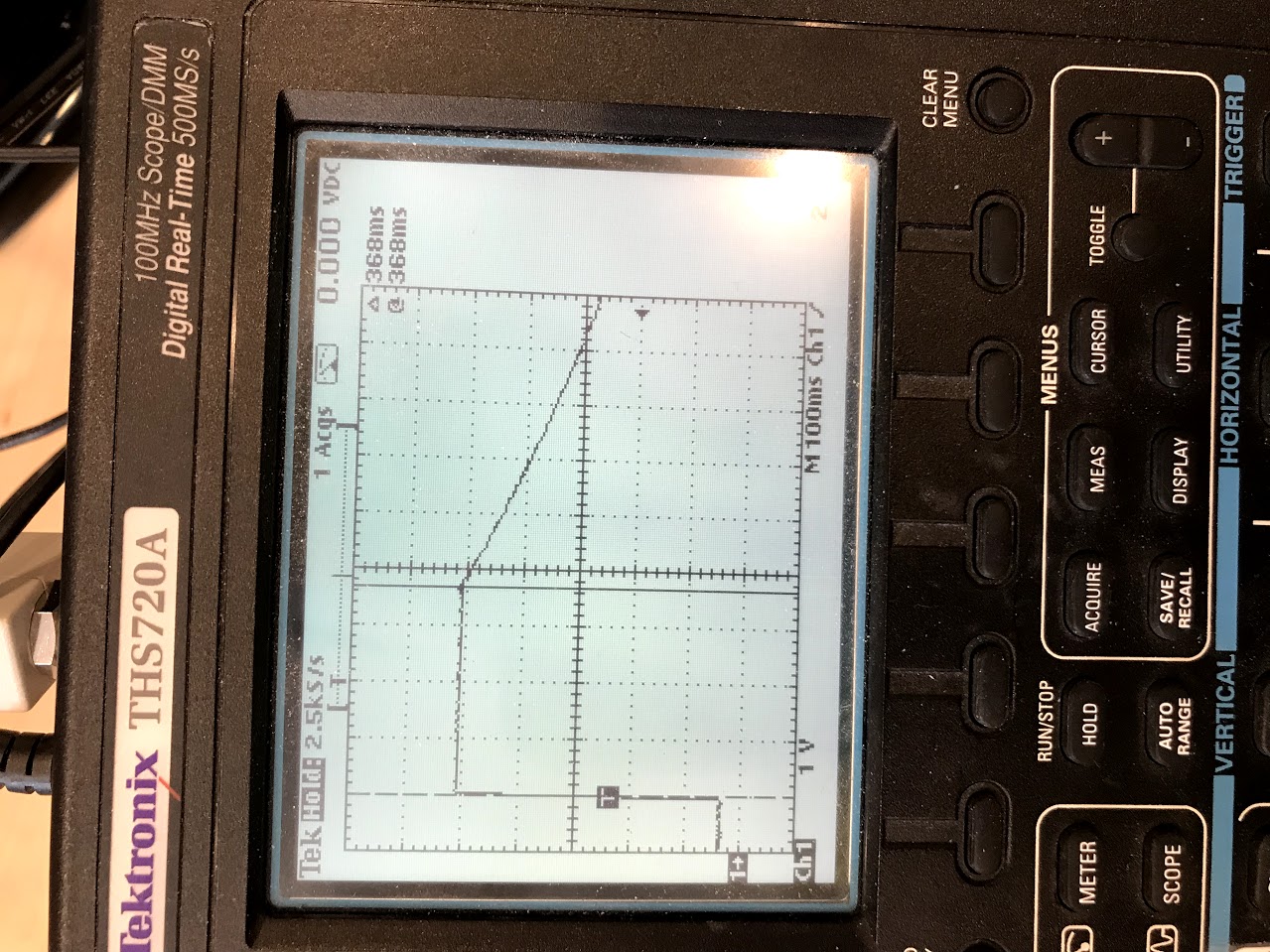

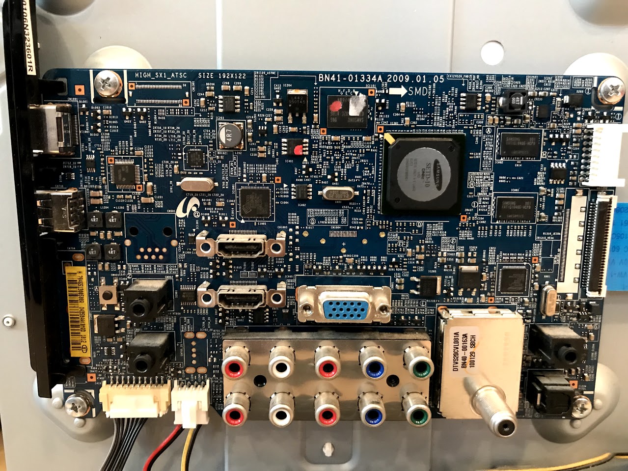

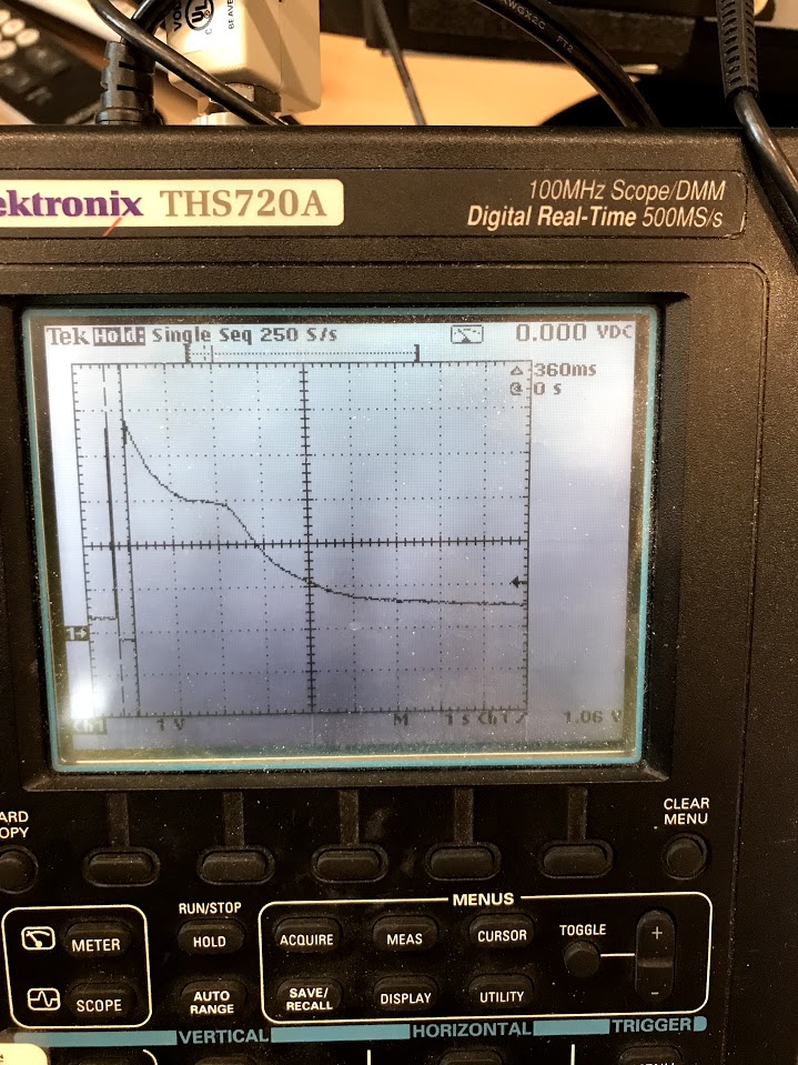

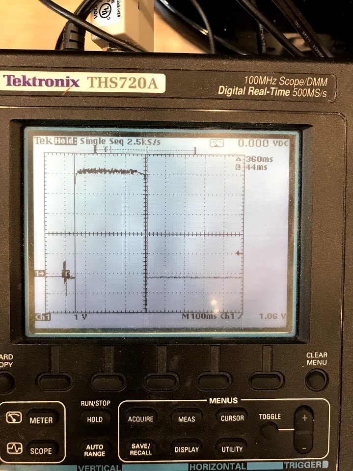

        I have a few updates to provide. I spent a little bit of time with my old 100MHz scope and poked around the ribbon cable between the power and main boards.
        Pics of the boards are attached.
        The connector pinout is shown in Pic0.
        PIC1 shows 5V_DET active for ~360ms before turning off. It's a single shot.
        PIC2 shows BLU_ON active for ~370ms before turning off.
        PIC3 shows the initial charge and decay of E-PWM
        PIC4 shows HSVON(?) - ~380ms
        PIC5 shows B5V - 5V@ ~370ms
        PIC6 shows PS-ON - ~325ms, the voltage level is ~734mV.
        PIC7 shows B5V (in column 1) - 5V, 370ms
        PIC8 shows B13V - measured out to be 12.6mV peak with my DMM. ~370ms
        Note 1: There is another 5V pin on the connector pin out that is called A5V, but i don't see it rise on the scope, even with the trigger level low. The service manual has a diagnostics flow chart box that references A5V.... I'll investigate this one.
        Note 2: The PS-ON signal initially seemed a bit low to me. But i measured the PS-ON pin on the Power supply with the cable between the PSU and the main board disconnected. It shows ~734mV (and interestingly enough, thats enough bias to turn the backlights on).
        ~350-380ms after the PSon signal is asserted, it turns itself off. Time to chase why that part is happening. The fault seems to be on the main board not being satisfied during start up.

          Re: LN32C450E1DXZA Main board fixes?
          A5V is the the Standby 5V so it should be present ans steady at 5V.
          B5V and B13V are switched power supplies that will be turned on when the PS-ON is present.
          So does the PS-ON signal come up to around 0.7V and then drops down to 0V?
          Some of PS-ON signal can be as low as 0.7V just enough to bias on the switched Transistor to turn on the Opto to turn on the PFC and the rest of the power supplies.
          The 5V_DET and the HVSON look to be error signals, I do not know if it is active HIGH or ACTIVE LOW, but since you have service manual, what does it say about thses two signals?
          May be you should upload the service manual.
            Hey Budm -
            Thanks for chiming in. I'm always appreciative of your input.
            The service manual is attached.
            I'll look in to A5V..
            Yes, PS-ON comes up to ~0.7V then turns off ~370ms later. Please see "PIC6 -PS_ON.jpg" in post #4
            I did not see anything regards to HVSON/5V_DET in the service manual

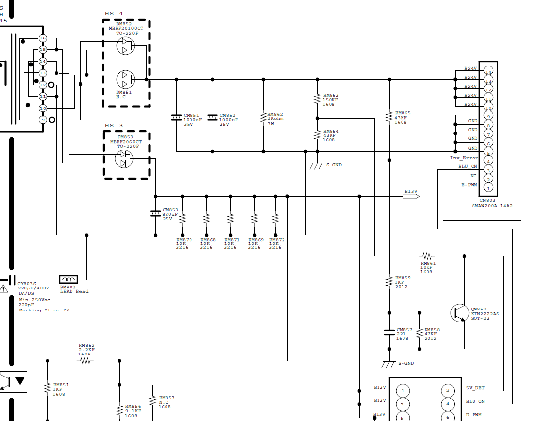

                            The 5V_DET signal goes between the power board and the inverter board (see the overall pic in POST #4). I disconnected the 5V_DET signal on the inverter board side (just slid the pin out from the plastic connector body). I tied it to GND through a 100 ohm resistor. I thought this would take care of it. 5V_DET on the PSU to MAIN board side STILL rises up to 5V before decaying. In the service manual, this is listed as INV_ERROR.
                            I thought 5V_DET was routed straight through from connector CN803 (inverter side) to CN802 (main board side). But that is not the case. It goes through a NPN inverter circuit implementation. Please see the attached PIC.
                            To my understanding, when INV_ERROR is HIGH, the NPN QM852 turns on, thus pulling 5V_DET LOW.
                            When INV_ERROR is LOW, QM852 is OFFso it should sit around ~5V.
                            Right now, i have INV_ERROR LOW; so 5V_DET is HIGH to the main board, but the behavior doesn't change at all. I still see the backlights flicker a few times and the PS_ON signal is short (370ms)

                              That 5V_DET (normally LOW) output of the inveter board is being converted to HIGH to satisfy the the main board (main board is looking for HIGH for normal condition), if there is true inverter error then the backlights will not come on and stay on.
                              At this point it is the matter of troubleshooting the main board to find out why PS-ON is turned off.
                                  I did not look at your service manual yet, so the one you have does not have the schematic for the main board?
                                  Did you try elektrotanya?
                                  https://elektrotanya.com/showresult?...oria=&kat2=all

                                    Good morning Budm -
                                    Correct, the service manual that i have doesn't have the board schematics for the main, inverter or SMPS. The link that you provided are all the items i've downloaded before, but no schematics are in them.
                                    I was not able to find a direct hit for a LN32E450E1 on my standard go-to sites: elektrotanya.com, eserviceinfo.com or toms-service-manuals.com
                                    Cosmetically, this unit is in really good shape. ... I'll keep on looking.

                                      The power board is a BN44-00338B (attached). Page 2 shows CN803, pin 4. On the power board silk screen, that is marked 5V_DET. In the schematic it is "INV_ERROR". This is pulled up by default. According to the panel spec sheet, the normal state of this pin is low when the inverter is operating correctly.
                                      On the power board, INV_ERROR is routed to the base of the QT853 NPN. The collector sits at about 5.4V. The emitter is connected to GND. The collector is connected to CN802, pin 2 which goes to the main board.
                                      • When INV_ERROR (CN803, pin 4) is high, QT853 is "ON" and pulls 5V_DET at CN802, Pin 2 low.
                                      • When INV_ERROR (CN803, pin 4) is low, QT853 is "OFF" and 5V_DET at CN802, Pin 2 high.
                                      Previously (Post #10), I pulled INV_ERROR low through a 100 ohm to GND and it didn't make any difference. Interesting data point. If the INV_ERROR pin is satisifed (e.g. no error condition), then the main board should have stayed on..
                                      This looks like it's pointing back to a bad main board.
