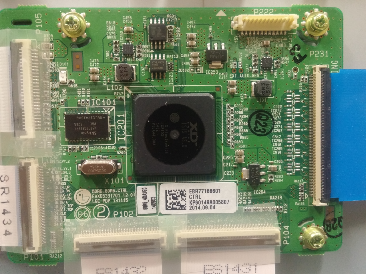

60PB5600 Control board EBR77186601 test jumper
    Anyone know where the jumper test points are ? I'm thinking R651 & R652. See picture. Thx

    Re: 60PB5600 Control board EBR77186601 test jumper
    Thats close, its the two holes labeled EXT_AUTO_GEN. some people solder a 2 pin plug then use a push on jumper similar to the ones on pc motherboards.
      Got it
