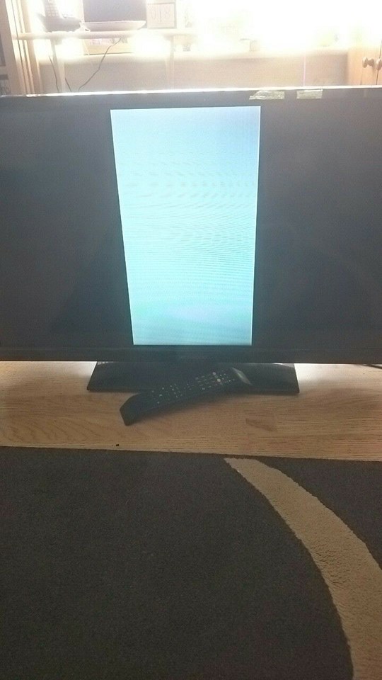

    Hi all got a 32 inch techwood tech32dledbms,vestel tv here,it powers up and off with a weird white patch/line in the middle of the screen..
    Im thinking screen panel but is it worth buying a 17mb82-2 mainboard to find
    out if its the mainboard?.
    Ive had a lot of vestel led tvs and its normally reflashing/backlights/diodes.
    But ive never seen one like this,the person i got it off said it had not been knocked..
    Thanks for any advice there must be somebody who has had one like this,
    of course it could have been knocked..

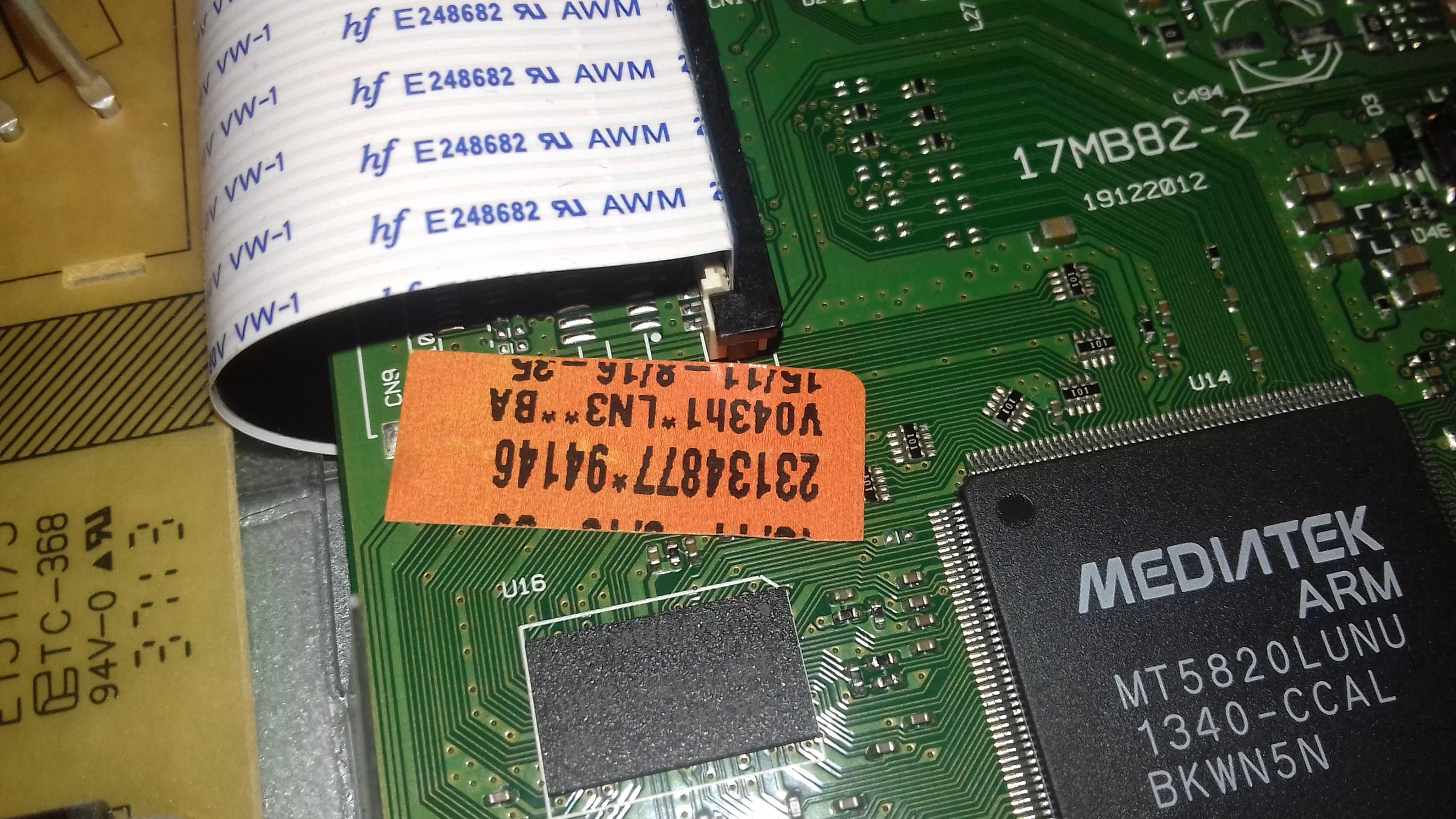

      Re: tech32dledbms weird picture
      Hi there is no tcon board only power board and main board.
        main board is 17mb82-2

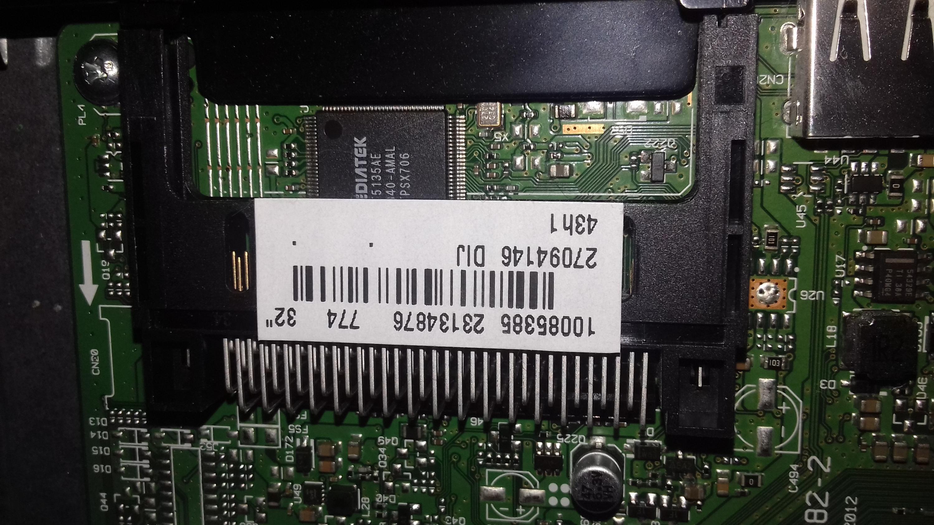

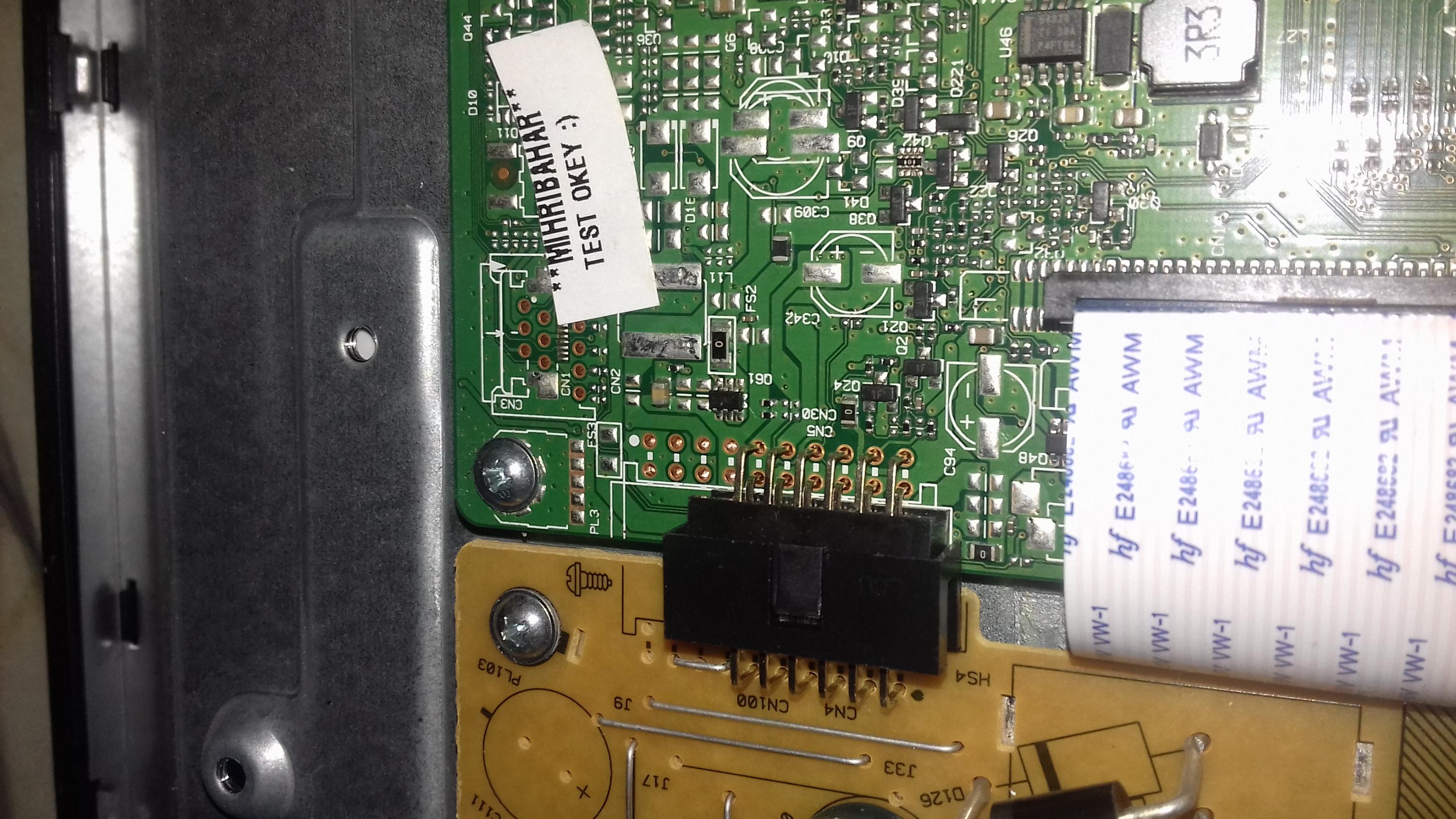

          Can you post photo's of your boards and back of the set showing how they all connect.
            no theres no tcon board so its either panel or the mainboard 17mb82-2,the only way i will know whether its the screen or board is buying the board i guess..
                Ive put the tv back together now,all thats in there is the two boards the power board works fine and the only other board to change is the 17mb82-2 i was hoping to see a tcon board in the tv but theres def no tcon board,it was the first thing i looked for as i know some versions of this tv have one.Without a lcd panel tester i guess ill have to buy the board on ebay and take a chance,by the way does anybody have one of the cheap led panel testers from ebay?,and do they work with vestel?,are they any good or a waste of money?,as most of the tvs i get are vestel,thanks.

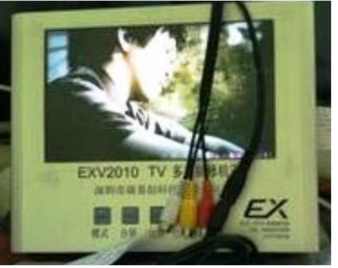

                    I have a EXV2010 LCD Panel tester With this one you can test the Main Bd. T-CON Bd. and Panel. It has a built in screen so by supplying the Main Bd. with voltage and taking the LVDS signal from the Main Bd. and , just connect directly to the tester and you would determine if the Main Bd. is working or not.
                      What does your tester look like?
                          This is what it looks like. This is not my picture. Actually it was given to me as a gift from a fellow engineer from Malaysia.
