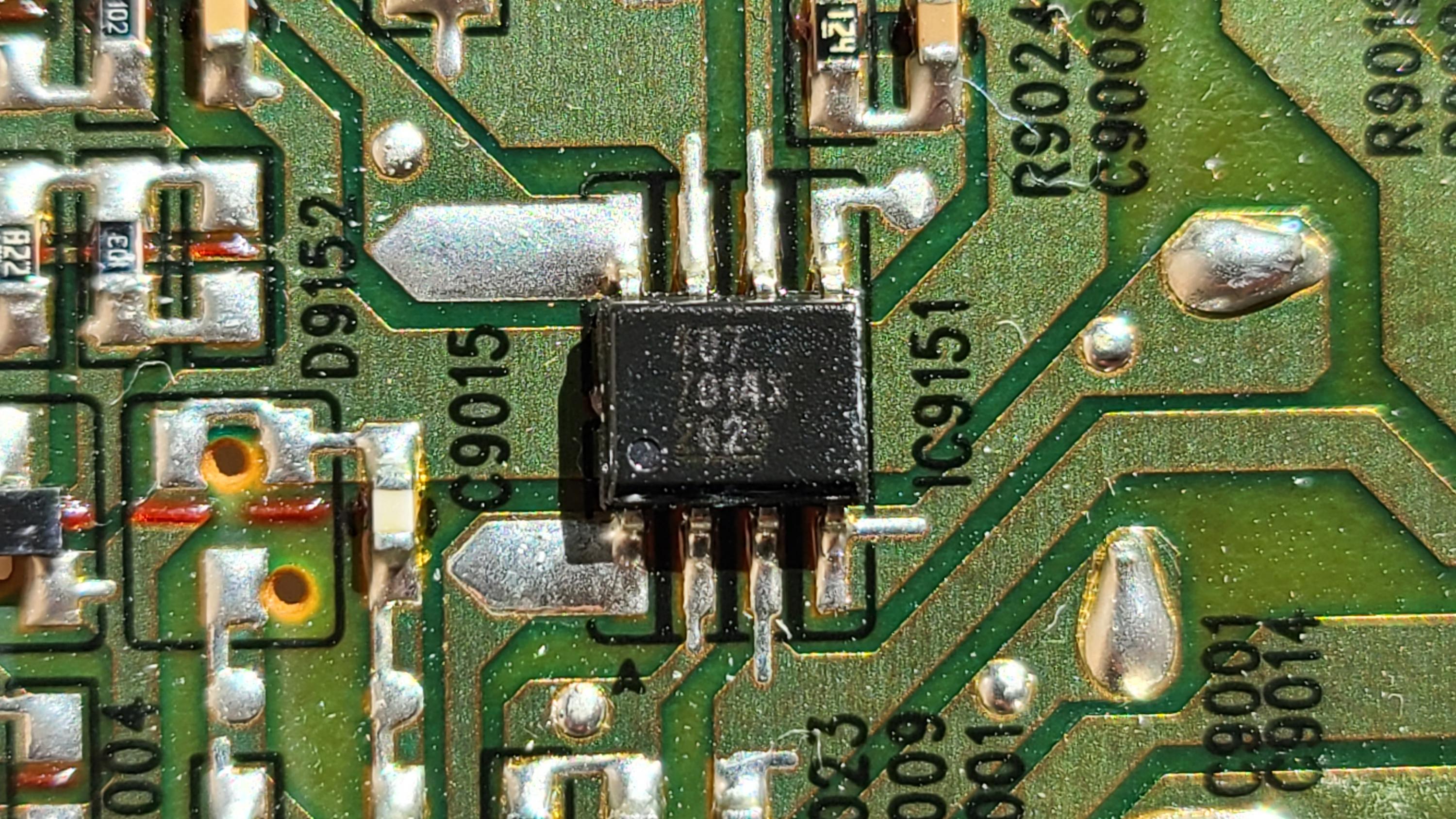

Samsung UN60H6203AF LED TV Screen Won't Turn On
  • Bambam33
    replied
    Re: Samsung UN60H6203AF LED TV Screen Won't Turn On
    Originally posted by Bambam33
    I thought that was on the top. When i look at the bottom the smd points to that part. I figured the driver would be attached to gate so im not sure what part is which. I took pics of the area hoping that helps.
    Are these good enough pics budm?
    Leave a comment:
  • Bambam33
    replied
    Re: Samsung UN60H6203AF LED TV Screen Won't Turn On
    Originally posted by budm
    The LED driver IC should be SMD located on the bottom side of the board.
    I thought that was on the top. When i look at the bottom the smd points to that part. I figured the driver would be attached to gate so im not sure what part is which. I took pics of the area hoping that helps.
    Leave a comment:
    replied
    Re: Samsung UN60H6203AF LED TV Screen Won't Turn On
    The LED driver IC should be SMD located on the bottom side of the board.
    Leave a comment:
  • Bambam33
    replied
    Re: Samsung UN60H6203AF LED TV Screen Won't Turn On
    Originally posted by budm
    what is the p/n of the led driver ic that dives the gate of the mosfet?
    Leave a comment:
    replied
    Re: Samsung UN60H6203AF LED TV Screen Won't Turn On
    What is the P/N of the LED driver IC that dives the Gate of the MOSFET?
    Leave a comment:
  • Bambam33
    replied
    Re: Samsung UN60H6203AF LED TV Screen Won't Turn On
    Originally posted by budm
    Post #51:
    0v between g and gnd with led connector off. 405v between d9001c and gnd with led connector off. Same voltages with led connector on.
    It looks like the MOSFET is not being driven so there is not current return path to ground for the LED.
    Thank u for the response. What should i look at next?
    Leave a comment:
    replied
    Re: Samsung UN60H6203AF LED TV Screen Won't Turn On
    Post #51:
    0v between g and gnd with led connector off. 405v between d9001c and gnd with led connector off. Same voltages with led connector on.
    It looks like the MOSFET is not being driven so there is not current return path to ground for the LED.
    Leave a comment:
  • Bambam33
    replied
    Re: Samsung UN60H6203AF LED TV Screen Won't Turn On
    Originally posted by Bambam33
    Replaced q9001c and d9001c. Still no backlight. When i first plug it is the top two rows breifly and faintly light for a split second. I checked every single led individually and they all light up correctly. Checked continuity between all led wires and the led connector and all checks out well. Measure 3ohms between s and chassis gnd. 0v between g and gnd with led connector off. 405v between d9001c and gnd with led connector off. Same voltages with led connector on. Tv off, test d+ when turned on with all connectors in place and goes up to 360vdc back down to 345vdc within 10s. S- is 260vdc down to 245vdc in 110s. S+ is same. D- is 160vdc down to 148. Running out of ideas on my end. Recall i did a bad thing by shorting the last led strip to gnd befor by using the diode mode and all the leds light up brightly. Also recall at one point this thing bit my finger when i simply touched the chassis and no points that should have done that.
    Budm, do these numbers look correct?
    Leave a comment:
  • Bambam33
    replied
    Re: Samsung UN60H6203AF LED TV Screen Won't Turn On
    hi maybe watch this video its a samsung un series led strip shorting too ground maybe why you got a shock of the chassis plus your led issue you are having
    https://www.youtube.com/watch?v=UXHyRfg1A1Q&t=192s
    That is interesting. I will try pulling the strips up and putting tape under it as well.
    Any other ideas if that doesnt work?
    Leave a comment:
  • vinceroger69
    replied
    Re: Samsung UN60H6203AF LED TV Screen Won't Turn On
    hi maybe watch this video its a samsung un series led strip shorting too ground maybe why you got a shock of the chassis plus your led issue you are having
    https://www.youtube.com/watch?v=UXHyRfg1A1Q&t=192s
    Leave a comment:
  • Bambam33
    replied
    Re: Samsung UN60H6203AF LED TV Screen Won't Turn On
    Anyone have any ideas?
    Leave a comment:
  • Bambam33
    replied
    Re: Samsung UN60H6203AF LED TV Screen Won't Turn On
    Originally posted by budm
    What does that mean?
    MOSFET has body diode between S and D so when test S and D it should show like Diode.
    1) Check the resistance between Source pin of Q9001C and ground to see what resistance you are getting?
    2) Check the Voltage between Gate and Ground of of Q9001C.
    Replaced q9001c and d9001c. Still no backlight. When i first plug it is the top two rows breifly and faintly light for a split second. I checked every single led individually and they all light up correctly. Checked continuity between all led wires and the led connector and all checks out well. Measure 3ohms between s and chassis gnd. 0v between g and gnd with led connector off. 405v between d9001c and gnd with led connector off. Same voltages with led connector on. Tv off, test d+ when turned on with all connectors in place and goes up to 360vdc back down to 345vdc within 10s. S- is 260vdc down to 245vdc in 110s. S+ is same. D- is 160vdc down to 148. Running out of ideas on my end. Recall i did a bad thing by shorting the last led strip to gnd befor by using the diode mode and all the leds light up brightly. Also recall at one point this thing bit my finger when i simply touched the chassis and no points that should have done that.
    Leave a comment:
  • Bambam33
    replied
    Re: Samsung UN60H6203AF LED TV Screen Won't Turn On
    Originally posted by budm
    What does that mean?
    MOSFET has body diode between S and D so when test S and D it should show like Diode.
    1) Check the resistance between Source pin of Q9001C and ground to see what resistance you are getting?
    2) Check the Voltage between Gate and Ground of of Q9001C.
    I lifted a leg of the diode and measure .4 across it. I removed q9001 and tested it as well. It shows open across d and s. I forgot to chk resistance between s and gnd before i removed it.
    If i understand it right, the mosfet is bad but the diode is ok. ??? Is there anything else i should chk before ordering a ne fet?
    I really appreciate your help thus far on this.
    Leave a comment:
    replied
    Re: Samsung UN60H6203AF LED TV Screen Won't Turn On
    Originally posted by Bambam33
    I checked d9001c and it passes (one direction flow only). I also checked q9001c and do not see continuity between s and d regardless of on or off state of the Q.
    What does that mean?
    MOSFET has body diode between S and D so when test S and D it should show like Diode.
    1) Check the resistance between Source pin of Q9001C and ground to see what resistance you are getting?
    2) Check the Voltage between Gate and Ground of of Q9001C.
    Last edited by budm; 09-05-2020, 11:00 PM.
    Leave a comment:
  • Bambam33
    replied
    Re: Samsung UN60H6203AF LED TV Screen Won't Turn On
    Originally posted by budm
    Check that diode too.
    It goes up to 405V because it is not seeing the load to complete the current return.
    Well, now im not sure. I am reading 388 in diode test mode from anode to cathode and OL the opposite way. Does that sound right?
    Leave a comment:
  • Bambam33
    replied
    Re: Samsung UN60H6203AF LED TV Screen Won't Turn On
    Originally posted by budm
    Check that diode too.
    It goes up to 405V because it is not seeing the load to complete the current return.
    I checked d9001c and it passes (one direction flow only). I also checked q9001c and do not see continuity between s and d regardless of on or off state of the Q.
    Leave a comment:
    replied
    Re: Samsung UN60H6203AF LED TV Screen Won't Turn On
    Originally posted by Bambam33
    I did that the other day and, if memory serves me, it ramped up to 405v and remained for D+. S+/- was around 350v and D- 150v. I will put it back together and test again.
    Check that diode too.
    It goes up to 405V because it is not seeing the load to complete the current return.
    Last edited by budm; 09-02-2020, 12:36 AM.
    Leave a comment:
  • Bambam33
    replied
    Re: Samsung UN60H6203AF LED TV Screen Won't Turn On
    Originally posted by budm
    On the LED connector (all connectors must be in place), there are four wires so what you need to do is to turn the TV off, keep the Black probe of Volt meter (Set meter to be able to read at least 400VDC) on the chassis, read probe on one of wire then turn on the TV while watching the meter to see how high the Voltage goes up to the with 10 seconds to see what it goes down to, the turn off the TV and then repeat the same test on the other 3 LED wires.
    At this point I suspect diode D9001C to be the problem, it is common failure for this BN44-00775A.
    For example: https://www.badcaps.net/forum/showth...75A#post980031
    I did that the other day and, if memory serves me, it ramped up to 405v and remained for D+. S+/- was around 350v and D- 150v. I will put it back together and test again.
    Leave a comment:
    replied
    Re: Samsung UN60H6203AF LED TV Screen Won't Turn On
    On the LED connector (all connectors must be in place), there are four wires so what you need to do is to turn the TV off, keep the Black probe of Volt meter (Set meter to be able to read at least 400VDC) on the chassis, read probe on one of wire then turn on the TV while watching the meter to see how high the Voltage goes up to the with 10 seconds to see what it goes down to, the turn off the TV and then repeat the same test on the other 3 LED wires.
    At this point I suspect diode D9001C to be the problem, it is common failure for this BN44-00775A.
    For example: https://www.badcaps.net/forum/showth...75A#post980031
    Last edited by budm; 09-01-2020, 11:56 PM.
    Leave a comment:
    replied
    Re: Samsung UN60H6203AF LED TV Screen Won't Turn On
    Originally posted by Bambam33
    Hi, sorry to bother, but any ideas?
    The picture of the bottom side has too much glare from the flash I cannot trace out the circuit using that picture.
    I will have to use pictures form shopjimmy instead.
    Last edited by budm; 09-01-2020, 11:53 PM.
    Leave a comment:
