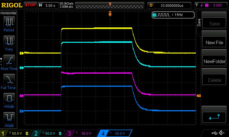

      The open circuit voltages are pretty uniform, though the suspect 3rd output still has a characteristic peaky start.
      The unit doesn't shut down when the lamp connector is open circuit, (end of traces occurred here when input power was removed) but there are still no diagnostic blink pattern from the power light to indicate a backplane problem.

        Oh, yeah - all the scope traces are 50v/div; the output amplitudes barely change between the loaded and unloaded state, hanging around 90V.
        You suggest that this is too low to operate a normal led string in this model.
        Does this mean I need to look at loading/regulation internal to this power conversion stage?

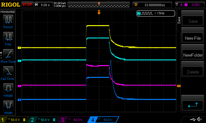

            Repeating previous test with lamp connector open, I could no longer get continuous operation from simple application of input power. This is strange, as the previous unloaded scope traces record the third time that this test was repeated.
            Instead, the outputs remain for only the original loaded time period (~10sec), on power application. Pressing the Power button then produces a continual output on the unloaded connector. traces are attached.
            The scope traces record:
            1(yellow) +C7204 ~L1-13 connector pin
            2(turquoise) +C7205 ~L1-9 connector pin
            3(pink) +C7206 ~L1-5 connector pin
            4(blue) +C7207 ~L1-1 connector pin
            ~85V is what the scope sees; a meter reads:
            L1-13 85.3V
            L1-9 85.6V
            L1-5 77.8V
            L1-1 85.7V

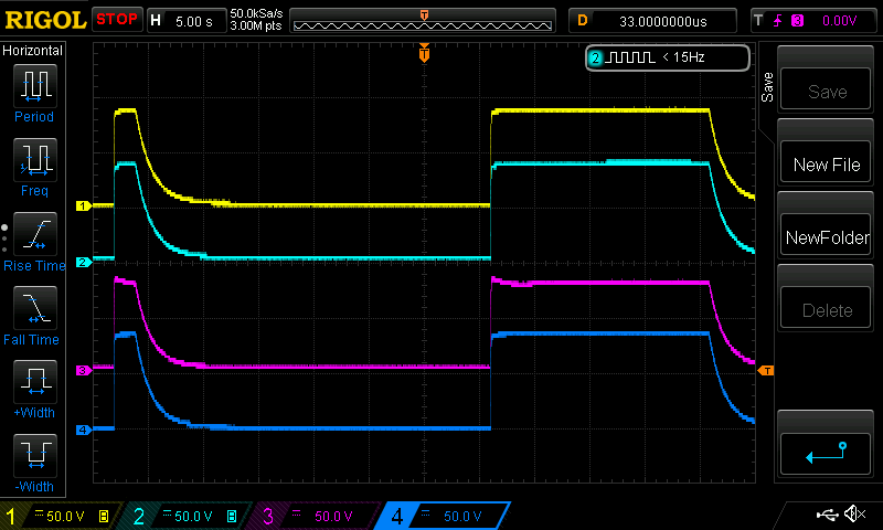

                  The OFL pin doesn't break out into the harness of this unit. In a repetition of the lamp-loaded, line make and break trial of the first sketch, it remains low throughout. There is no subsequent effect from pressing the on button, while power is applied.
                  Unloaded, there's a lot of chatter on the ERR line before the STBY line is asserted, at shutdown, subsequent to an input line connection. The same chatter is visible when operation started from the power button is similarly terminated. It would be handy to know where ERR is generated and why. The chatter is new. Image attached. Previously (ie until a few minutes ago) ERR was cleared by STBY as the converter went into protective shutdown, without ambiguity (per original sketch).
                  In order to track down the voltage imbalance on the unloaded lamp+ terminals, I replaced the electrolytic C7206 (tested normal for c and esr) and swapped over the two film coupling caps C7201 and C7202 (both also testing normal for generic polyester), without visible effect.
                  It looks like the lamp +voltages are democratically limited through the IC7303regulator/PC7601optocoupler, though this may not be the main regulated voltage. The reduced voltage node (L1-5) is never seen, the spiking node (L1-1) not seen until after the converter is disabled.
                  PFC output is normal, around 400V when the converter is enabled. Nothing odd around R7601 or C7603.
                  I guess the next candidates for voltage imbalance are the MUR206's. Will also check the effect of a missing snubber cap on the unbalanced half of the anode supply.

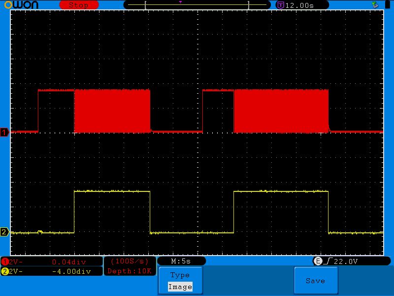

                    A complete change of MUR260s did not alter the unloaded voltage imbalance on L1-5, nor did it change the loaded flaring behavior on L1-1 during protective shutdown.
                    Loaded, the drain voltage on the drain pin of Q7202 rises above 10V before the STBY pulse inhibits the main converter. The negative output of the cathode regulator hits -60V before the inhibit. Unloaded, the negative regulator goes to -65V without generating an inhibit.
                    Jitter on the ERR line is only present in the unloaded lamp condition, and does not result in an inhibit.
                    An inhibit will only be reset by line input power recycling, suggesting a latching fault detection, either in BU5V-powered circuitry, or main board logic.
                    There are no indicator lamp blink codes - this is steadily illuminated when the power button permits it, turning off under the internally inhibited condition.
