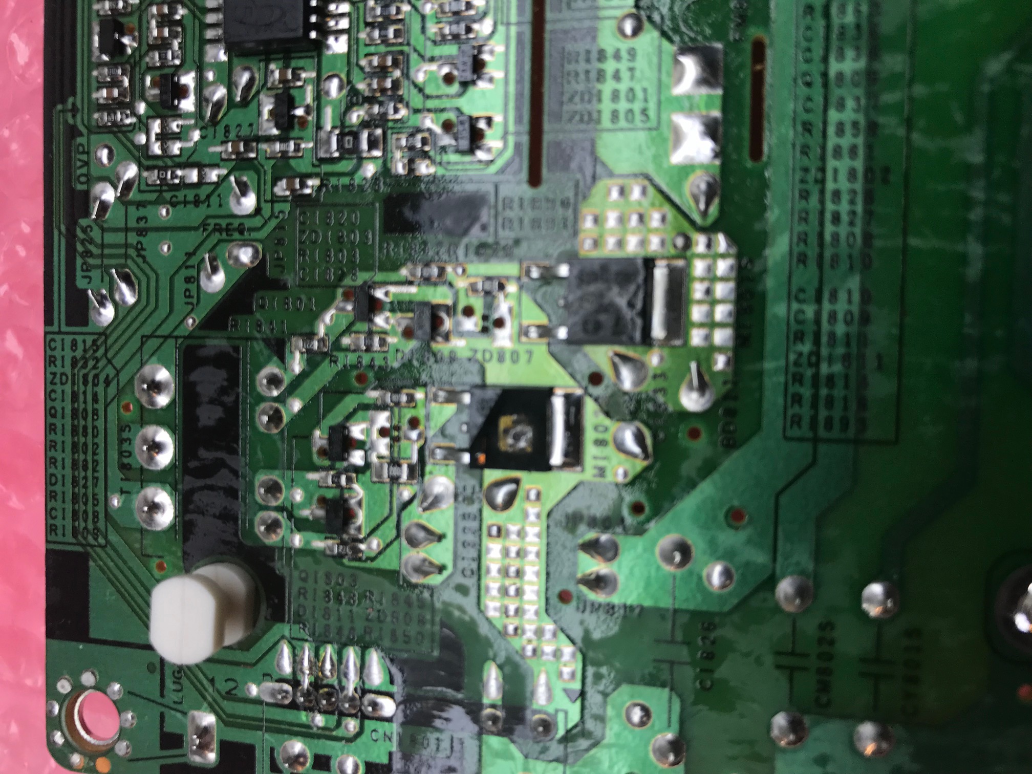

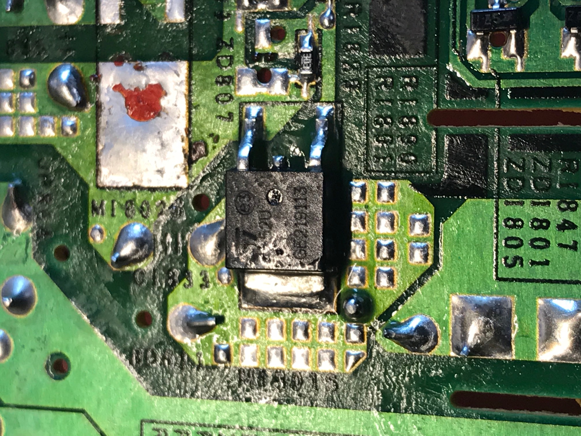

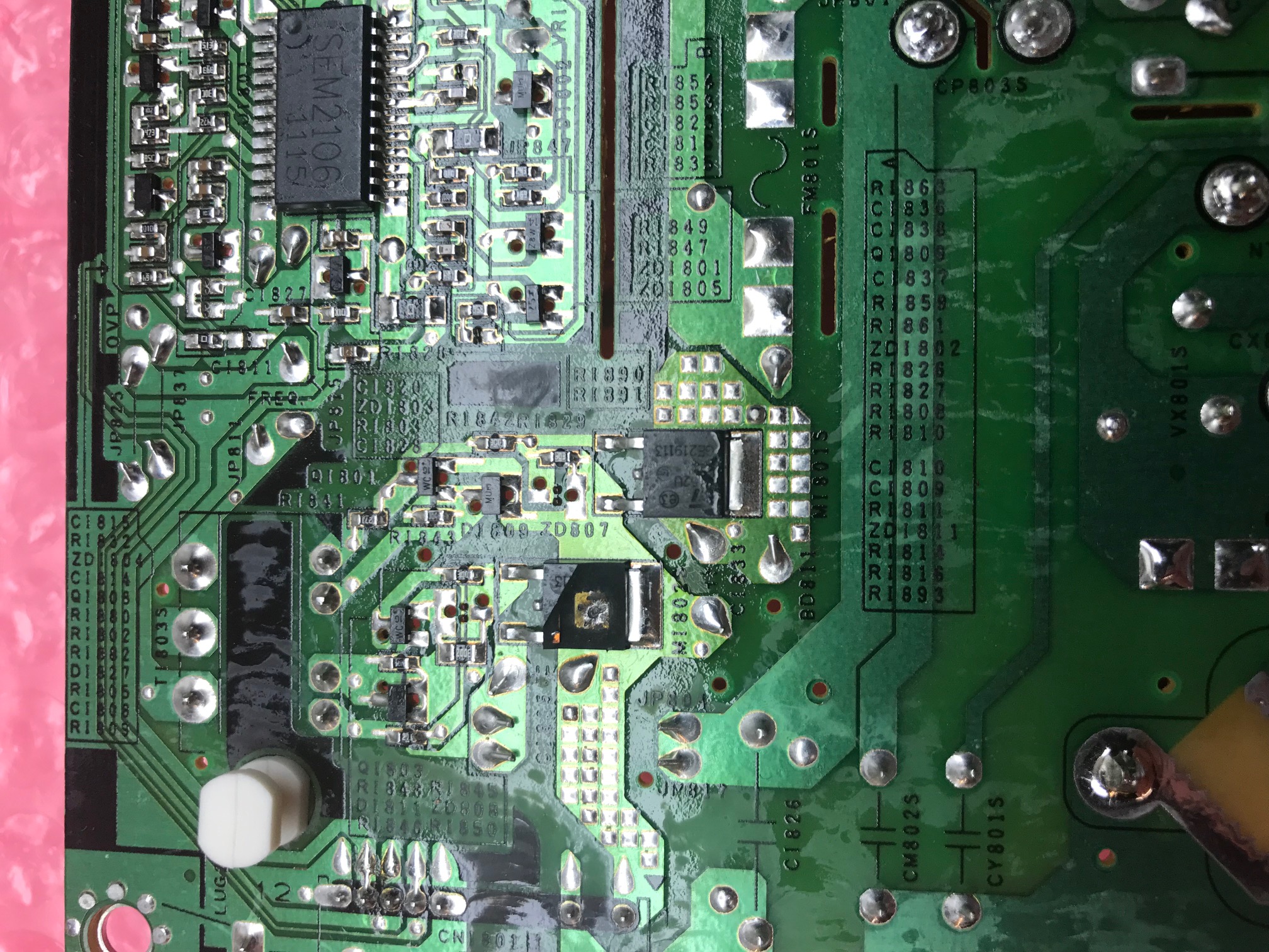

Samsun LN32D405
Re: Samsun LN32D405
Yes, they are the same, they are setup as half- bridge to to drive the primary windings of the inverter transformers on the inverter transformer board.
You need to test all parts that are connected to the Gate pin for damage too.
Samsung BN44-00438A (PSIV121411A) Power Supply Unit
http://www.shopjimmy.com/samsung-bn4...upply-unit.htmLast edited by budm; 04-19-2018, 08:49 PM.Never stop learning

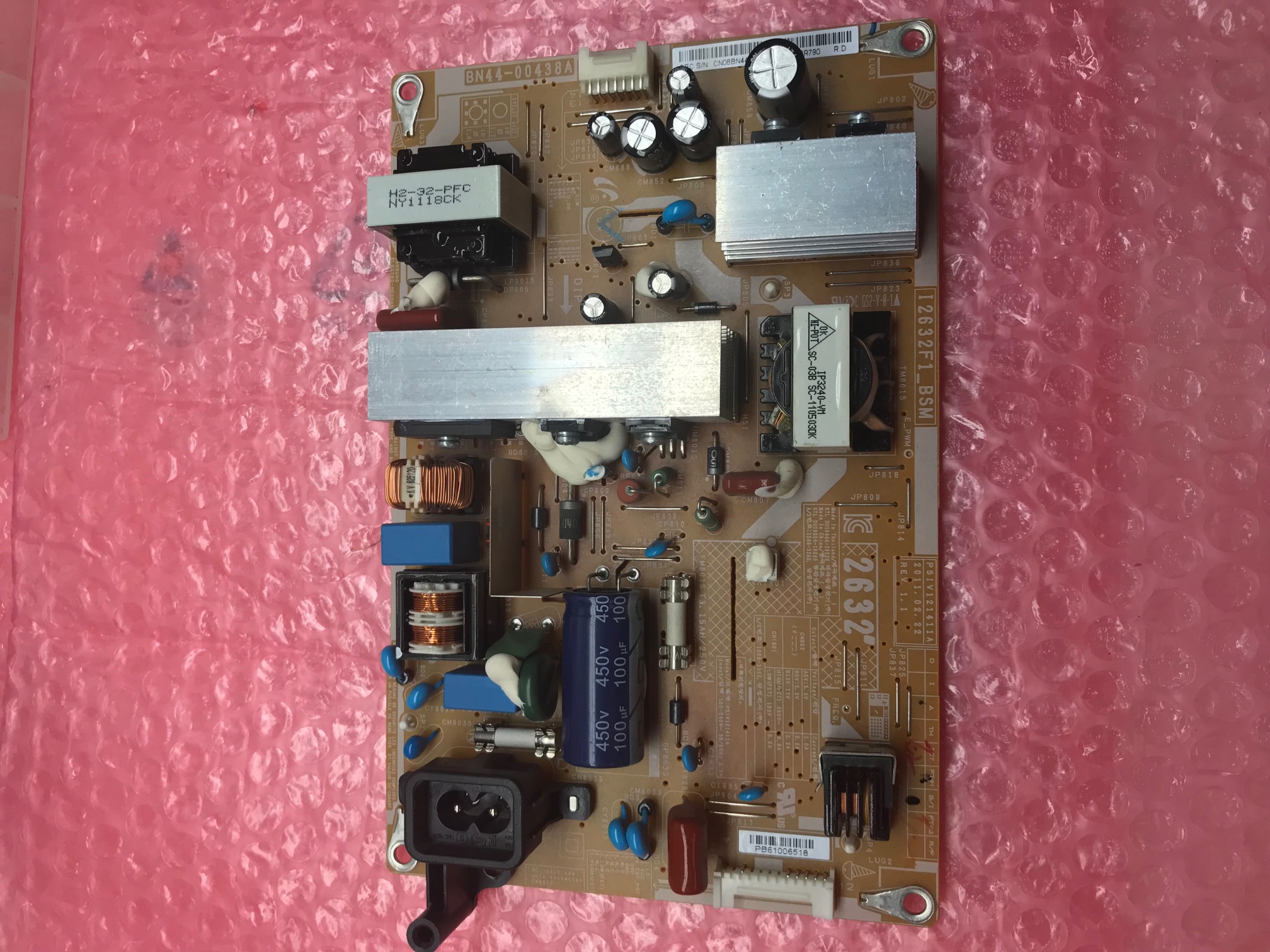

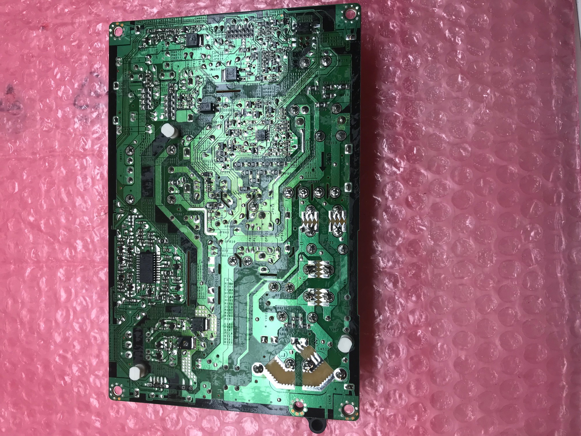

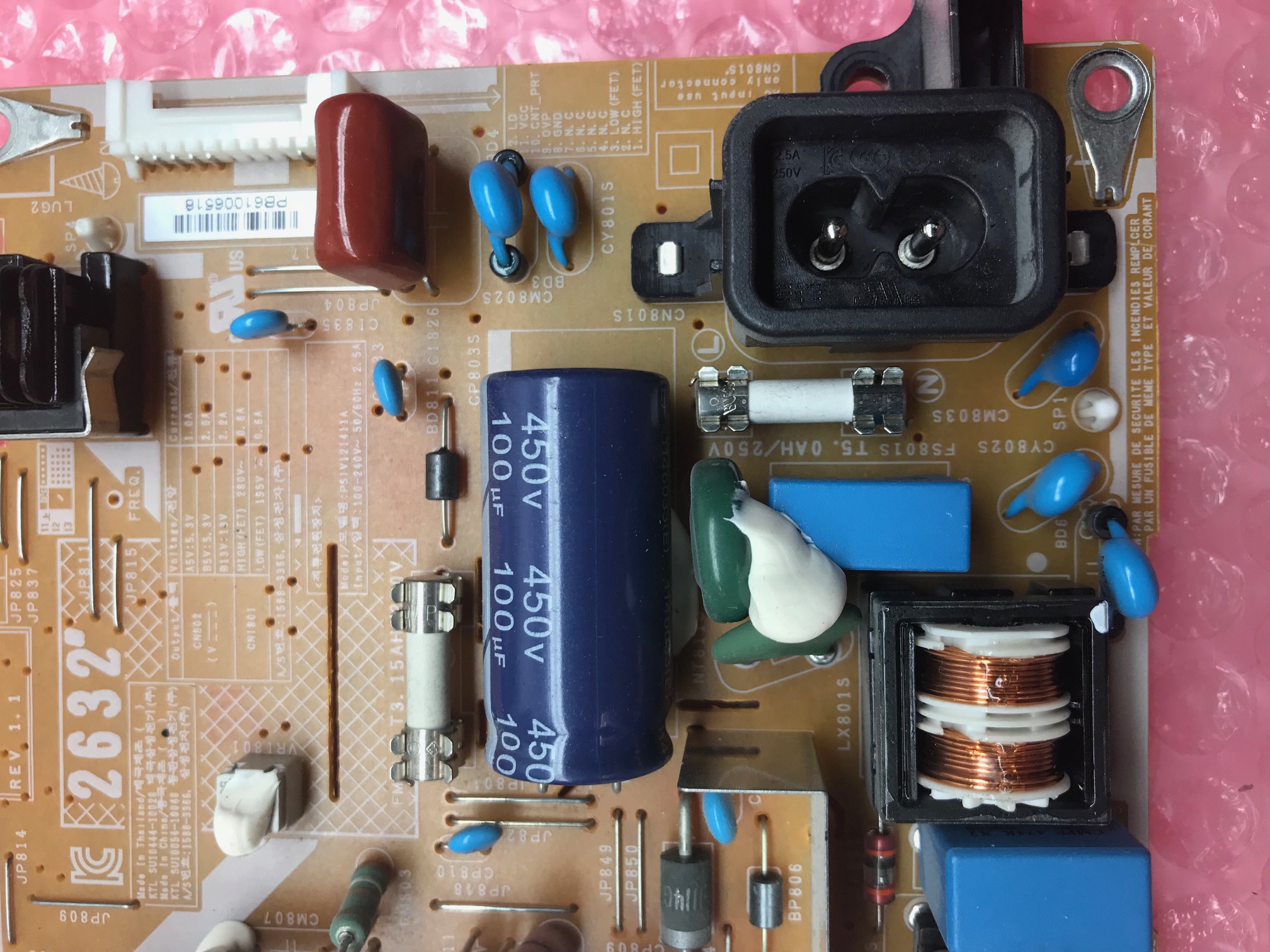

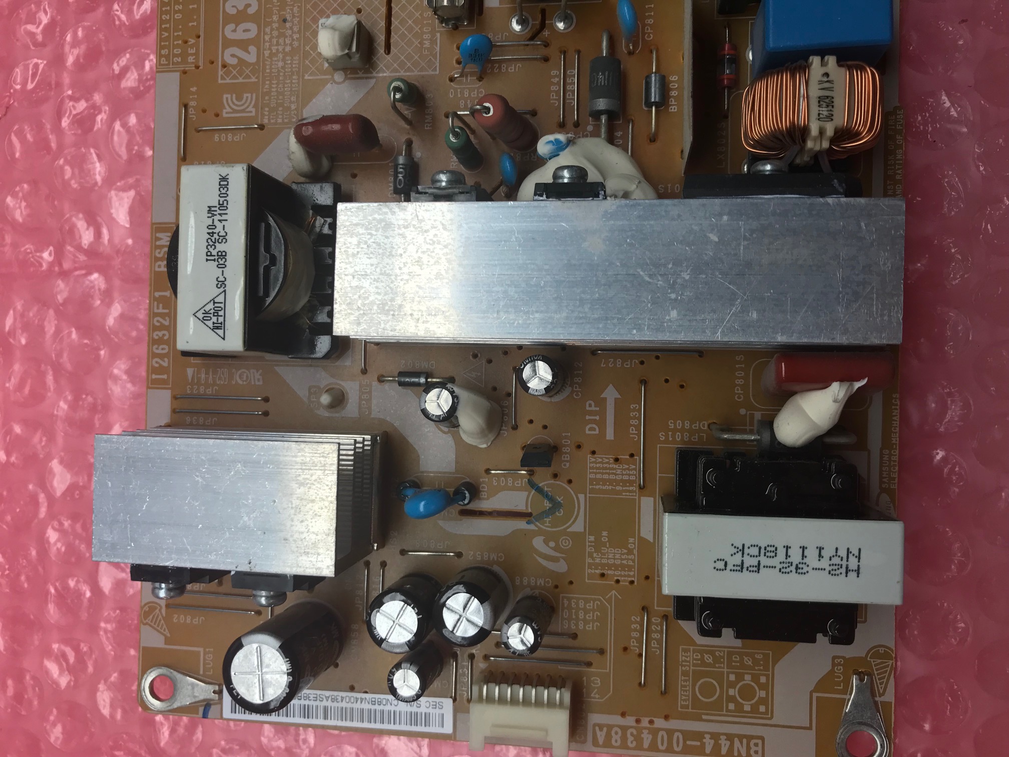

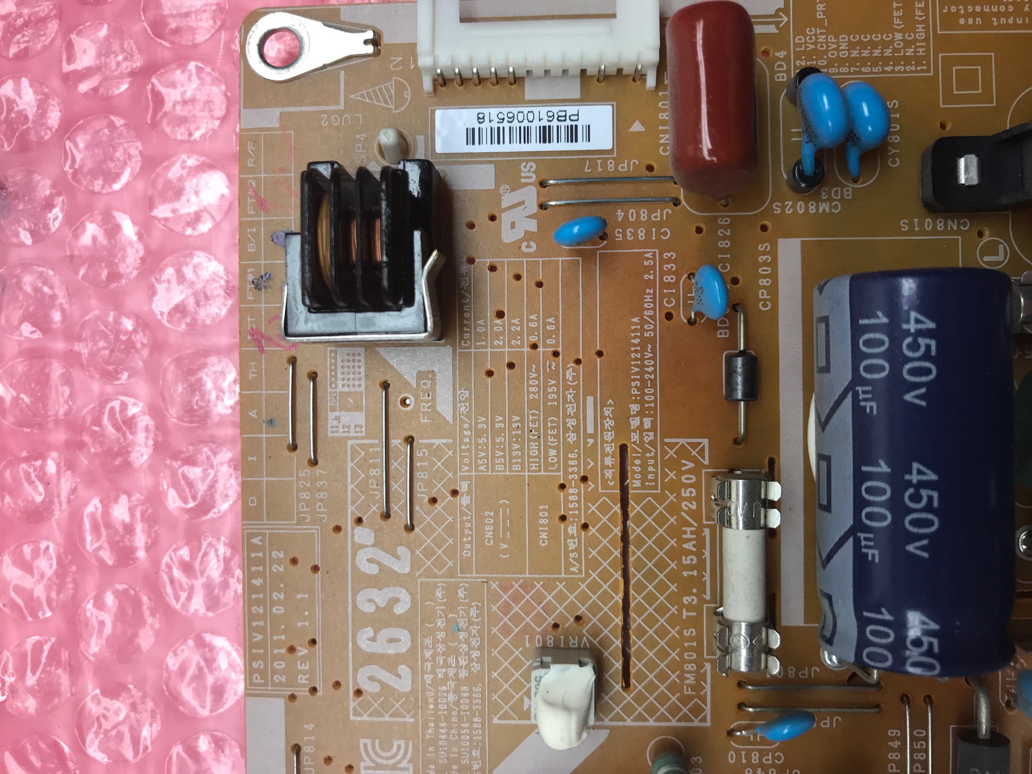

Re: Samsun LN32D405
Your part number is BN44-00438A
Repair Kit - check these parts for failure
https://www.ebay.com/itm/BN44-00438A...t/183177052784
Schematic
https://www.electronica-pt.com/esque...-supply-26302/Comment

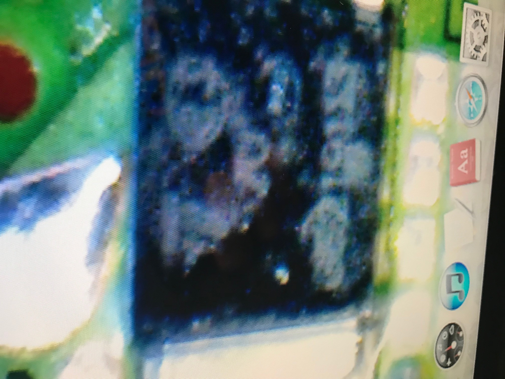

by Loki_FidoHi ya folks,
I have this MacBook Pro A2485 (M1 Pro 2021) which came in for repair.
It had a shorted SSD power supply chip. Therefore it was stuck at 5V.
I replaced it and the SSD are fine. No more shorts.
But The mac still pulls 5V and 200mA. If i leave it alone for 5 mins, the mac manages to receive 20V and 40mA. Of course, which doesnt mean the mac starts after power meter reading 20V.
But while the mac is stuck at 5V, i checked the board with thermal and found this chip was trying to start. Chip picture is attached.
Chip marking... -
